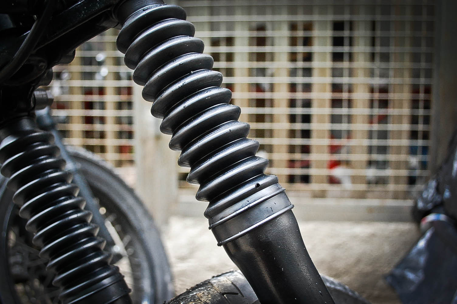

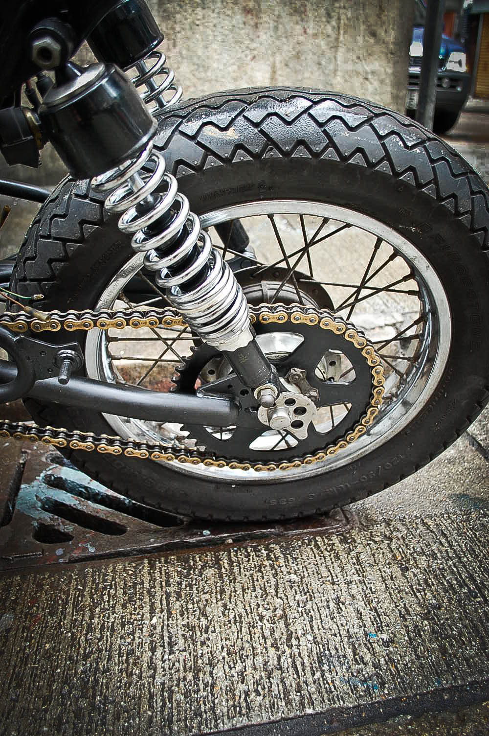

ok guys here is an update. i finally have a roller. got the drums polished up, rebuilt and re-jetted the carb have the new rear shocks mounted with new bushing swingarms, front forks painted and gaitors (forkboots) on. my mate managed to get the dent out of the tank with compressed air (don't have a pic, but if you look at the previous pics there is one with the tank lying next to the bike and you can see the dent, previous owner put a sticker over it, as they do). super stoked it came out because it was a fucking huge dent, busy prepping the tank for paint now.
still need to sort out most of the electrics, mount the new speedo,tank, seat, exhaust and bars. glad i have a rolling chassis though, certainly feels more like a complete bike again.
i'm really shit at updating pics and i appologise for that. i'm also not the type to post pictures of myself grinding the tabs off the frame with sparks flying. anyway, it was raining today, but i snuk out to get some shots.

I love that stance. Are they standard rear shocks? Carb looks schmick!
Re: sr 250 cafe - rachel
chain is D.I.D and the rear shocks are aftermarket. they are 2 inches or 5cm longer than the standard ones. because of the extra length I had to modify the rear brake as it would hit the swing arm otherwise.
