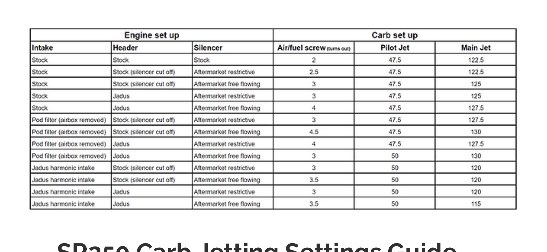

Cheers for the reply mate. Think I’m gonna get some jets for this CV carb that I’ve got I’m gonna go off attached jadus graph and see how she runs. Currently running stock header with restrictive silencer and pod filter. Would you still recommend the VM 30 with that set up ?
I would never recommend a pod filter with a CV carb. If you're not going to run the stock airbox, save yourself the hassle and just get a Nibbi PE30. They're not that expensive. It'll be ten times easier to tune and run better overall once you get it dialed in.
