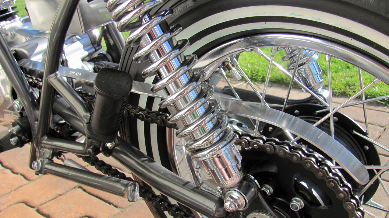

Re: SR250 Build
I made a chainguard out of a bit of aluminium flat bar, rivetedsome supports to it, looks a lot cleaner and less cluttered than the stock one.
The original exhaust header was pitted with rust so I decided to wrap it, new ones are fairly expensive and postage is down here, it looks white in the picture but it has tuned a browny grey colour now which loks good.

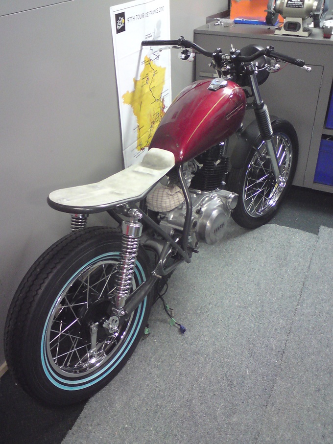

Re: SR250 Build
Bought some foam for the seat pan. Glued and shaped it but will leave the final cover for a professional.

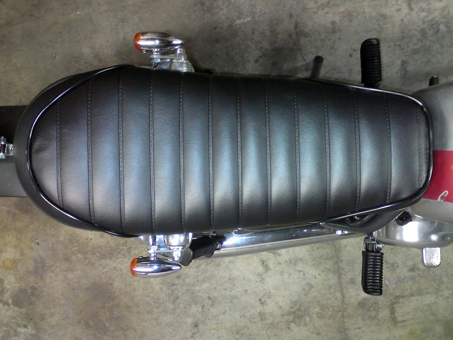

Re: SR250 Build
The seat came back from the upholsterers, they did a great job. Went down the home made route just to keep the cost of the project down. Mounted the tail light , time is coming to wire it up!

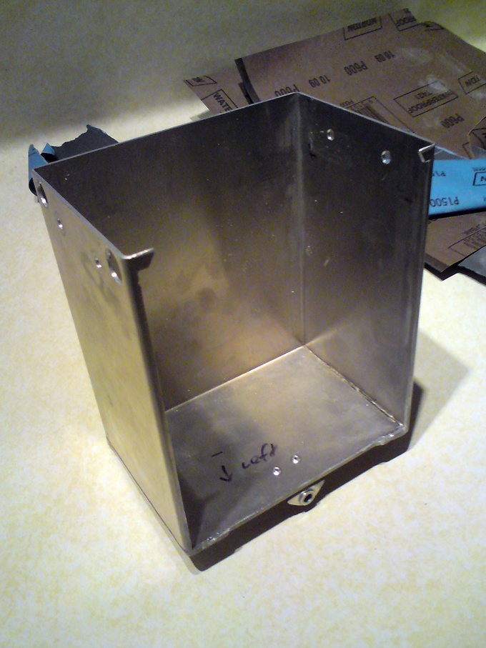

Re: SR250 Build
Decided to keep the standard size battery, I like the look of having nothing in the frame, but also having a visible battery box. Tried to make a feature of it, the lid comes of by removing a screw on the front. Had the box folded and welded, then gave it a light polish.

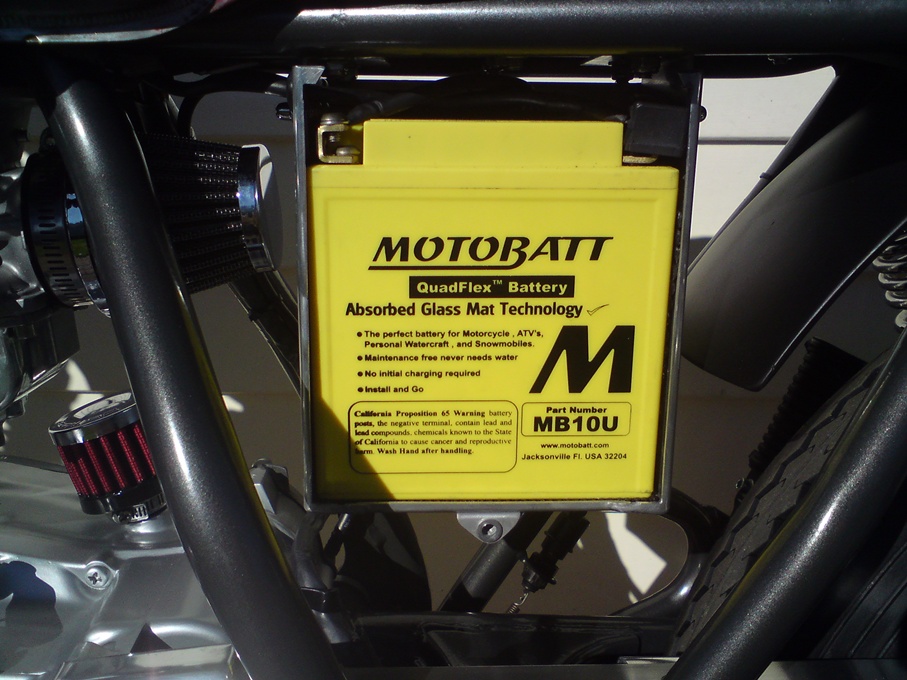

Re: SR250 Build
Here it is with the battery in it, installed onto the bike.
