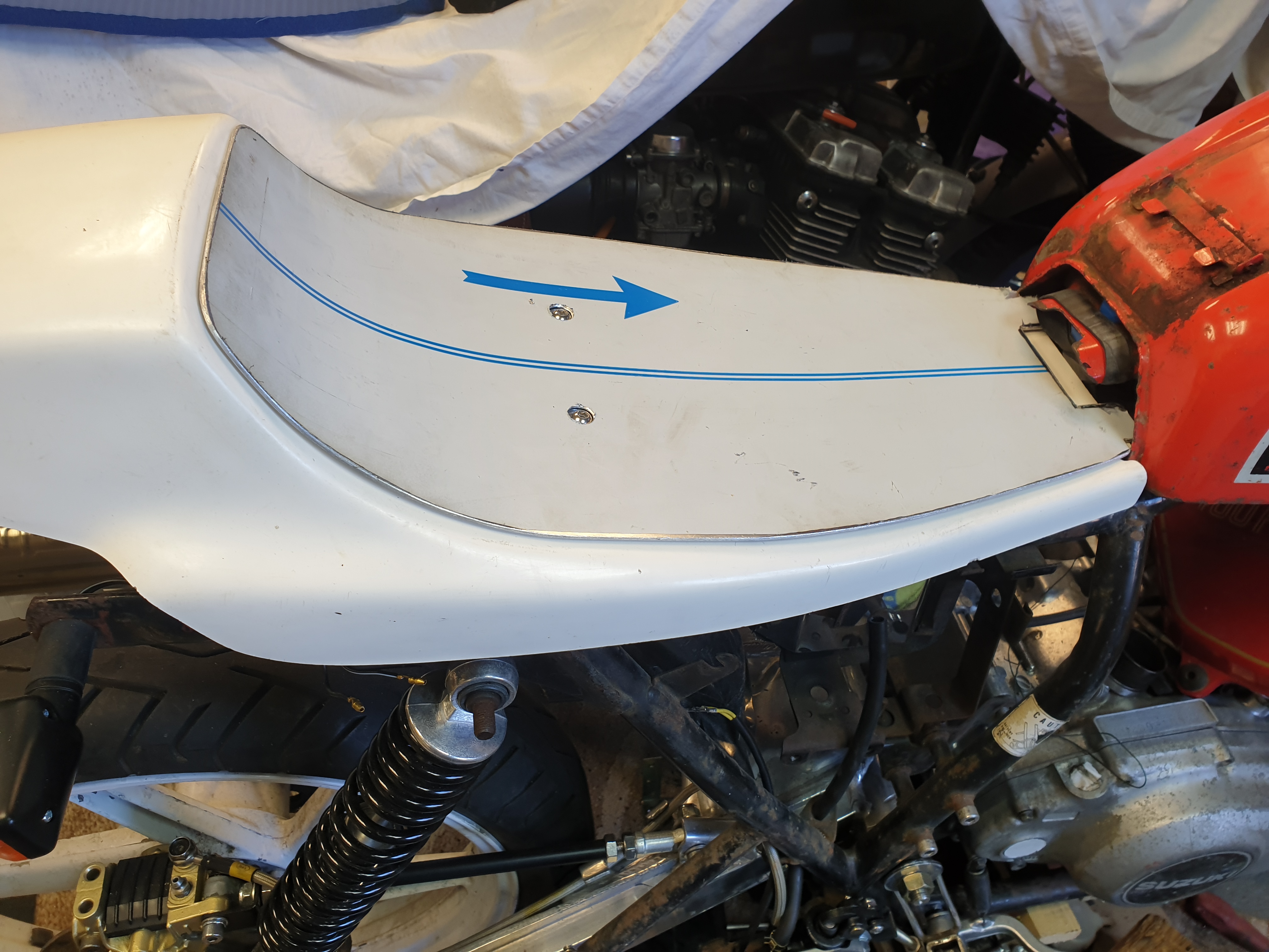

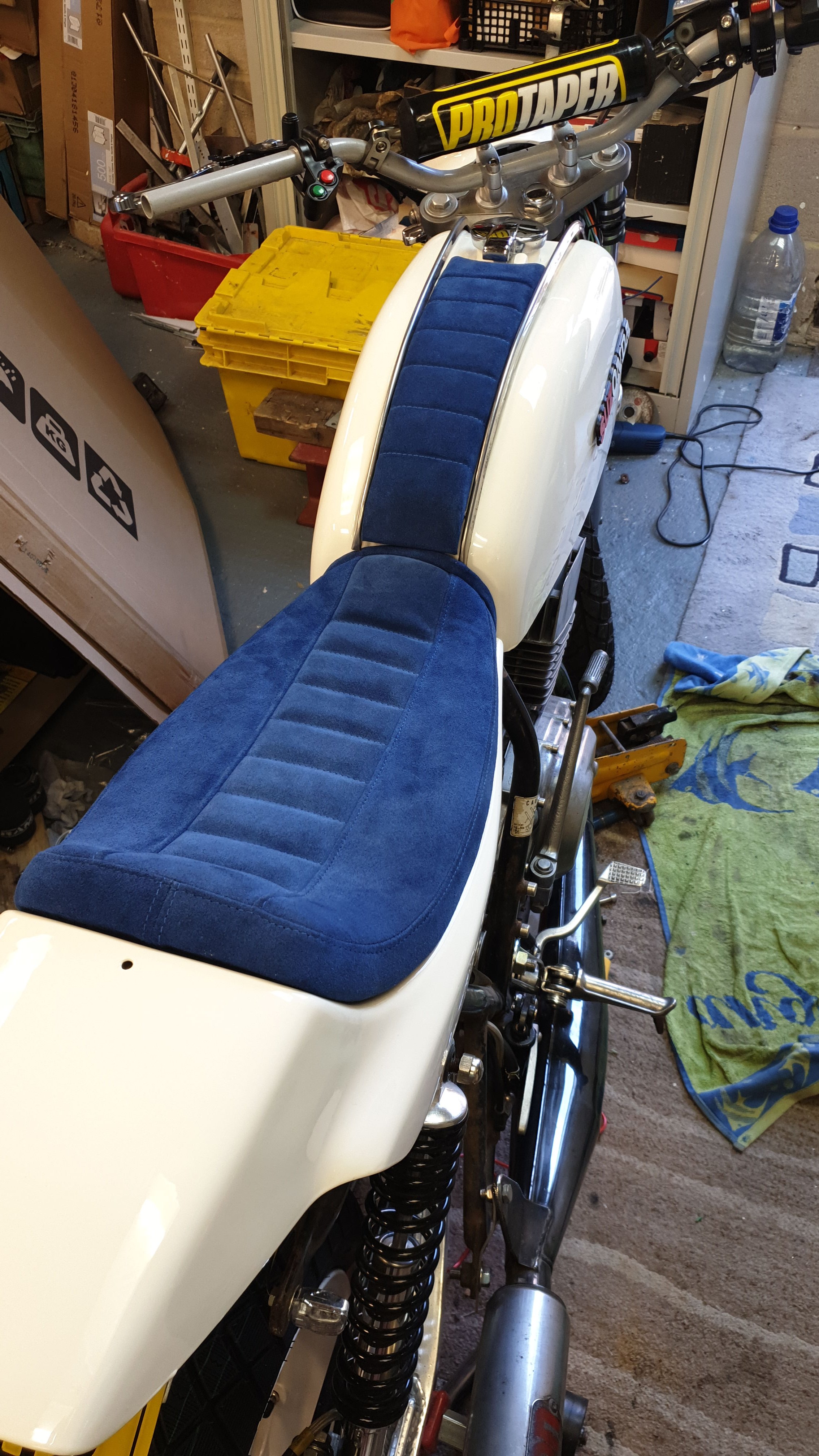

The seat unit is very similar to the one I chose. I made a simple padded seat out of 2mm alloy and 15mm yoga mat, doubled up to 30mm and then pro upholstered in blue suede...came out nice.

Nice! Good shape on the seat and not too thick. I am debating if I should get an actual seat made and upholstered or just run a piece of foam cut to size and glued on. Still not sure :)

Thanx...the yoga mat comes in various colours and can be shaped to look quite neat using 60-80grit sanding, the mat is rubberised and waterproof so could be used raw.

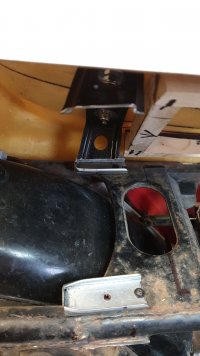

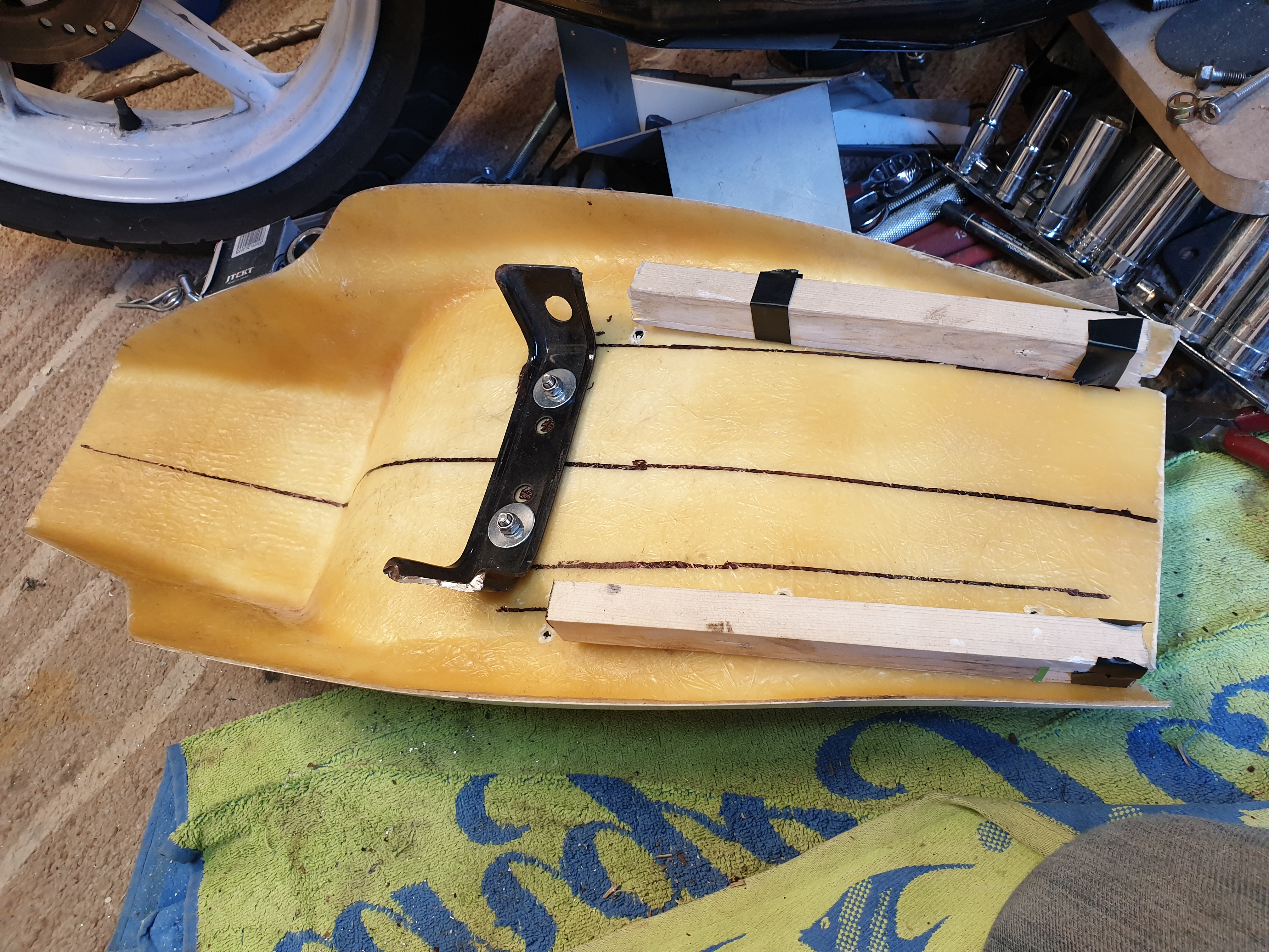

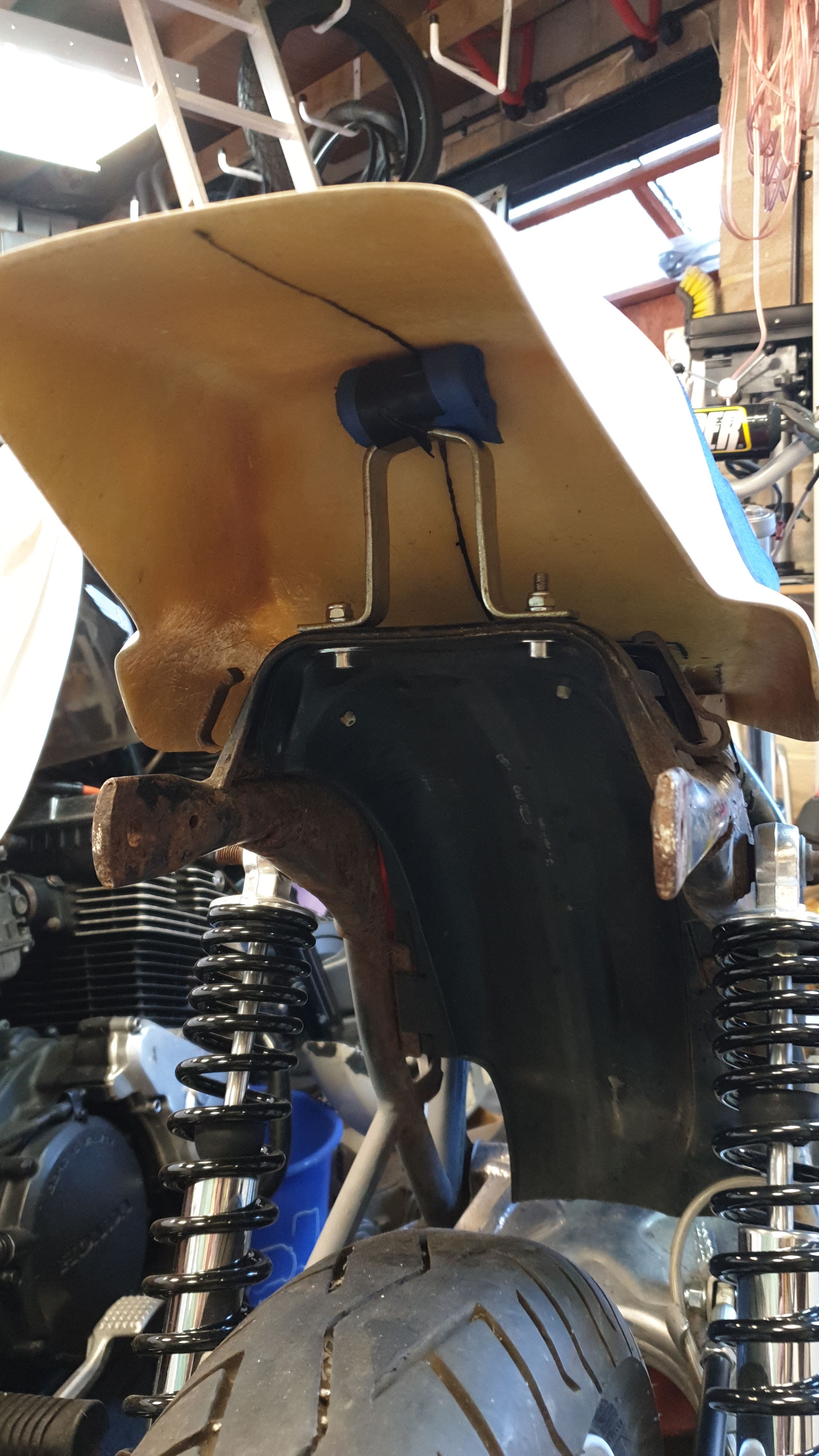

The seat pan is 2mm alluminium simply cut to shape and formed to follow the glass unit. I fixed/glassed/screwed in two timber subframe bearers to have it sit at the correct height (to align the seat unit and tank line) and recycled a subframe bridge (off my CBX550 project) to form a rear end brace, the two bridge feet sit in channels (which will be welded, cut from a drawer roller slider) so the seat can't move sideways. I then formed a raised rear mount (out of a bathtub support foot) and held with a single Deus clip. The front of the seat pad had to clear the rear tank mount, so I formed a 'mouth' from a cut up ear defender which worked a treat :)
The seat pad will be attached to the seat unit using acouple of strips of h/d velcro.
There will be a keyed switch mounted in the seat unit, with a quick release wire for when I need to remove the seat.
