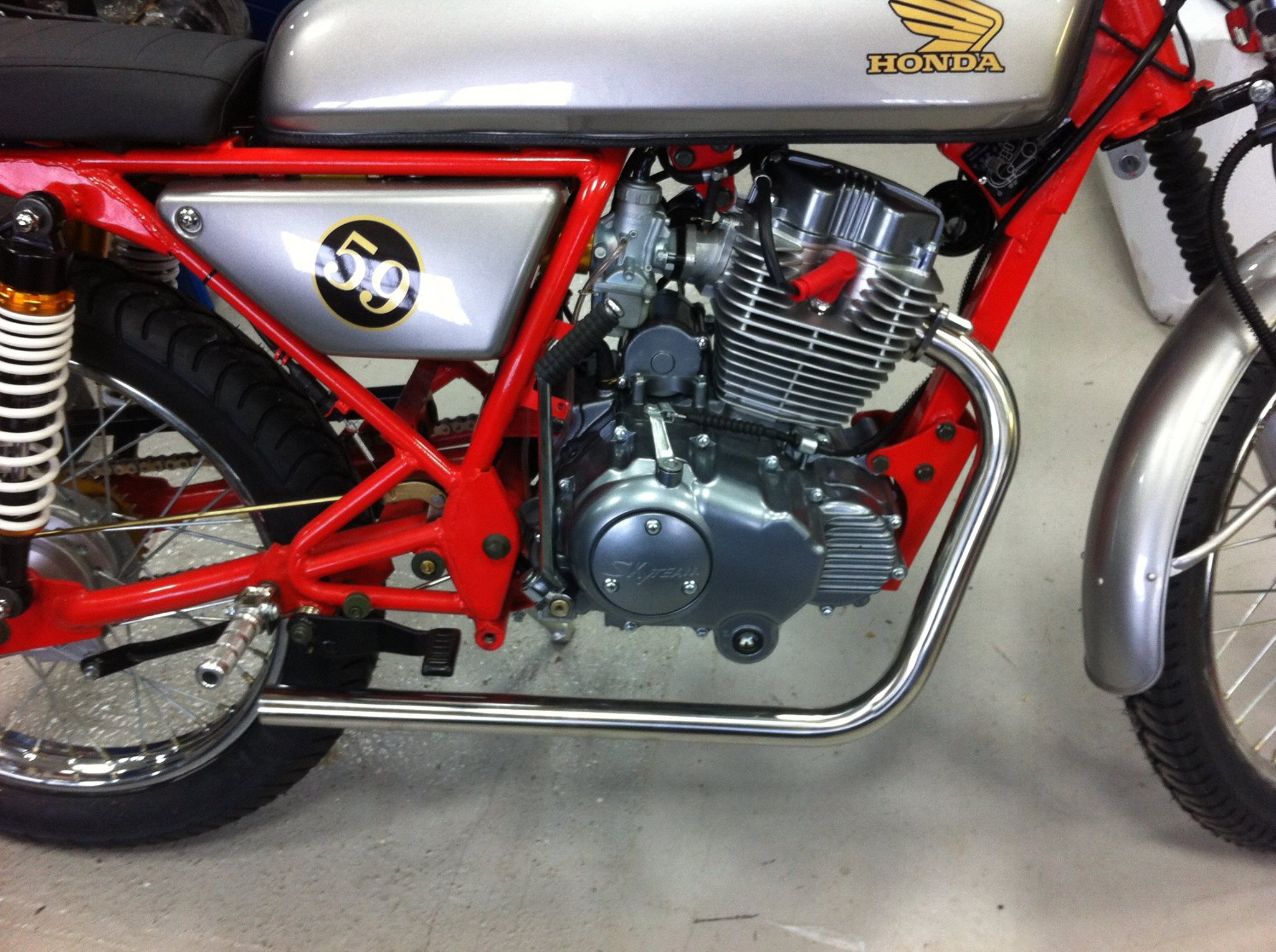

just saw oo racing has released a new header in stainless for £59.99
its on their facebook page but not on the sales site yet
quote-" Ace 125 stainless D CAT front pipe now in stock 32mm bore 35mm O/D 1.5mm wall can be cut down to suit. Price £59.99"
Here the are and the quality looks amazing although the flange isn't right but with a bit of modifying it will work.

Unfortunately the header and flange are perfect and would fit if my bike hadn't been built by an idiot, the studs have been bent.
So the header would probably fit straight on then just a case of making a mounting bracket, but i haven't got round to that yet.
Fitted mine today - looks a good bit of kit and has gone that nice straw colour now having been out for a run . My straight through megga is a bit loud though so might have to do some repacking . Getting speedo readings of 65mph - went for the hard run in as couldn't be bothered waiting ....... ;)
And yes mine needed the slots in the flange brought inwards, with a few strokes of the file all was good .
