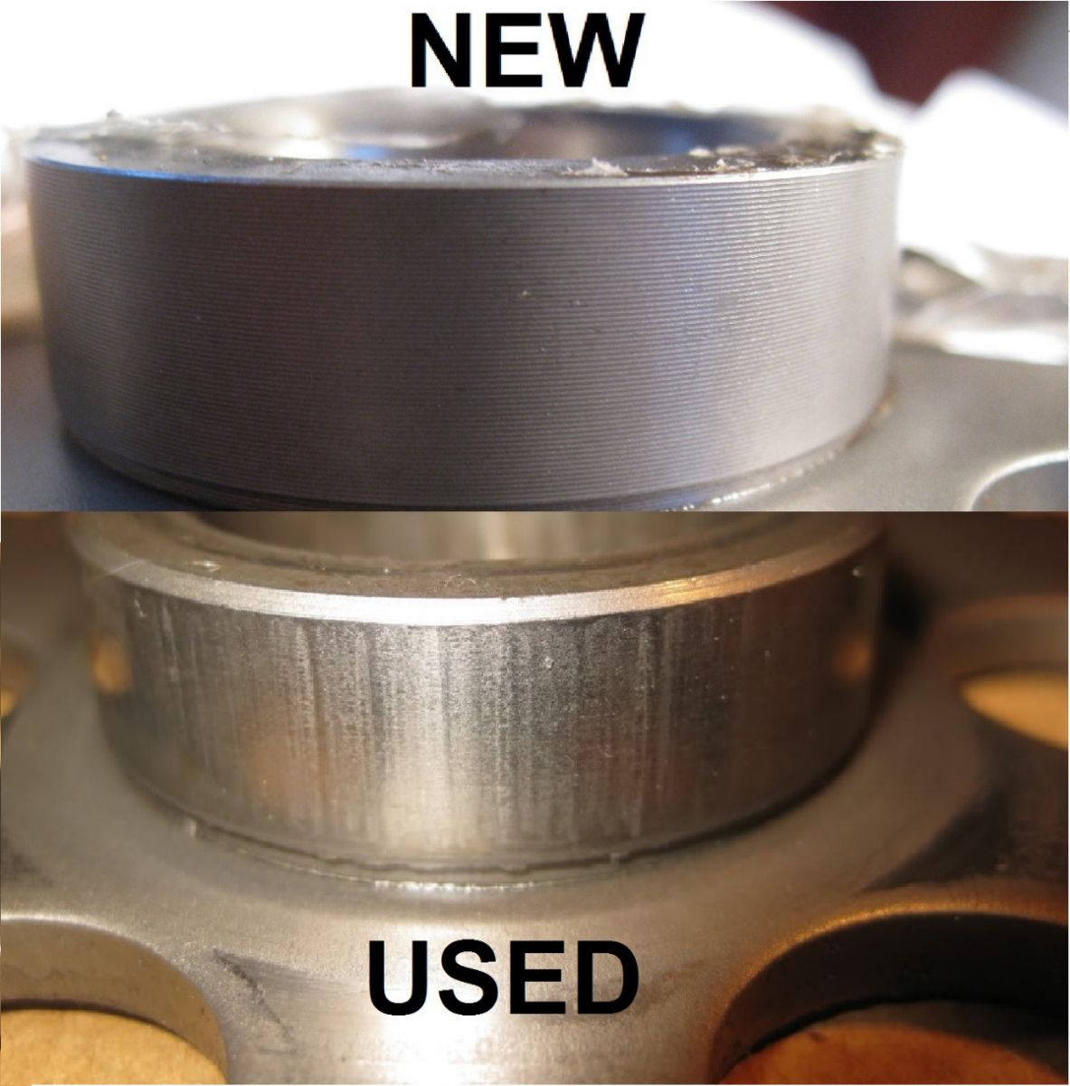

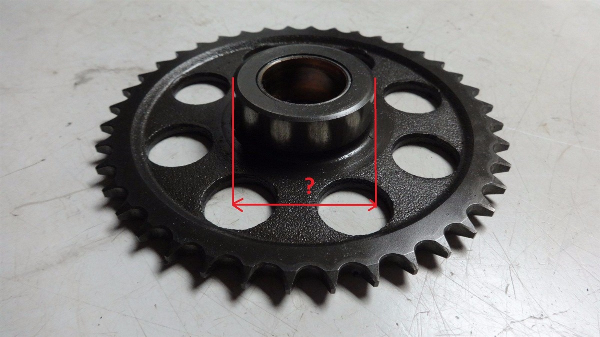

These photos arent mine but they illustrate what i need. I dont think i need the machined ridges for it to work well, but i cant have the ripples.

That one doesn't look too bad (at least in picture?) I've had Honda ones in much worse condition that polished up well enough to keep bike running another 6 months~year while owner looked or waited for a new one (and decided not to change it until it failed again ::) )
