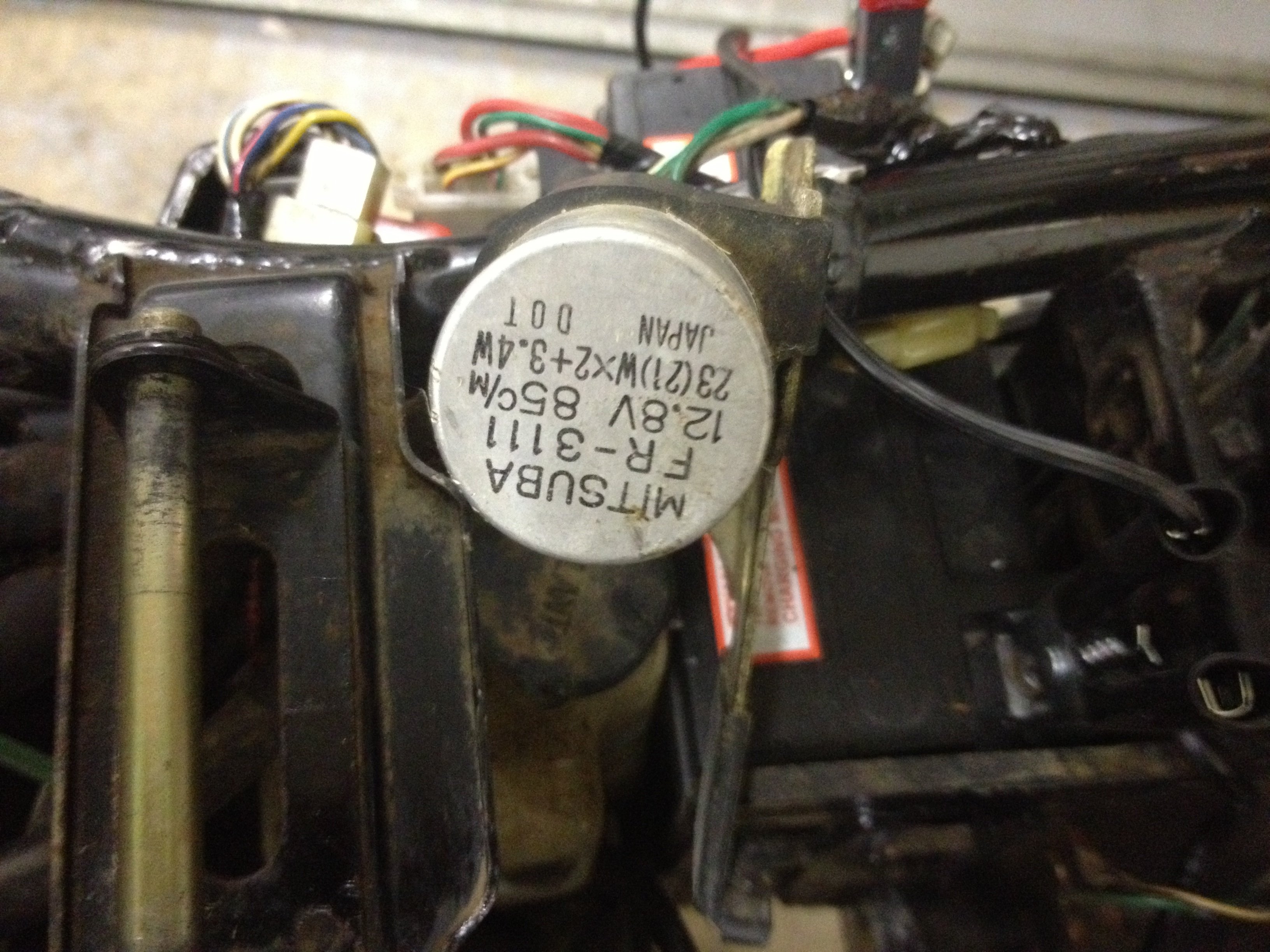

Thanks guys! I still have to rebuild the clutch slave and clear the front brake lines. Maybe a flasher for the turn signals and tach not working so some tinkering to do yet but she fires that's the big hurdle.I think I can find one of these flashers at autoZone right?

nevermind. Probably didnt need the three wire. the third wire on the magna is a ground. not needed for the new flasher.

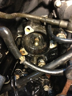

Well tore the clutch slave apart and wow!

Is this supposed to be soft rubber gasket

Not that I can remember, but I only pulled one of those a part a while back and truly wouldn't remember. If you are worried, put some yamabond on both sides and call it a day. NOT RTV...that crap should be nowhere near a motorbike. That one is just so water and dirt is kept out, not to keep fluid in.

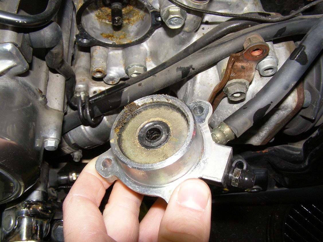

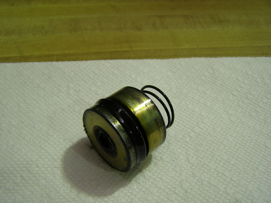

You pulled the puck out of the clutch slave correct? (like cleaning a brake caliper when you pop the pistons out to clean under them/replace seals) Again, not trying to insult your intelligence. Here's some pics of when I did it on a Super Magna last summer. You have to make sure the inside is CLEAN as can be. I dunked the piston in brake fluid before I put it back in too...I know the brake rebuild grease is better...but here it is, works great. There should of course be some resistance as you should be pushing the rod into the clutch plates. Next step could be breaking the plates free, as they may have stuck them selves together over the time they sat. Usually just running the bike for a bit will get a "slightly" stuck set to let go. Holding the clutch in, and putting it in gear will also help with this (still hold the clutch lever)
