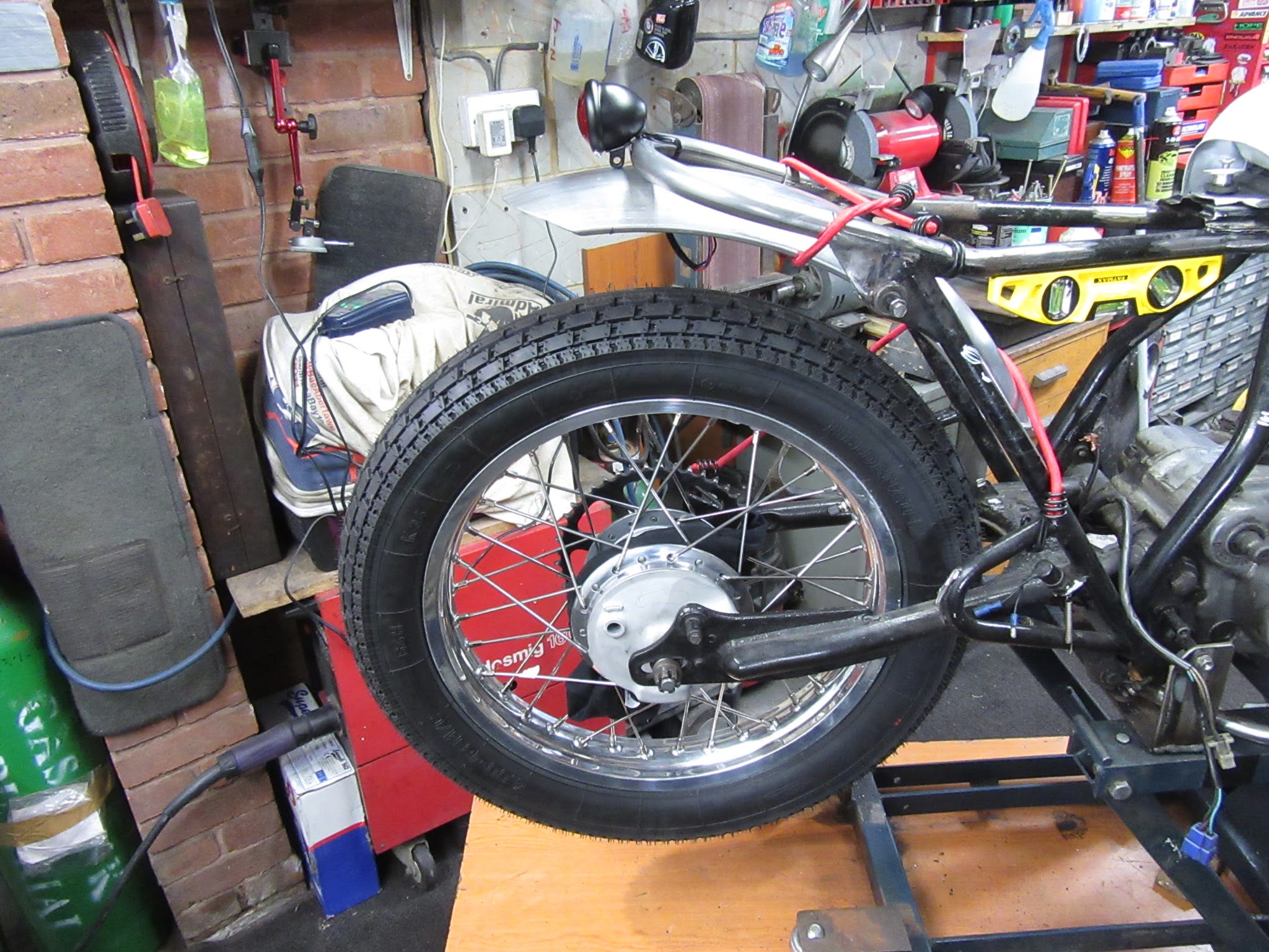

Step aside Moto Guzzi...........Yamaha SR250 coming through :-)

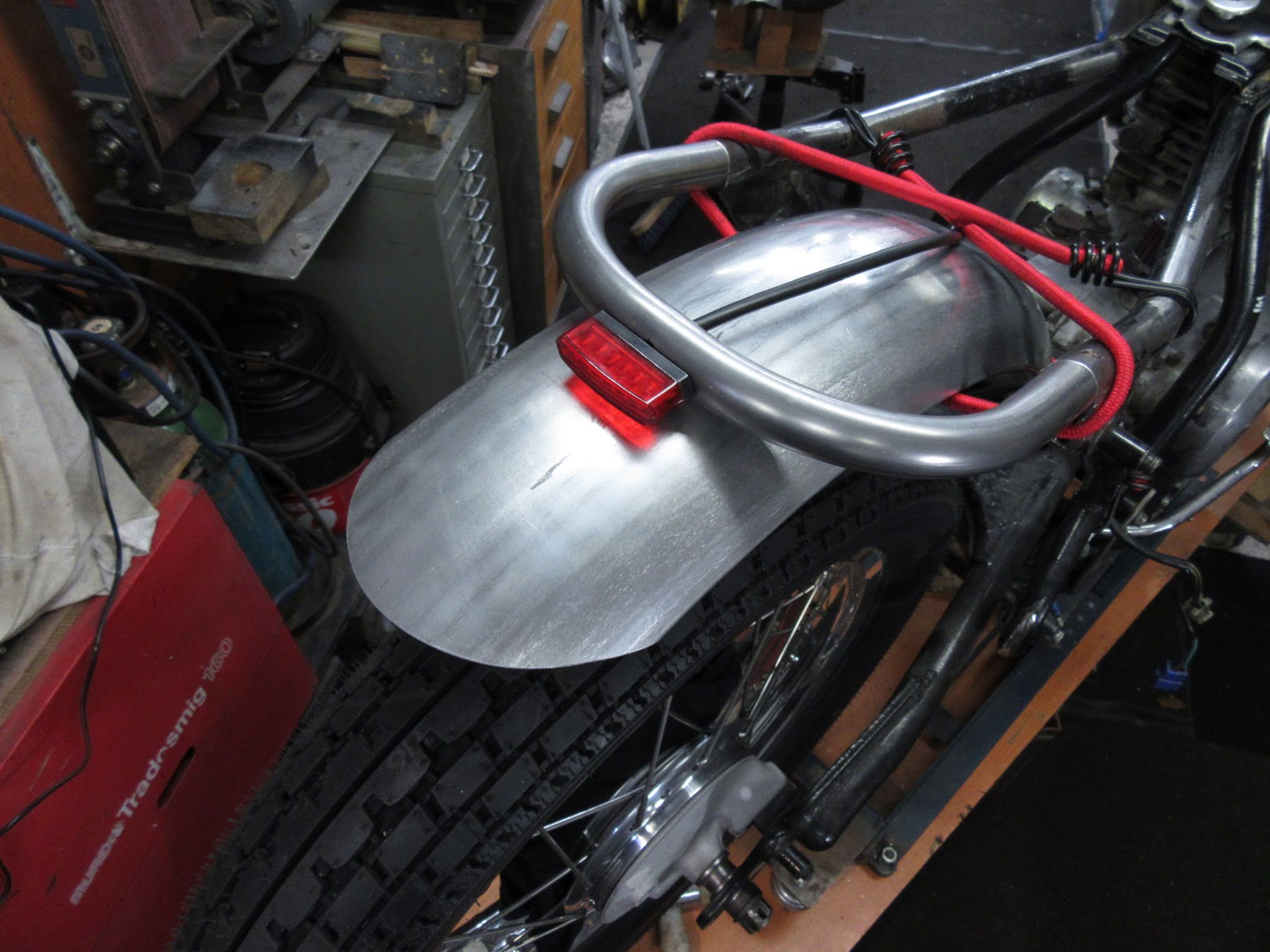

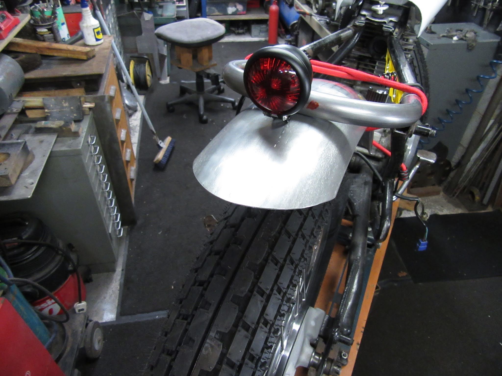

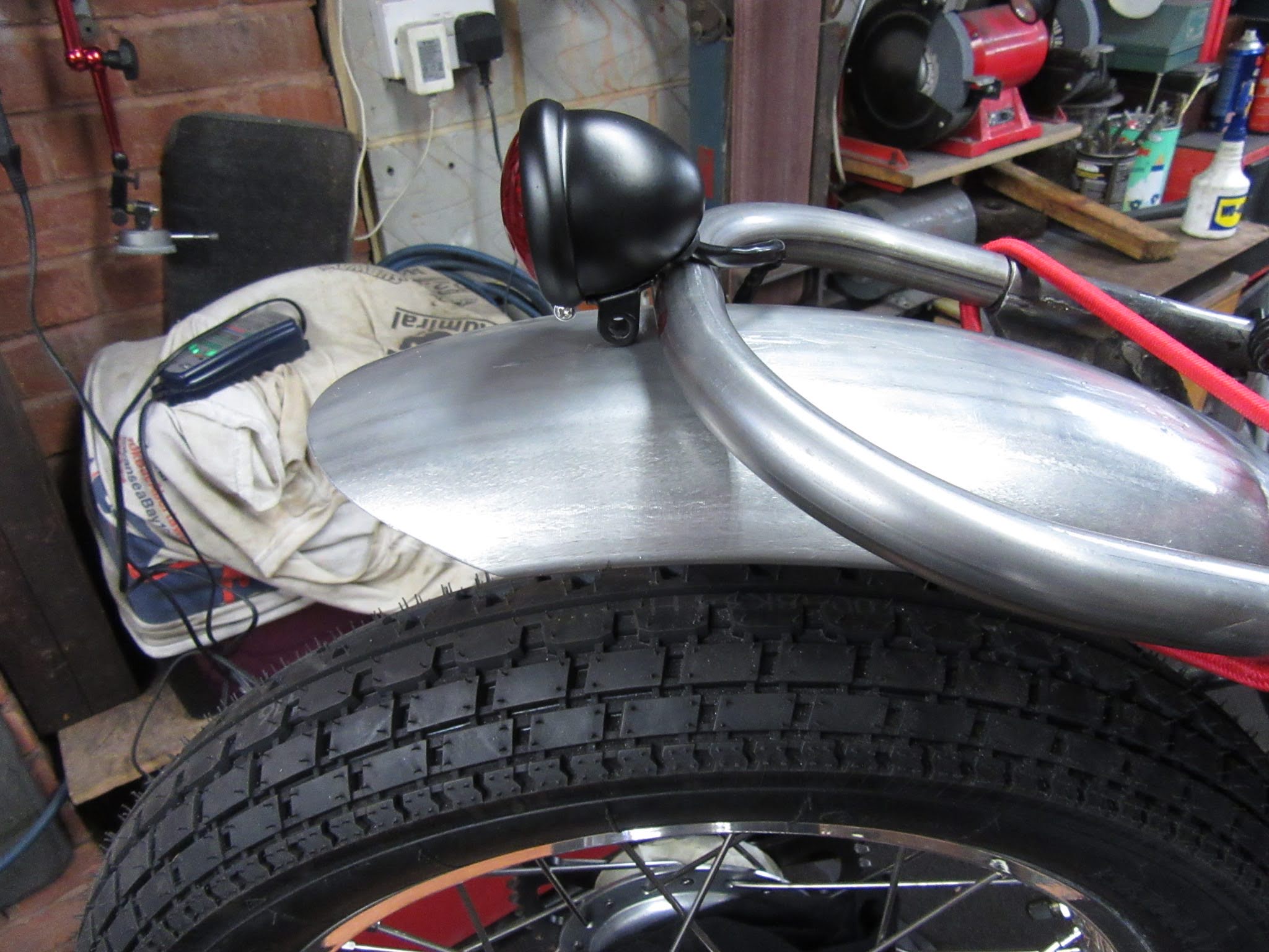

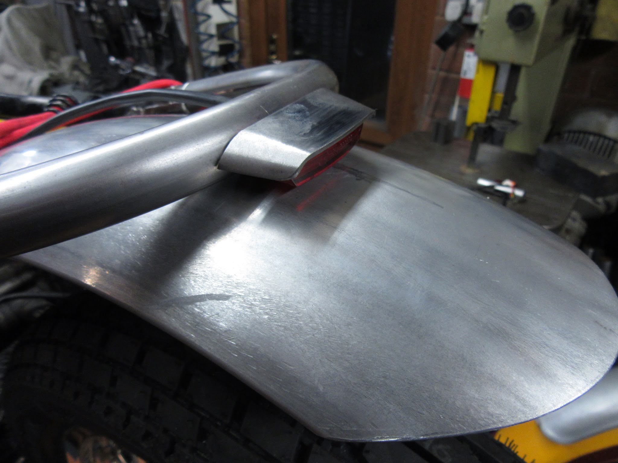

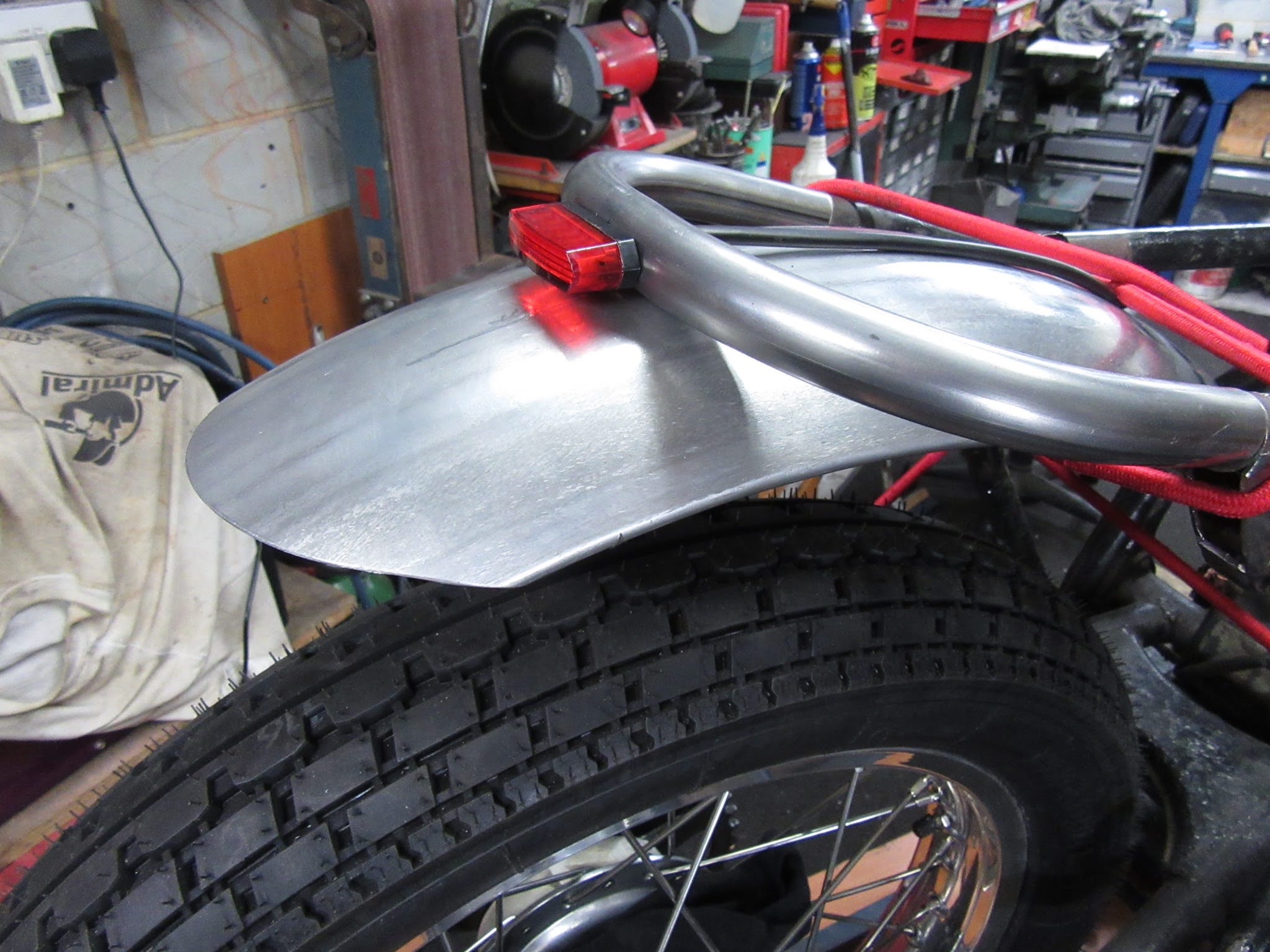

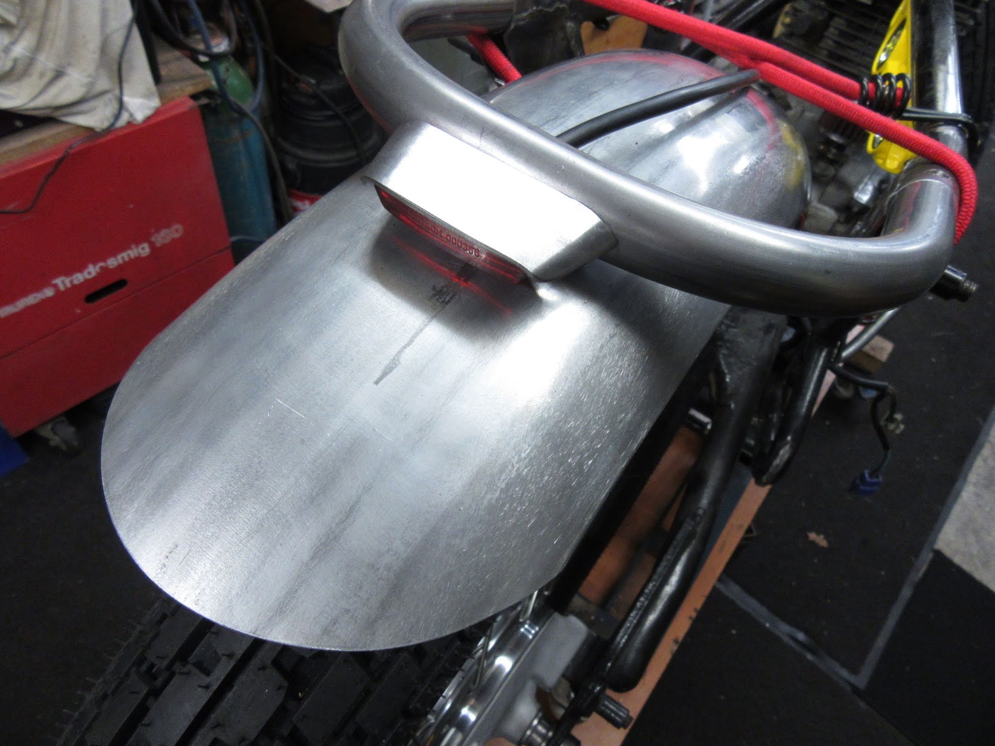

Then spent another few hours scratching my head with the rear light...............trying this trying that, different postions.......no wonder these projects take so much time. Decided to ditch the round one in favour of the small square one I picked up. The round one was a bit too chopper/bobber looking for me.......just need to work out where the number plate will live now :rolleyes:

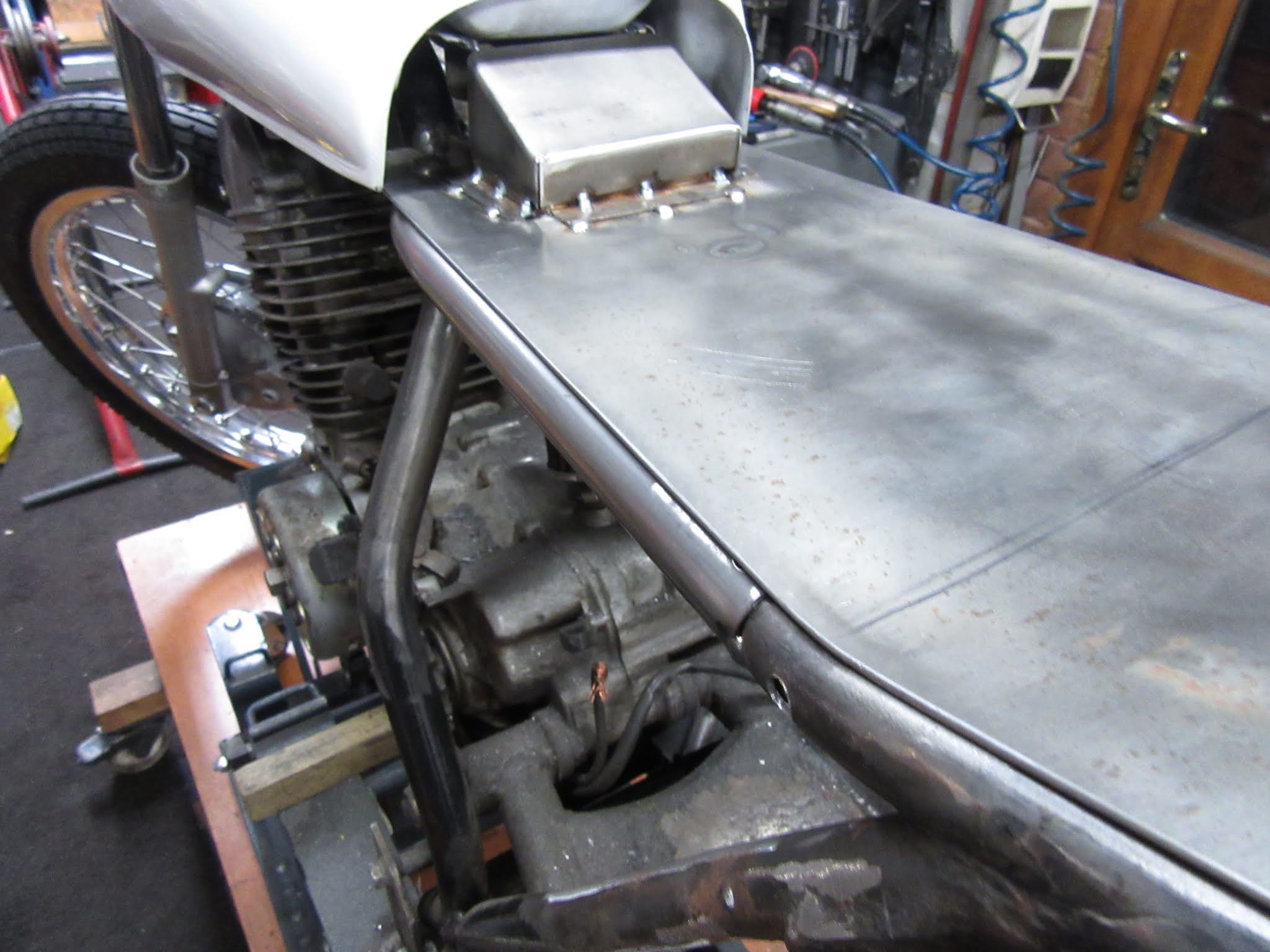

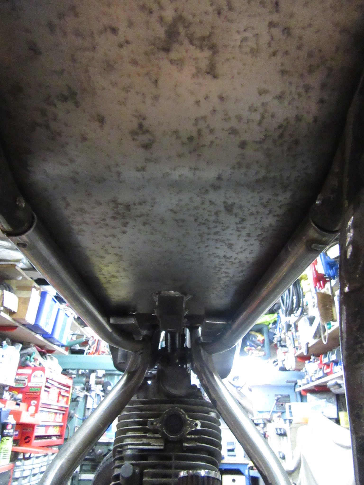

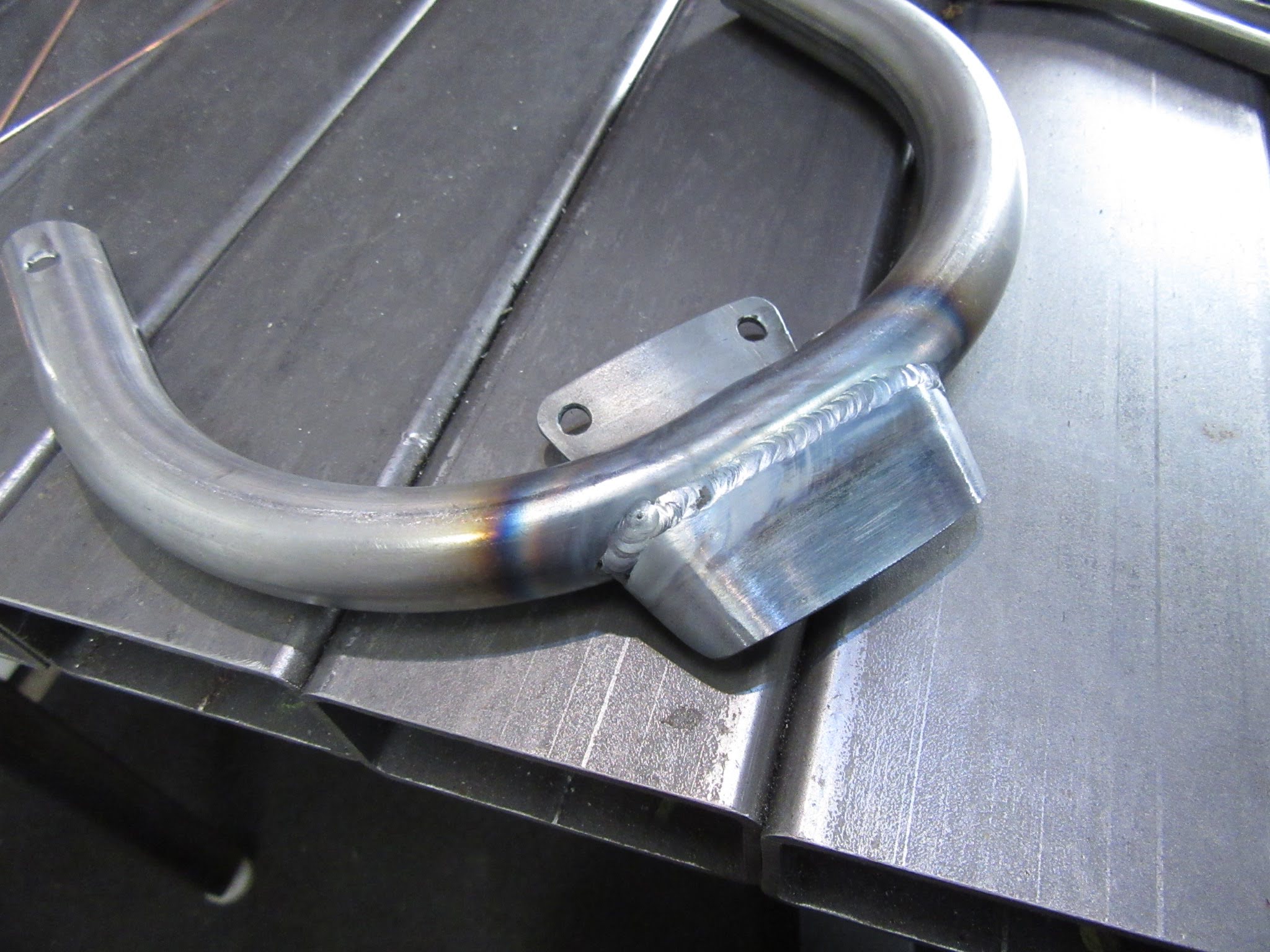

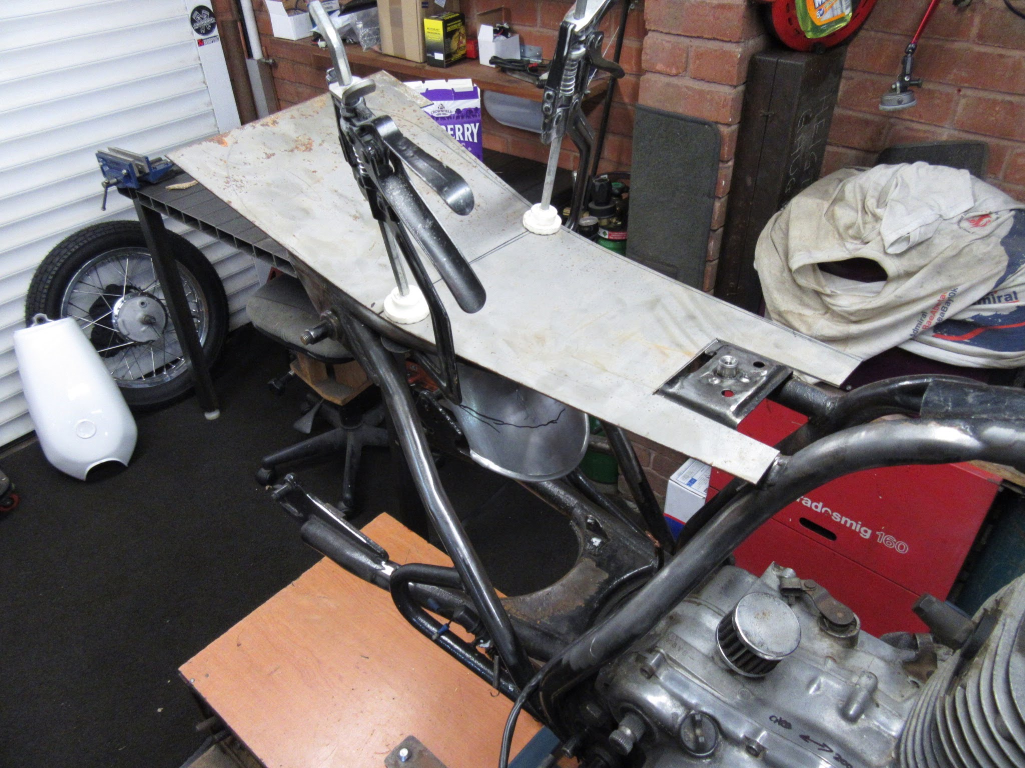

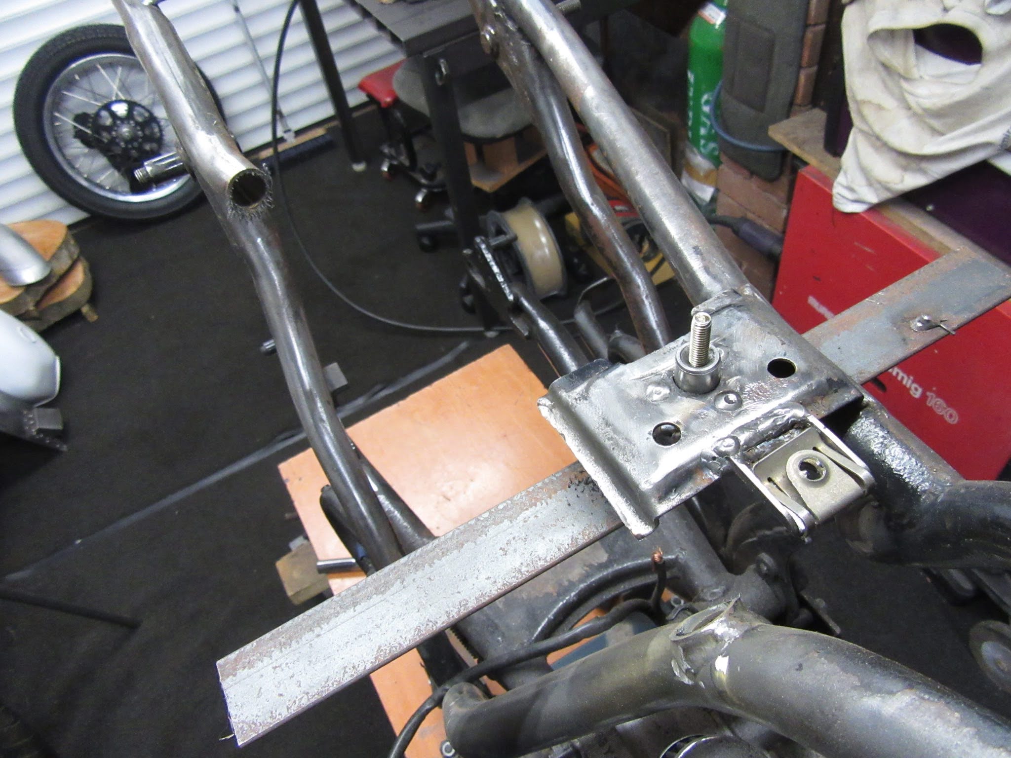

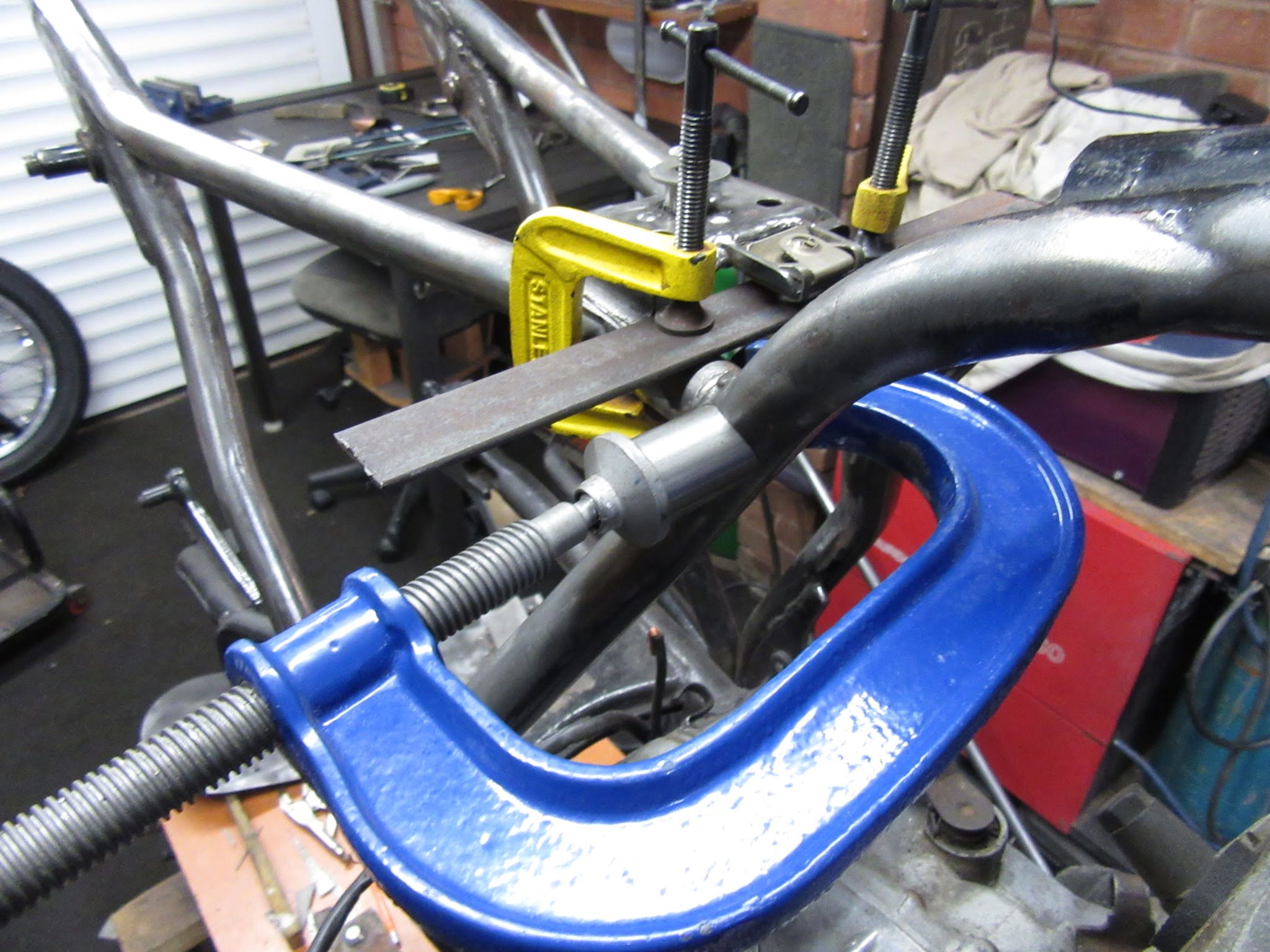

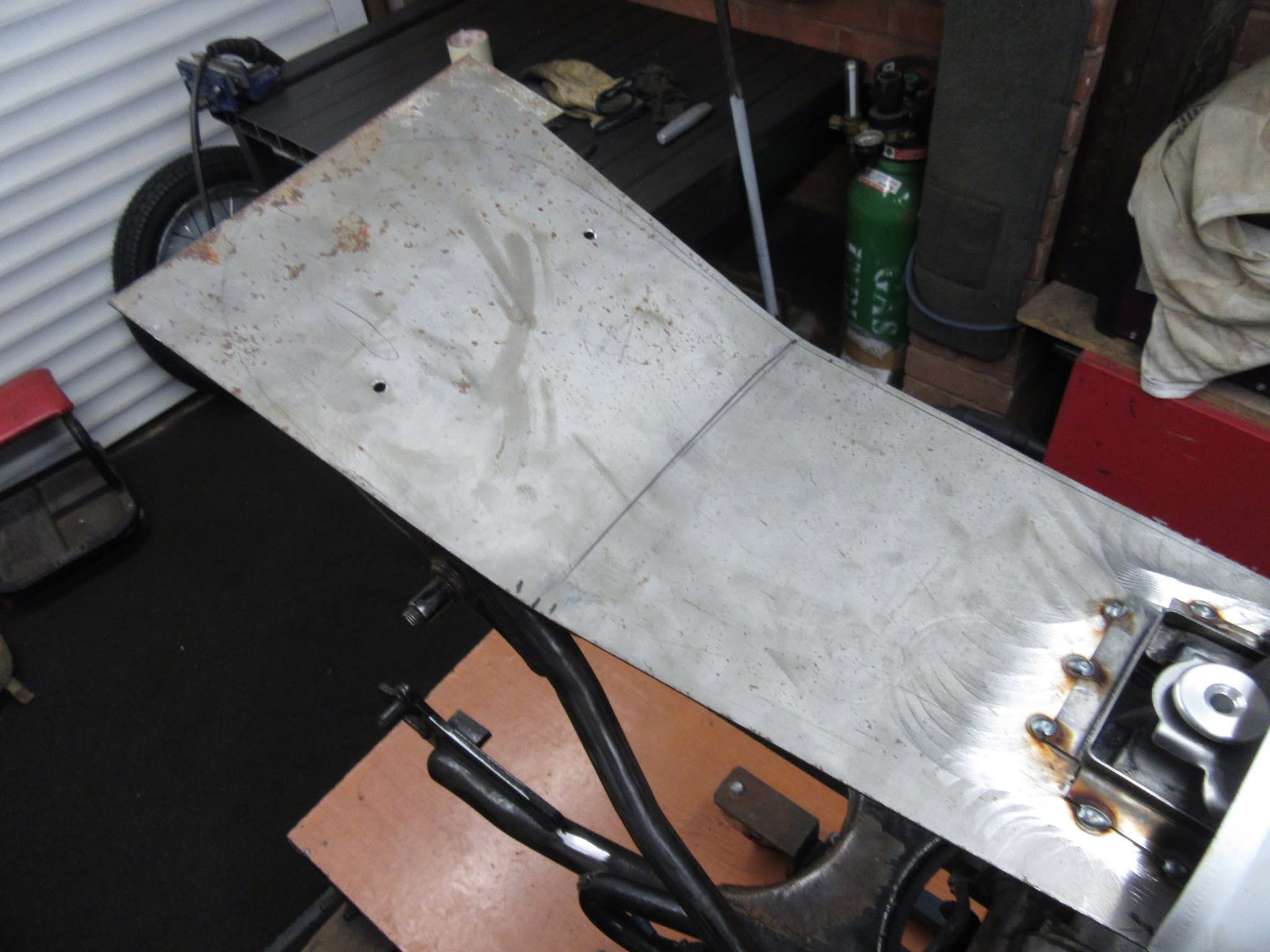

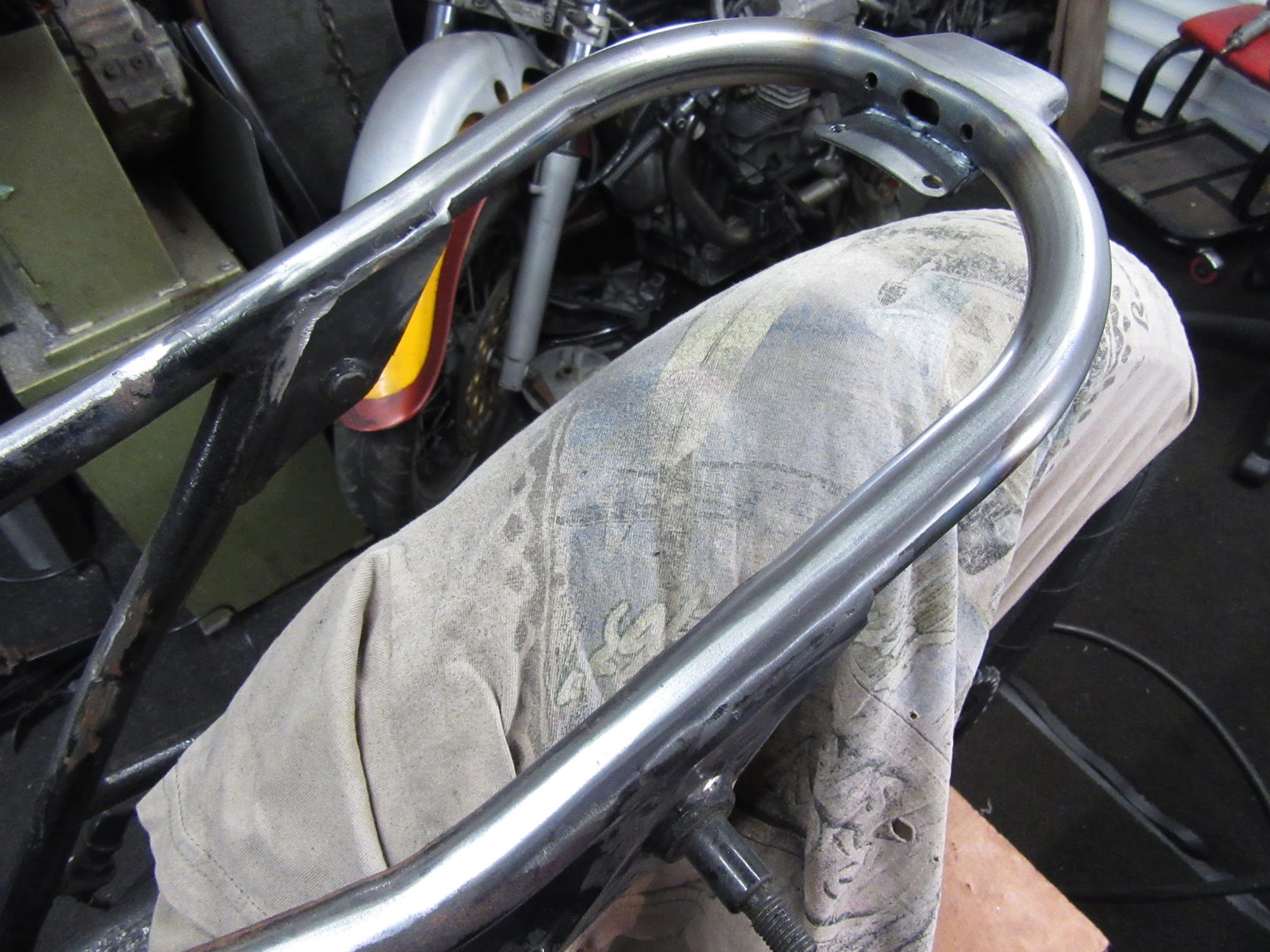

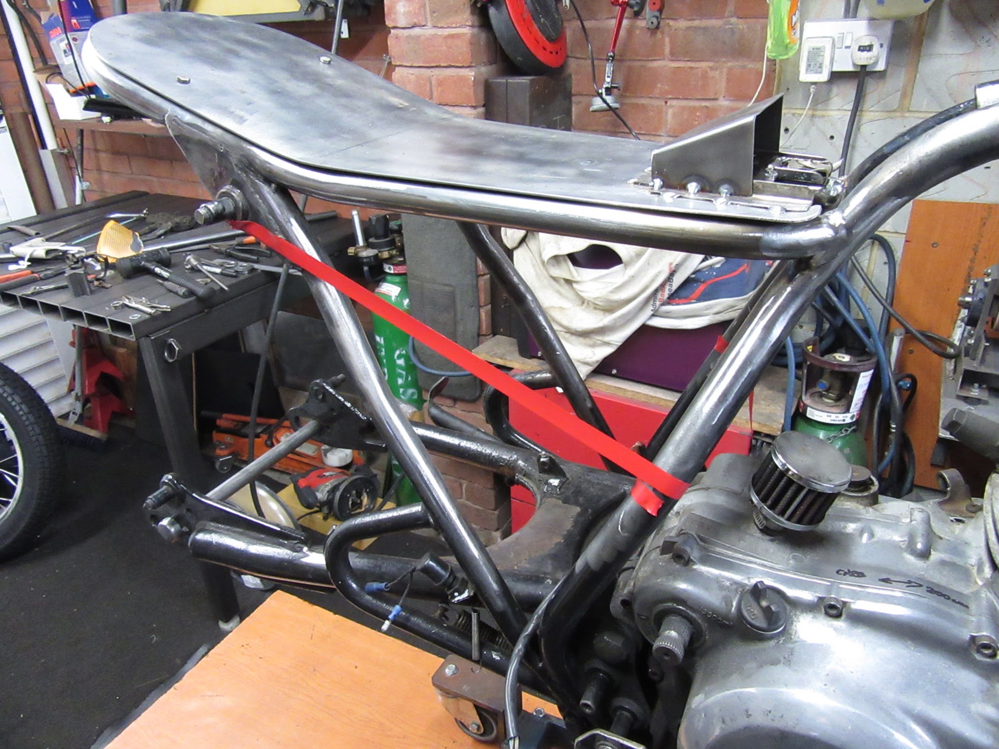

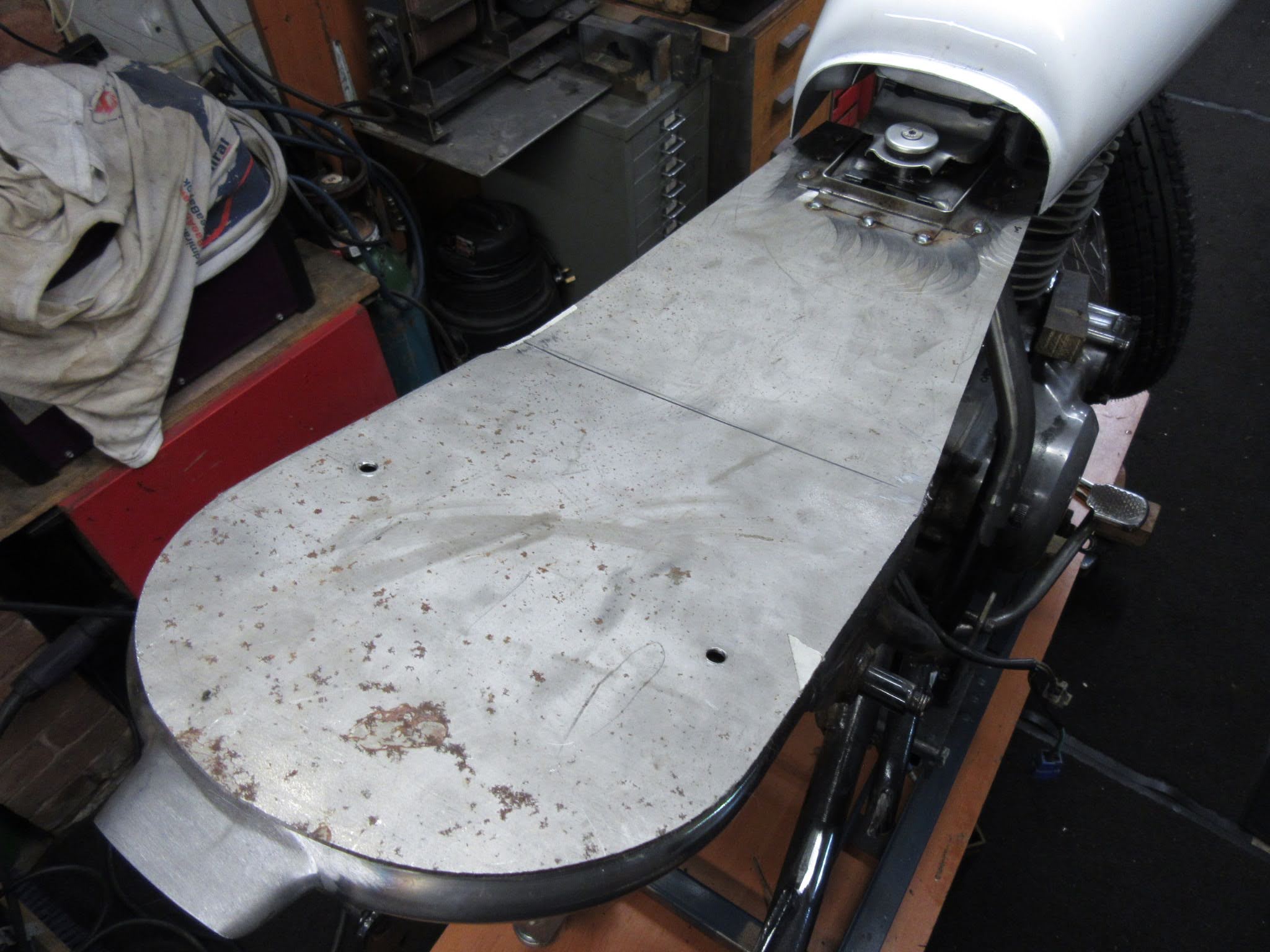

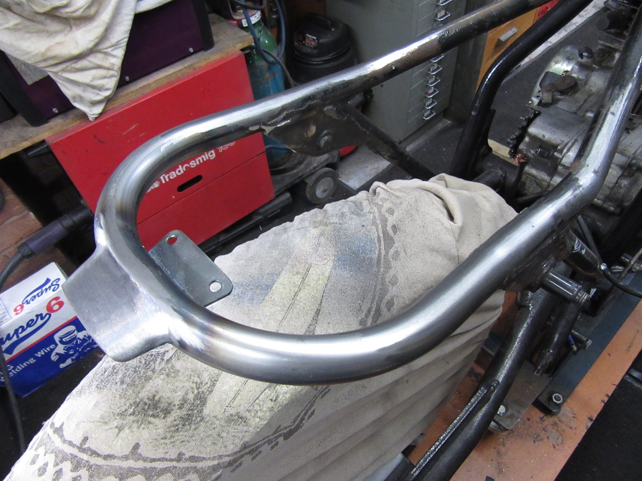

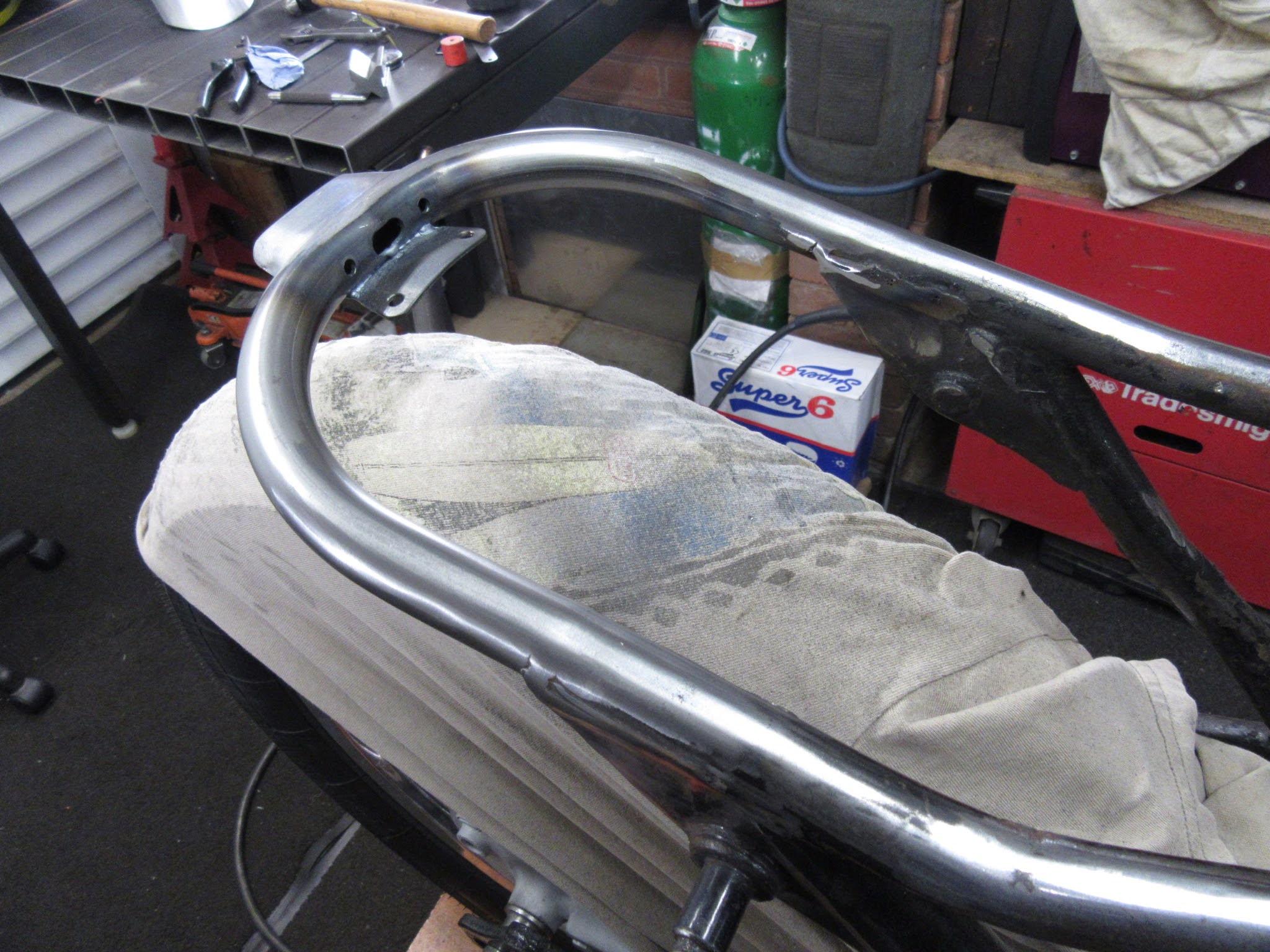

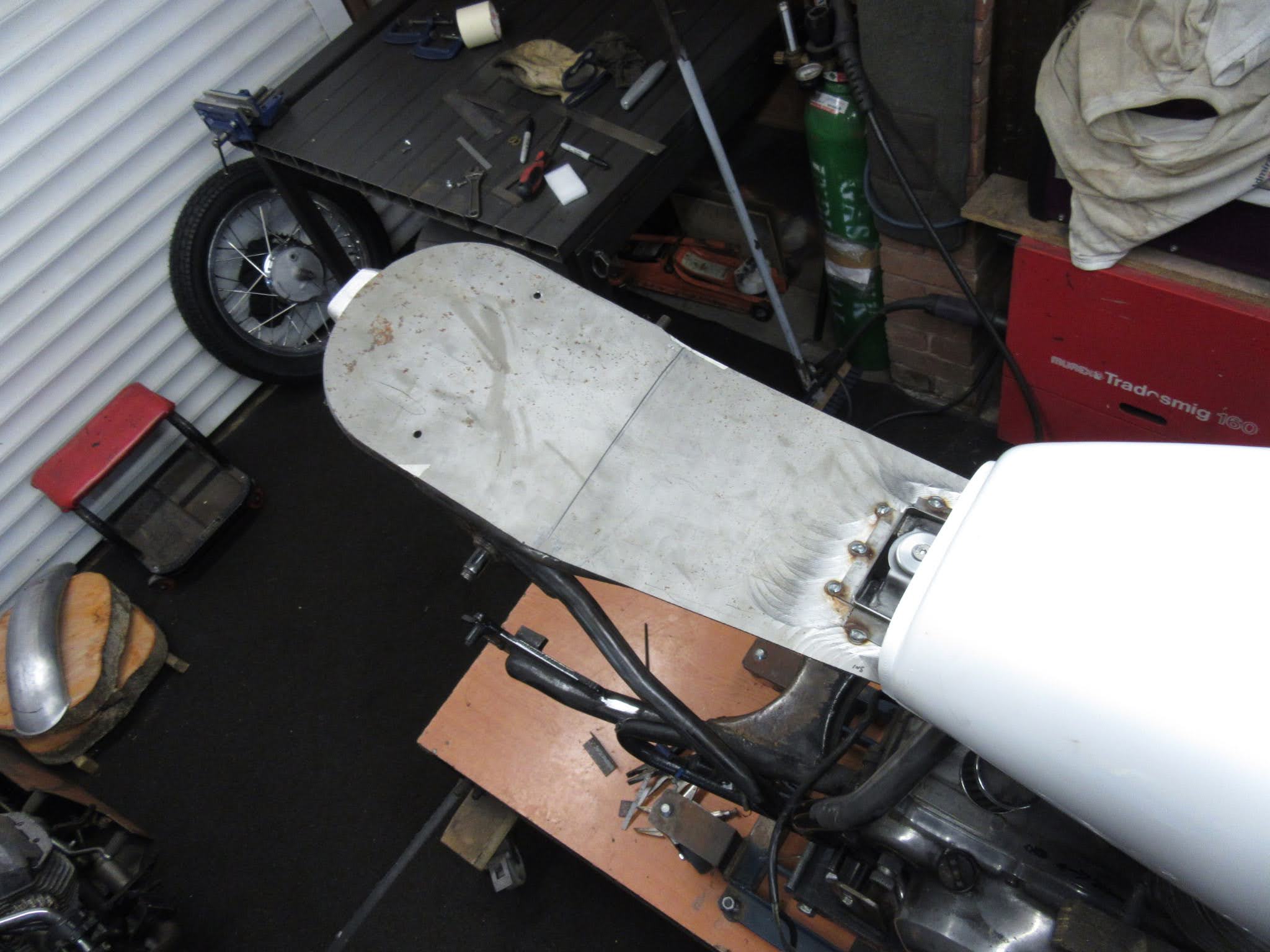

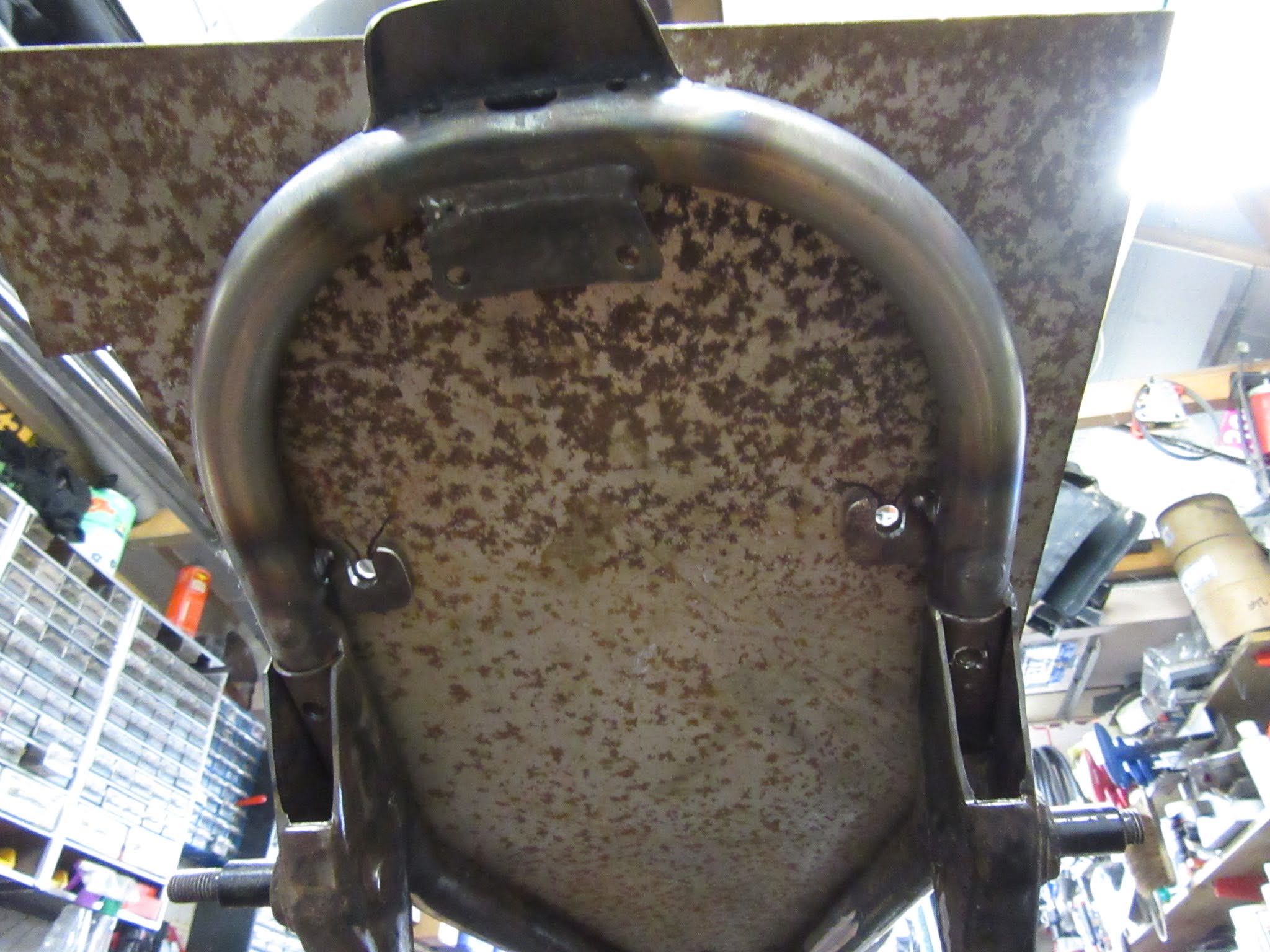

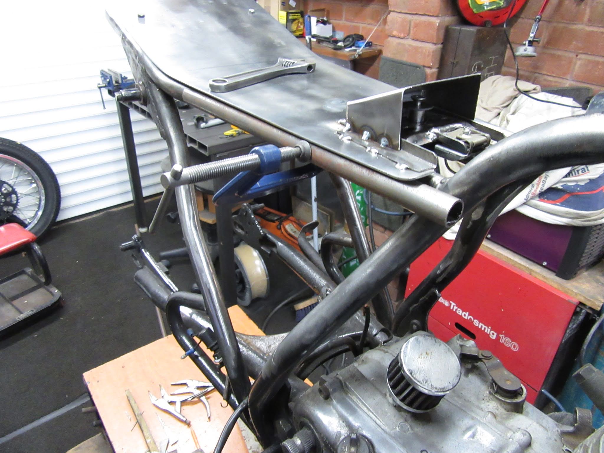

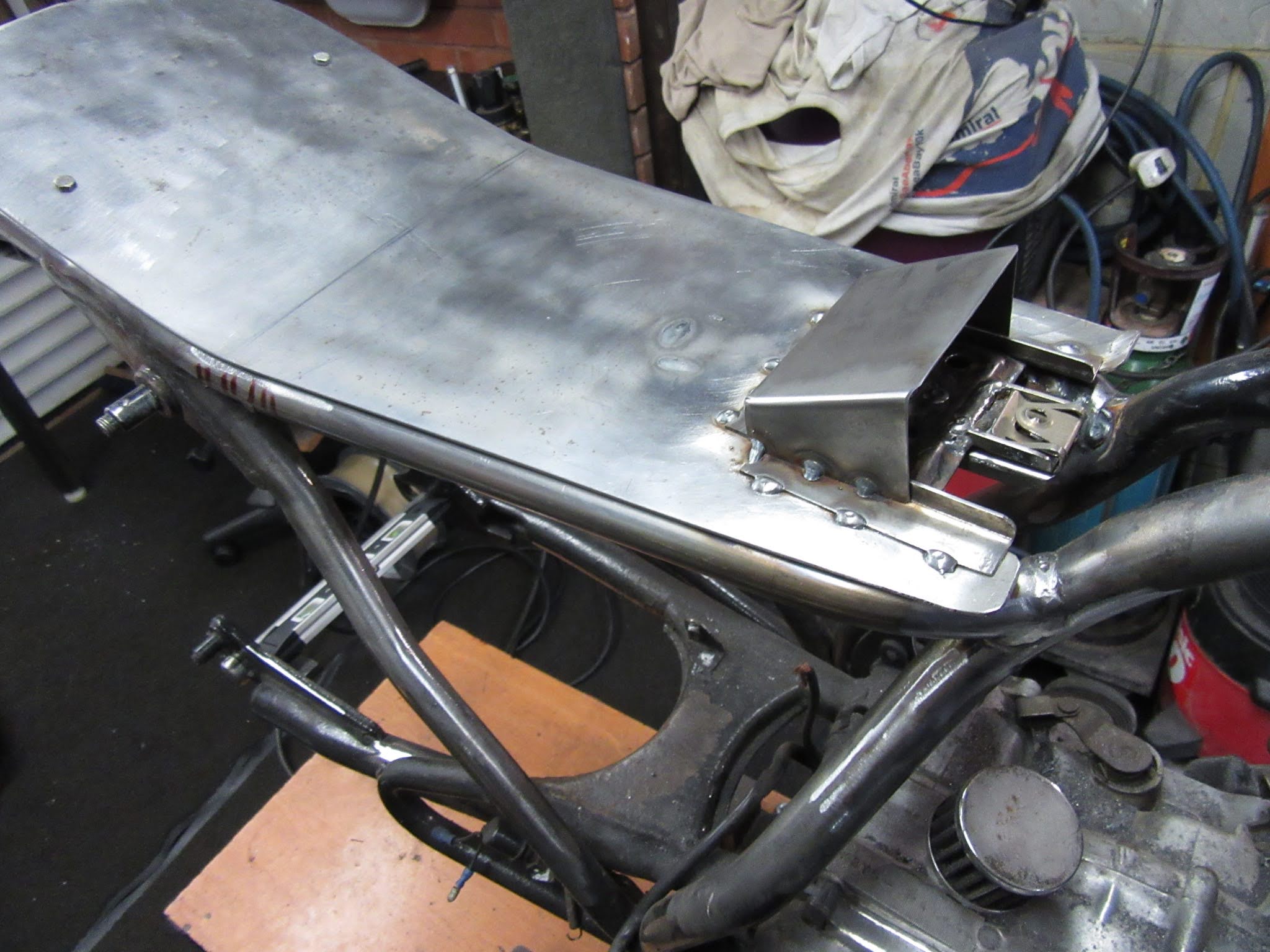

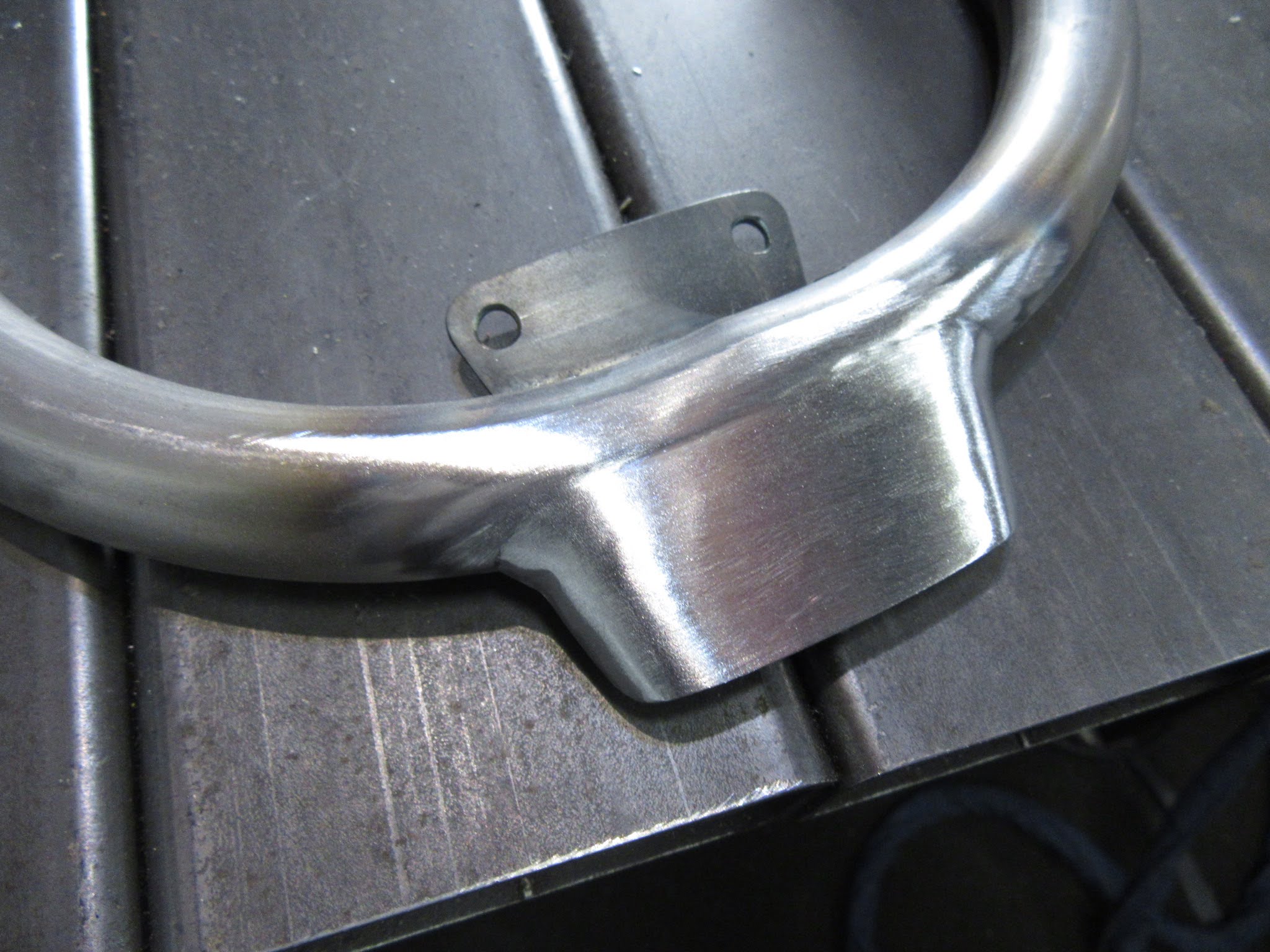

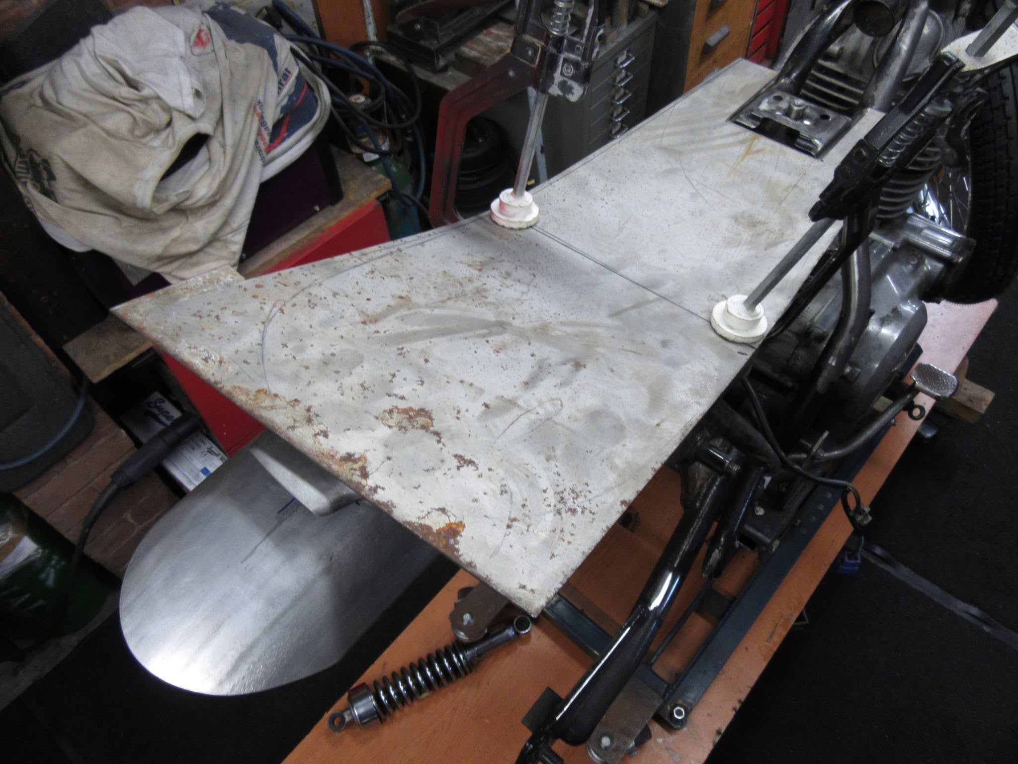

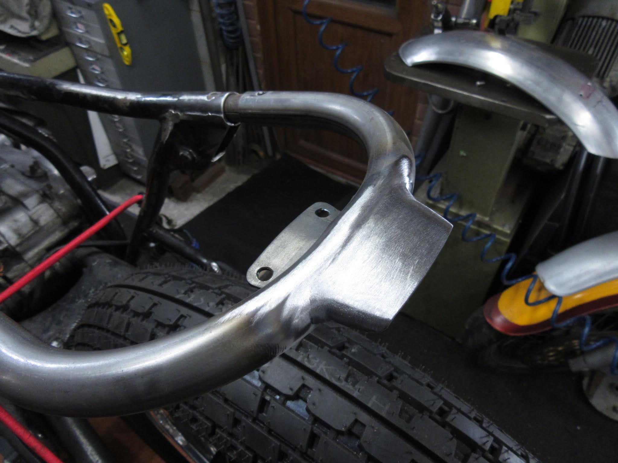

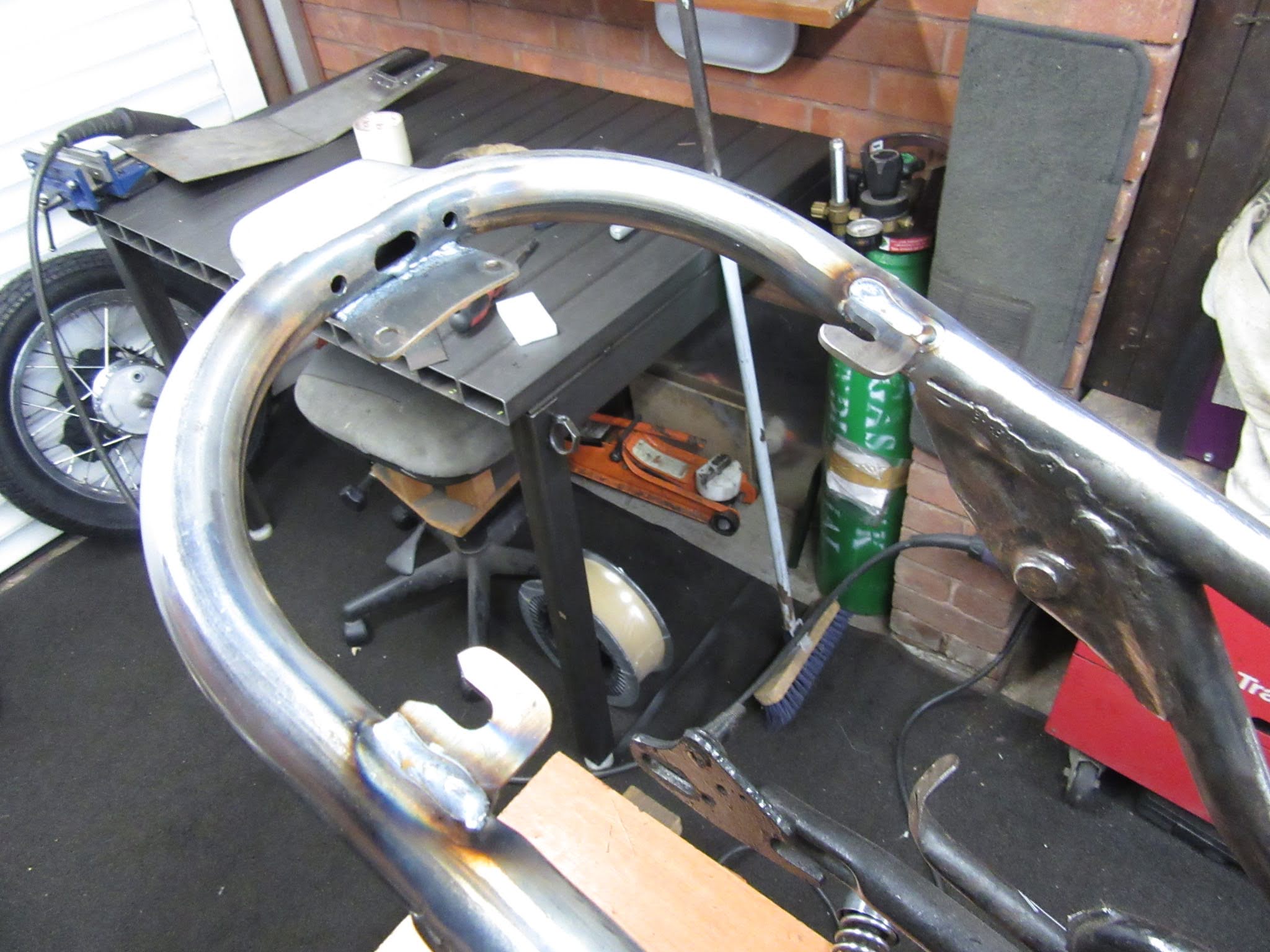

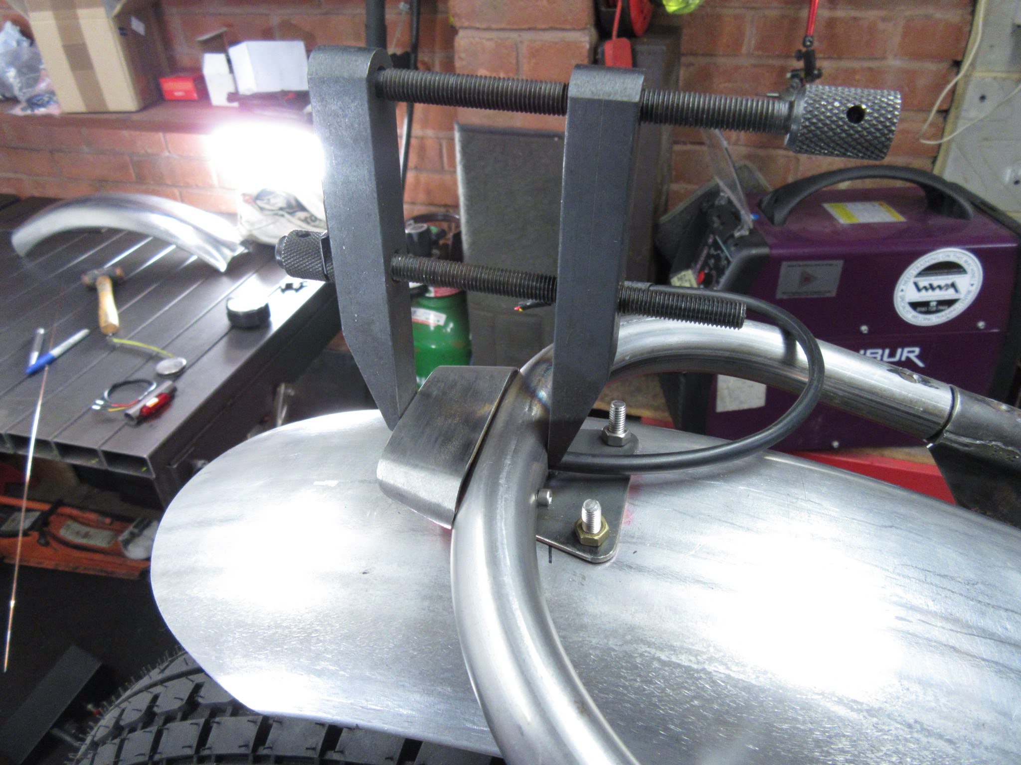

Ive been mostly working on the seat and pan trying to get it to fit nicely in with the CG125 tank. Ive managed to get the hoop welded in, and blended along with the rear tail lamp eyelid.

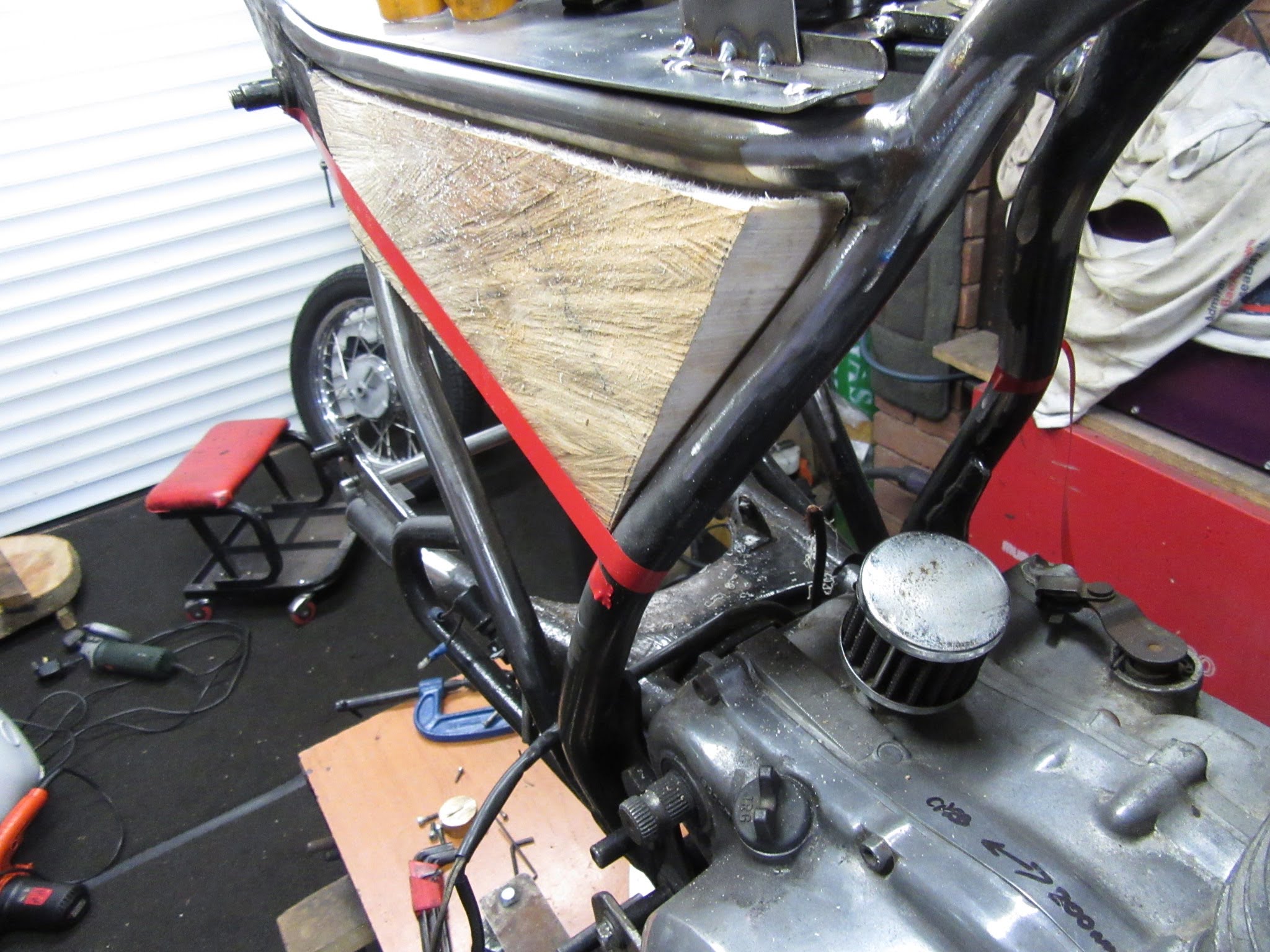

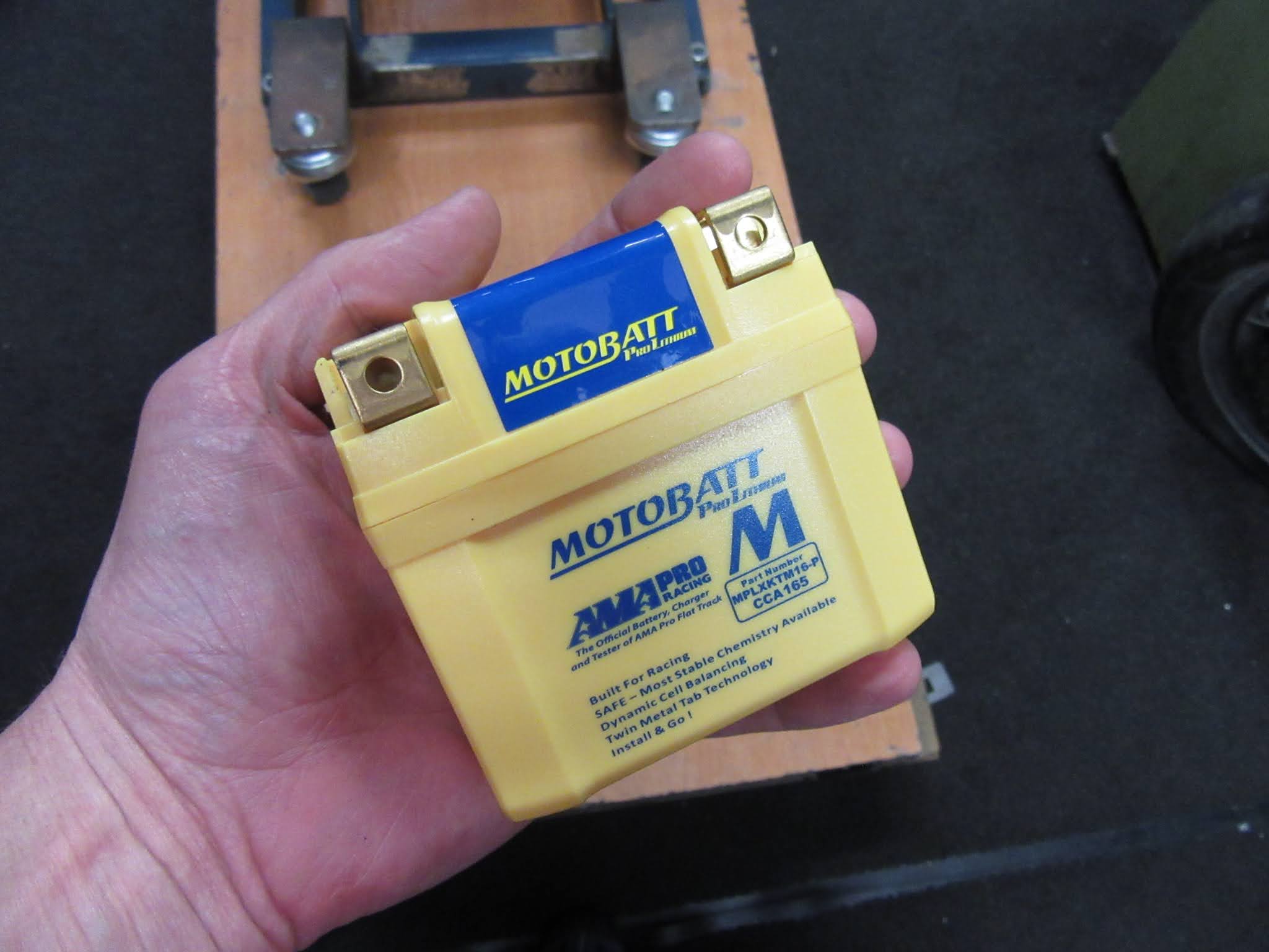

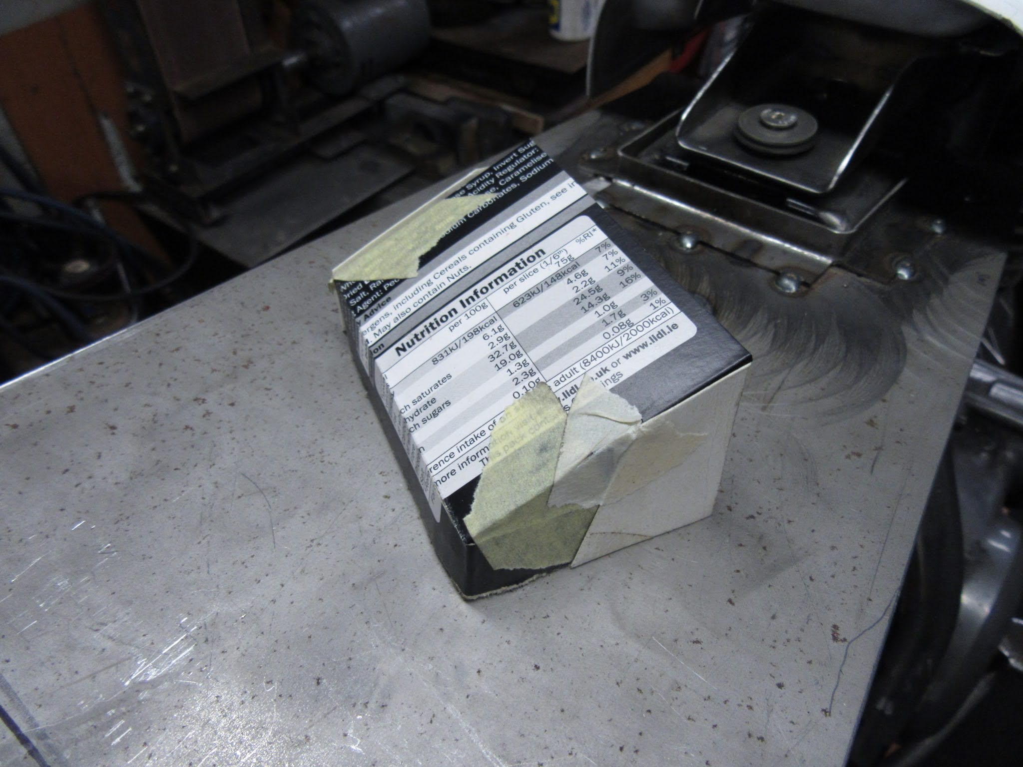

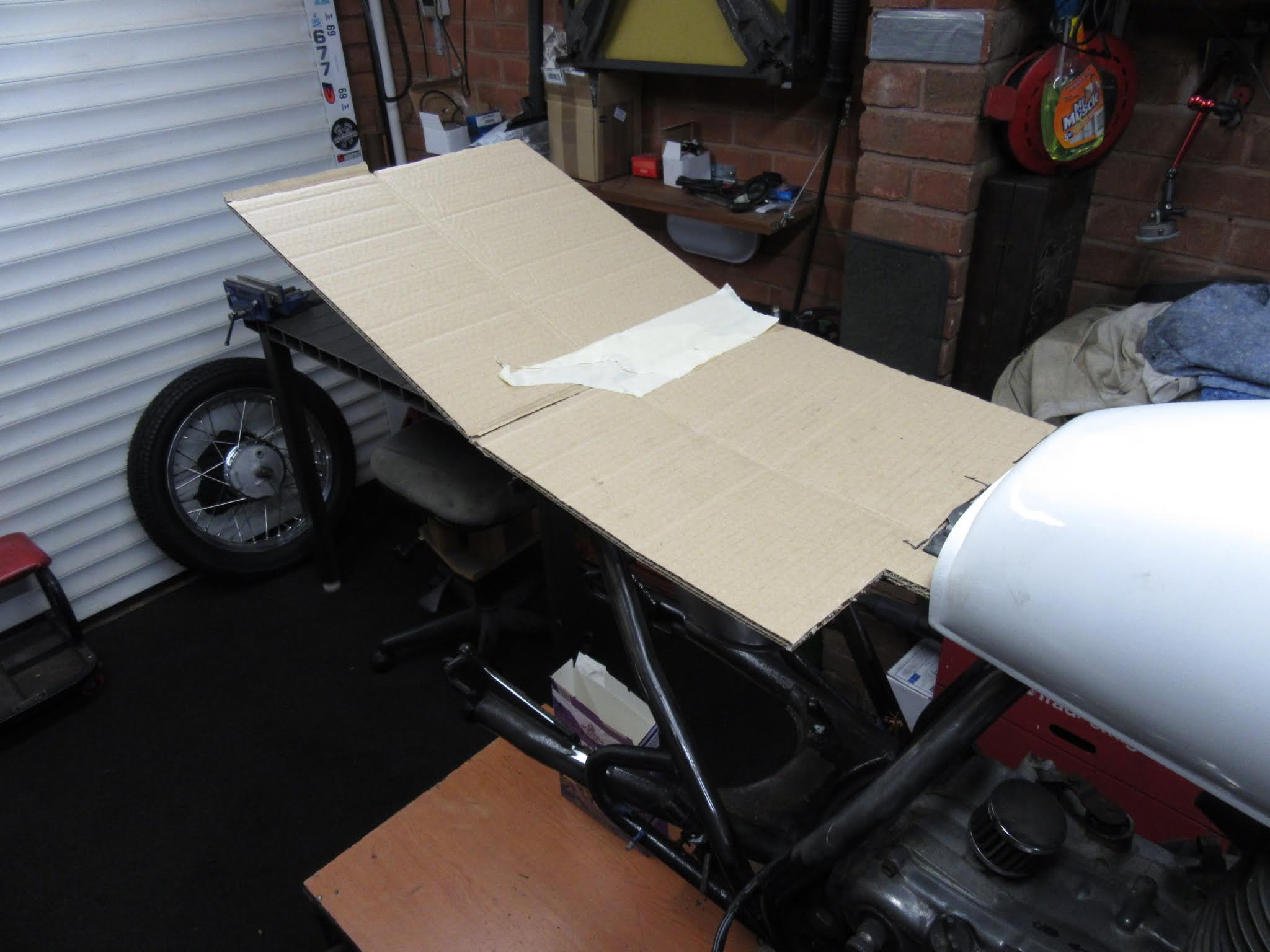

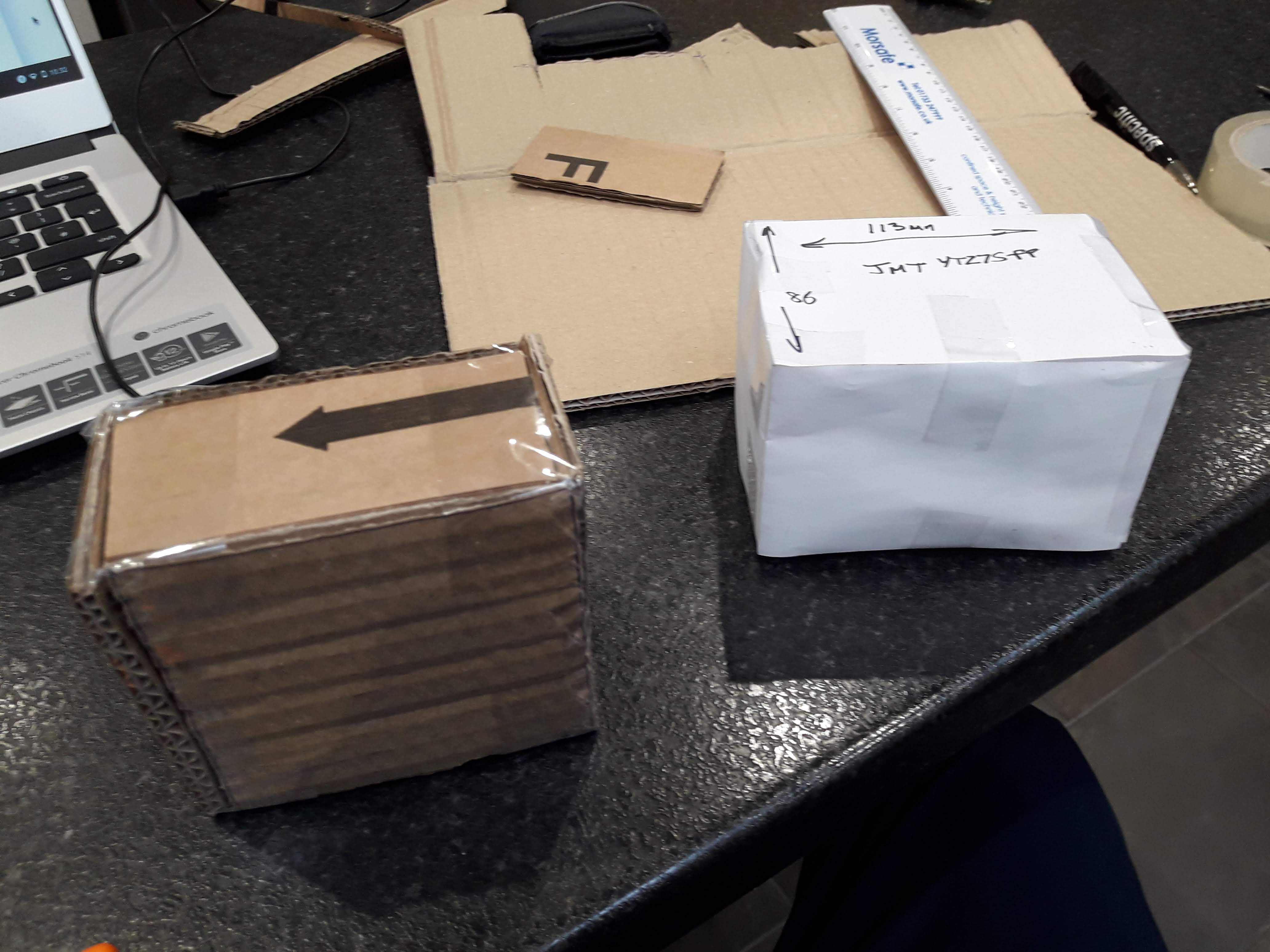

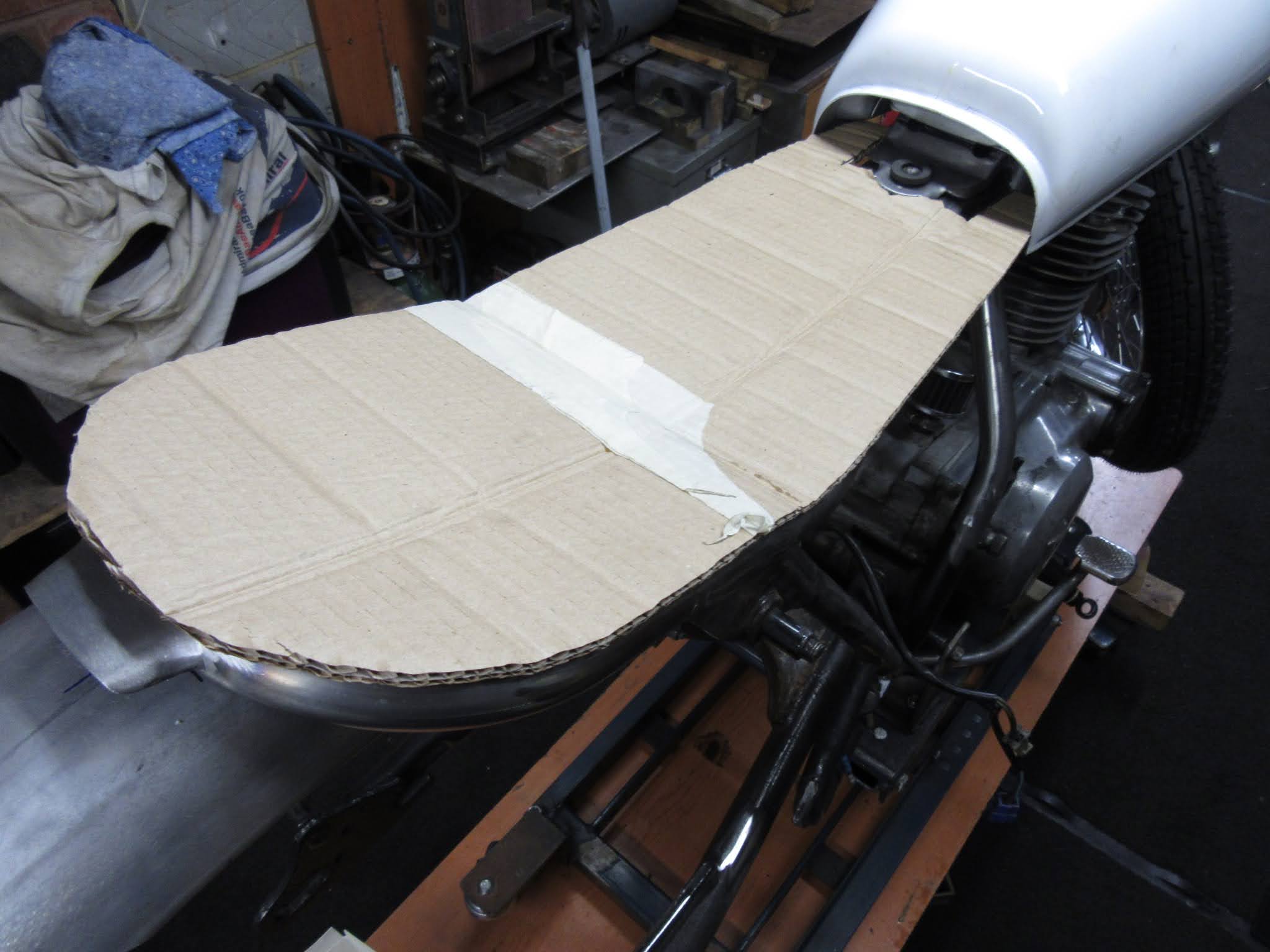

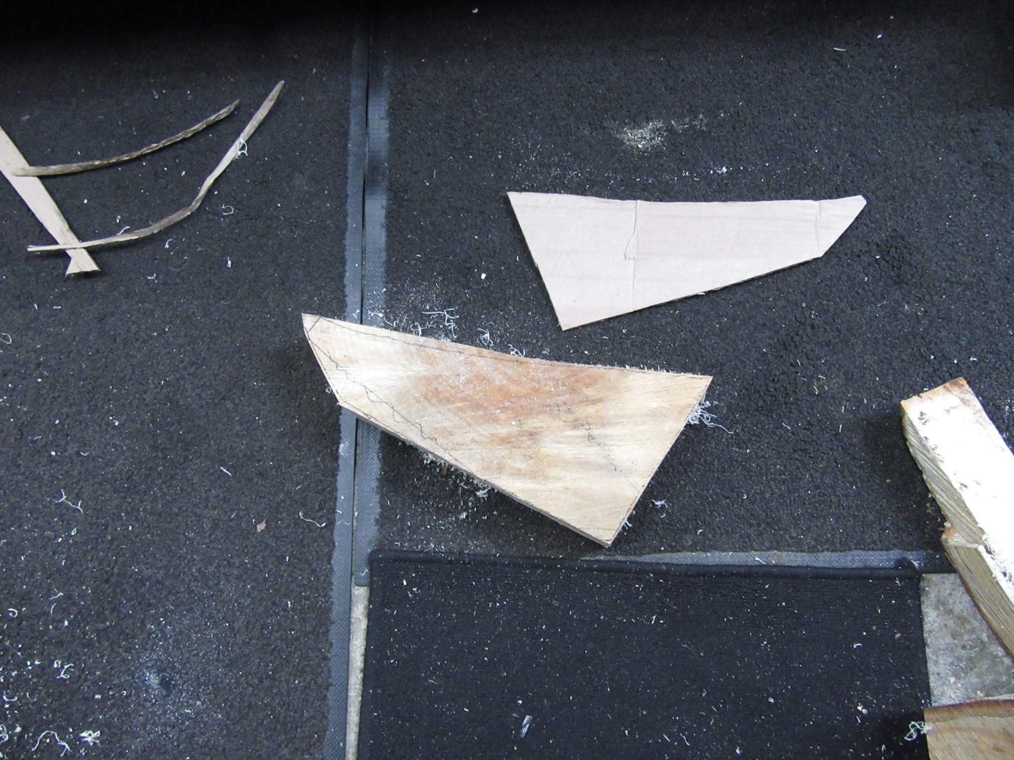

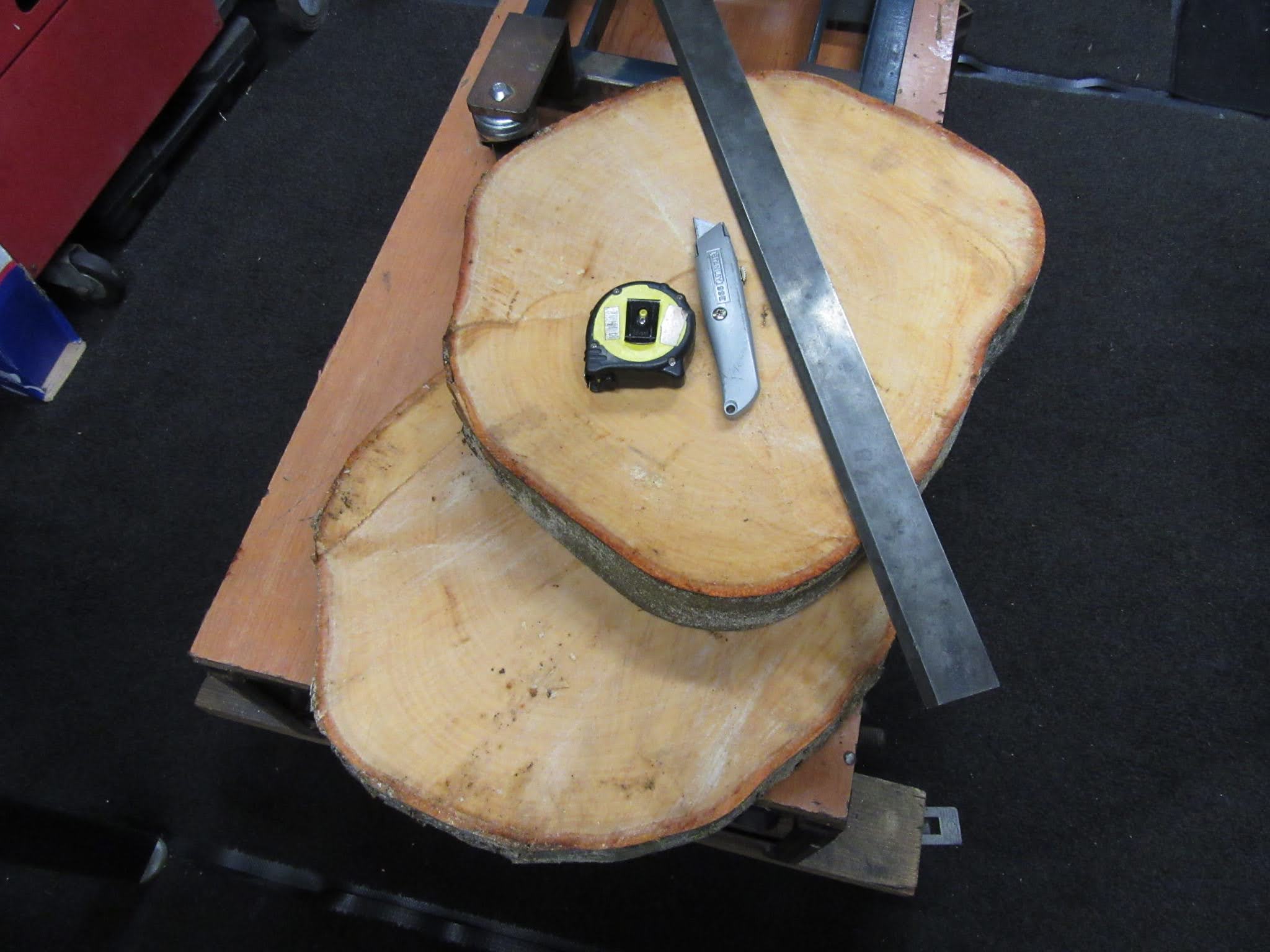

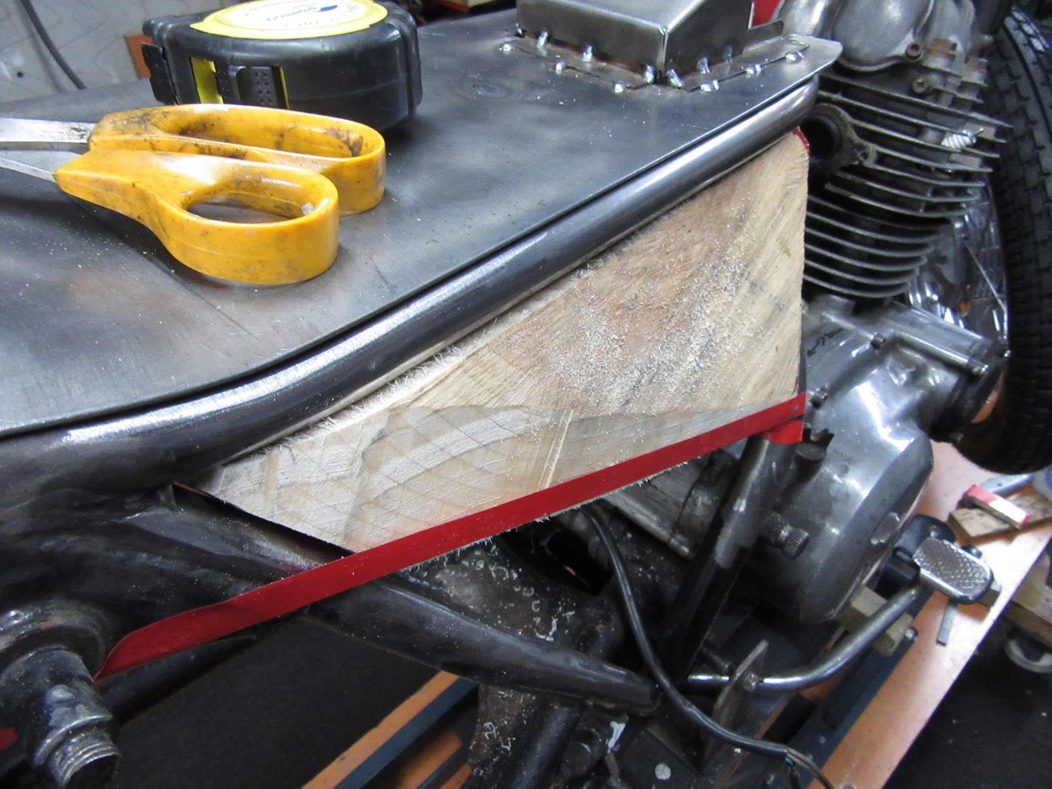

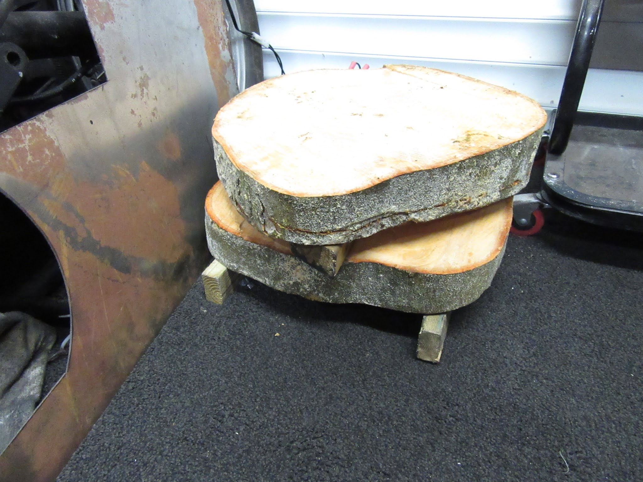

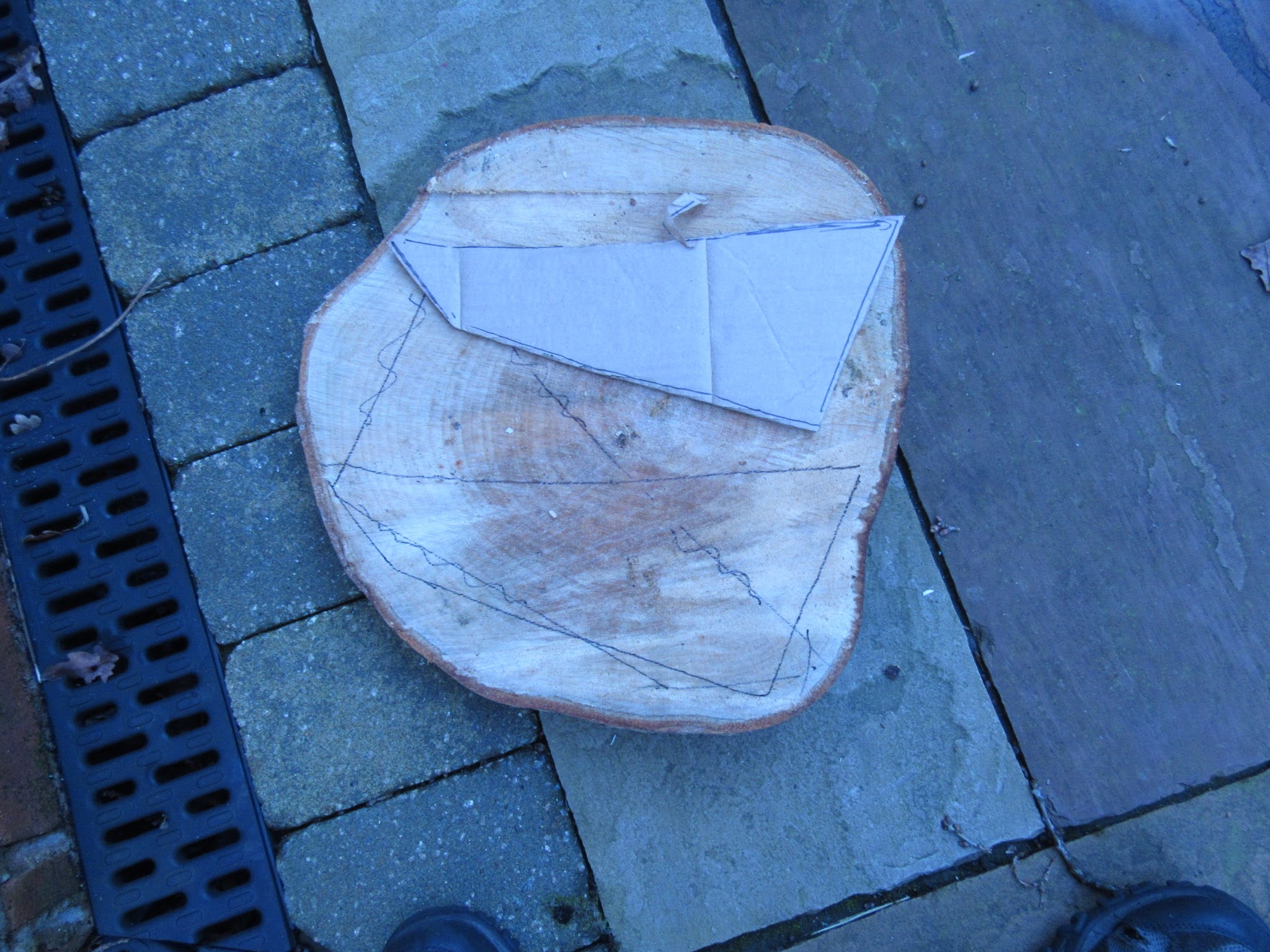

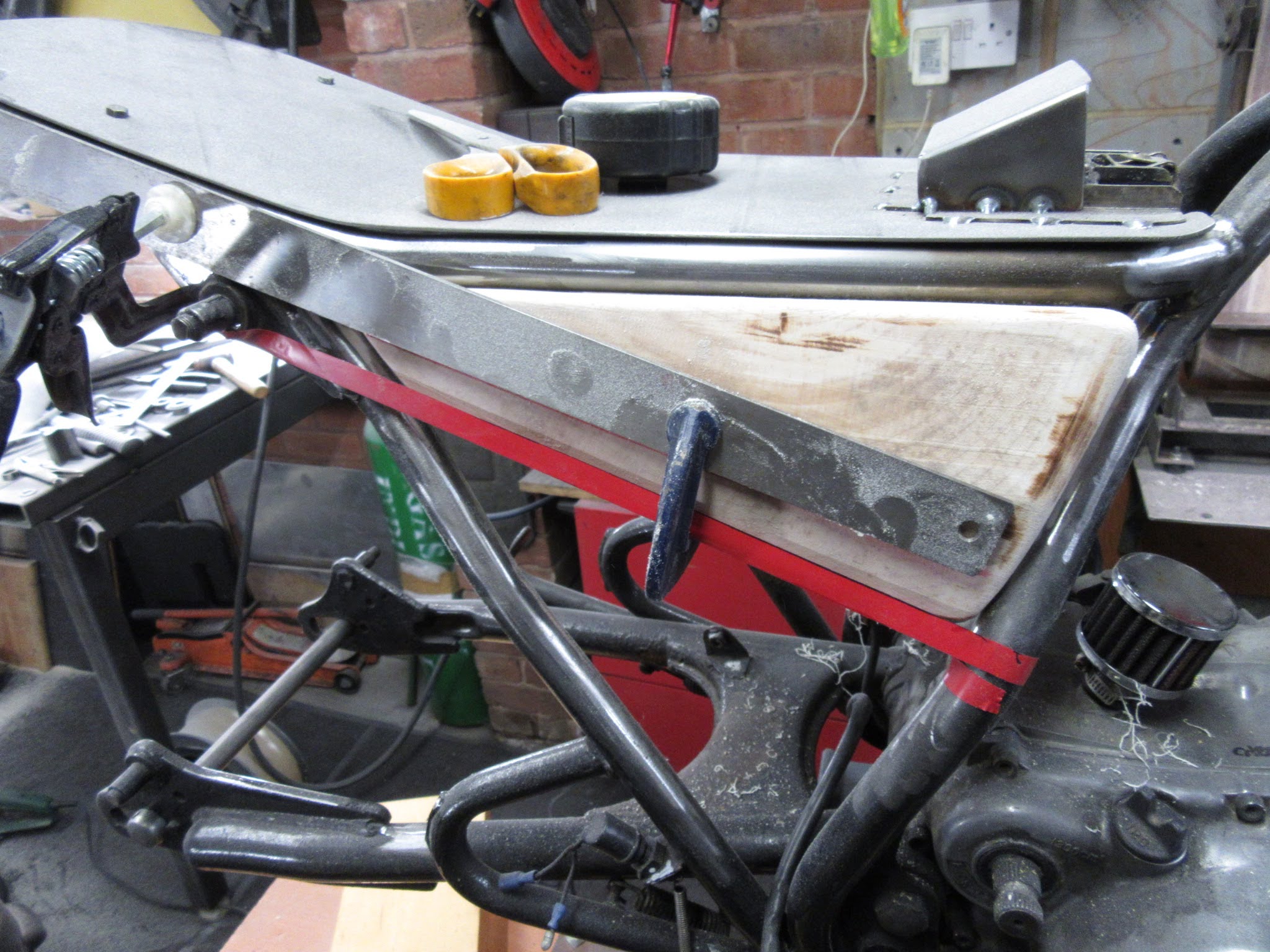

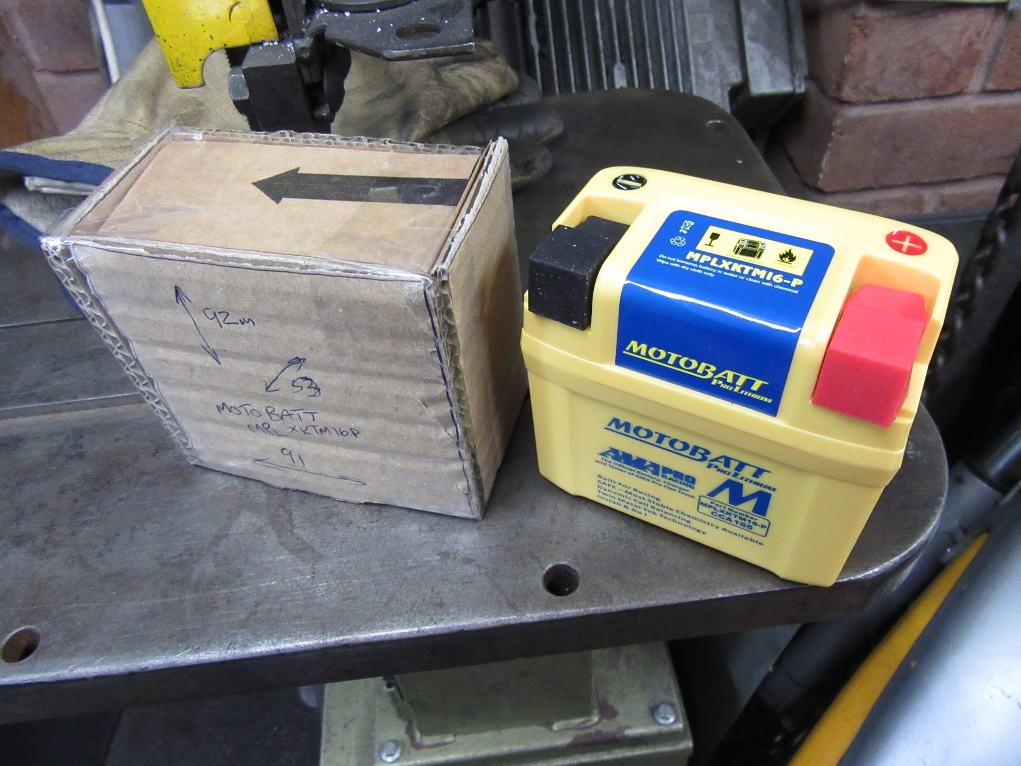

Fired up my CAD (cardboard aided design :D) system to make up a mockup battery to get an idea of the compartment where its going to live. This will influence the seat design, and shape of the pan. Ive gone all organic in this upload, and also acquired some nice slabs of Ash from the local tree surgeon..........Im going to attempt to make some forms and try my hand at making some side panels........that's going to be a first for me. Not going for the open triangle look on this one, so need to fill the hole with something....................suppose I could just fill it with wood for the classic Riva Aquarama look:laughing:

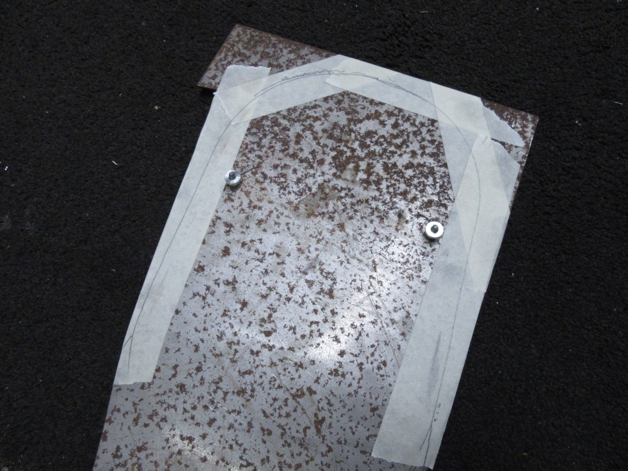

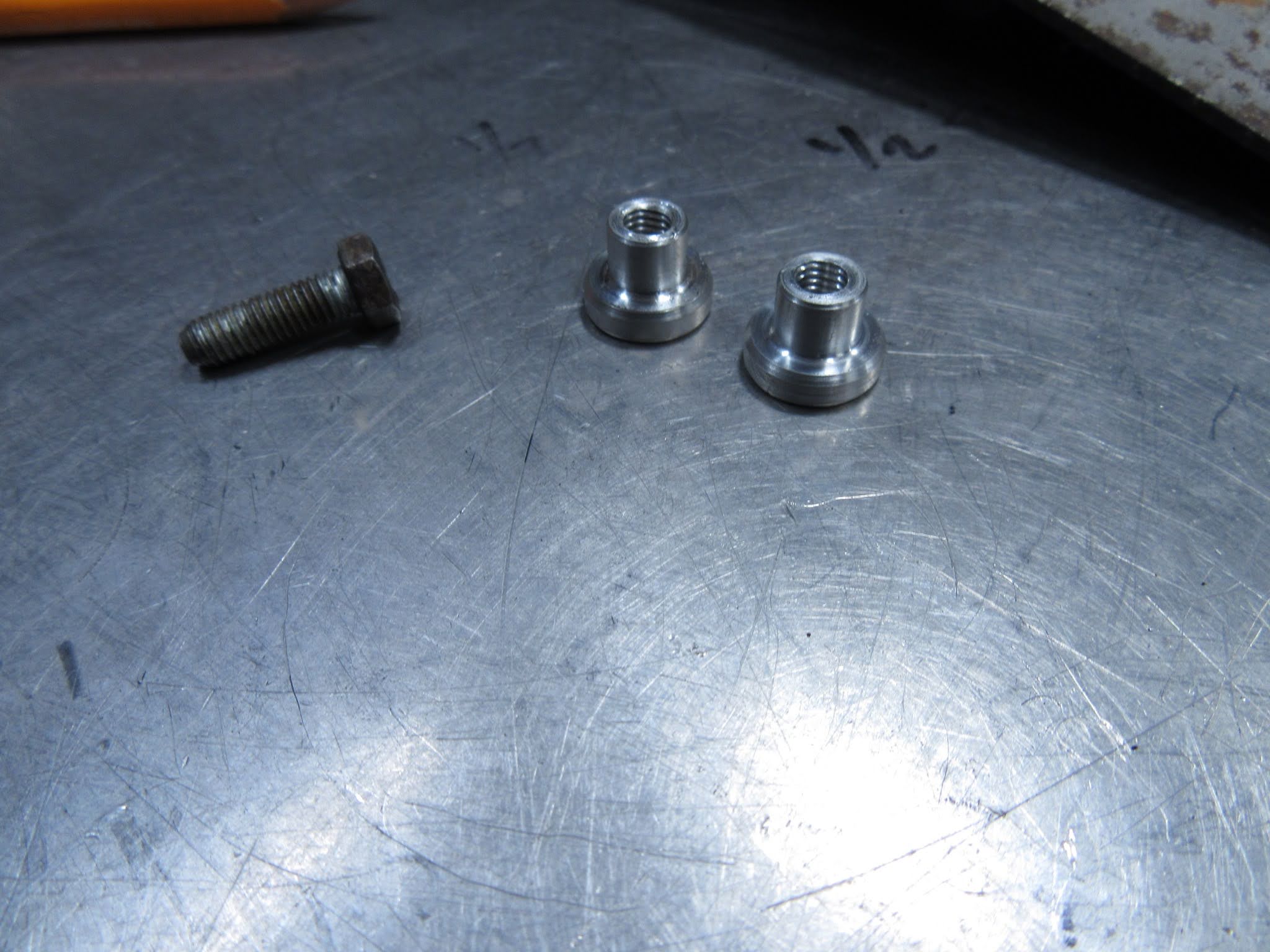

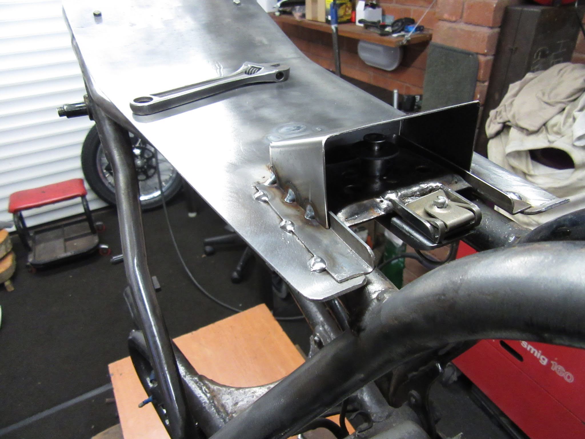

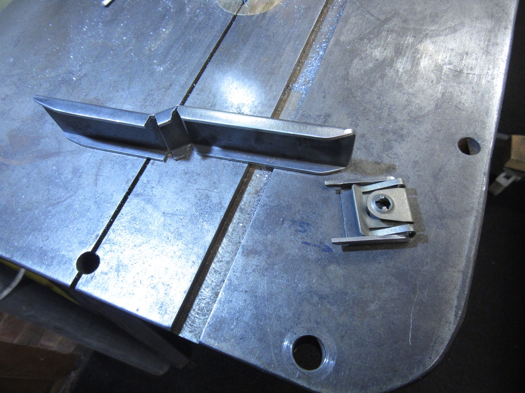

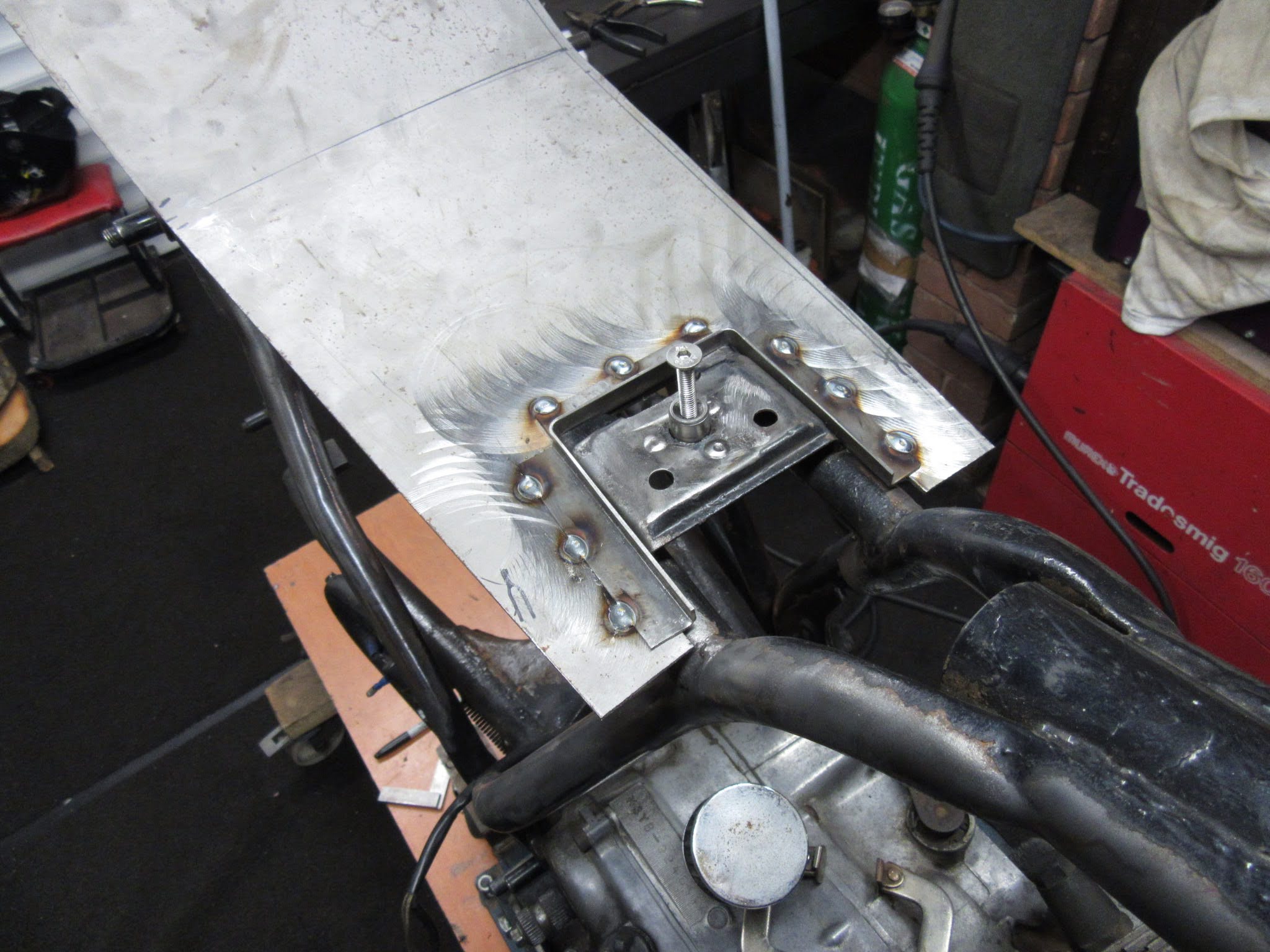

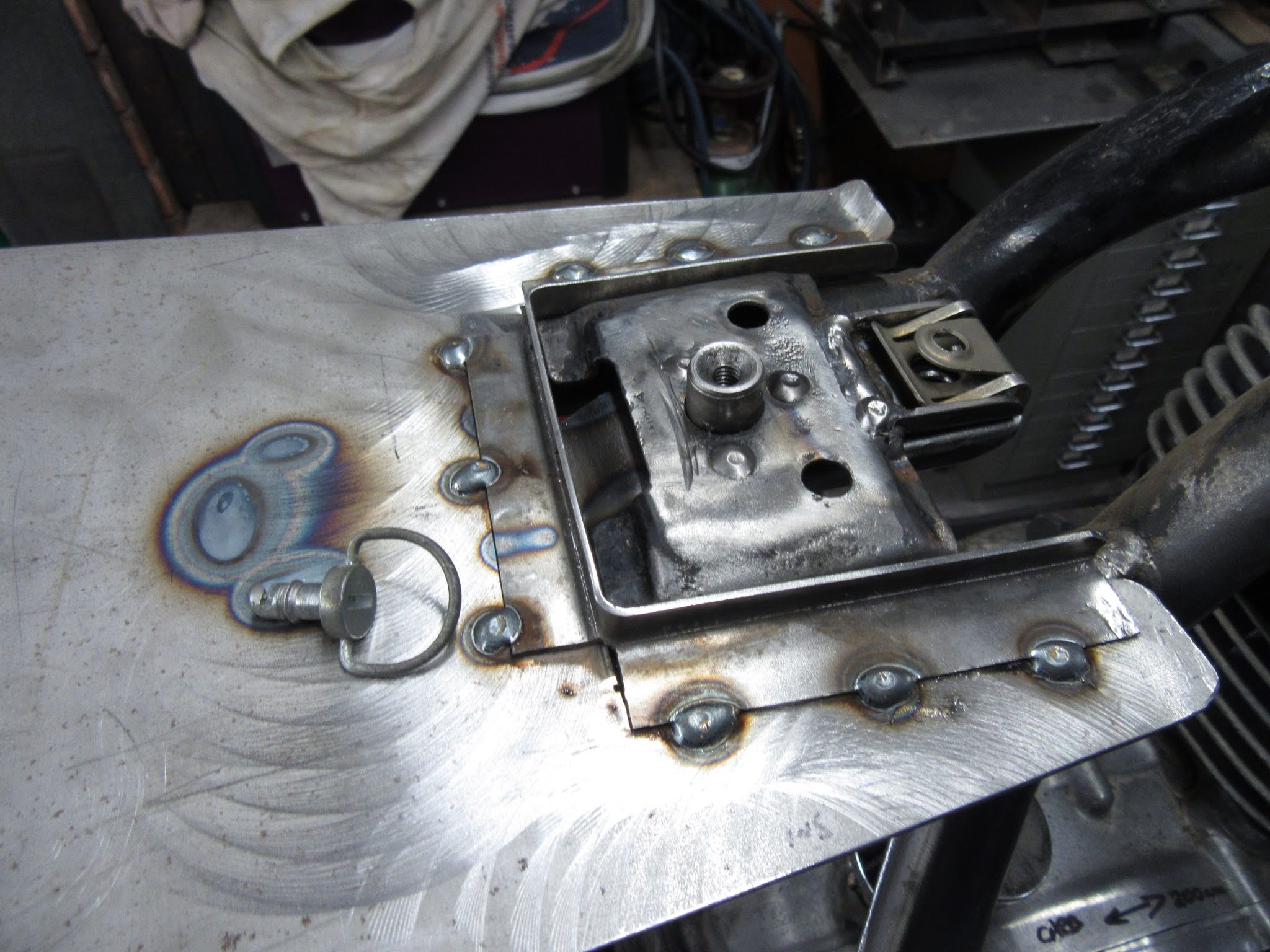

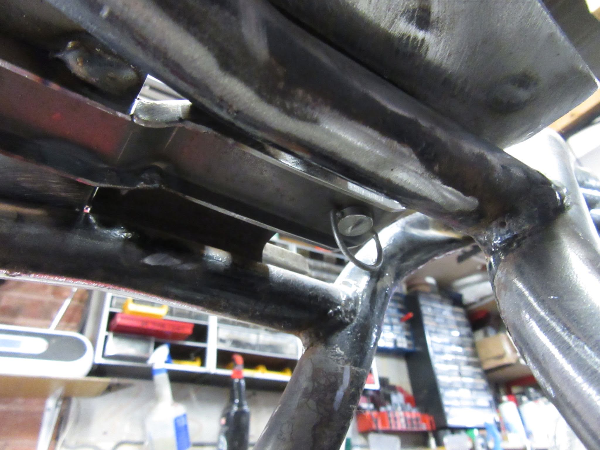

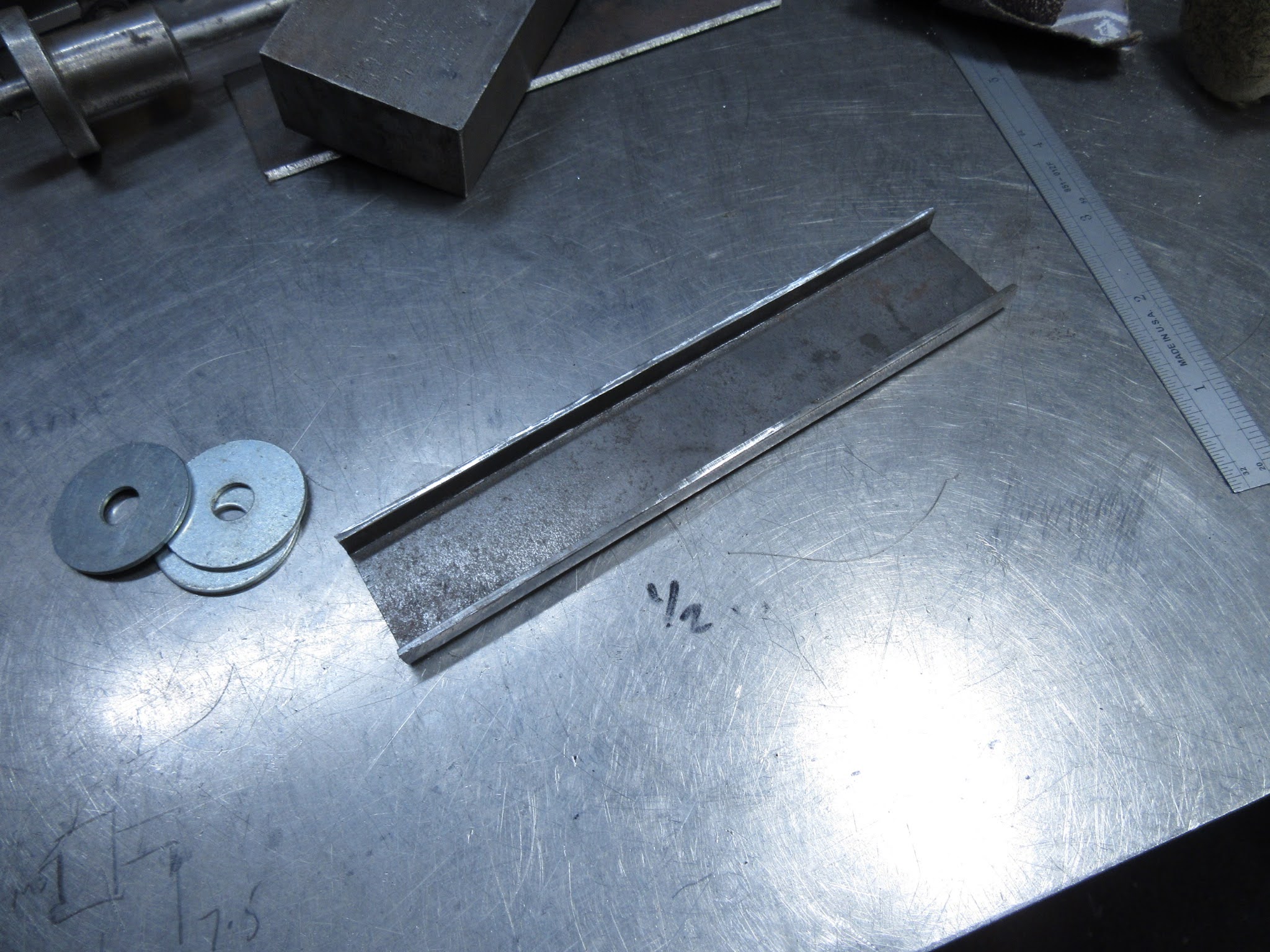

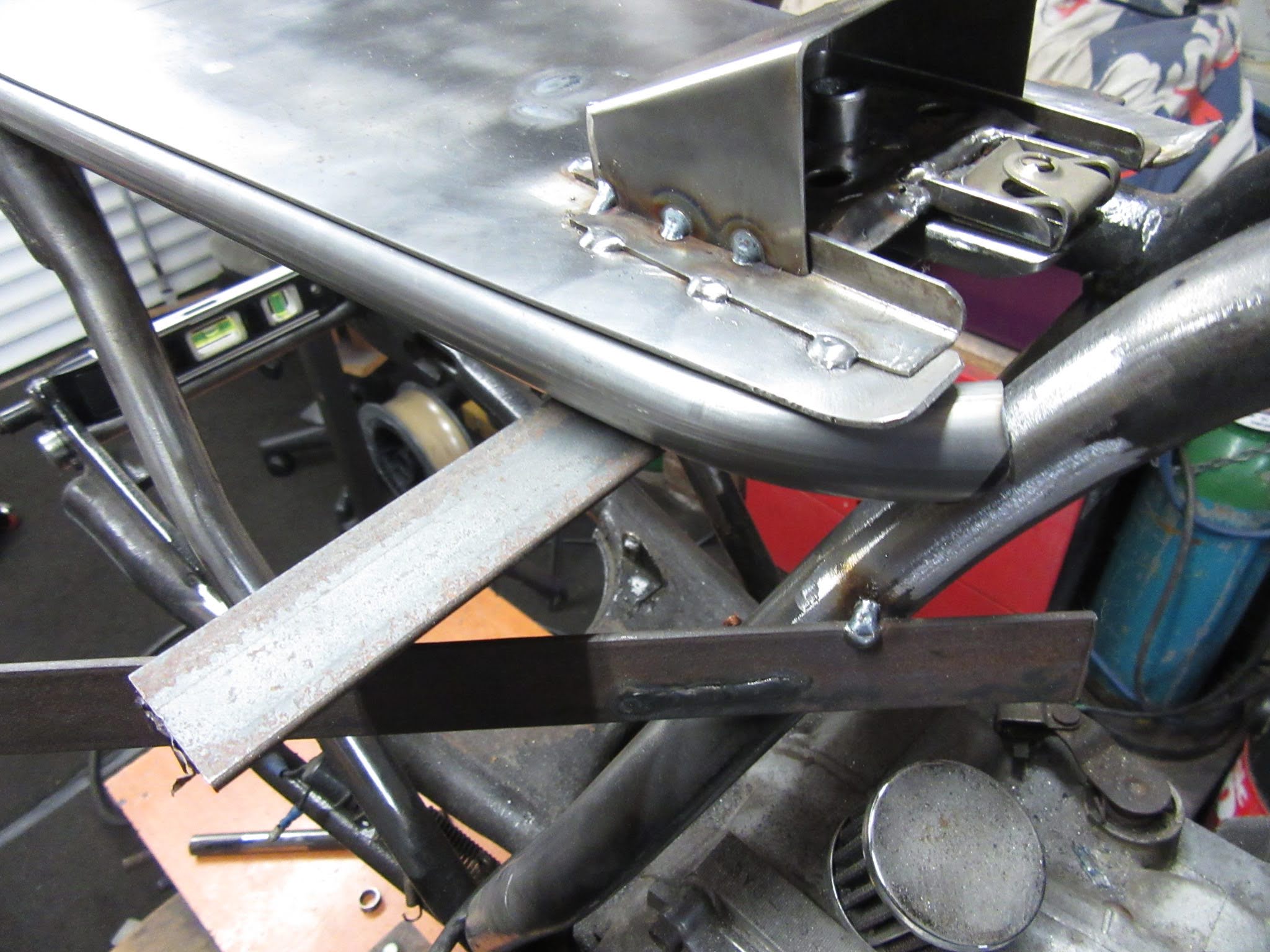

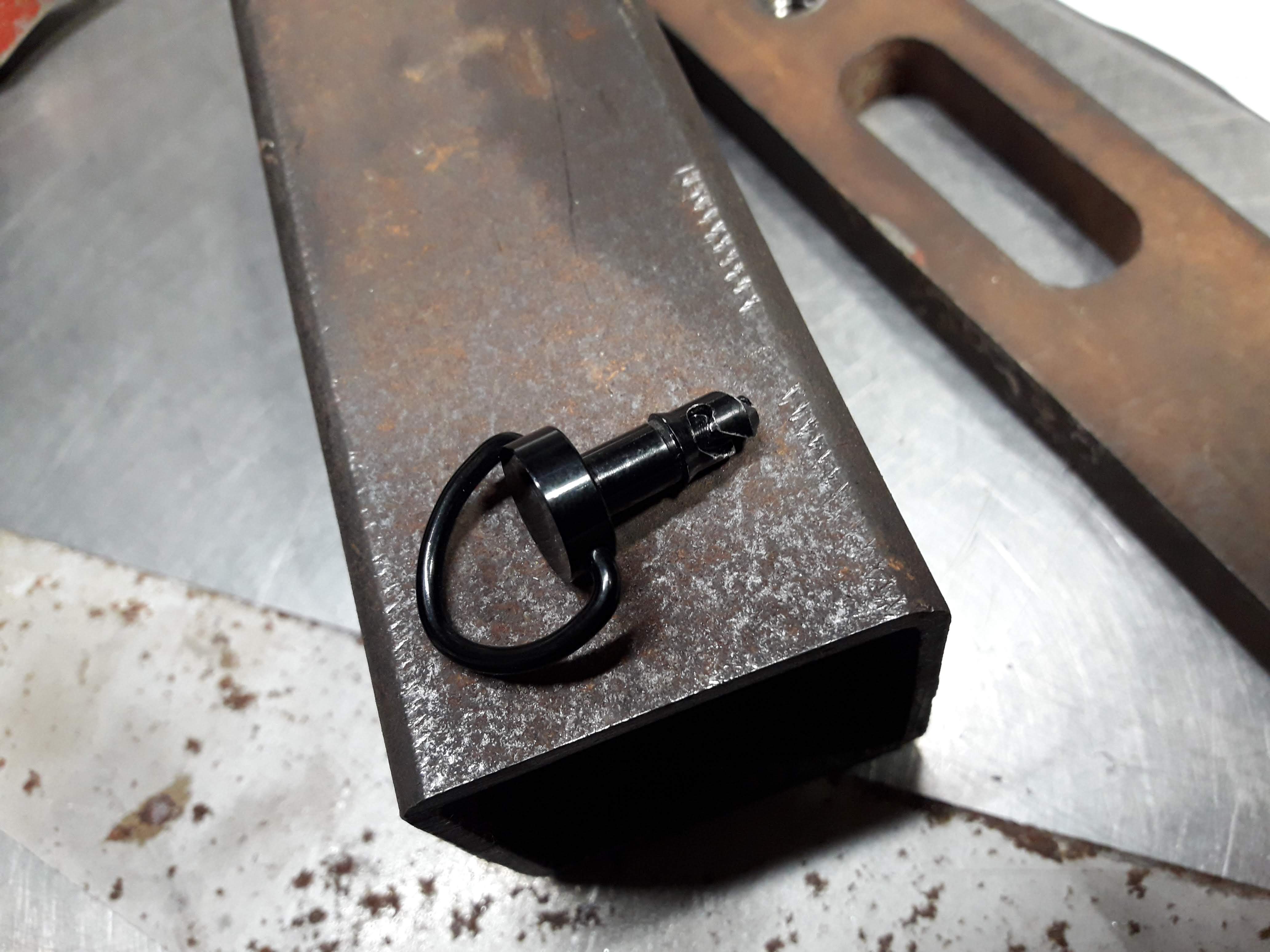

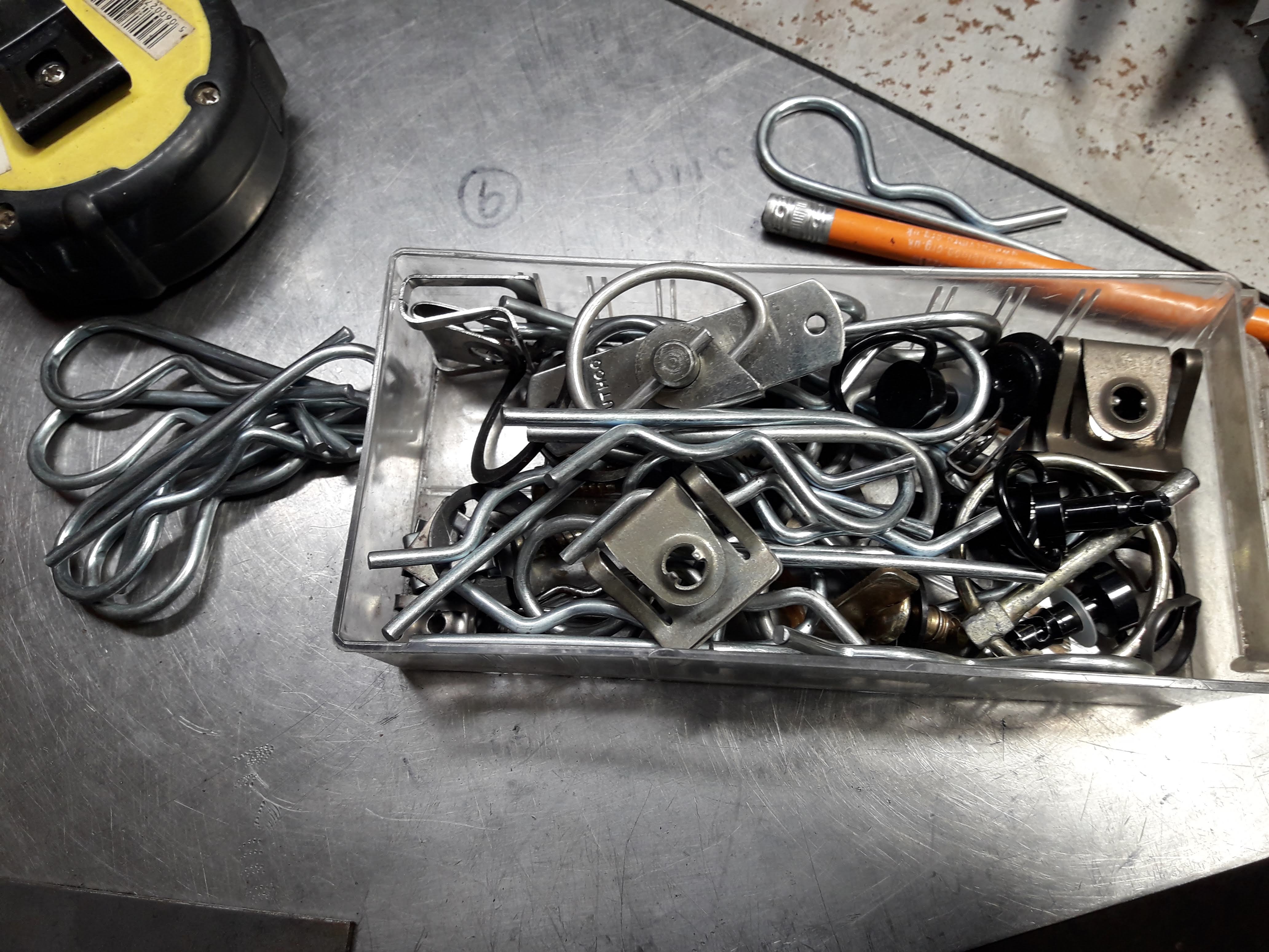

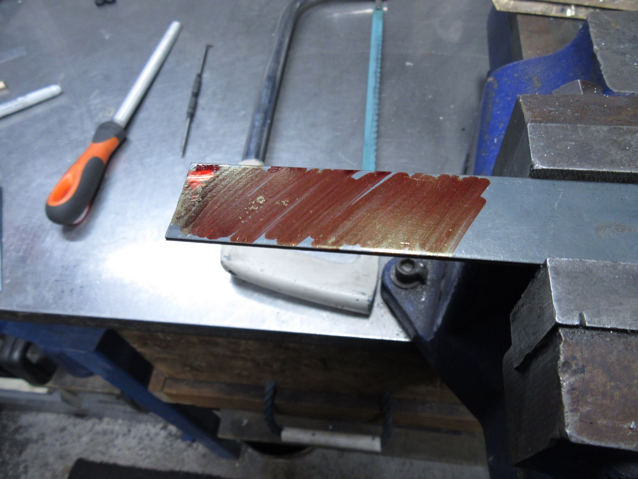

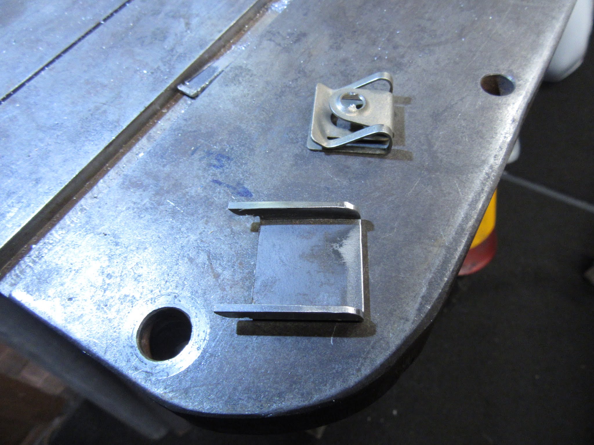

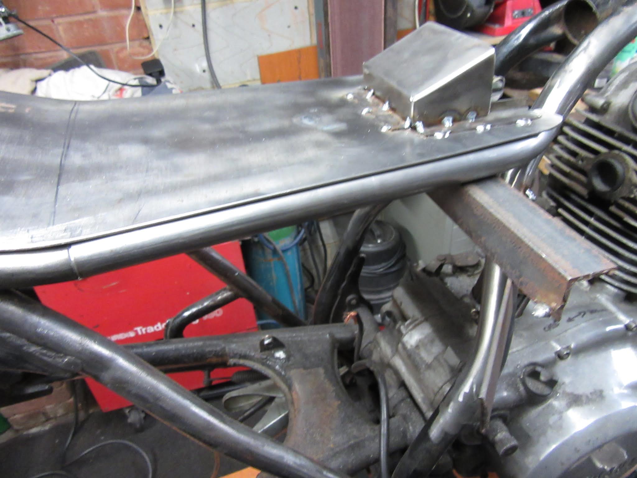

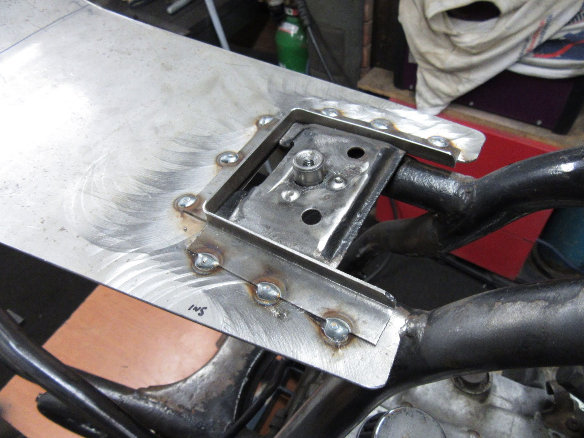

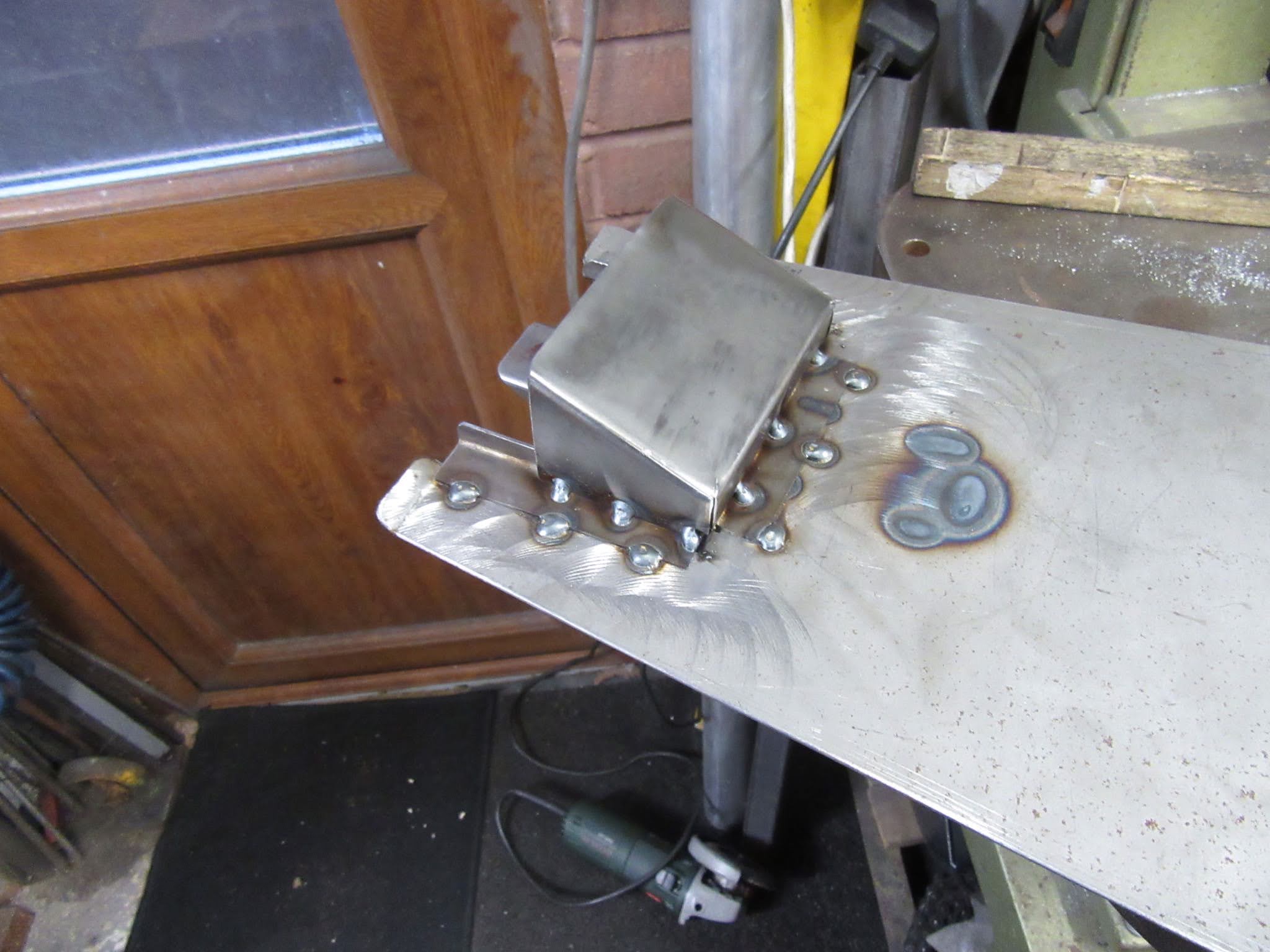

Checked the shop stock on widgets and clips and opted for a DZUS fastener and some home made channel for a bit of strength. Made up some location brackets and turned up a couple of pegs to slot into the seat rear end. when the seat is slid into place the Dzus clip stops it all flying off!

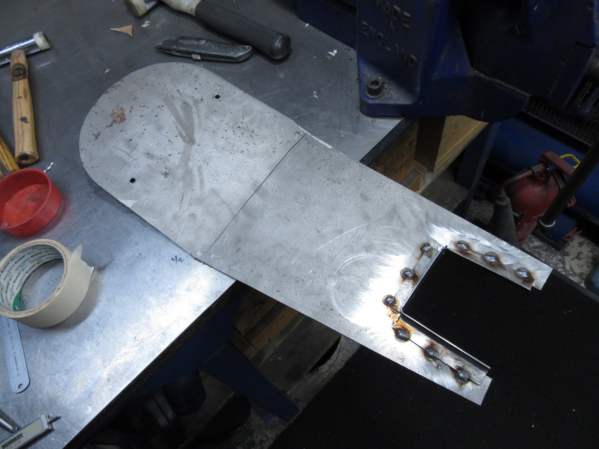

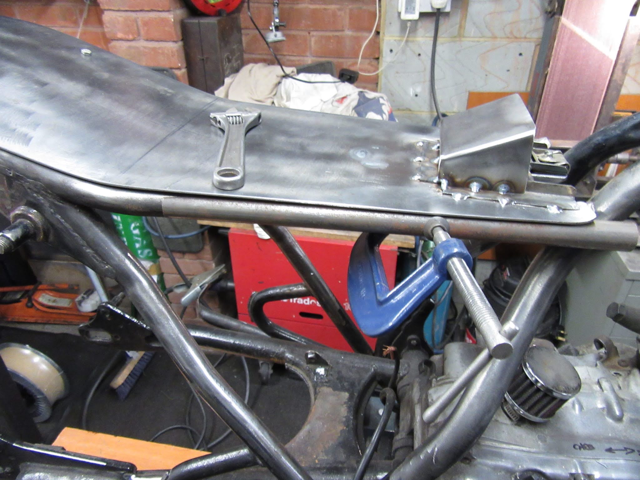

some more seat pan action!

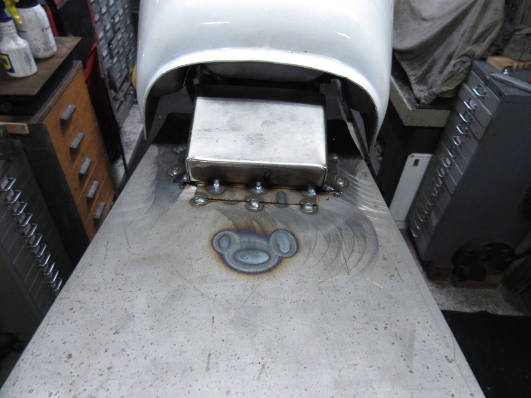

all welded into place.....

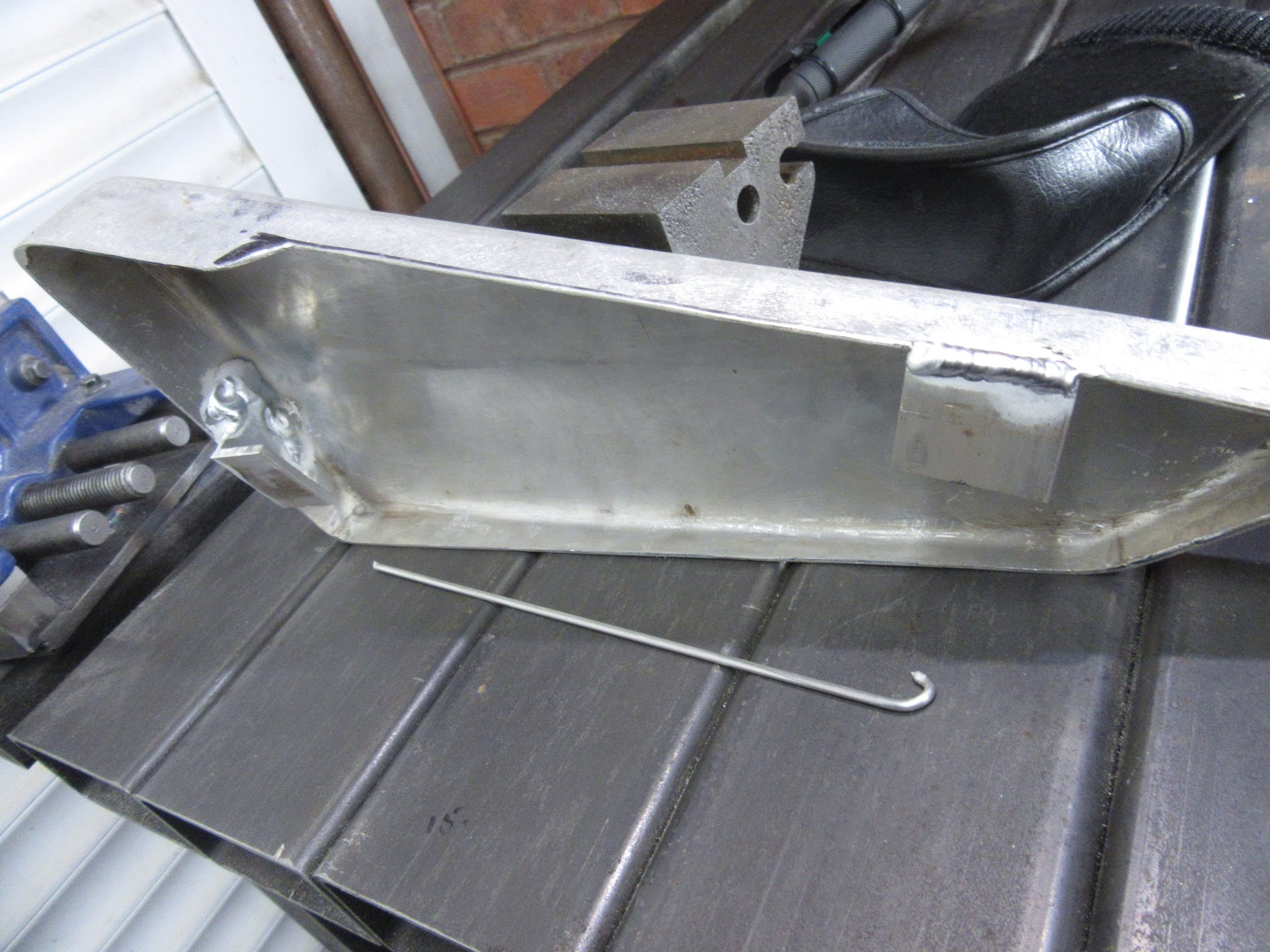

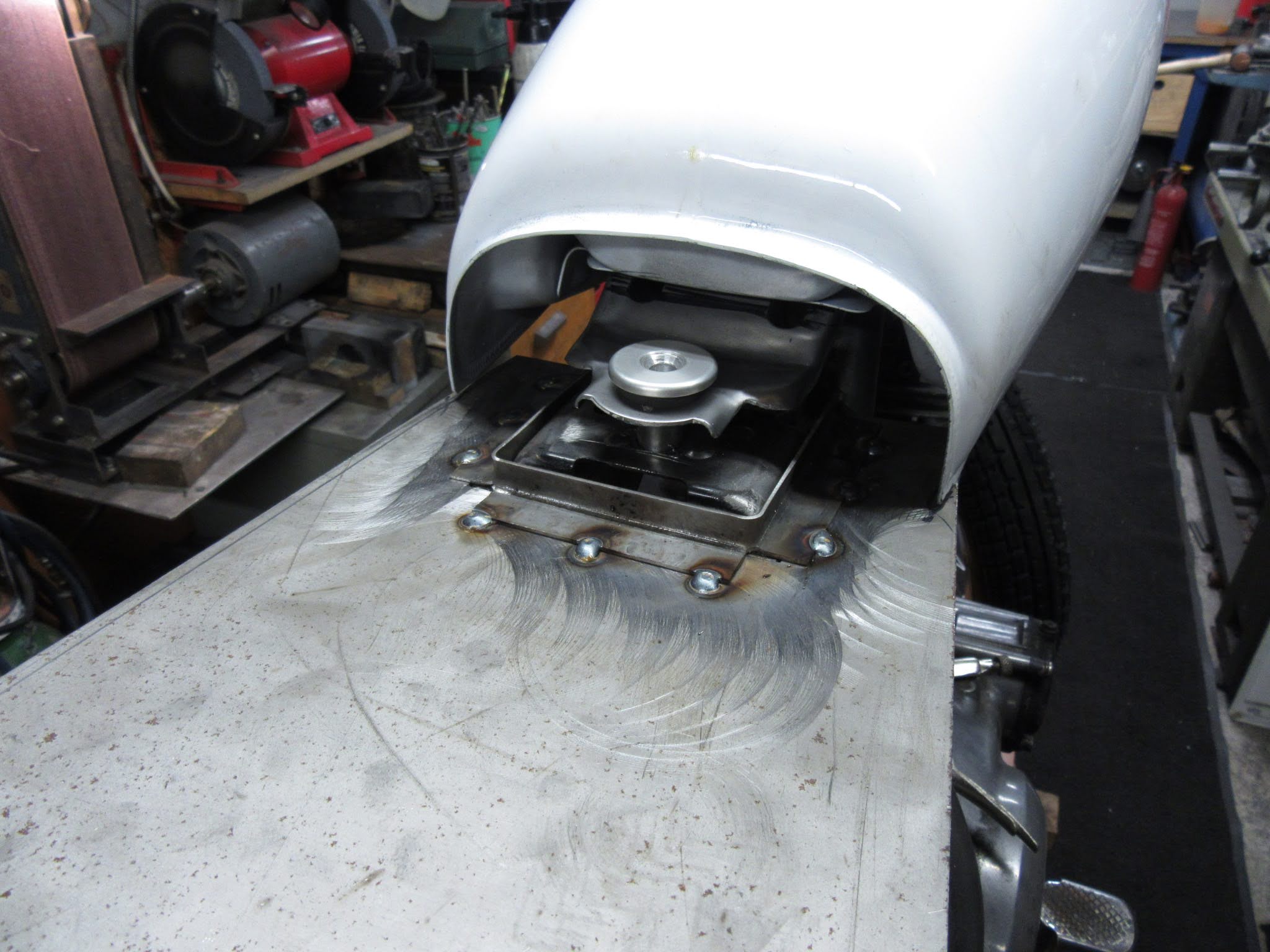

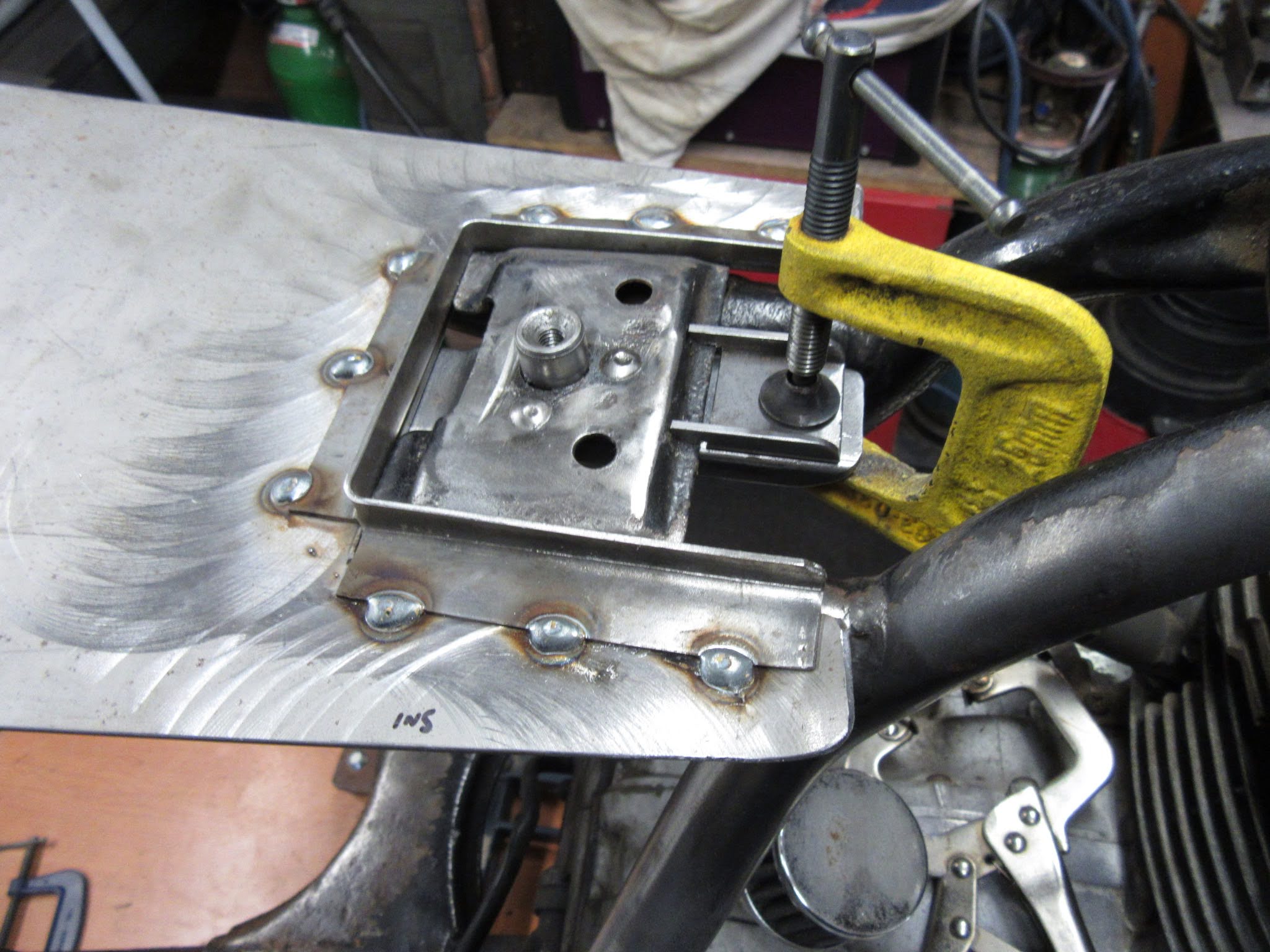

So......back to the seat...

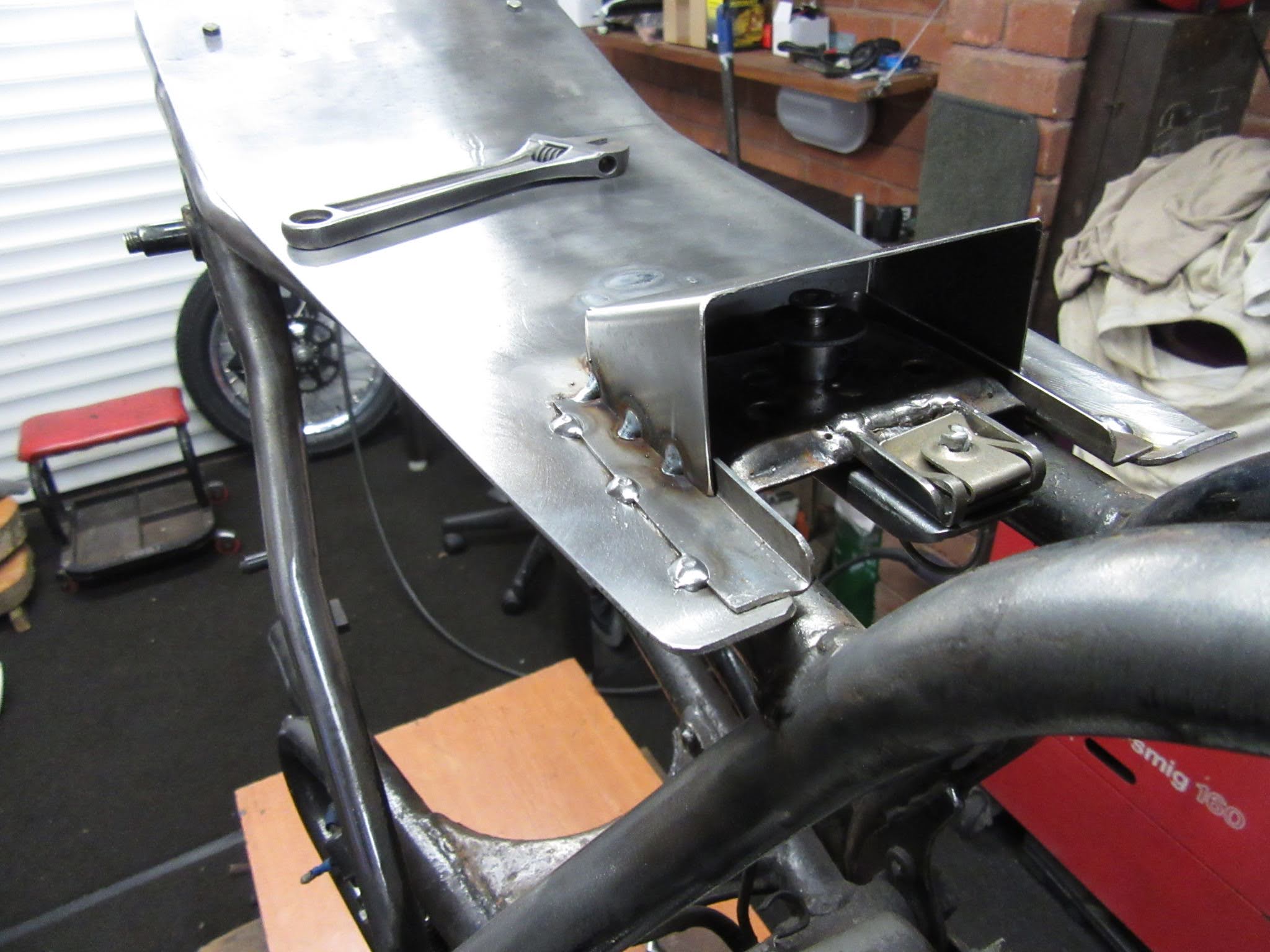

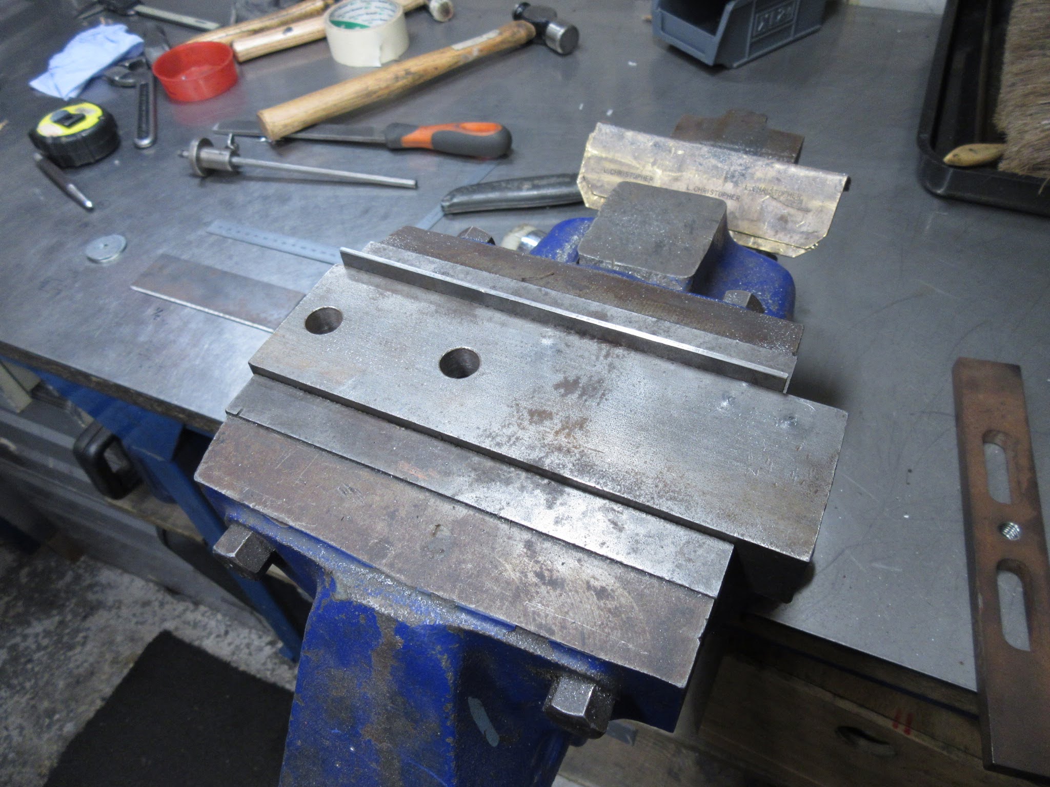

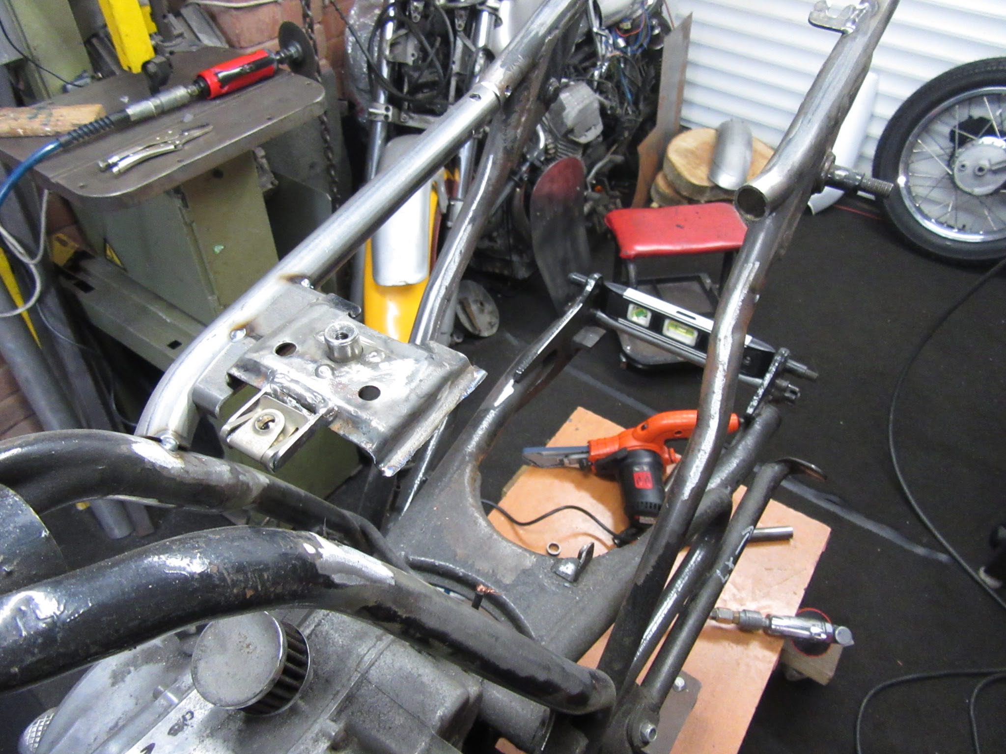

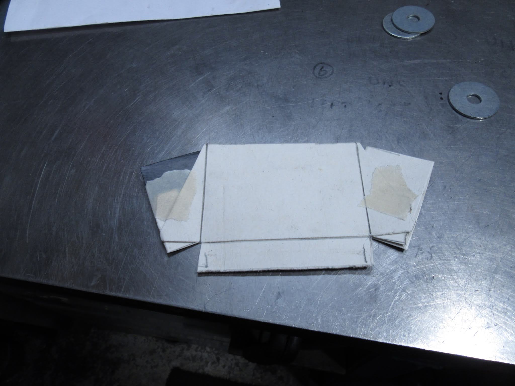

Got out the cardboard aided design package again and made a little tunnel for the seat catch. Dusted off my home made folder for the task.

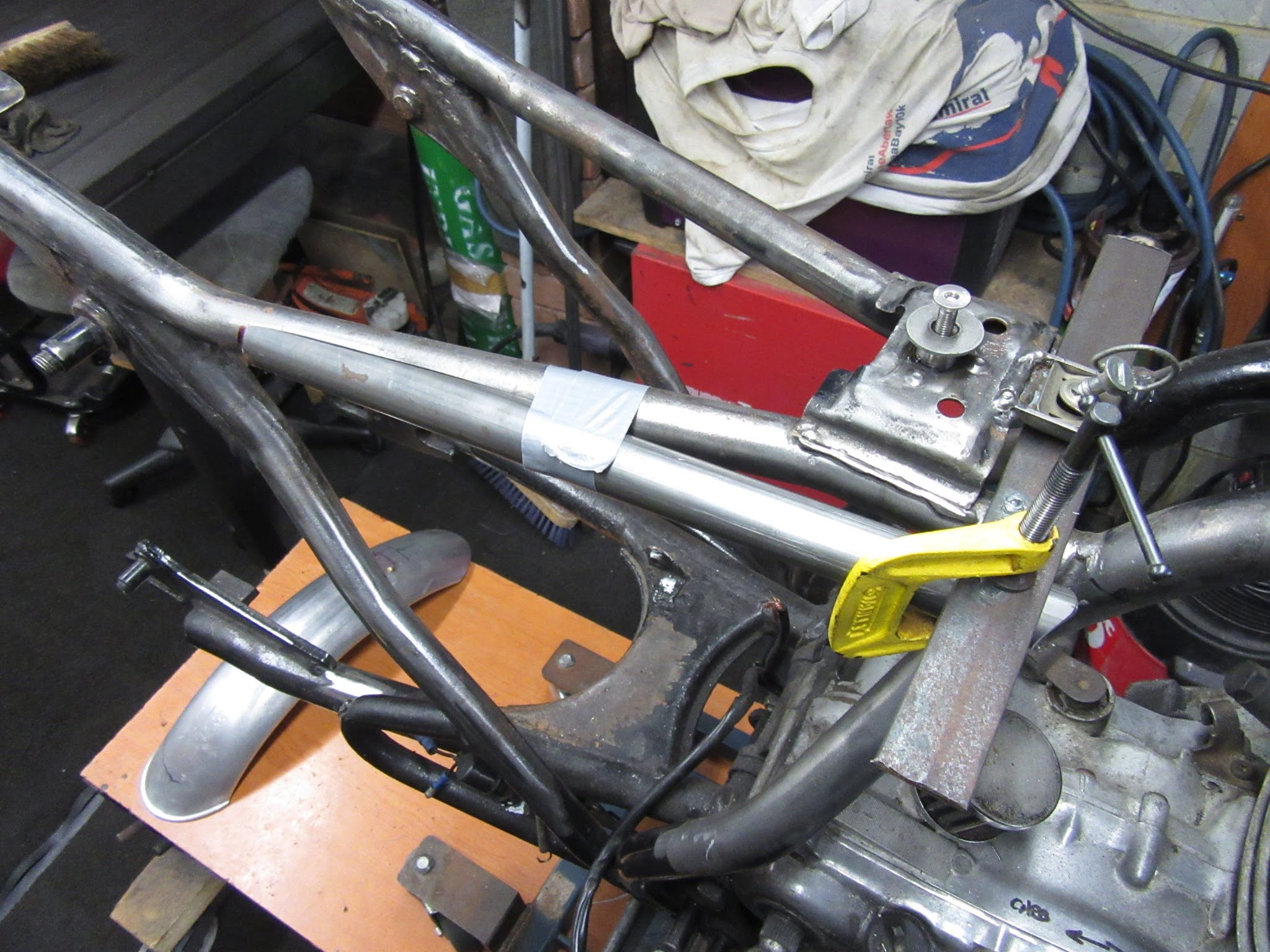

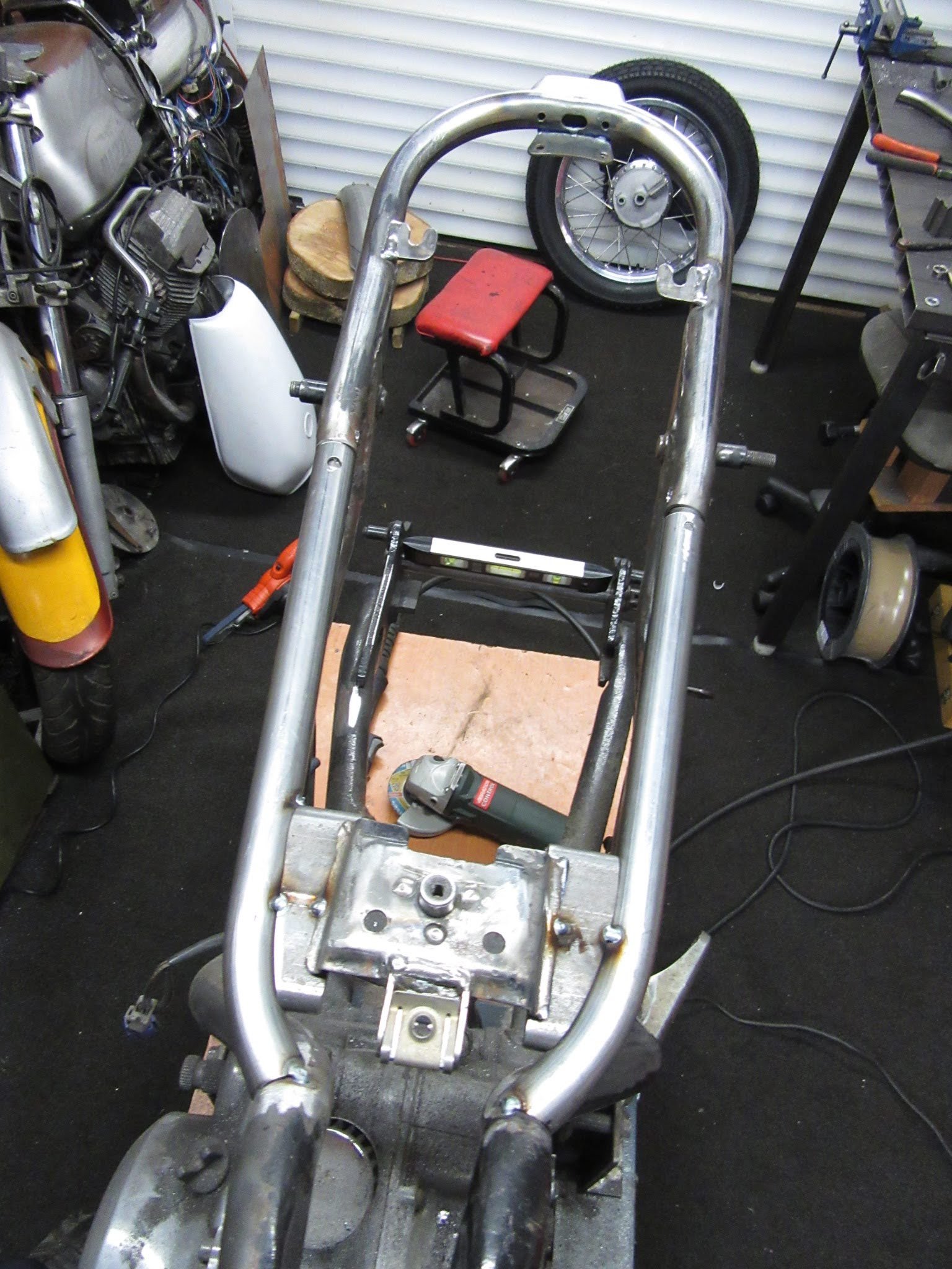

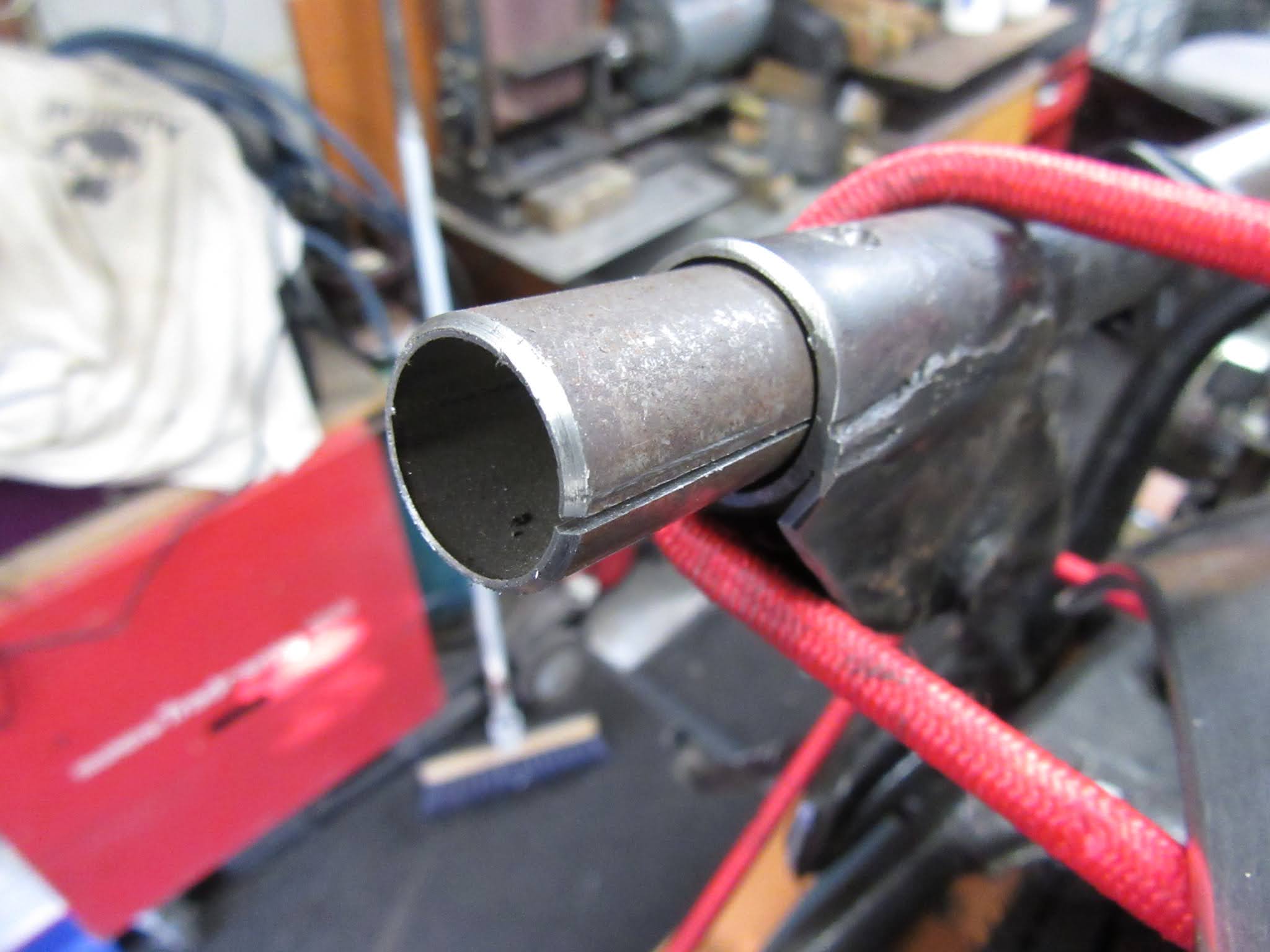

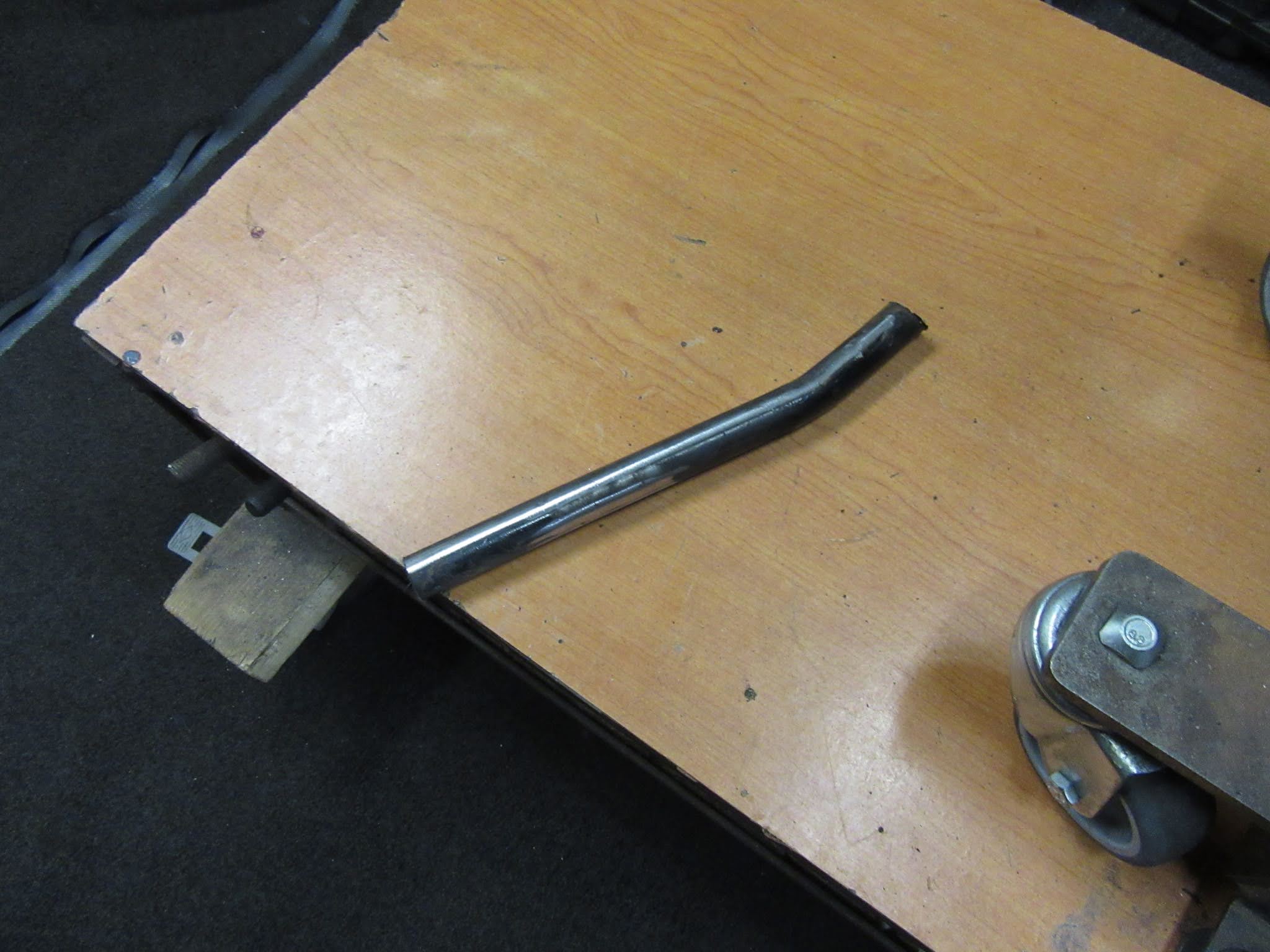

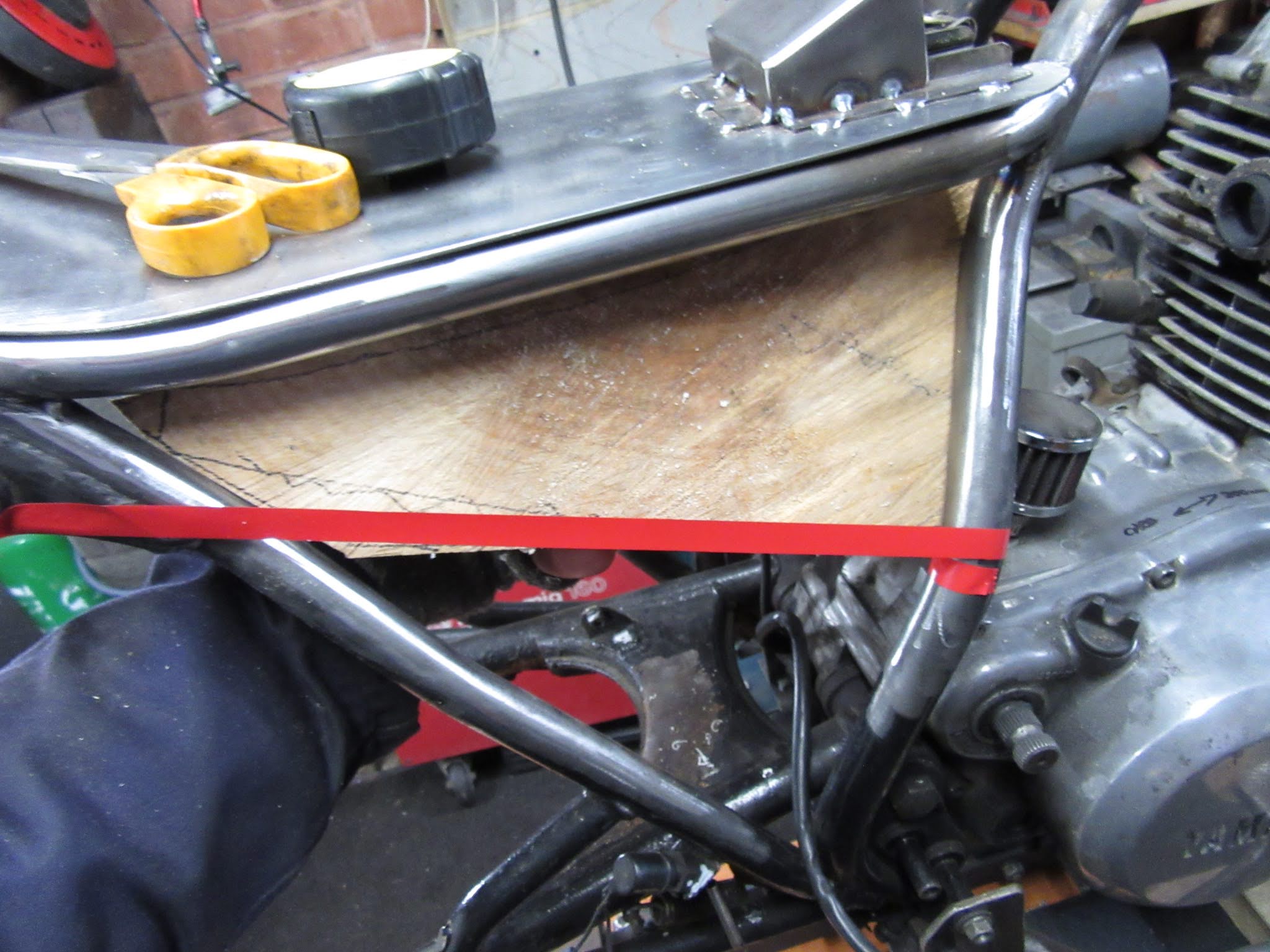

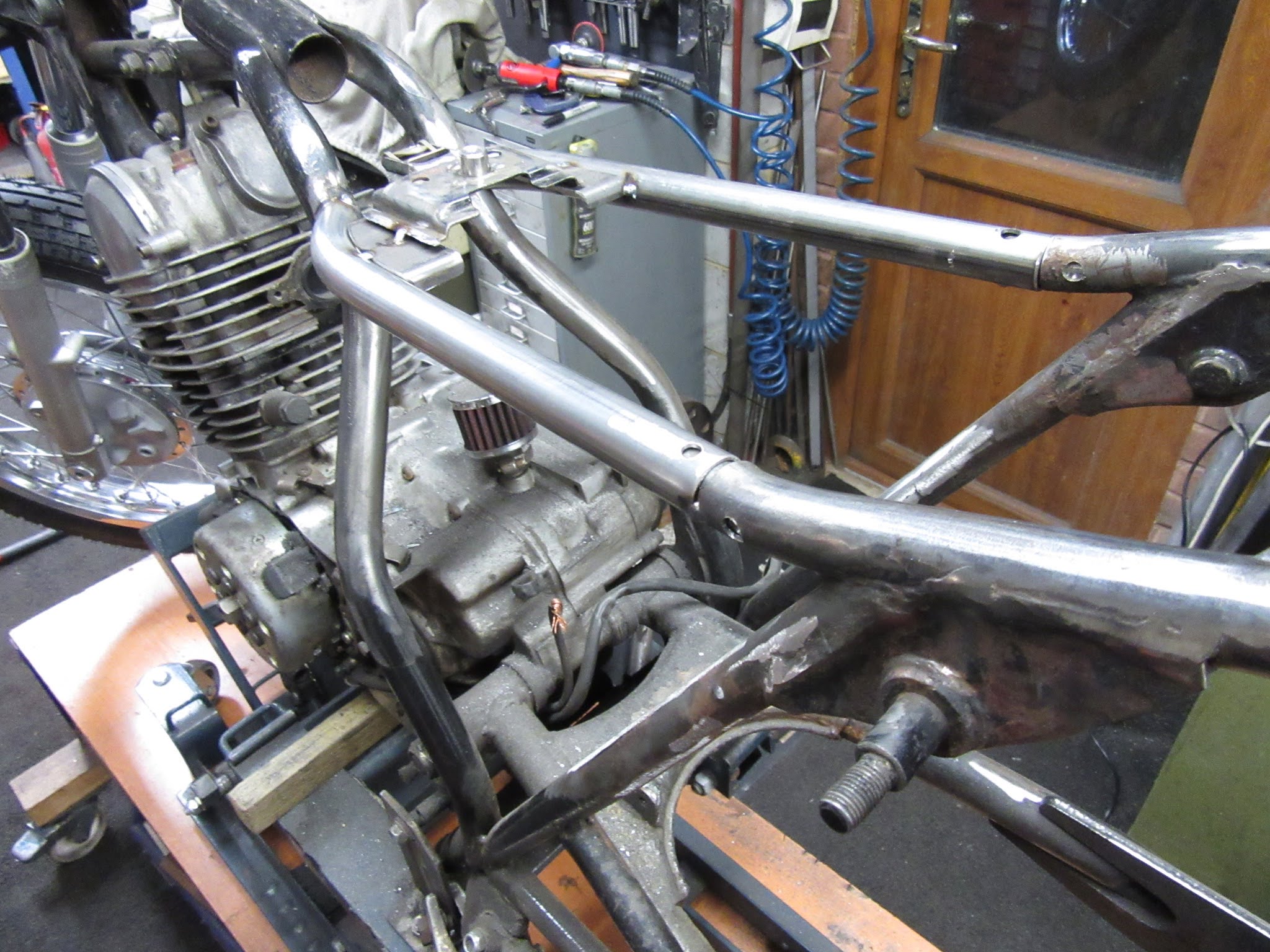

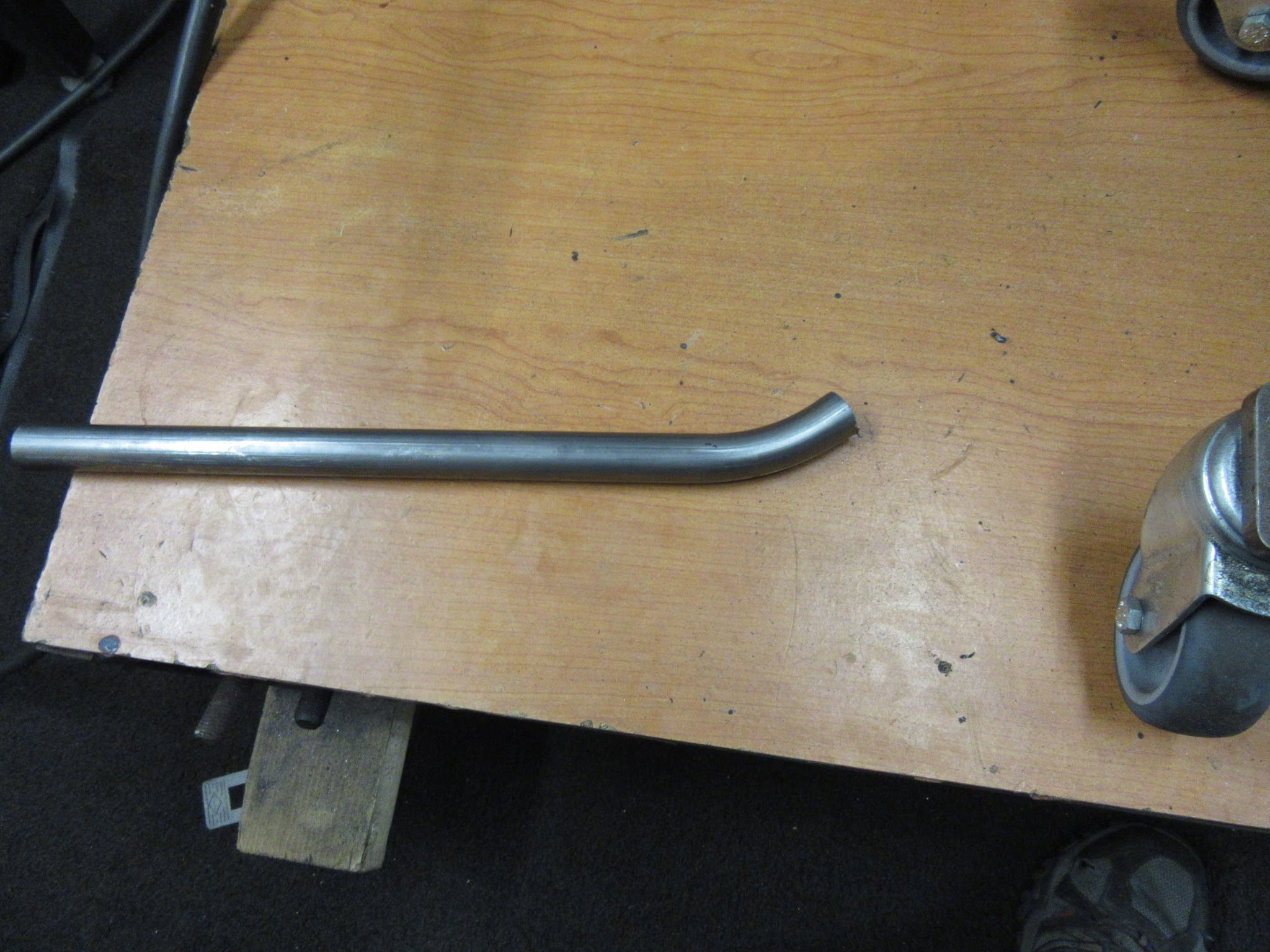

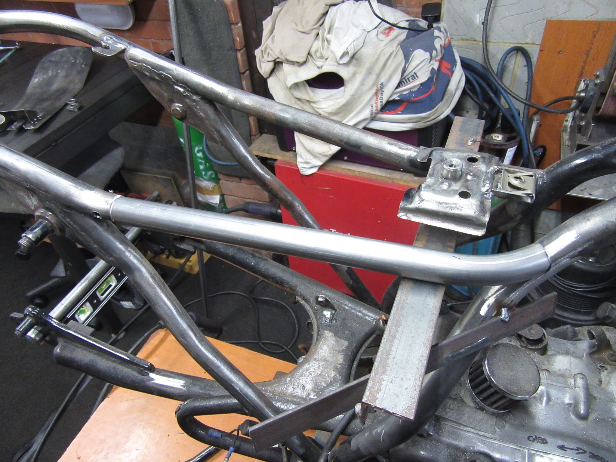

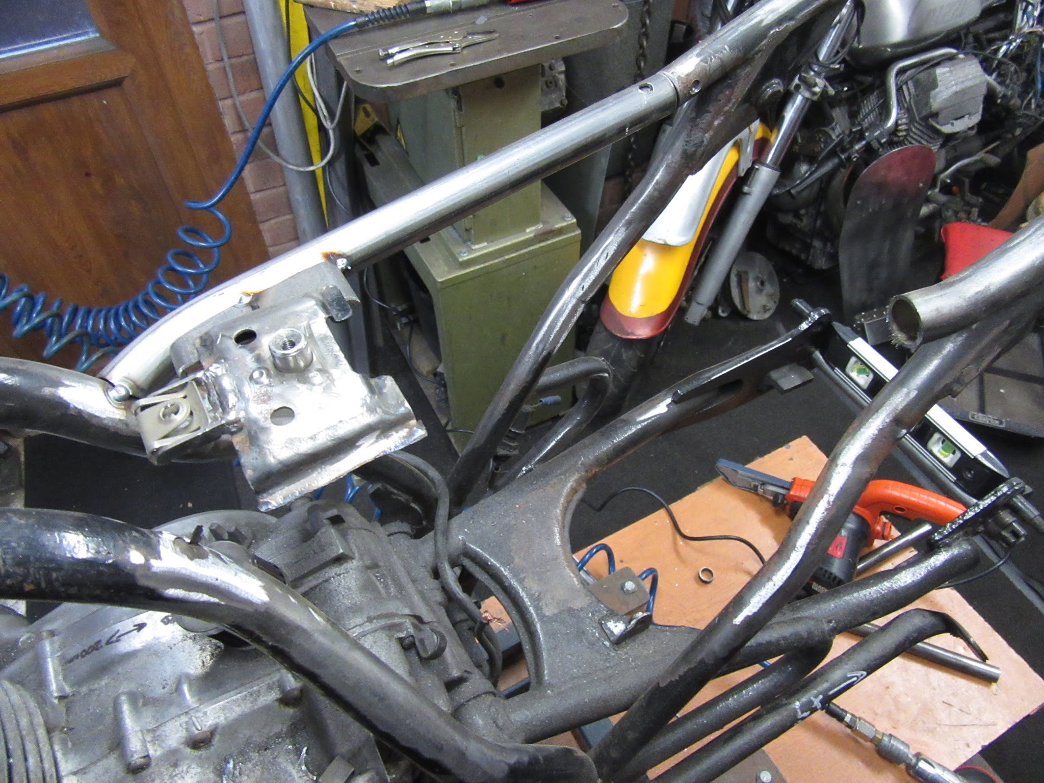

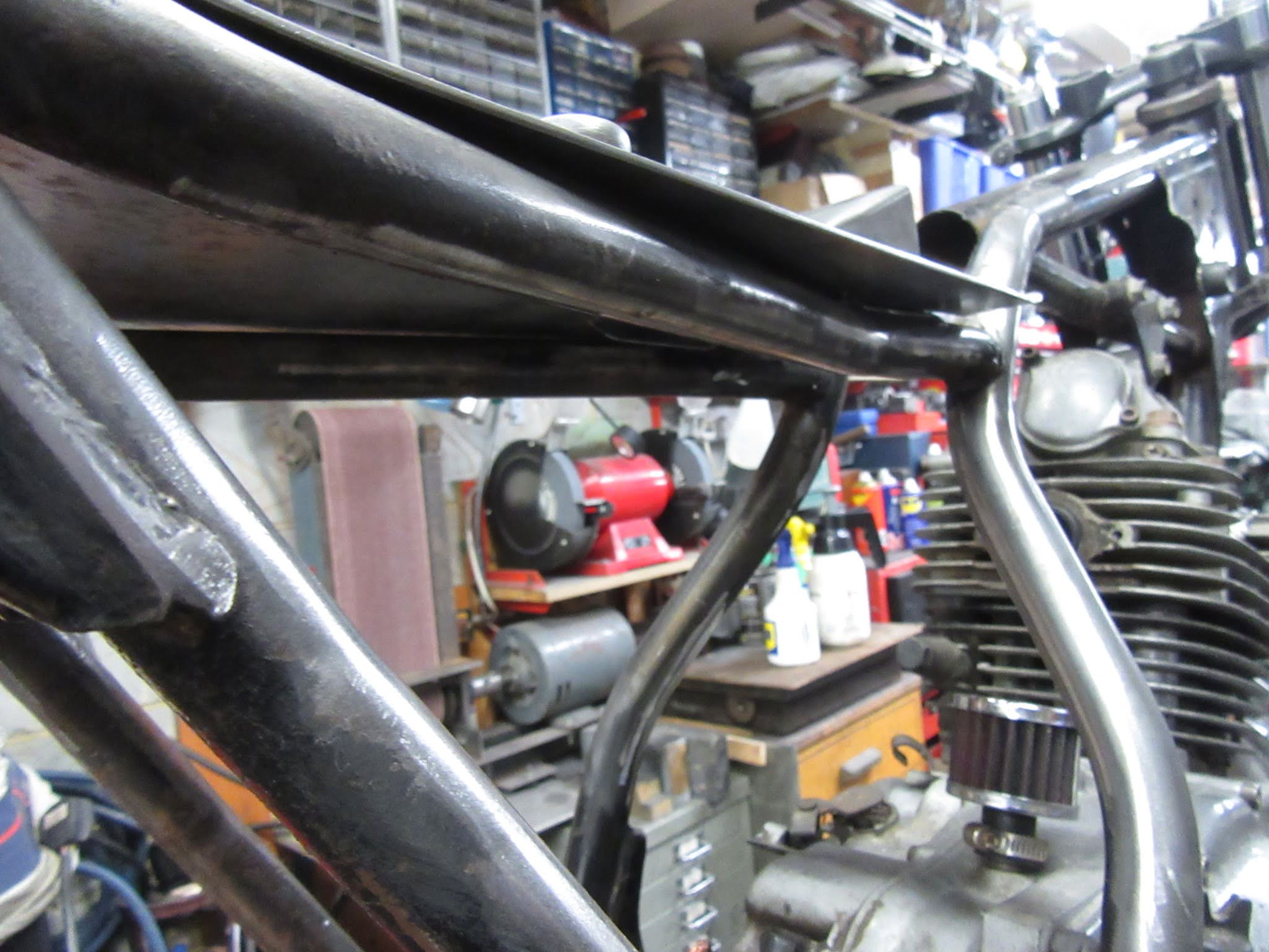

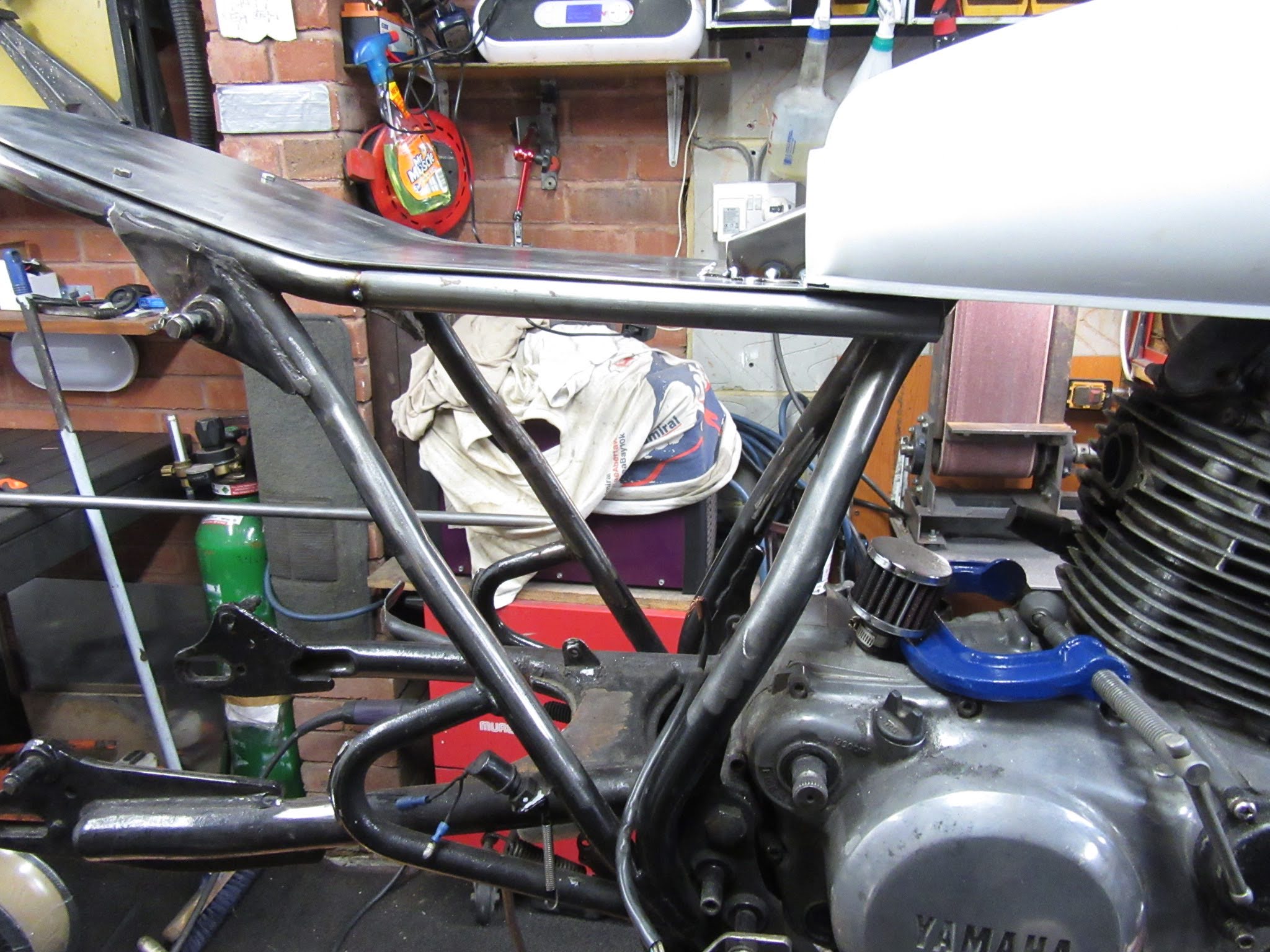

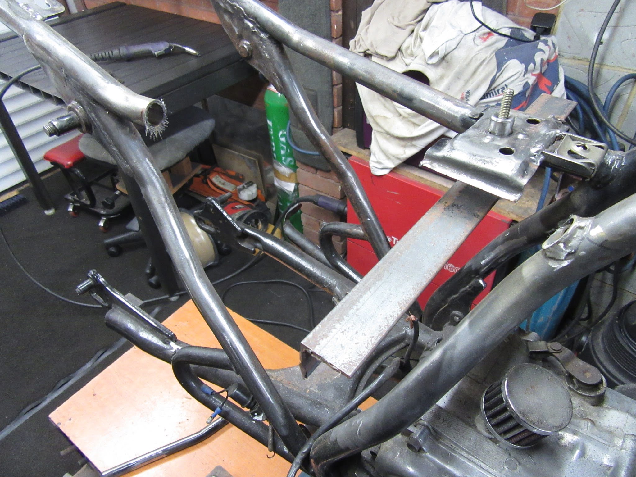

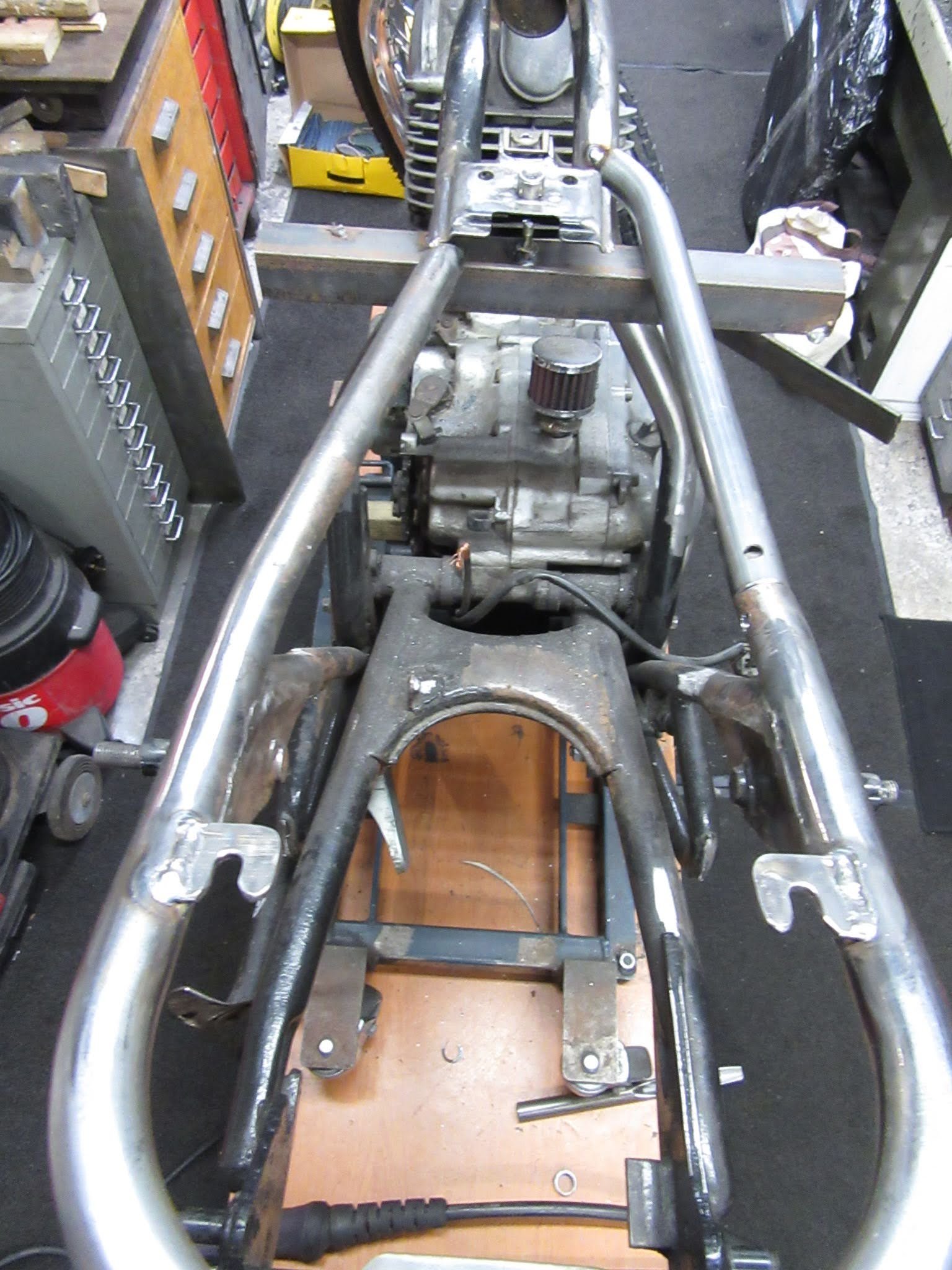

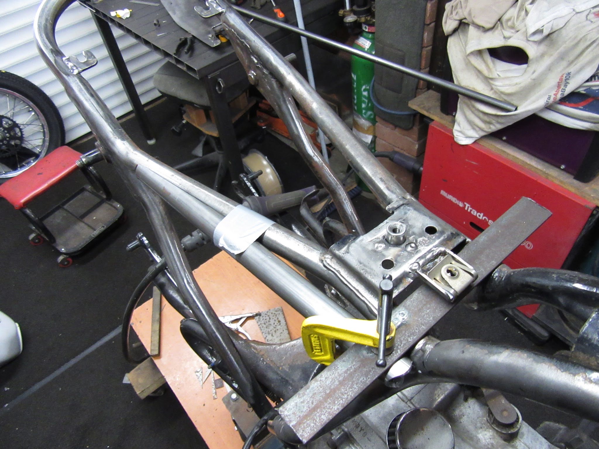

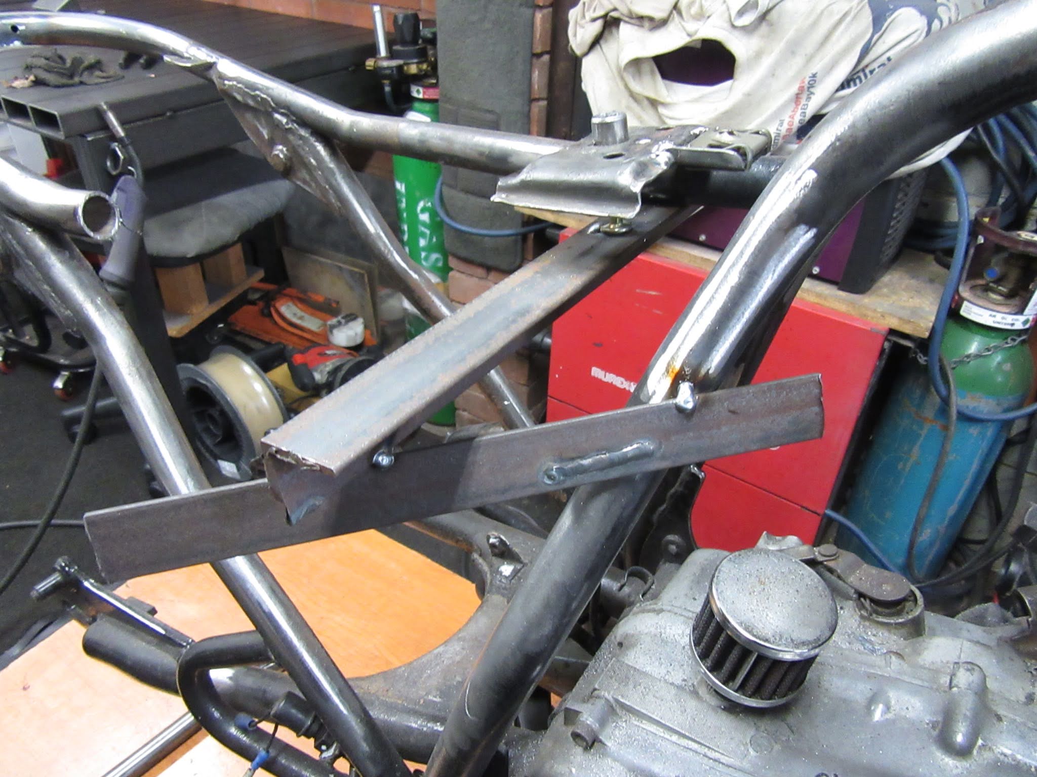

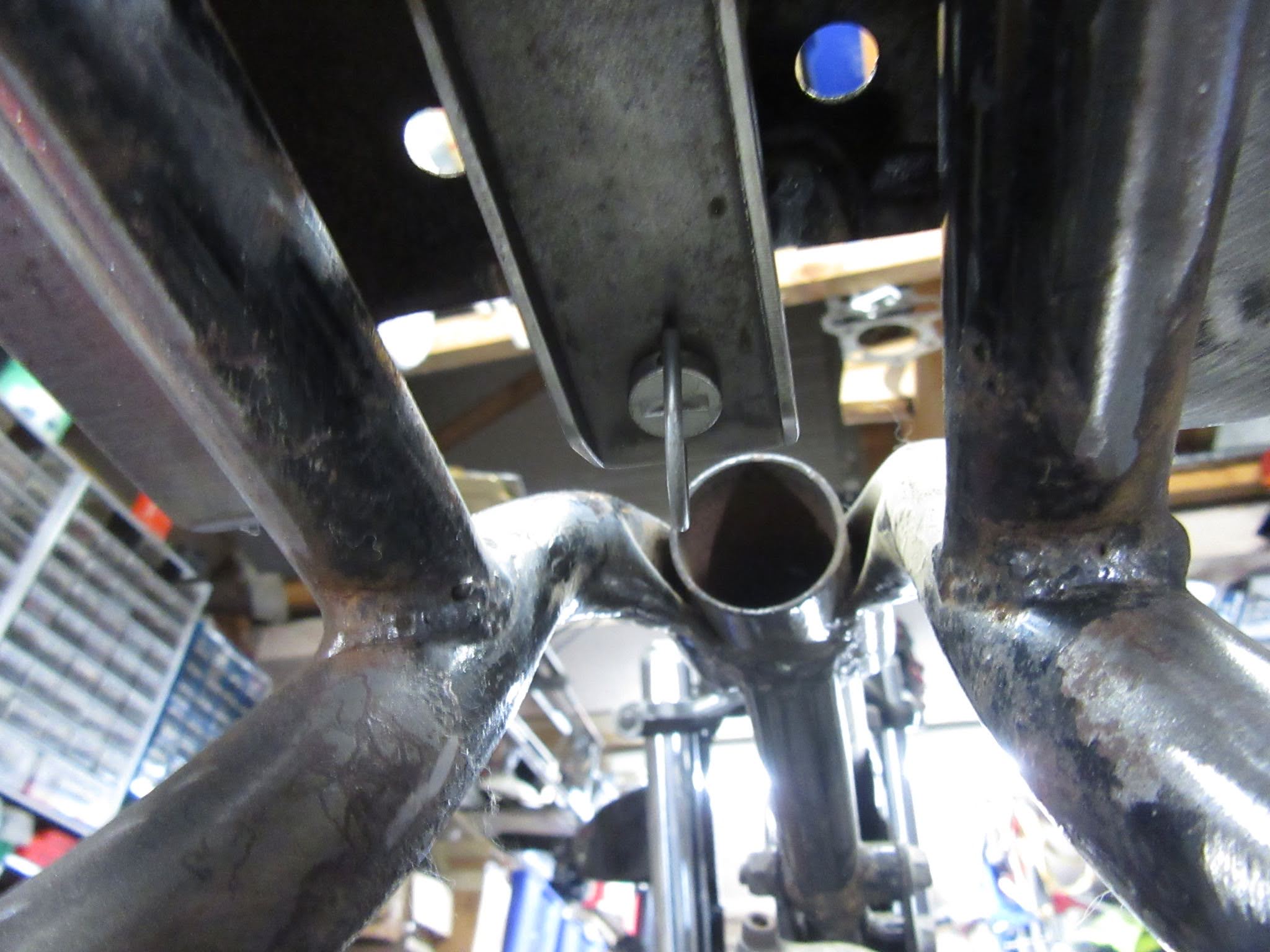

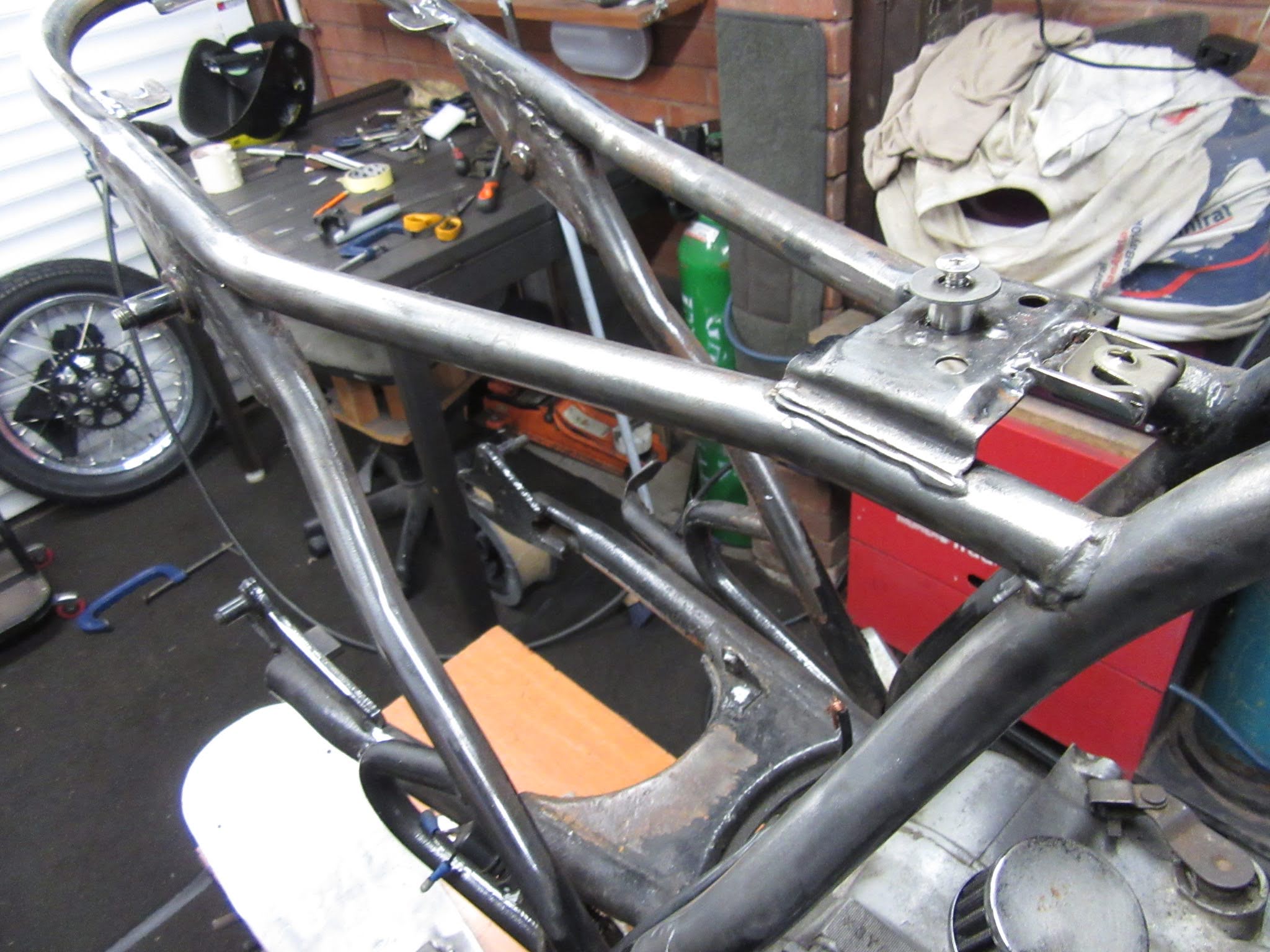

So there I was..........sitting there trying to warm up in minus 2 deg drinking a cup of tea when I decided I didn't like the way the top rails of the subframe narrowed and joined the main down tube. The rails sort of disappeared under the seat and it wouldn't look quite right when it was done? Bearing in mind this was supposed to be a quick turnaround project and I didn't want to cut too much stuff off............
So I thought about welding in some dummy sections as a quick fix, but trying the get the front edge to meet up back with the frame again didn't look right, even though its hidden under the tank?.............I know it there

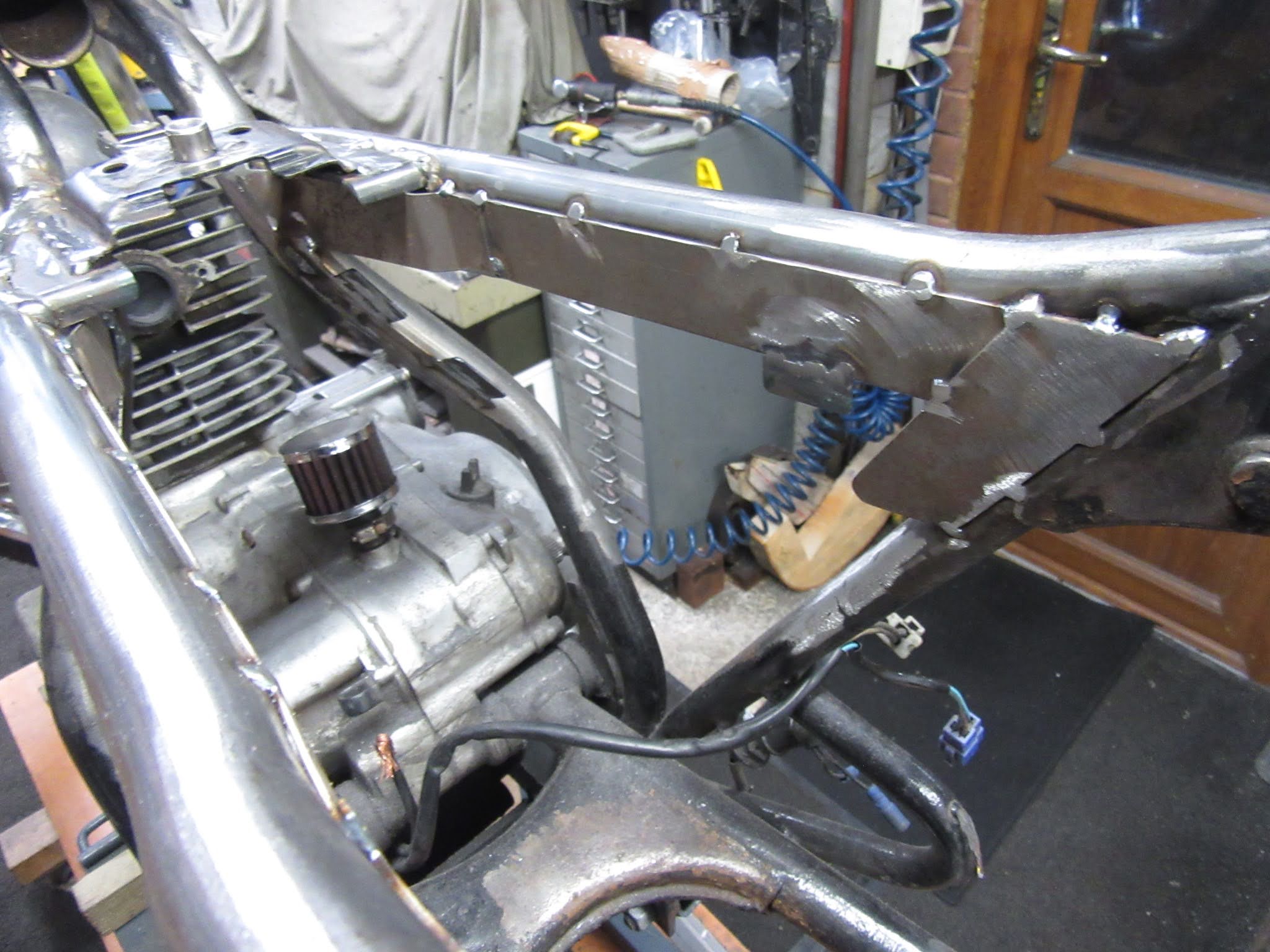

didn't want to cut too much off................:D

that's better........................can now drink my tea in peace

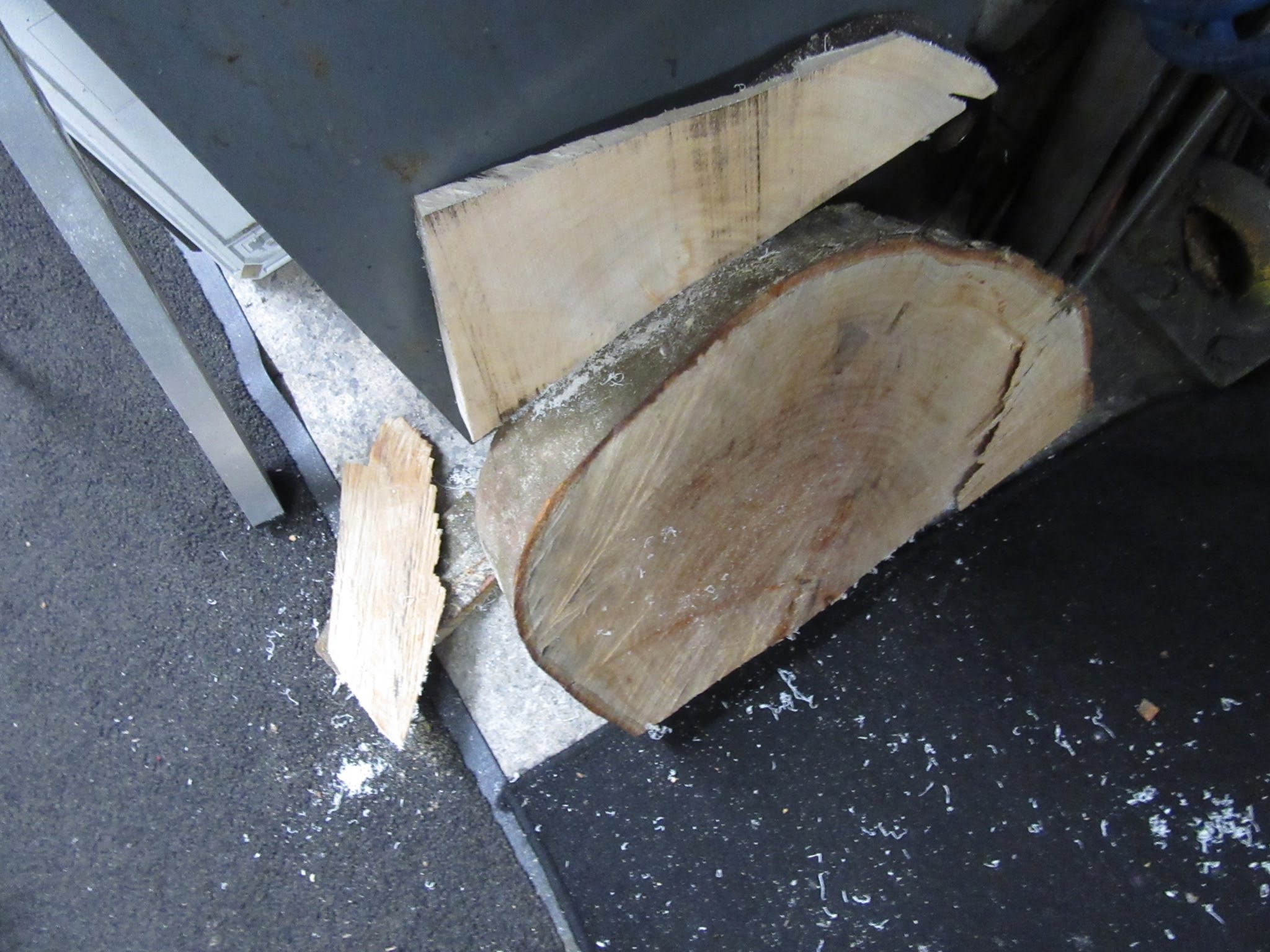

those lumps of wood I pictured a few postings back.................................................
Time for them to join the party....................the clean up is going to be epic

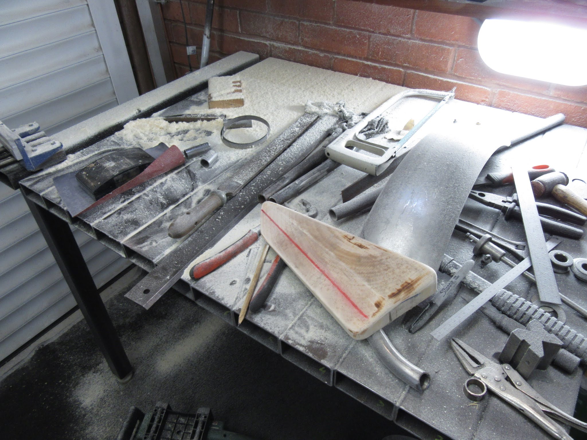

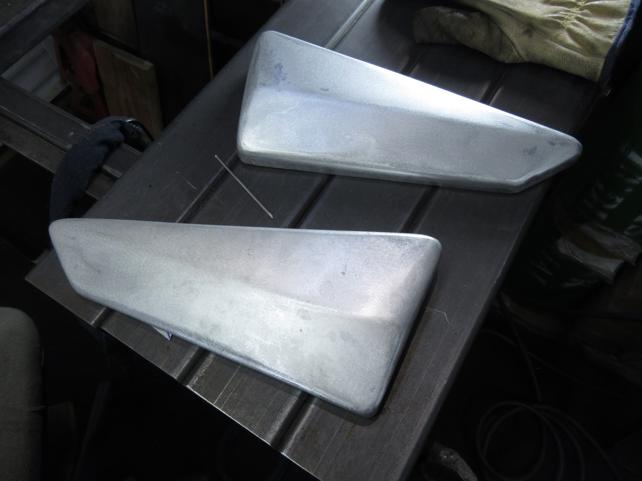

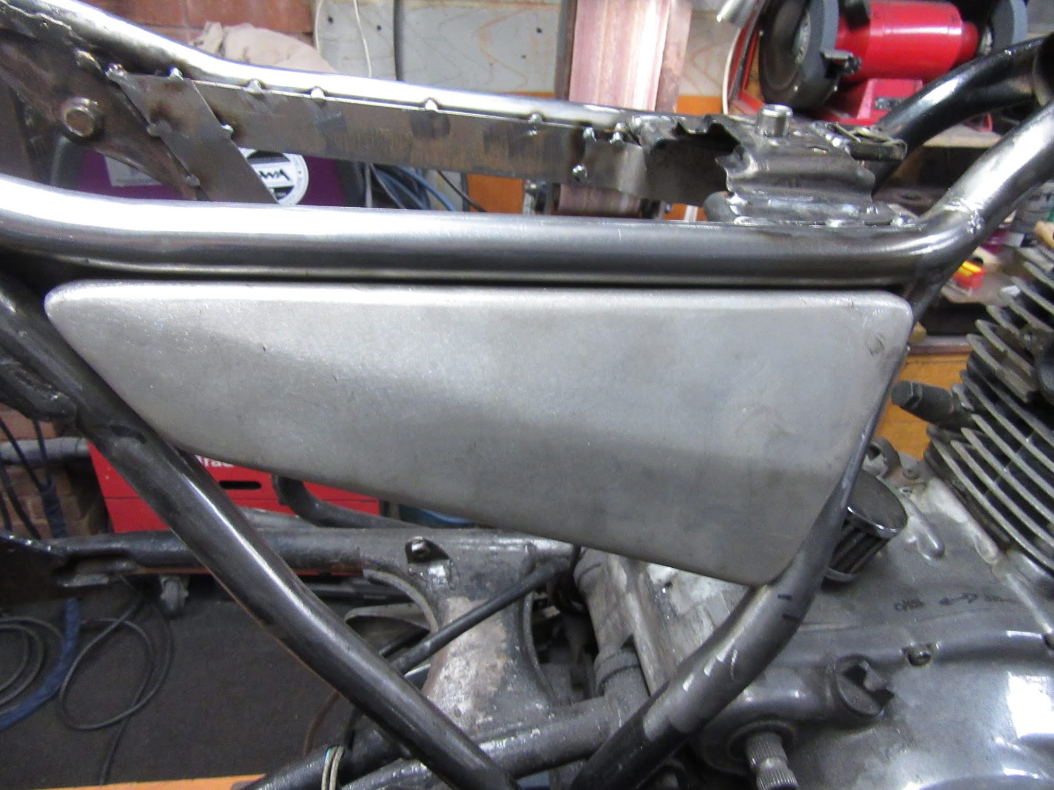

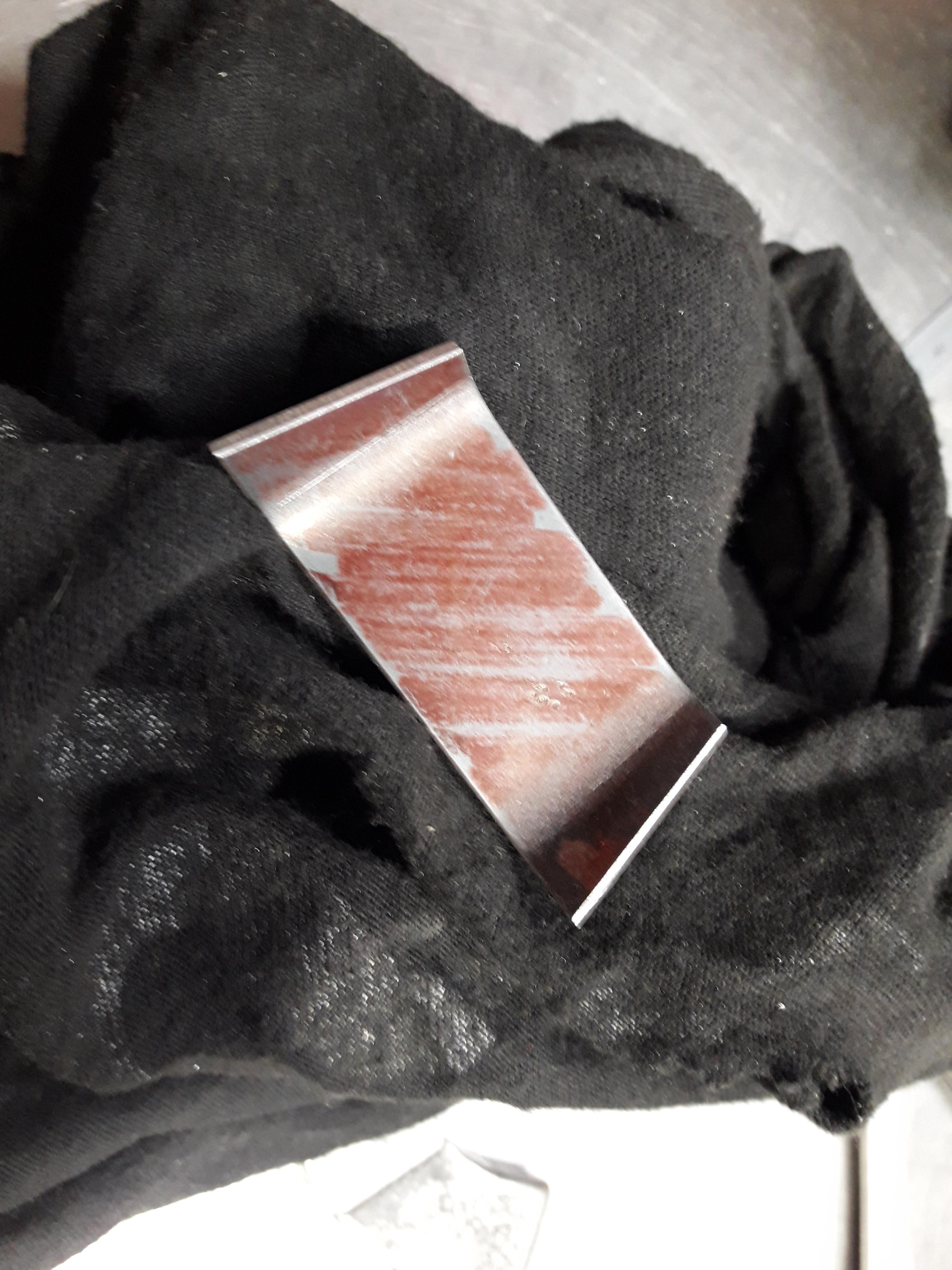

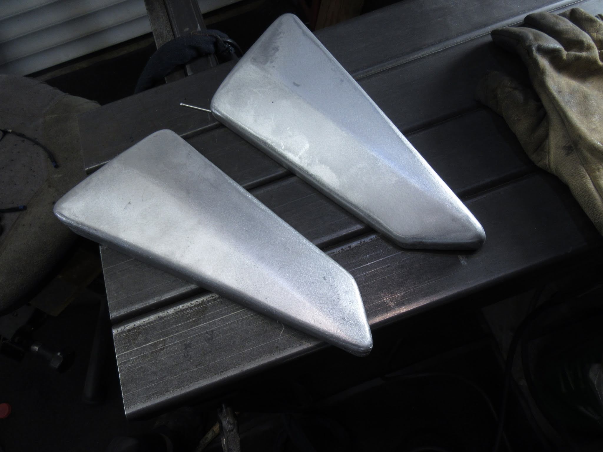

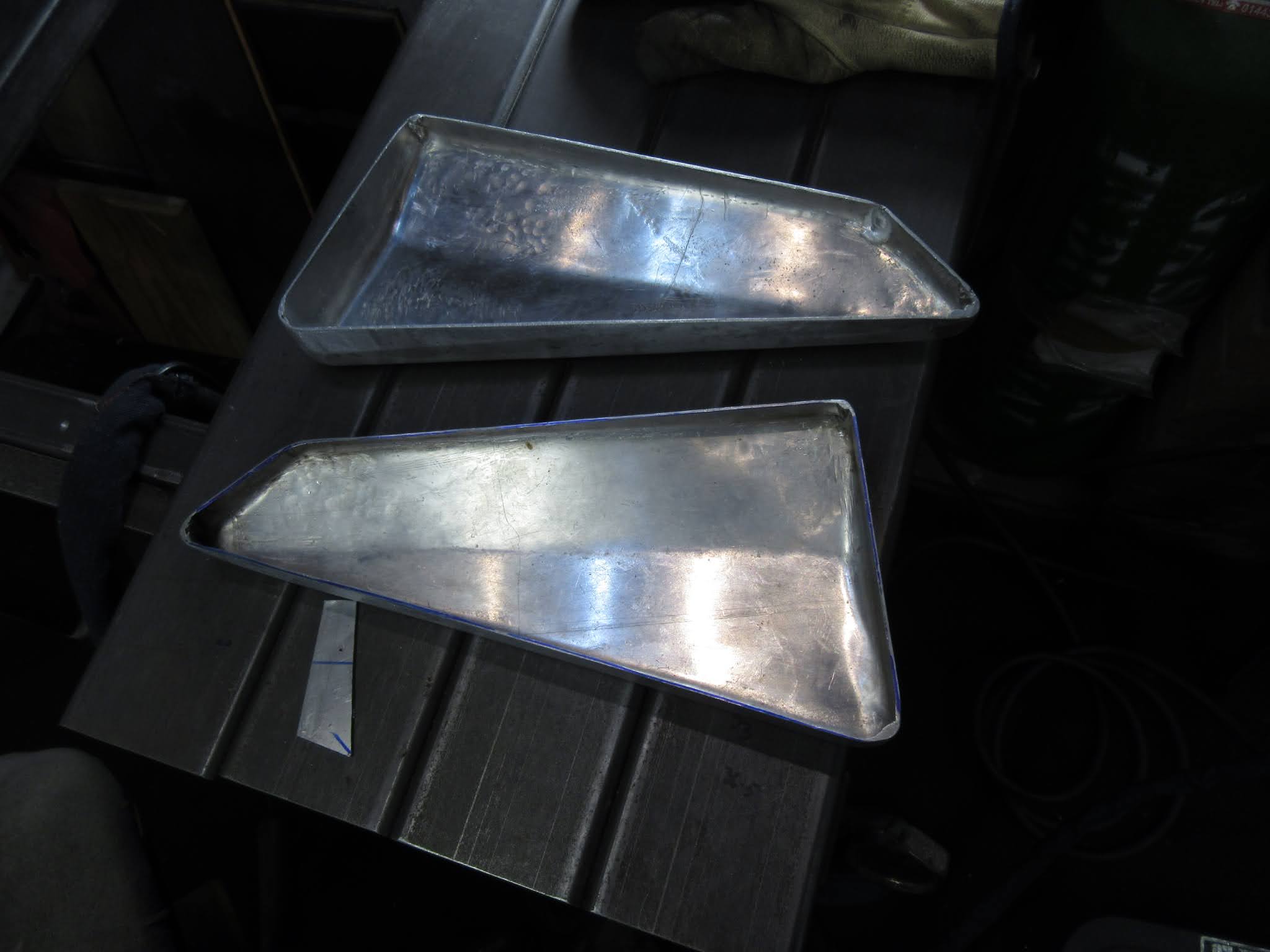

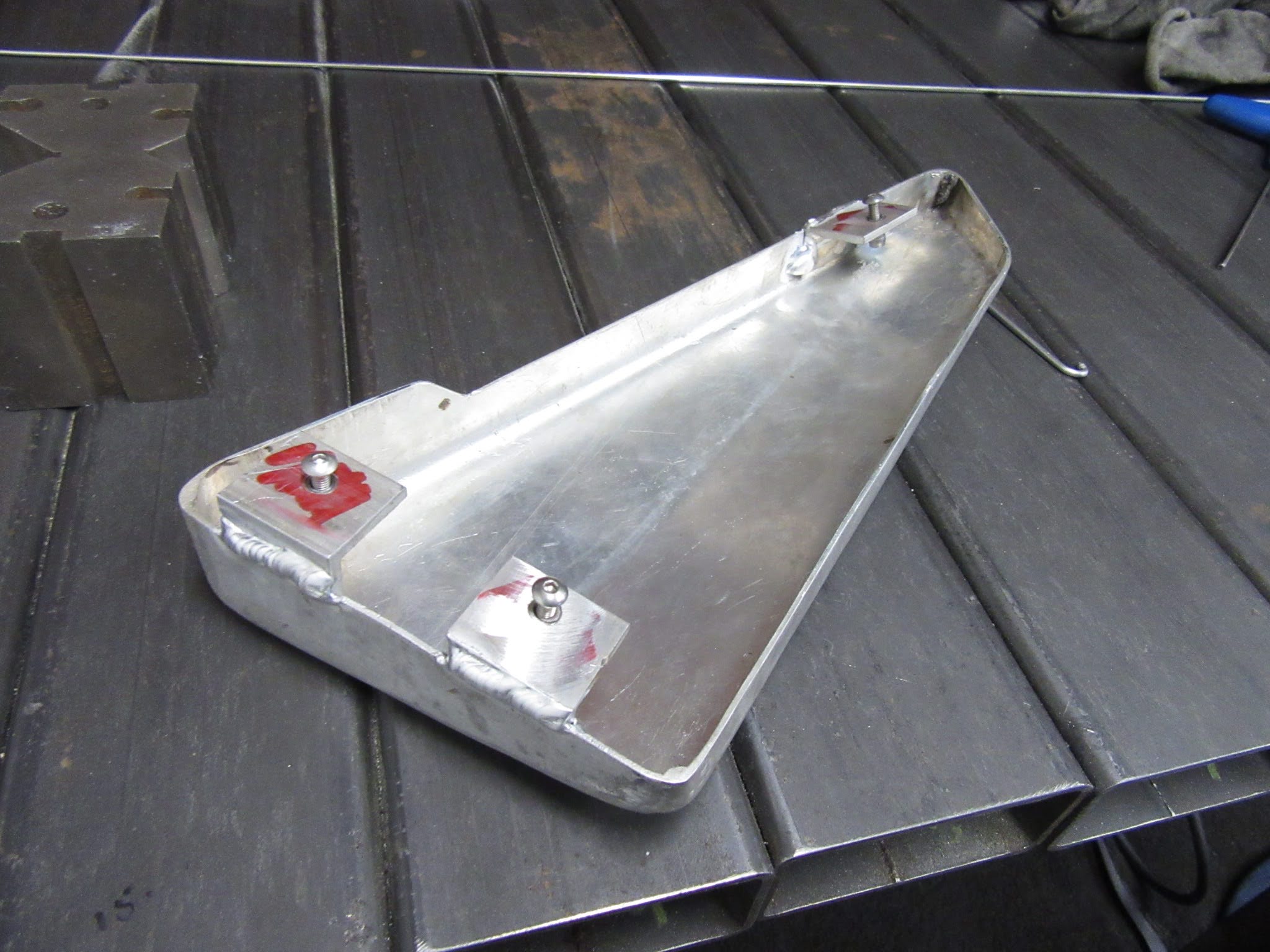

Making one was hard...................making an identical one was even harder!!.........Hats off to those metalworkers who make all them fancy compound curvy things !!
Everyday's a school day, quite satisfying turning a flat sheet of aluminium into something 3 dimensional with some hammers and some wood!
Had to get creative with some brackets to hide the fixings. That's where all the time goes in these builds, hours and hours of head scratching, measuring, cutting welding, grinding off re-welding then more grinding then getting it to look decent !
