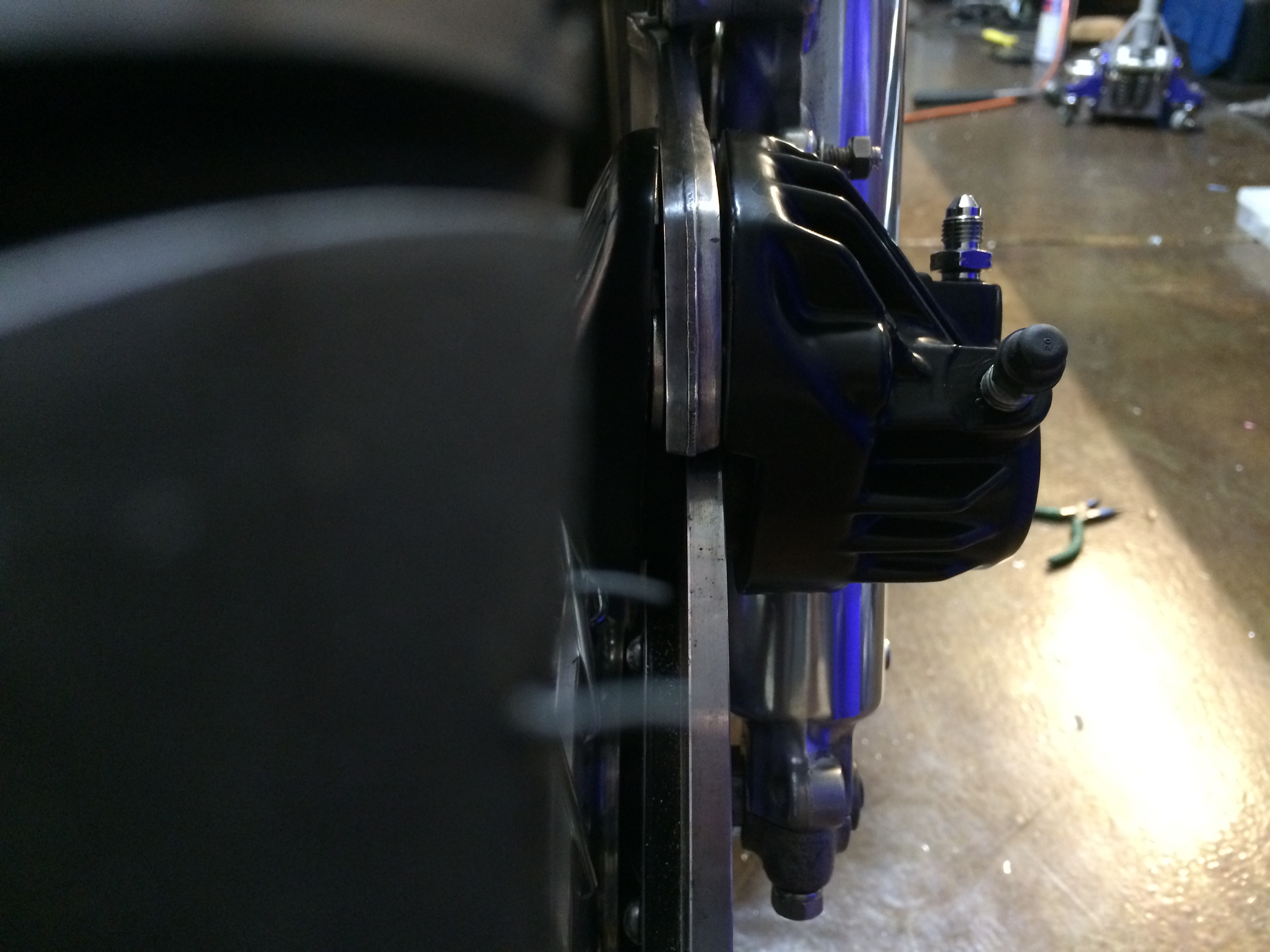

A pic like this or one from the front showing the offset would certainly be helpful.
This is a 360, but should be the same set up.
Here's a pic, i adjusted the caliper arm to be parallel with the tire to compare with the disc

Compress the piston all the way in, loosen the adjuster screw so the caliper "flops" back and forth. Apply the pressure and then adjust screw to locate the arm and you should be good to go.
