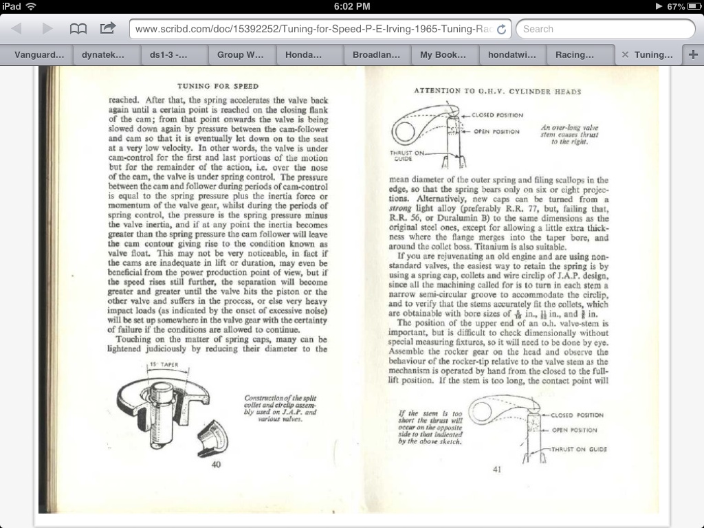

Is there a formula for determining when valve float will take place? That moment when the equal and opposite reaction of the valve spring fails? Is shimming a valve advisable to reduce valve float?
