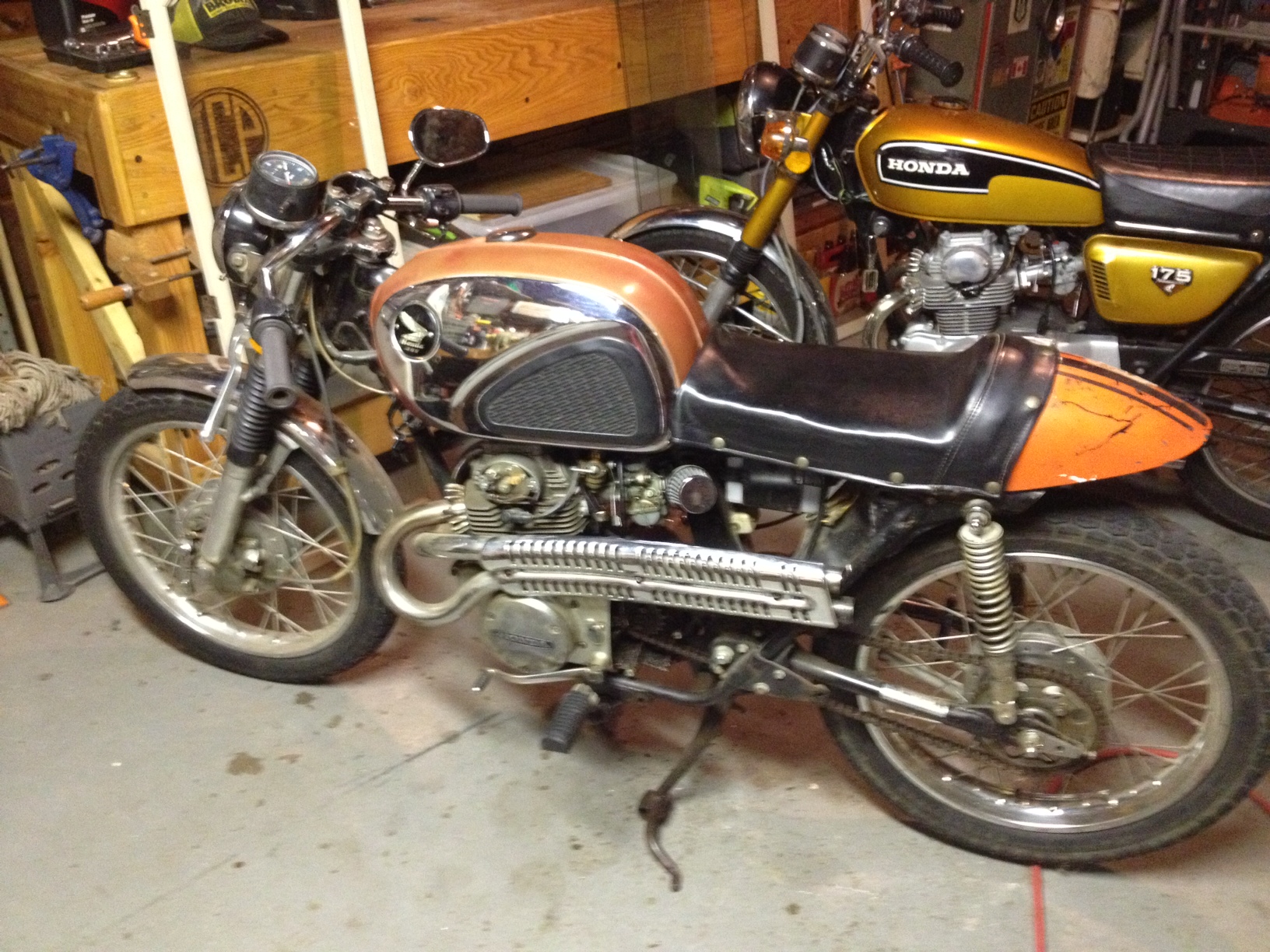

Looking for the Petcock for this tank. It has an extra fuel intake port, since the tank doesn’t have a left to right crossover line.

I have had a slew of CB72 and CB77 twins over the years. Some street and most were race bikes but you are right. That is what the tank is from - a CB77 Superhawk.
It's a super hawk. As mentioned, try honda305.com .
or this…
http://www.ebay.com/itm/HONDA-CB77-CB350-CL350-CB360-CB450-CL450-CB550K-DUAL-OUTLET-PETCOCK-/371000271039?pt=Motorcycles_Parts_Accessories&hash=item566156e0bf&vxp=mtr
Thanks, but that's the issue I'm having. The Ebay link you sent as well as 305.com is the only one i can find and is currently on the bike. The original has an extra inlet line for rt side of the tank.
Yep same here and that's the petcock I cant find anywhere. All i here on other sites is plug the rt side tank line and tip the bike left when you run out of gas.
If you can't find the right petcock - like that one shown above, you may have to weld a short 90 degree barb on the petcock side of the tank to connect the two sides.
i agree. either find a used petcock on ebay and buy a rebuild kit, or weld a connection for a crossover and use whatever petcock you want
