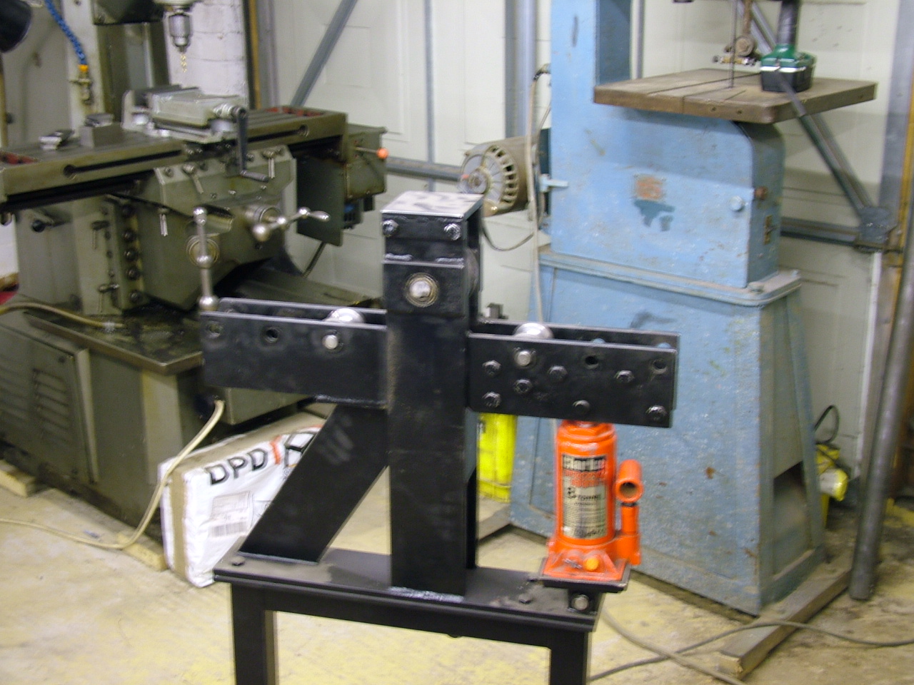

Cnc bender whats one off thoughs :) no I use a jd 3 bender and make exact patterns before I start and a home made bender for nice long curves.

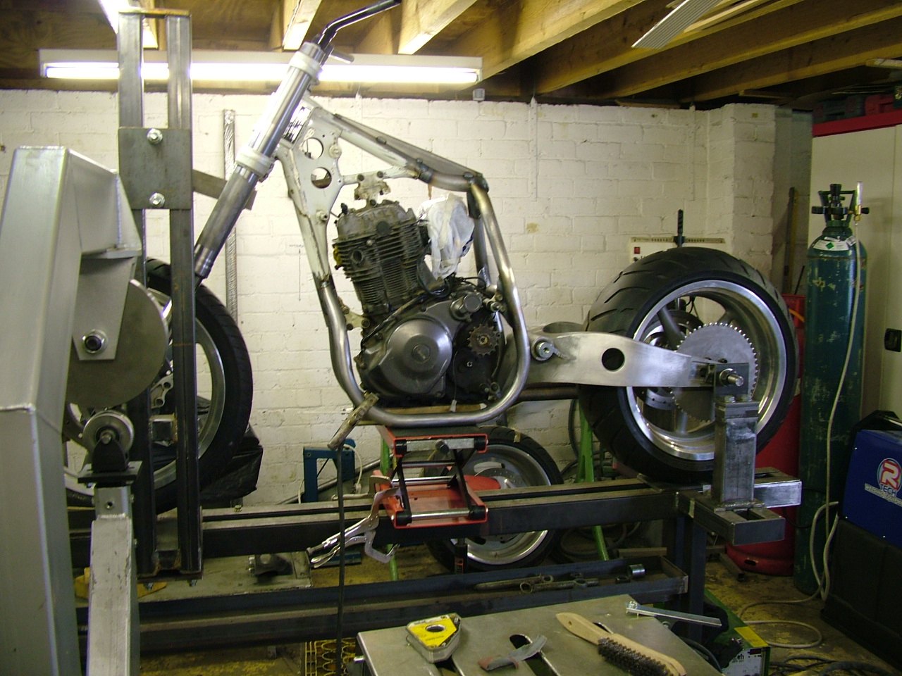

Frame's looking great - just make sure you can get the engine out ;) - looks pretty tight.
Nice homemade bender! I was looking for a swinging point but didn't notice the (quite obviously there :P) mini-jack.
Those are good for about anything huh?!

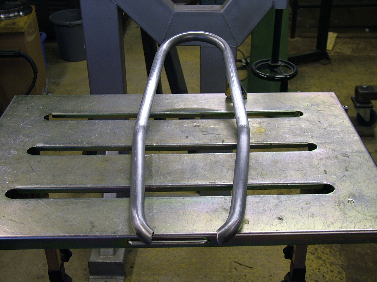

Hi its been a long week but here in the Uk we have a three day weekend so I should get a bit more done on the build I havent done to much this week been busy with other projects here are some photos to bring you up to date
thanks to everyone for all the feed back.

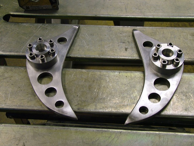

Well got a bit more done over the weekend built the rear subframe and made the mounts for the swingarm.

Damn fine work mate! I'm subscribing to this! May i ask why you chose to bolt the bushings for the swingarm instead of welding or using a thicker piece of material?
You're a craftsman, but i wouldn't expect less quality with tools like that ;)

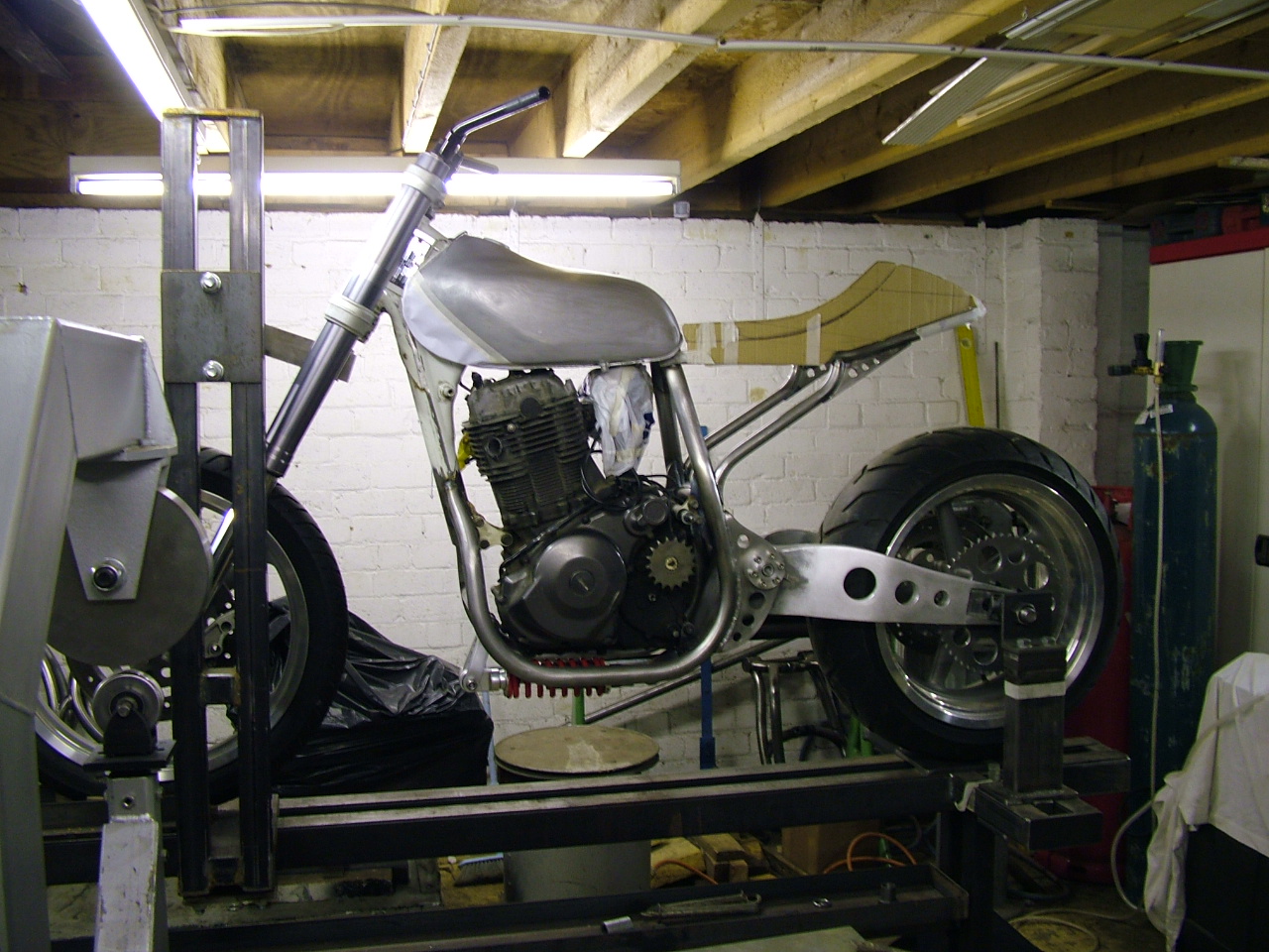

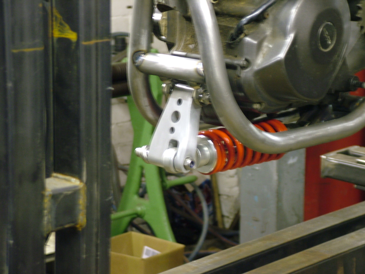

Hi all sorry I havent been on the forum lately had a bereavement in the family and lost intrest for a while anyway back on track know hopefully. Ive mounted the rear shock and alteard the swing arm put a bit of air in the rear sproket I also had a tank of a another project that with a bit of alteration could look quite good.

oh. my. word. that new subframe is gorgeous, beautiful ideas and craftsmanship! and that tank is awesome, i dig the vintage motocross look. can't wait to see where this goes!
