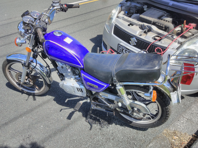

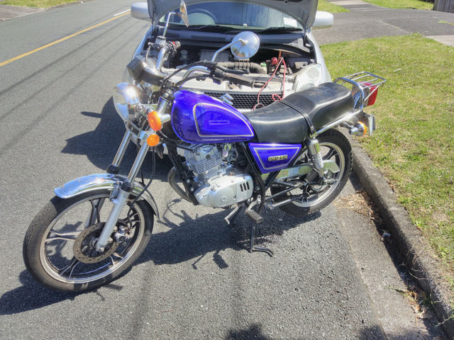

Morning, I just wanted to share the progress I had made so far in my first rebuild of a GN125 to a Tracker style bike.
Here are few pics of the original bike.

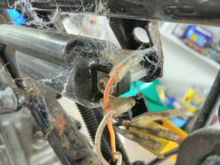

First off the bike wouldn't start, but after cleaning out the carb, replacing the gas and the plug it started to fire up, but still stalled with any revs. This confirmed compression was good so next step was to take the thing apart.
There was quite a bit of surface rust and a family of spiders had moved in, but over all not too bad.

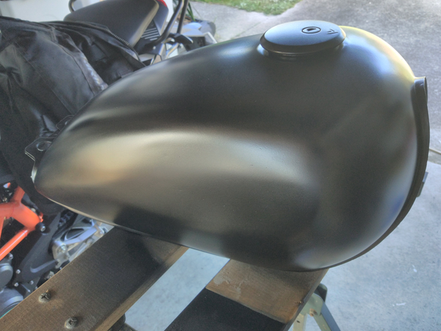

Next step was prepping the tank. I looked at soda blasting it, but to be honest it was already in pretty good nick, so just some elbow grease, steel wool and a sand and it was ready for painting. Here is used VHT again with their Engine Enamel products.

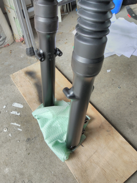

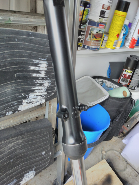

Next step was to prep and paint the front forks, once again I used VHT Chassis and roll cage paint here. I also put the shocks back together and added the dust gators.

Time to remove the Suzuki logos from the tank and fix the big dent on one side. I also wanted to change the tank shape a bit for a better look. A quick prime to stop rusting for now. Proper paint job to follow at a later stage.

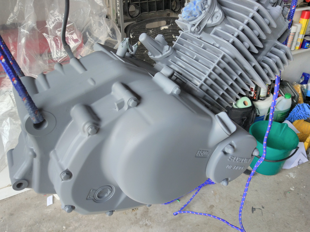

Engine back in the frame and put the tank back on just for looks. Putting the engine back in was a bit of a nightmare, much easier getting it out. So far so good.

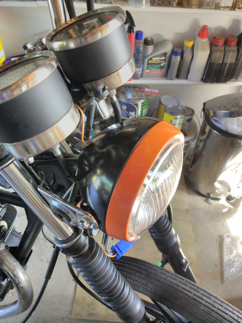

Replaced the crappy old grips and the entire front brake lever and brake fluid until as it was leaking and faulty. Put the new seat on just to see what it looks like, still need to cut the frame and add the rear loop. Also painted and replaced the plastic sprocket cover(Not sure if this is what it is called.)
