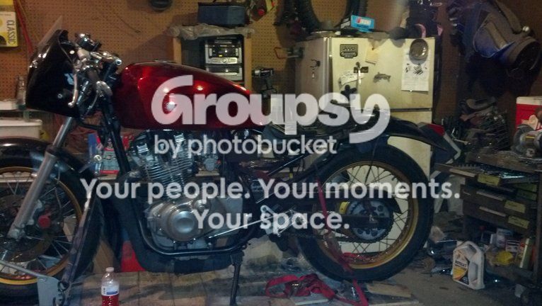

I've got a GS850S with that same BIG tank, in the garage waiting on me right now. This tank was going to be my first foray into hammering in some knee dents. Glad I got to see your work first :) Love the bike!
Big Rich said:
1980 GS850 "G" (the touring model). Before I hammered in the knee dents it had a 5.9 gallon capacity - compared to my current 3.9 gallons. I'll post much better pics and more details later tonight.

OK Rich lets solve that emblem problem . Take the tank off and bring it down to me and we can fill in where the original badges went . With that color it would be ashame to cover any of it .

All good Kevin! I have a pretty solid plan of action about that......it's just going to be one of the last things to get done though.
Thanks though man! I appreciate it.
Re: Suzuki GR650- The massive tank has the greenlight!
Let me know . We can smooth that out and make it look like glass . Just skipped threw your thread and everything looks awsome .

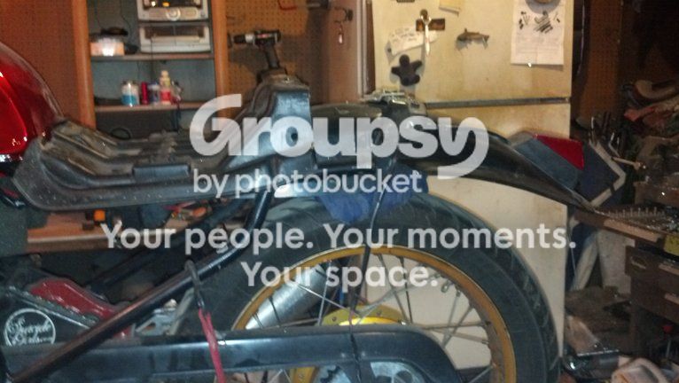

Forgot to update this! I started removing the tray for the electrical doo-dads, and wanted to get an idea for the final shape. With no massive fiberglass ass, I need a proper rear fender, and have this one laying around (ignore the generic tail light, it's already unbolted):
Bear with me, the seat needs finished obviously, but any objections to the shape / placement of the fender?

Rich,
Maybe it is the tail light throwing it off. Looks like it needs to come forward and down slightly to better mirror the shape of the wheel? Could just be the picture but it seems to be at an odd angle and kinda sitting like a dirt bike fender right now.

It does stick out a bit but his solo seat is pretty pointy too, so IMO it wouldn't look bad.
Re: Suzuki GR650 - rear fender fitting......
This is going to be your distance bike right? I say the fender is fine and you will be happy if it rains. Maybe do a small cowl to tie the seat into the fender like I did on the CX? You can hide a few electric bits and put a tail light in it.

I'd need to see it with the tail piece on but yeah I reckon bring it down more in line with the curve of the tyre.
It took me ages to figure out the best position for the GTR1000 front guard I put on the rear of the 450.
Take your time and fiddle with it 'til you're happy Rich.

Thanks fellas! Right now it's just balanced in that location, being pressed into the frame with an old rainsuit between it and the tire. I'll move it forward a little to expose some more of the rear tire. No worries Mike - the license plate will be hanging off the rear for rain protection.
