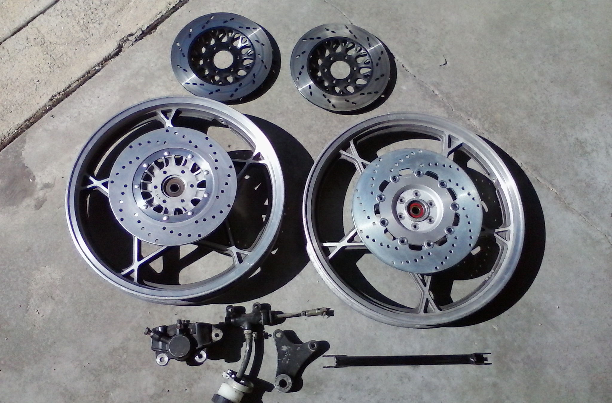

Are you wanting spokes or 'mags'? I do have an 18" rear setup for sale. It is disc brake but I have all the components you need to make it work if you decide to go that route. It is in great condition.

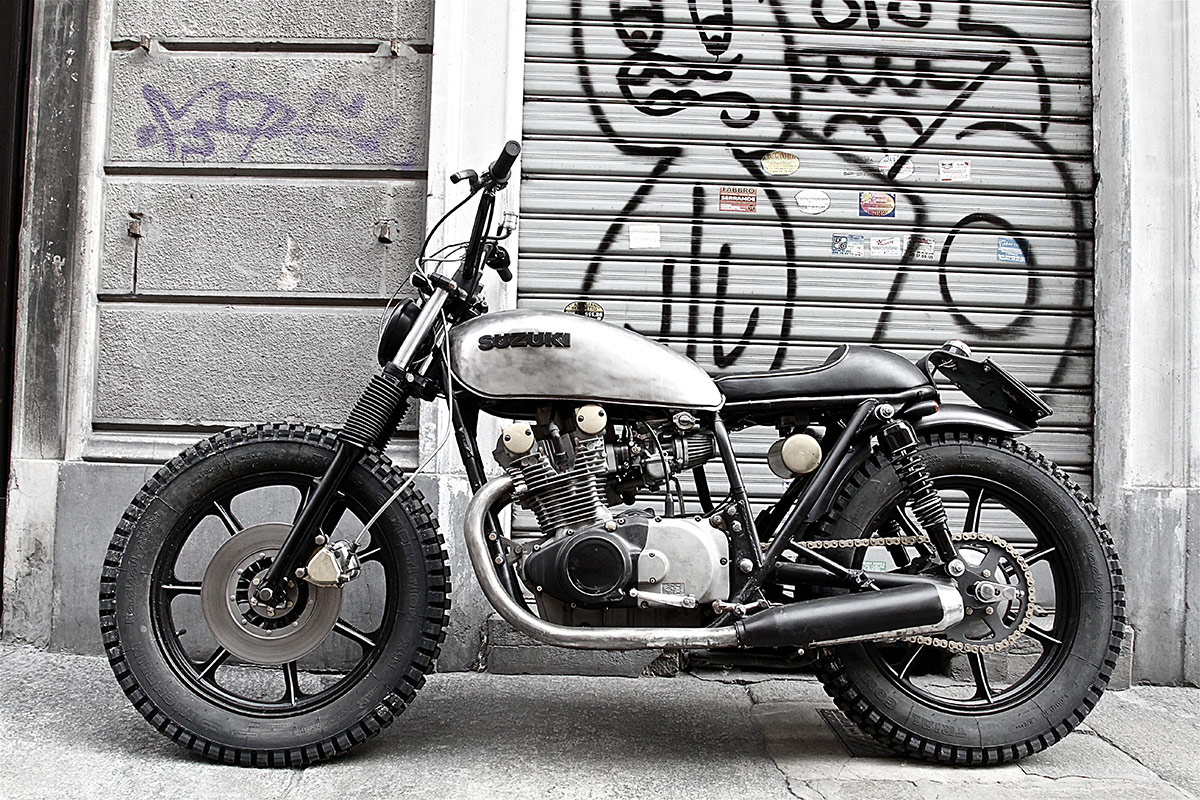

Hoping for the Kawi mag style like what was used on this GS400:
http://www.bratstyle.it/suzuki-gs400-urban-tracker.html
They've fitted trial tires 4.00-18 which I hope to do as well.

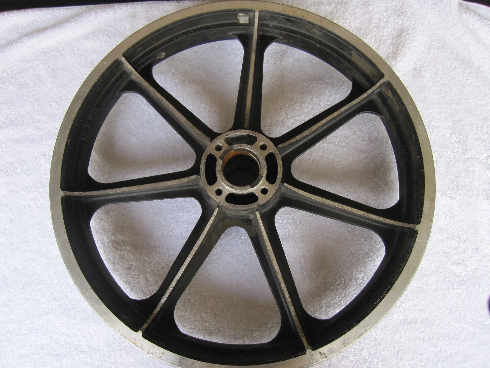

DOHC - Is your 18" rear set up along these lines?

If you want that 'Kawi mag look' you're gonna have to buy Kawi mags. Mine is a Suzuki wheel.
As you can see this is not as nice as my wheel but here is another picture of the pattern without the disc in the way. I'm away from the shop at the moment but I can post more pics if you are interested.
Again this is not mine just an example:
Trials tires on a street bike are a bad idea. For pictures only.
18" Kawi front mag will be tough to find.
Also hopefully you realize that the bike you posted as a reference is a total p.o.s.

Dohc - Those wheels are in great shape; though probably a bit narrower width than where I want to take this project. I'd feel bad putting them on a scrambler when someone could use them for their suzuki cafe build.
I did pick up an 18" front KZ wheel measuring 18x2.15. Only trouble is that it's a 4 bolt pattern whereas the GS450 uses a 6 bolt. Couldn't resist the price so got it just in case I am able to find a disc and bearings that will allow things to mesh together.

Surely you will run a front fender, right? The bike pictured above has dirt bike tires and no fender which is plain ass ignorant and looks retarded to anyone that knows anything about motorcycles.
The bike in that pic would be nearly unridable in anything but a clown show.

I think the bike in the picture was built purely to tackle the cobble streets of Italy... It is more just guidance for how I'd like to mount the tank and the 18" wheel/tire setup.

Couldn't ride that bike 2 feet without the tire hitting the rear fender. Whatever they built it for, it's built completely wrong. The front has been lowered internally to a point where it will bottom out too. The seat doesn't match at all and forces you to sit in the most uncomfortable position possible. Its a complete pile.
