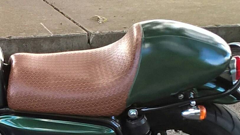

Strip te K&Q seat, strip all down to the pan, and you have a pan that can be modified to your ideas, then build up carpet padding (rebond) and shape with an electric carving knife. Glue layers with 3M 80 spray adhesive (Home Depot).
You have any pics of the process from when you did it? Sounds like a good idea using the pan that’s already there
I have some from the cafe-style seat for the Hunley. For it, I had found a fiberglass seat pan on ebay for $30, but it could have been done with a K&Q - just change to pop-rivets for mounting the cover.
The "hump" is just built-up on a heavy foam block. Use 3M 80 spray adhesive to bond all and an electric carving knife (NOT hers!) for cutting/shaping. Often you can find tear-out or scrap padding for free.
I bought the vinyl online and had an upholsterer sew it, but wish I'd done it myself.
