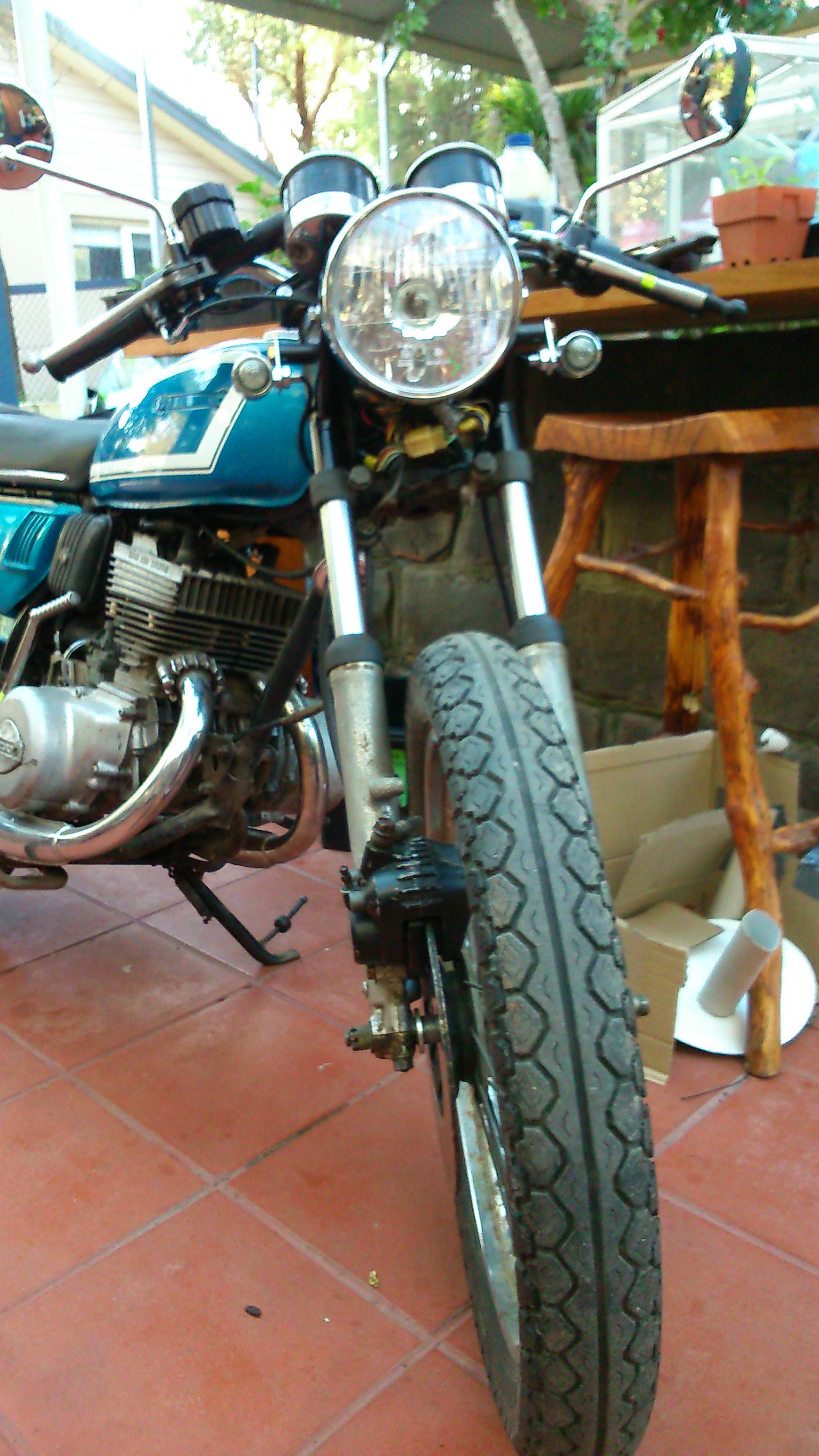

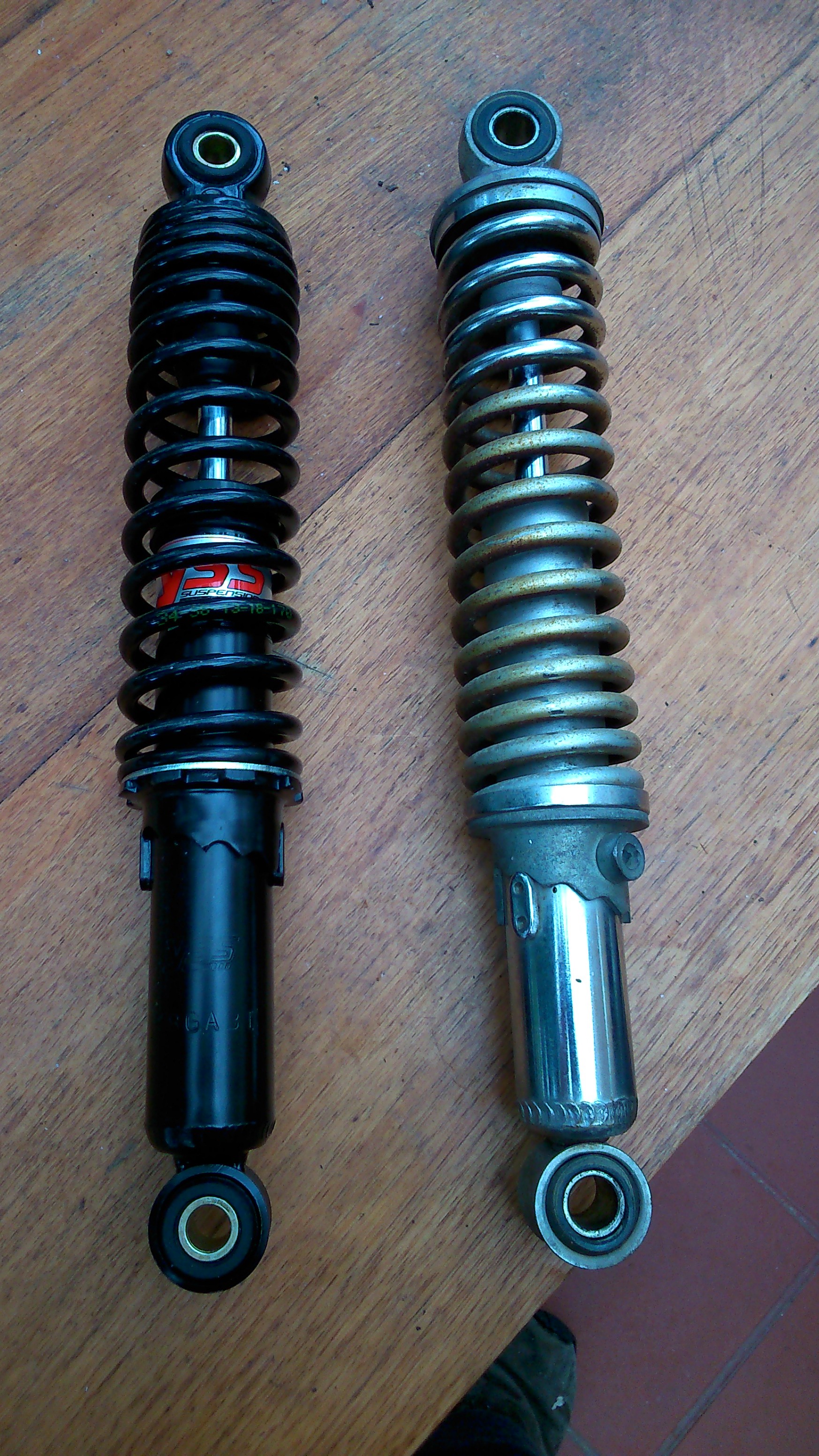

New shocks arrived yesterday! YSS 300mm
The original suspension leaves a lot to be desired! Rear was hard and bouncy with bugger all sag.
Front is soft and bouncy. Seems to be no damping at either end.
I now have 5mm static sag at the back and 25mm dynamic with pre load set on its lowest setting.
oh, and the shocks feel like they have some damping!
Looking forward to a test ride. Then to see what i can do about the front end!

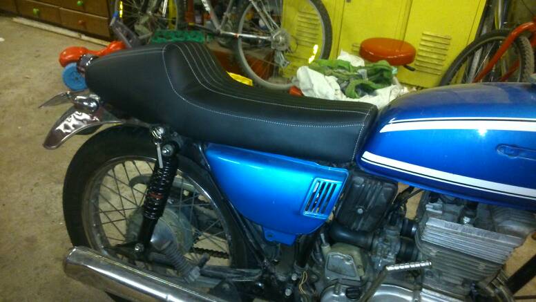

New seat from Texavina just fitted.
[/IMG]
Also some clubman bars and fork boots
[/IMG]

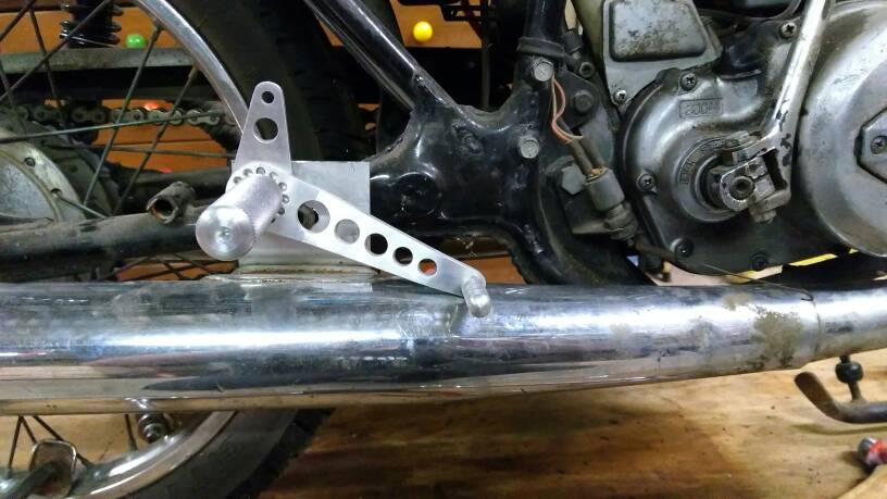

Parts bike is really rough but the exhausts are what I wanted off it. Next was to work out how to fit the rear sets. Removed the original foot pegs and brake then made a template to mount the rear sets to. Need a shorter linkage for the gear change and to modify the brake rod.

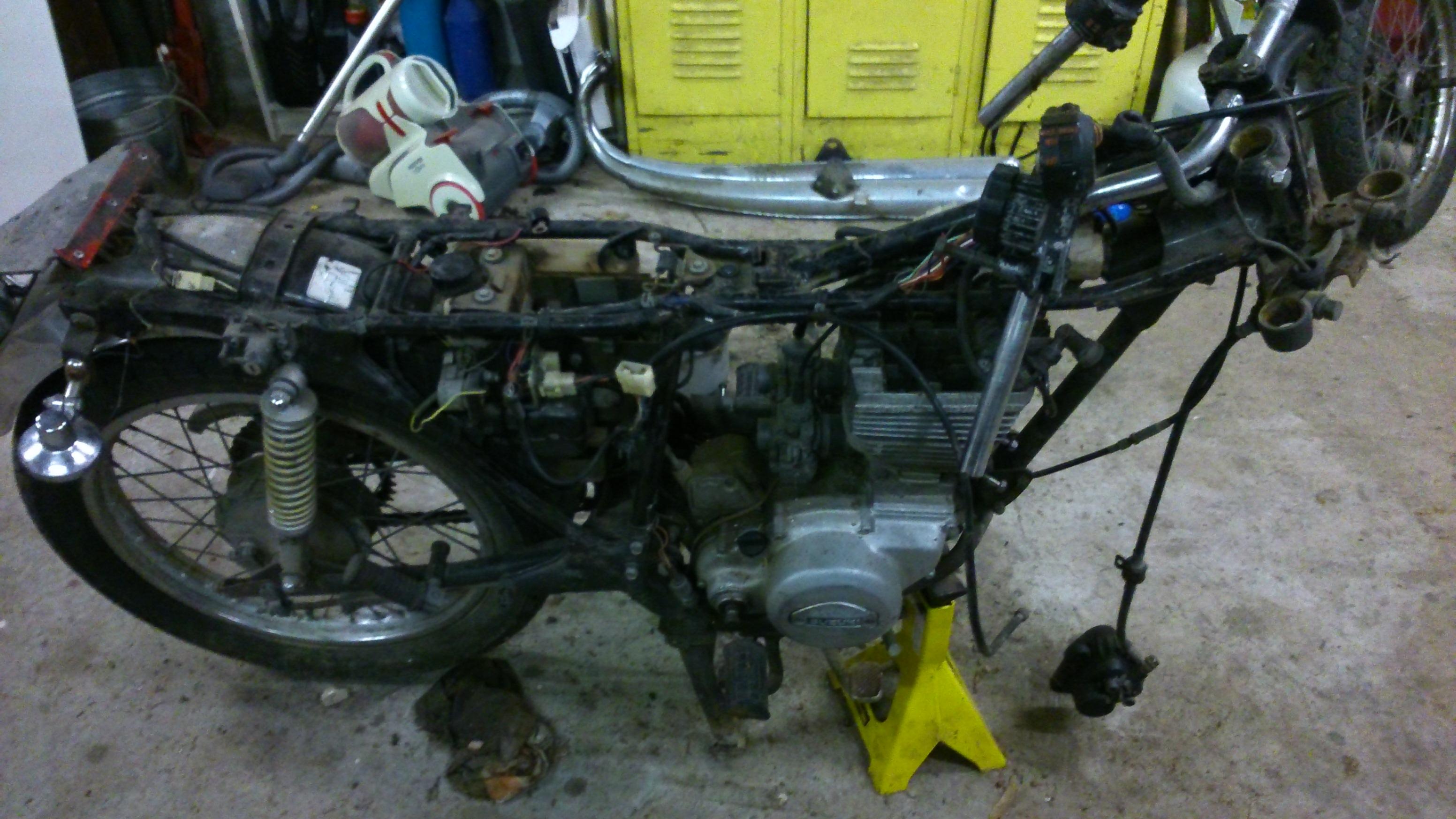

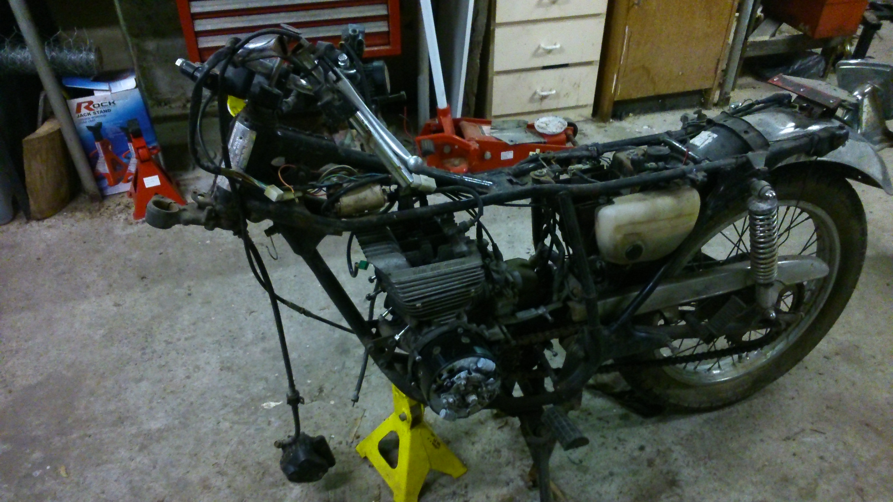

The strip down has begun. Hopefully have the frame bare by the weekend so I can clean off 38 years of grease, 2 stroke oil and dirt. Then prep it to paint. Project bike on the stand, parts bike on the bench.
Sent from my Moto G Play using Tapatalk
Re: Suzuki GT185 1978 buils
Frame is all stripped down, degreased and pressure washed
Started work on the frame swing arm and centre stand. It's going to be a bit more work than I was expecting. There is more rust than I thought, nothing to serious though.
