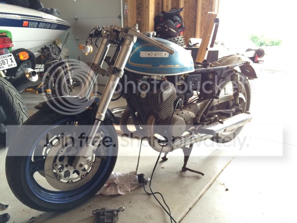

just for the hell of it, I threw on a GSXR front end that I had laying around in garage to see what it would look like.
I really had no intention of using it. The rear sprocket offset and narrow swingarm would have made it pretty difficult to fit a suitably larger rear wheel back there. I had though of maybe using an RD swinger and rear mag wheel but I still would have needed to deal with sprocket offset. Plus, I wanted to keep this more of a classic appearing cafe racer.

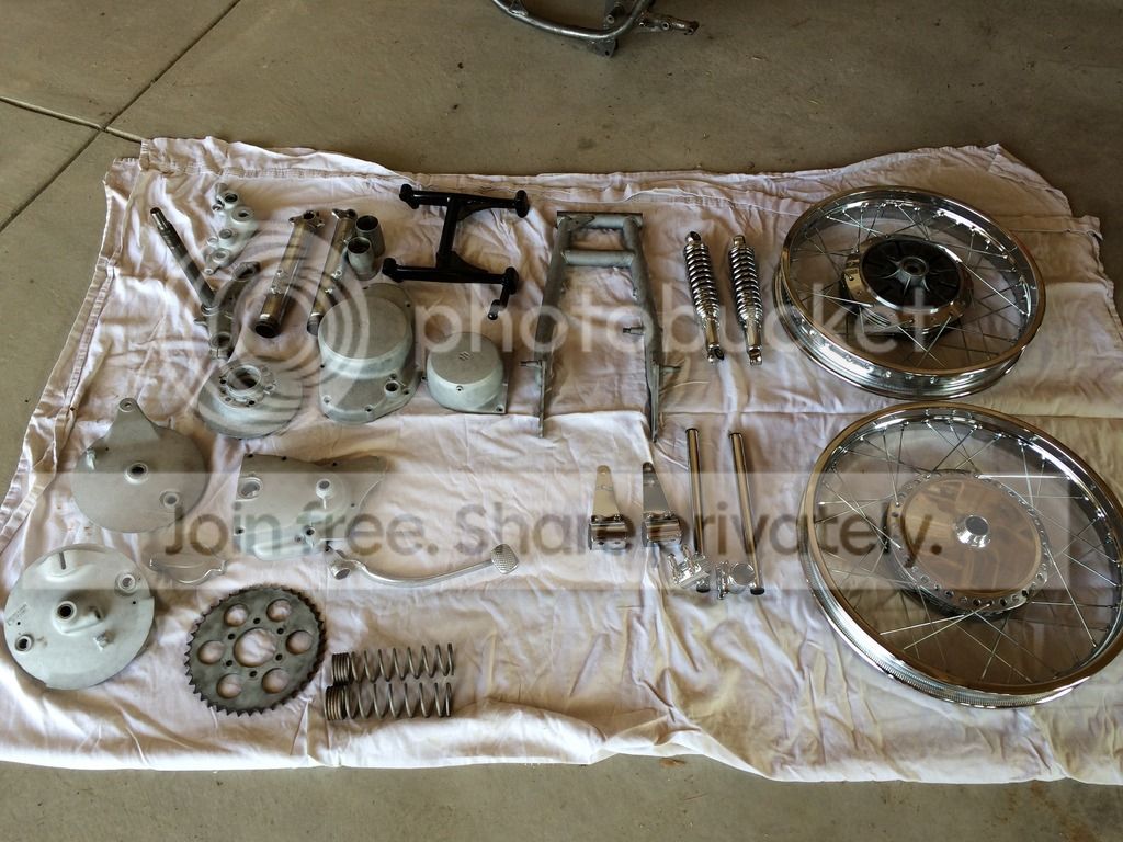

Paul Miller Vintage supplied some of the new parts that I ordered up right away.
Brand new, NOS rear shocks..
Brand new front and rear wheels and hubs made from NOS parts. These cost a fortune but were still cheaper than getting them made from Buchanon.
Also spent a day in the sandblasting booth getting all the rust and crud off everything.

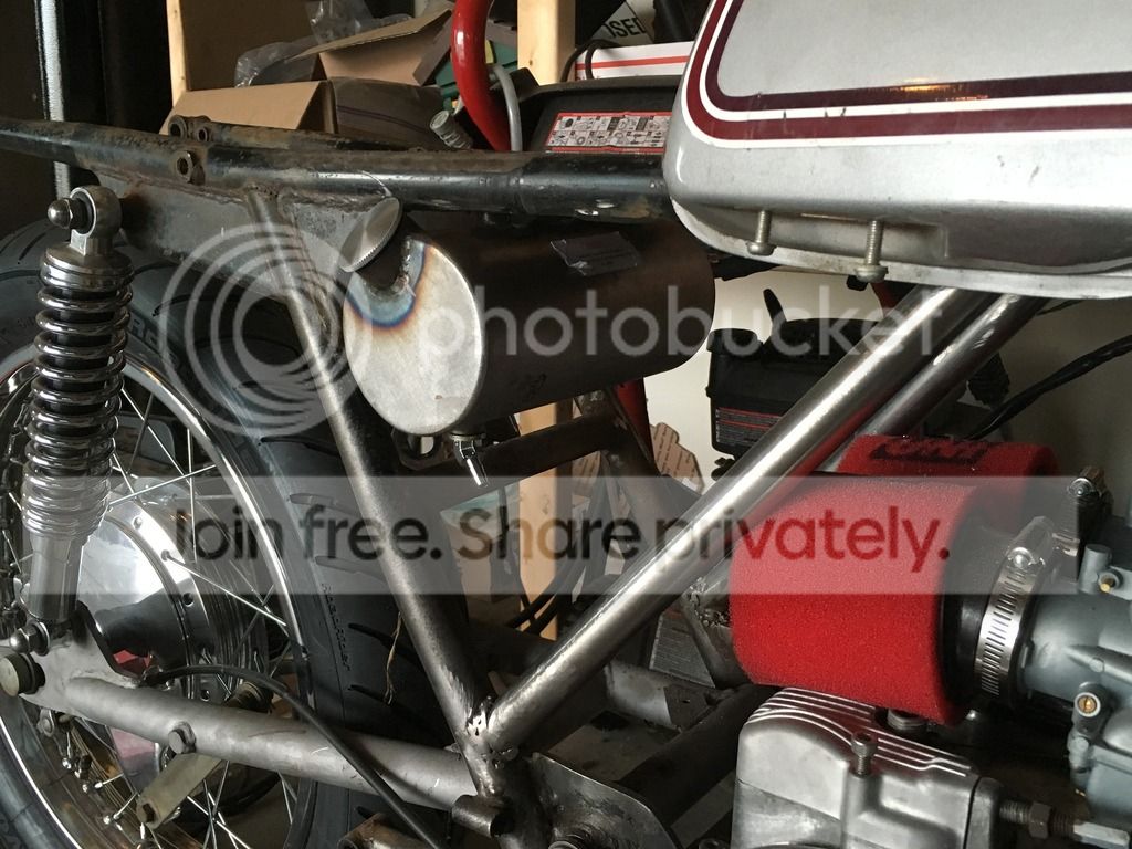

found a guy online who makes oil tanks. I sent him specifications on sizing, outlets, etc and about four days later I had an oil tank in my hands. Only cost about $100. Welded up some tabs to mount it on the frame.

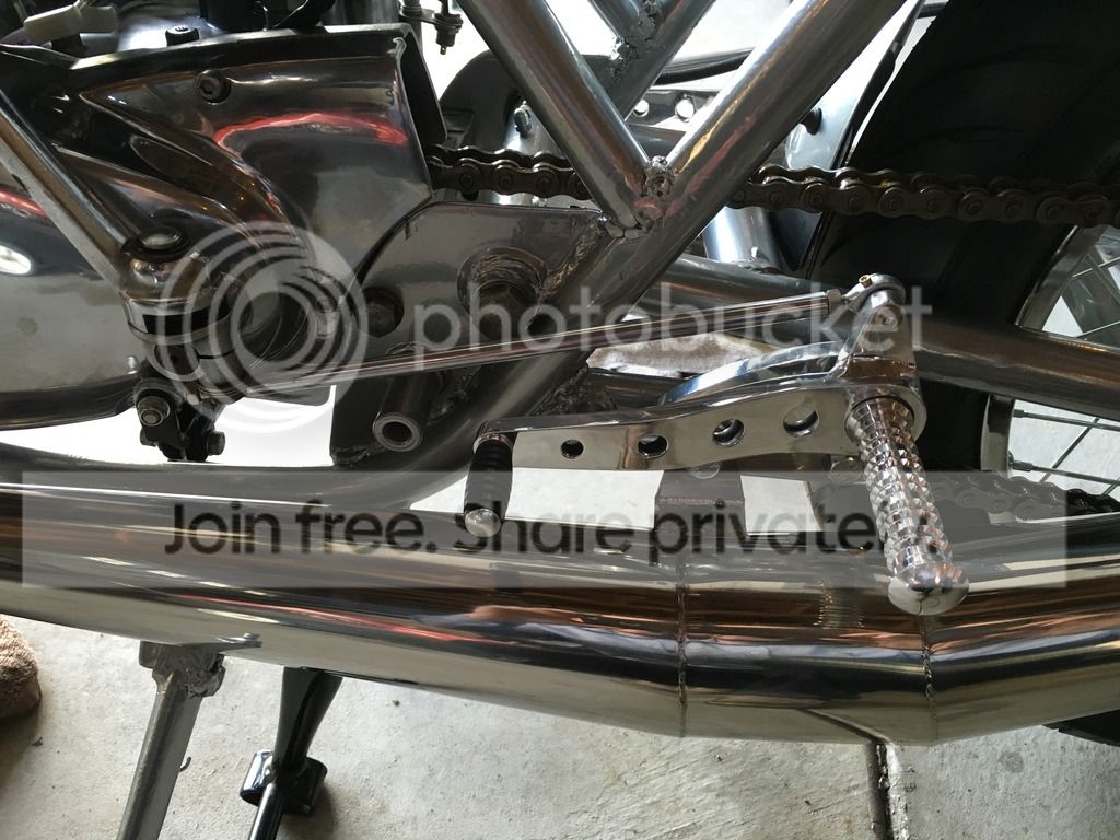

meanwhile, a few months prior I had also ordered my rearsets from Titan in the UK.
They took an eternity to build, but in the end, the rearsets turned out great. As far as I could tell, these are only one of two custom made rearsets availble for this bike. The other company is in the USA but they aren't polished and don't look nearly as nice in my opinion. The kickstarter (which is on the left side of bike) had some clearance issues with the left rearsets. A local machine shop heated the kickstarter and put a small bend in it. This helped but it still contacts every few kicks. I plan on having them bend it some more.
