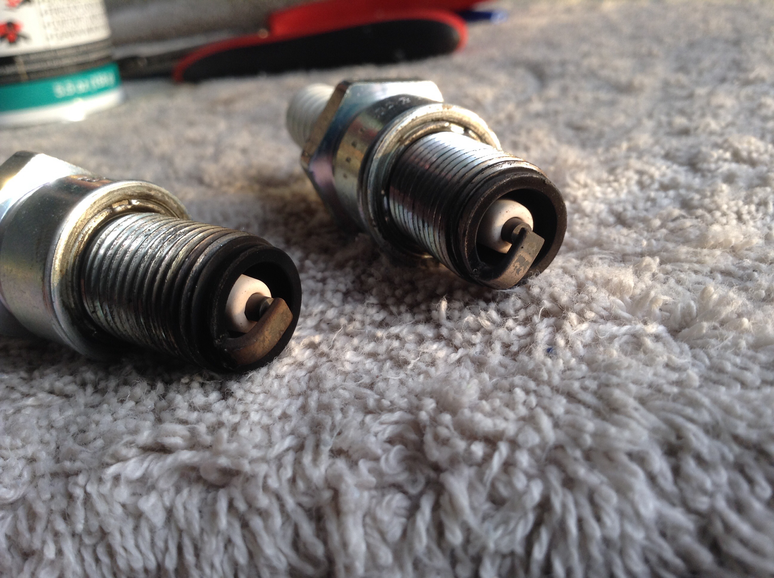

Ok so I stand corrected, after a longer ride the stumble is still there. And if you enter the stumble zone slowly it takes longer to recover and pass thru it. If you just crank it wide open its less noticeable. Here are the plugs after the ride.
So now my current set up is #3 slide, 159 P0 needle jet, #6DH7 jet needle with clip in the bottom slot (richest). The bike seems the happiest so far. Just can't run a steady 5-7k RPM with throttle between 1/2 to 3/4 without sputtering. I also checked compressions found to be even at 120 per side, 150 if I do it wide open throttle. Not sure which way is best.... Spark looks good as well. Anyone have any thoughts I'll read them. I wish I had a dyno and every needle and jet needle in the book.
compression check is done with the throttle wide open always
seems a bit lean from the plugs i would try a larger jet needle if you have something around a p-4 give it a try see what happens
drop the needle down a bit at the same time
I had a P5 in with the #6DH7 but it was worse. I even moved the needle to each slot and the top slot worked the best. I now have the #6DH7 in with the P0 and the clip in the bottom slot. Still stumbles in the mid range. It's a tough one to figure out.
