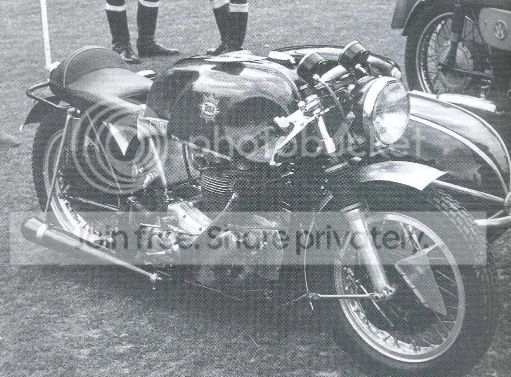

OK guys, another couple of outfits coming up - just to show that charioteers were no less resourceful than the 2 wheeler Cafe Racers. You'll also see that the chair guys were equally serious about the CR image.
ALL B & W pix credit to Mike Clay's "Cafe Racers" book.
This first one is a bit unusual in as much that you wouldn't normally pick a Featherbed as a basis for a chair. Not that there was anything wrong with that - in fact many FB based outfits were raced - but a Featherbed was probably twice the cost of a BSA frame [ single or twin ] and 4 times as much [ at least! ] for a Triumph, AJS, etc. In fact MOST Triumph frames were simply thrown away when the engine / box was liberated for a Tribsa / Triton .......... However, sidecar performance was not so dependant on having a stiff frame [ as the FB ] - more on geometry and a well attached third wheel. I suspect this one started out as a solo - a Norbsa. However, it has all the "good" chair bits - low, 16" alloy rims - and note the passenger [ sidecar ] grab handle behind the seat. That gave the passenger a good hand hold when attacking right hand bends / roundabouts. The passenger would lean as far out of the chair over the rider's seat, with probably just his feet keeping a purchase with the sidecar and get as much of his bodyweight to the right hand side of the outfit. You can also bet those meggas were straight through! This is one serious chair

Thanks for those TJ. That Norbsa must have at least 2" of front suspension travel! Very good looking outfit, I like the 16" wheels.
Some mad engineering going on,I suppose it was a case of 'necessity is the mother of invention'.
They all seem to use the same chair?

Yes all these chairs are Steibs - German and beloved of BMW charioteers. They were percieved to be better quality than our Brit Garrard GP - which was basically a copy.
In reality, it was much more a matter of how the outfit was set up.
