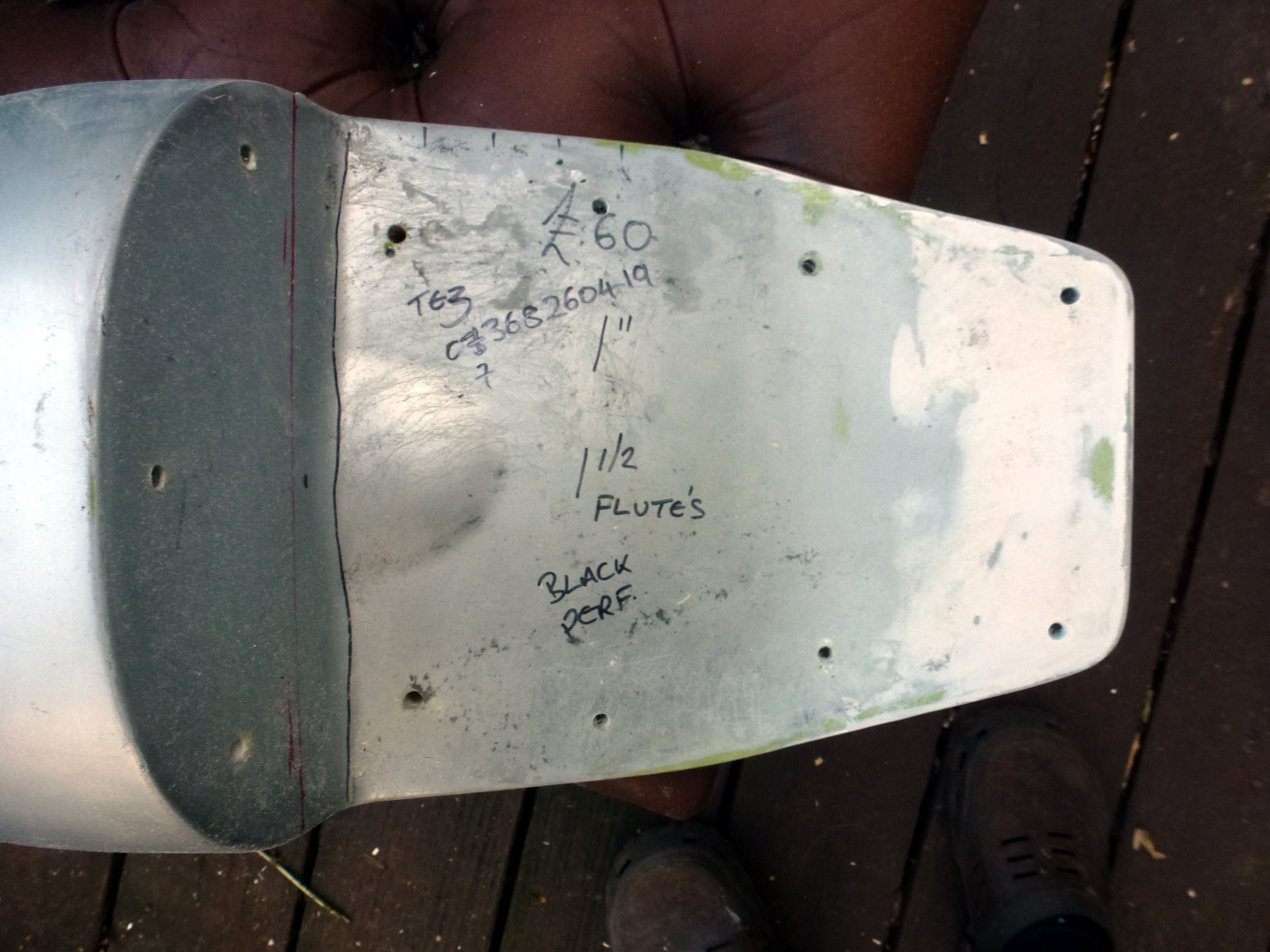

Actually, the upholstery base pattern has been completed and the stitching chalked out on the perforated Leather.
The trimmer wanted me to OK that before proceeding. Absolutely spot on and he's even found a Red thread to match the frame paint.
Also meant he is finished with the seat base so I could bring that back to complete the pattern making and final prep for paint.
In all probability after the Christmas break now - be a late Christmas present to myself !!
The seat is now fully fettled and shaped - a final wipe of filler, flat off and into primer. I've short listed two "Silver" shades and the 1/2 litre test pots should be here next week.
