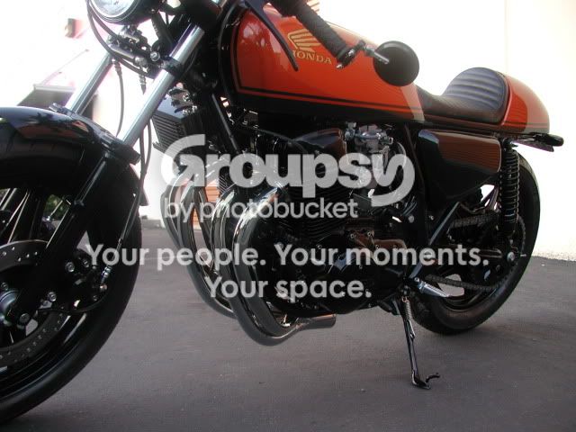

Re: The South Seattle Cafe project- 1978 CB750F
Yep, that paint is fantastic.
bikeboy said:Love that tank! Is that a metallic gold decal under all that clear? Looks awesome!
ian
BWJ said:Thanks for the props!
The counter shaft seal can be installed with the cases together. The crank seal behind the points has a lip on it and needs to be installed before the cases go together. Hope this helps.
Erskine said:Wow. Mint! I like the little oil pressure gauge on the casing. Nice detail.
