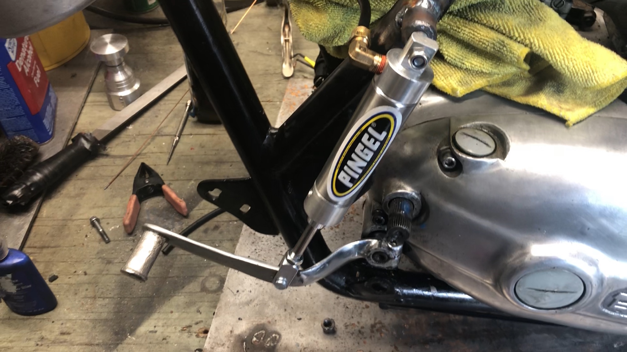

Combination rear set, brake stay, and lower wheelie bar tab.
My welding is getting better...not as good as Zeke. Hopefully I will finish the race better than my welds.

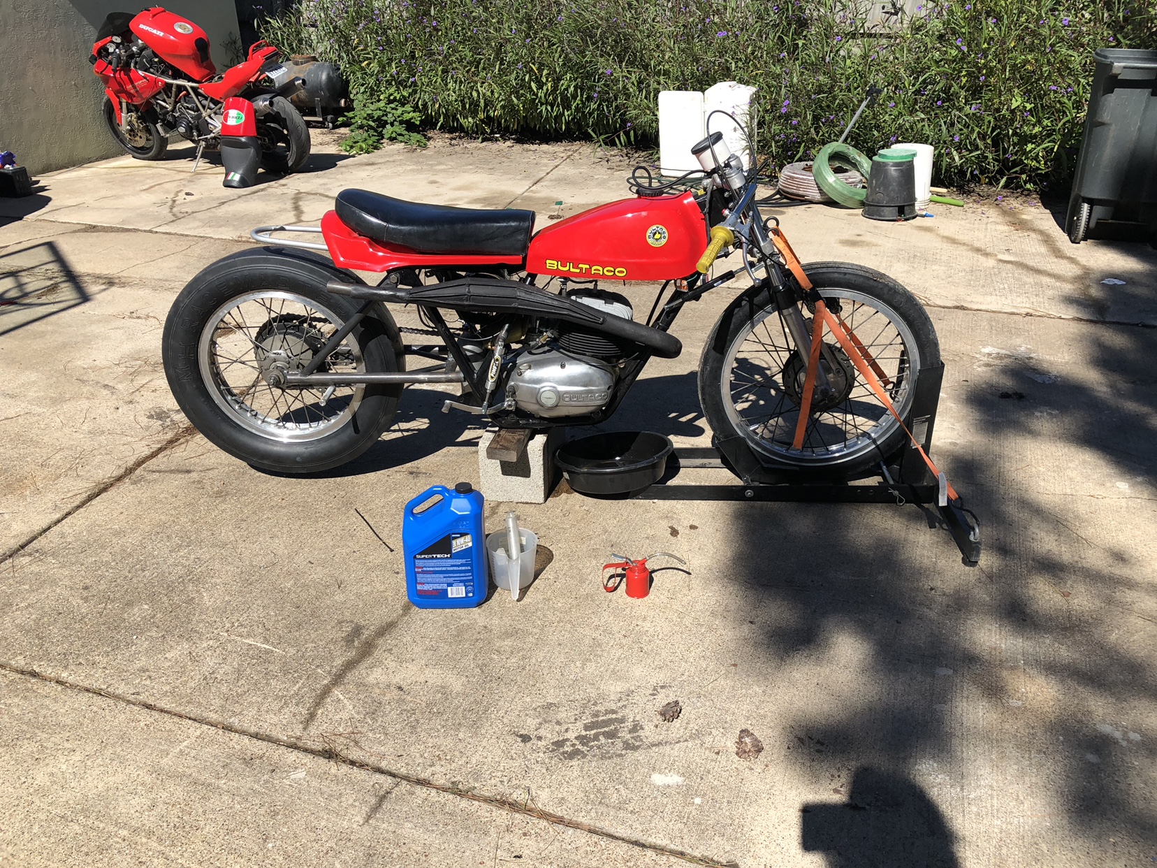

Well the Bultaco Drag bike is winning the weight loss challenge. I am down 15 lbs from last Twist Off held in Texas and the Bultaco Montadero is now 234 lbs. The Bandido weighed 251 lbs with the lighter flywheel. So we are 17 lbs lighter than the Bandido at this time.
Well the Bultaco Drag bike is winning the weight loss challenge. I am down 15 lbs from last Twist Off held in Texas and the Bultaco Montadero is now 234 lbs. The Bandido weighed 251 lbs with the lighter flywheel. So we are 17 lbs lighter than the Bandido at this time. The good news is Zeke is having a tough time getting his bike started.
Couple of problems. First is the clutch. After our dyno runs the clutch did not want to work. The plates were all stuck together. Disassembled. The wear limit is 2.3mm and we are at 2.8. There is suppose to be 300 ml of oil in the right side case but it has a leak and we usually run less than that.
Also the clutch plates we have are composite not metal like Hughs Bultaco sent us. The Metal ones are 2 lbs heavier. So we probably won’t use them.
Should we just vent the case and go to a dry clutch? Take a look at this picture of the other Bultaco drag bike.
Second problem is not having a kick starter. So I am going to relocate the air shifter to accommodate the kick starter.
