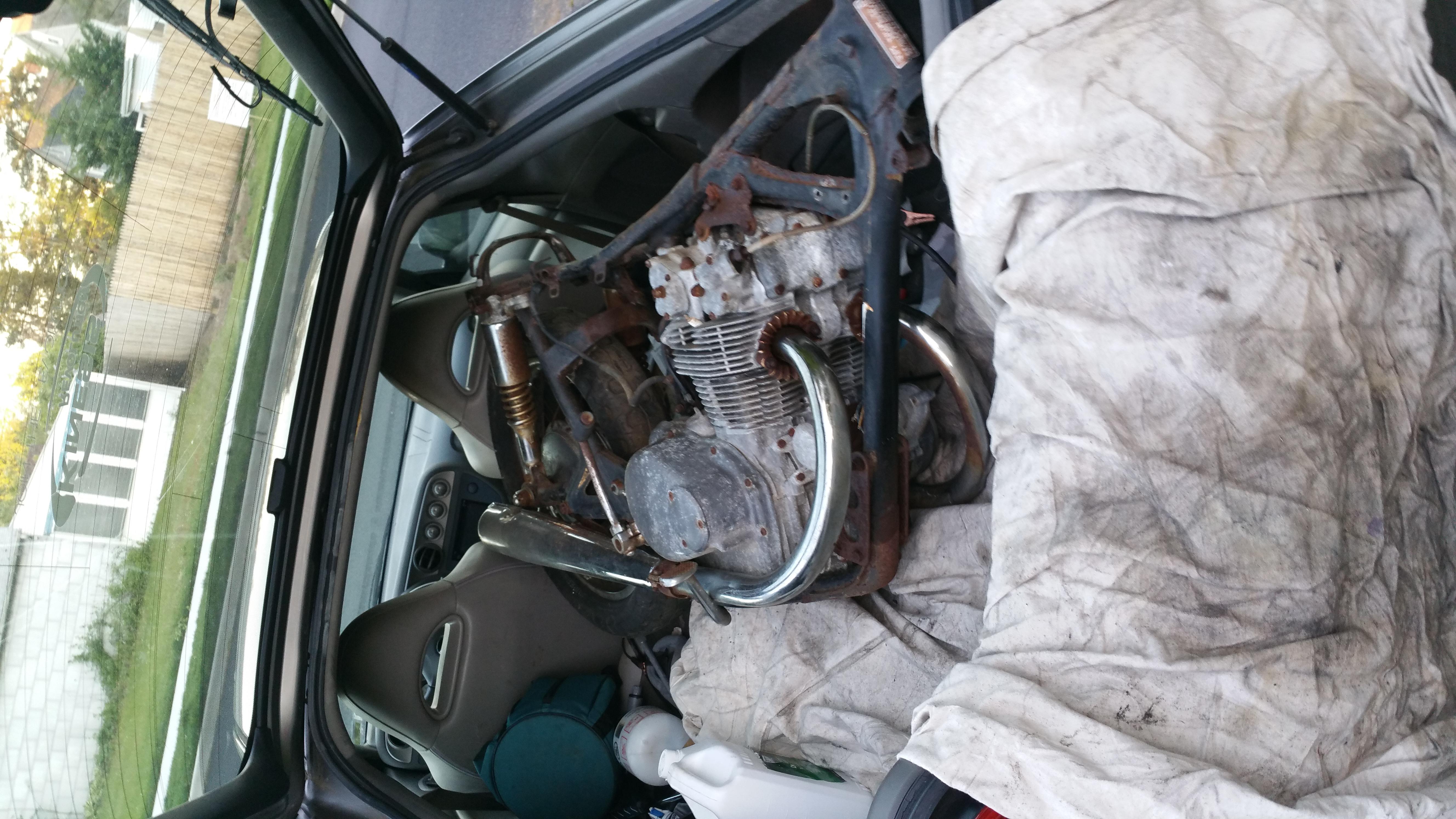

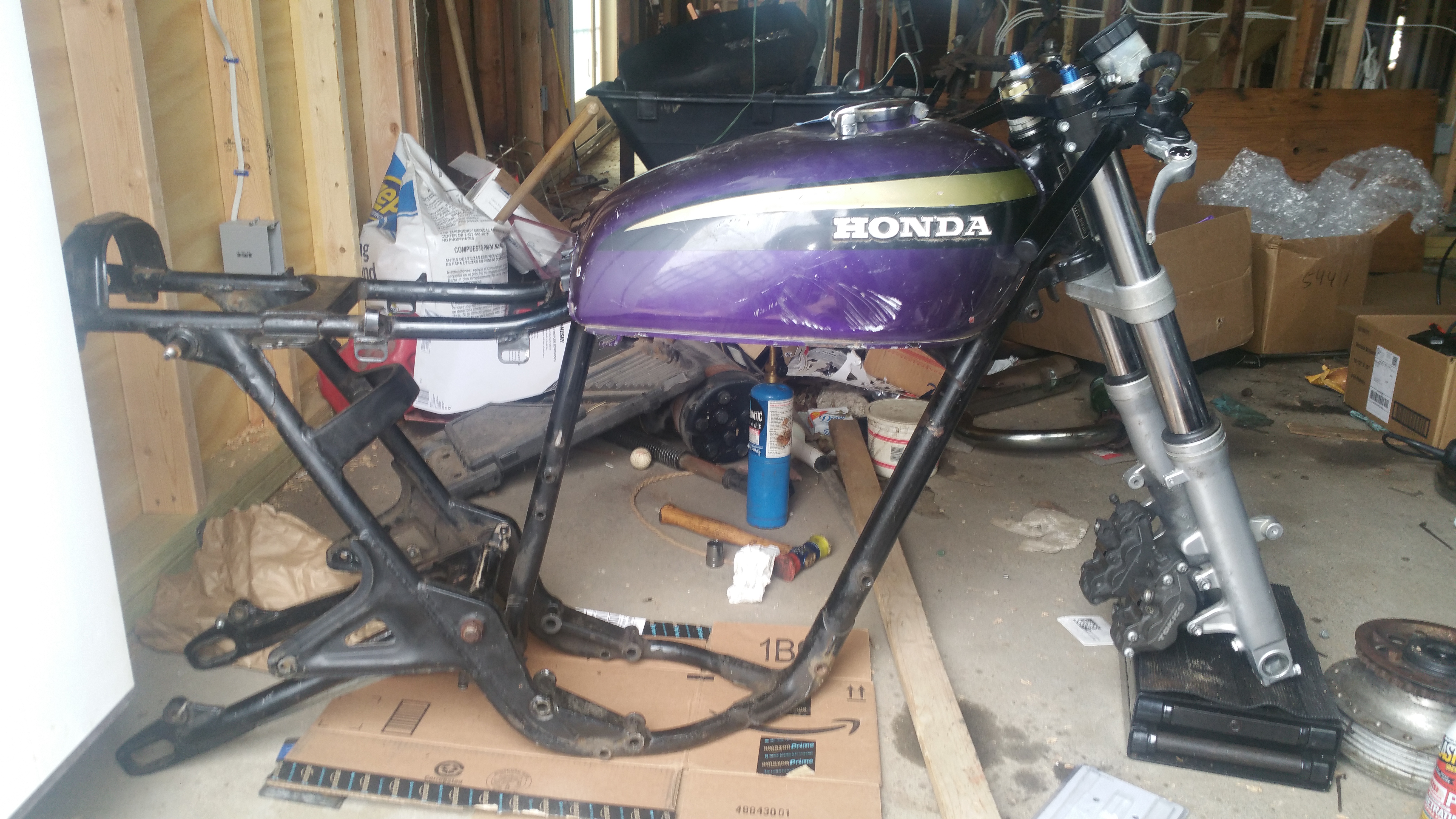

As I'm sure many of us here can testify, sometimes things unfold in a way where opportunities to pick up bikes/parts for a "too good to be true" price present themselves. This build starts along those lines. While going to look at a cx500 for a friend, in the corner of this guy's garage I spy a suzuki sv1000 front end, in really, really nice shape. After my friend haggles and ends up the with the cx, I then turn the gentleman's attention to the front end, which including everything but the controls and front wheel I pick up for $125. Later the same week, my luck continues. A guy I occasionally do business with has a cb450 he is willing to part out, and it just so happens I have a front end and wheels he wants off a cb360. On a barter, I get the engine, frame, and rear wheel.
So, at this point, being into a new project for $125 and a few dollars of gas, I figure why not start putting this thing together. I have no idea what direction I am going, other than I will absolutely go crazy on the motor once I thin my current herd, and I want to do something with a little more of a modern feel than I have done. The only thing I know for sure is I want to push myself out of my comfort zone as much as I can, but not so far from what I know I wind up with a pile that'll never get finished.
Here's where I am at:

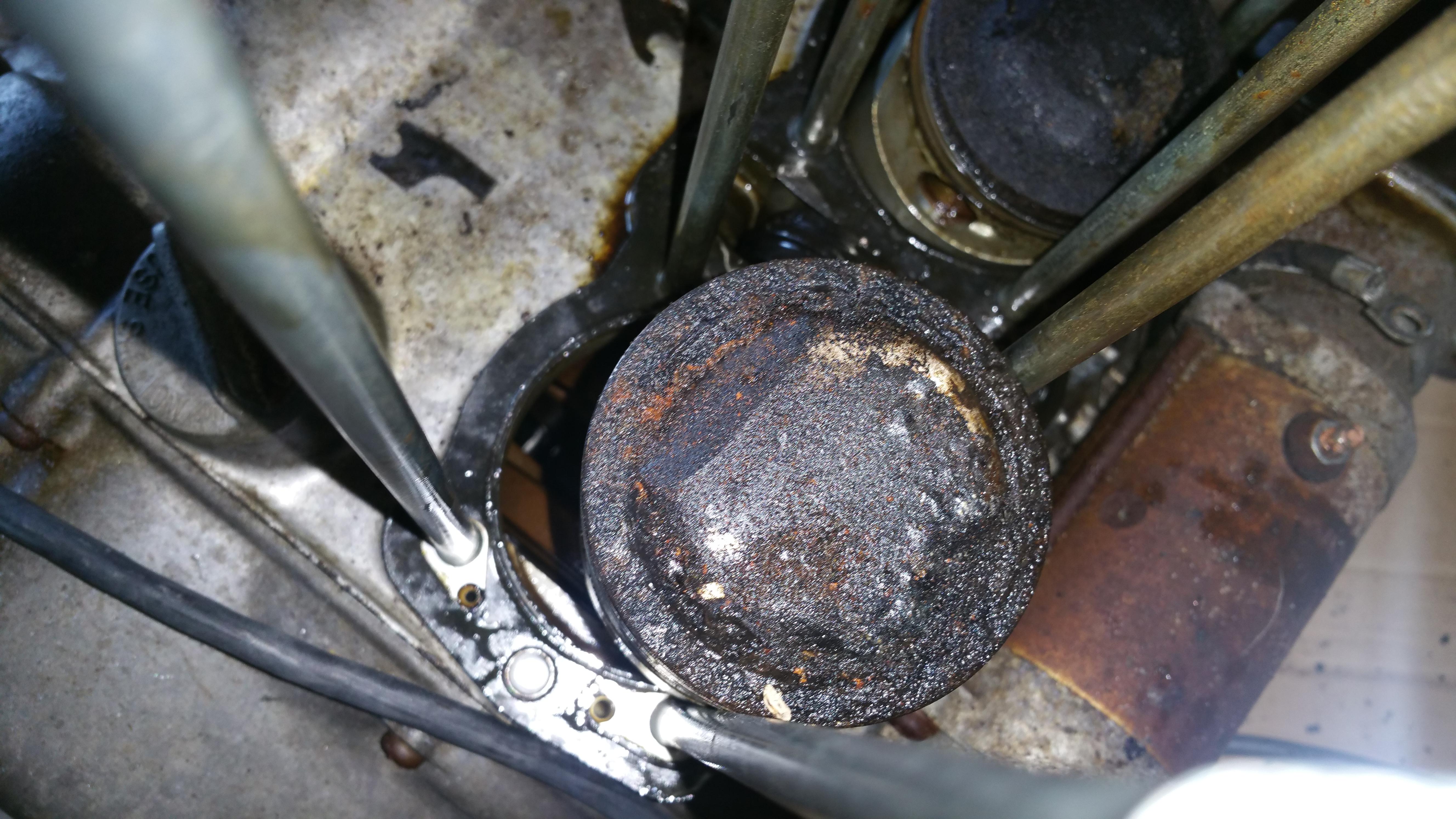

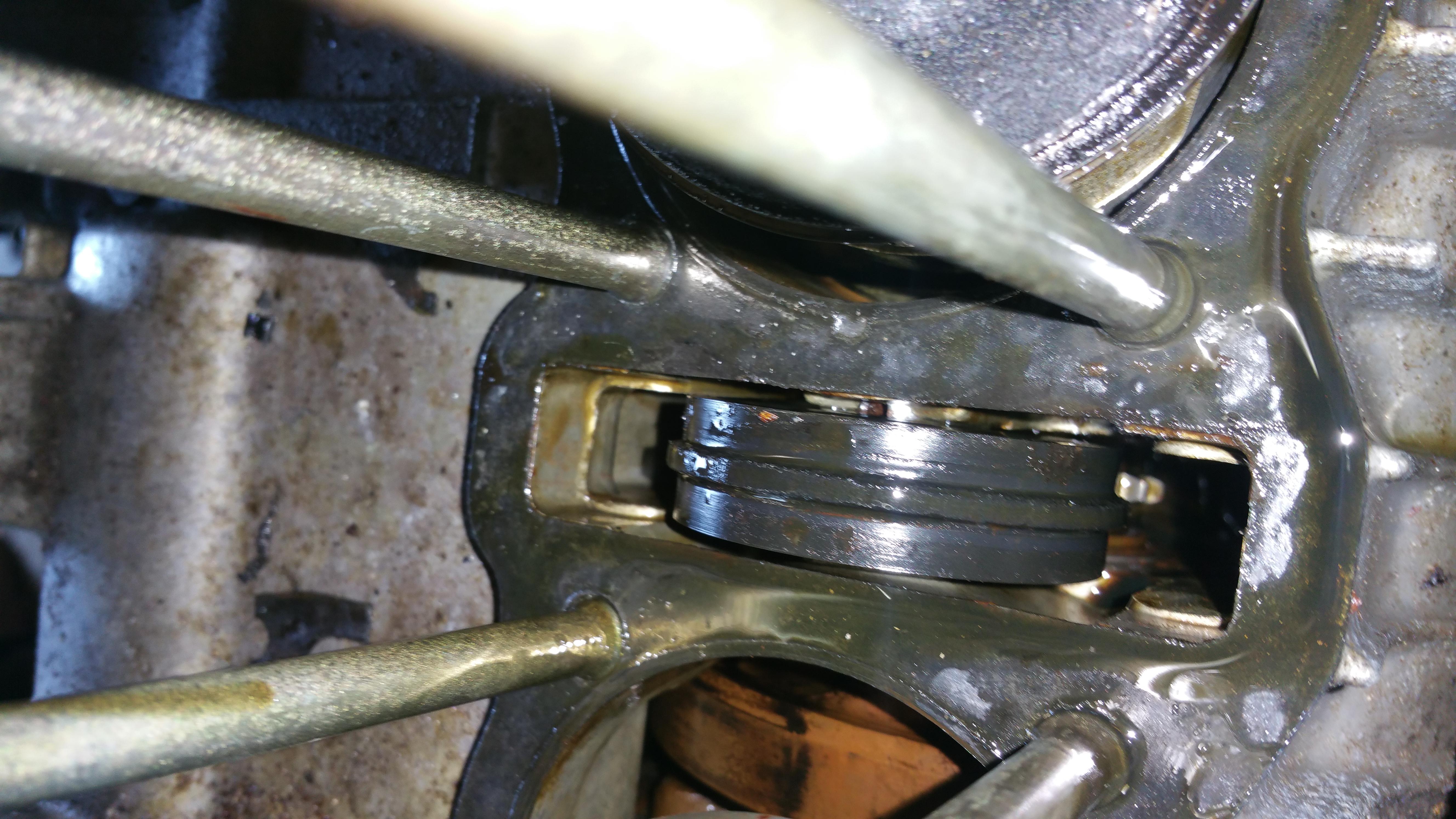

Re: Fuel injected Cb450 build
This torsion bar setup is funky man. Anyone know if once the bolt on the side is removed if you just tap out the bar? I've also read some people stating remove the valves first, others says after. Nothing like conflicting information.
Oh, and picked up a tank off ebay. Needs a little love but almost rust free.
Subscribed!
Just tap the bar out once you remove the side bolts. There is not that much tension there. I've rebuilt the CB450 about 3 times, and it gets easier by the third time and I always learn something or an easier way to do things on these bikes.
