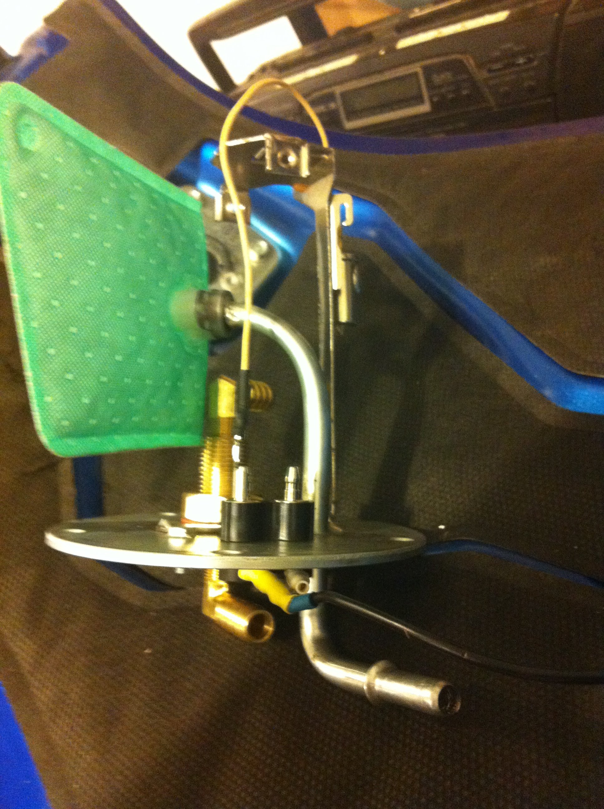

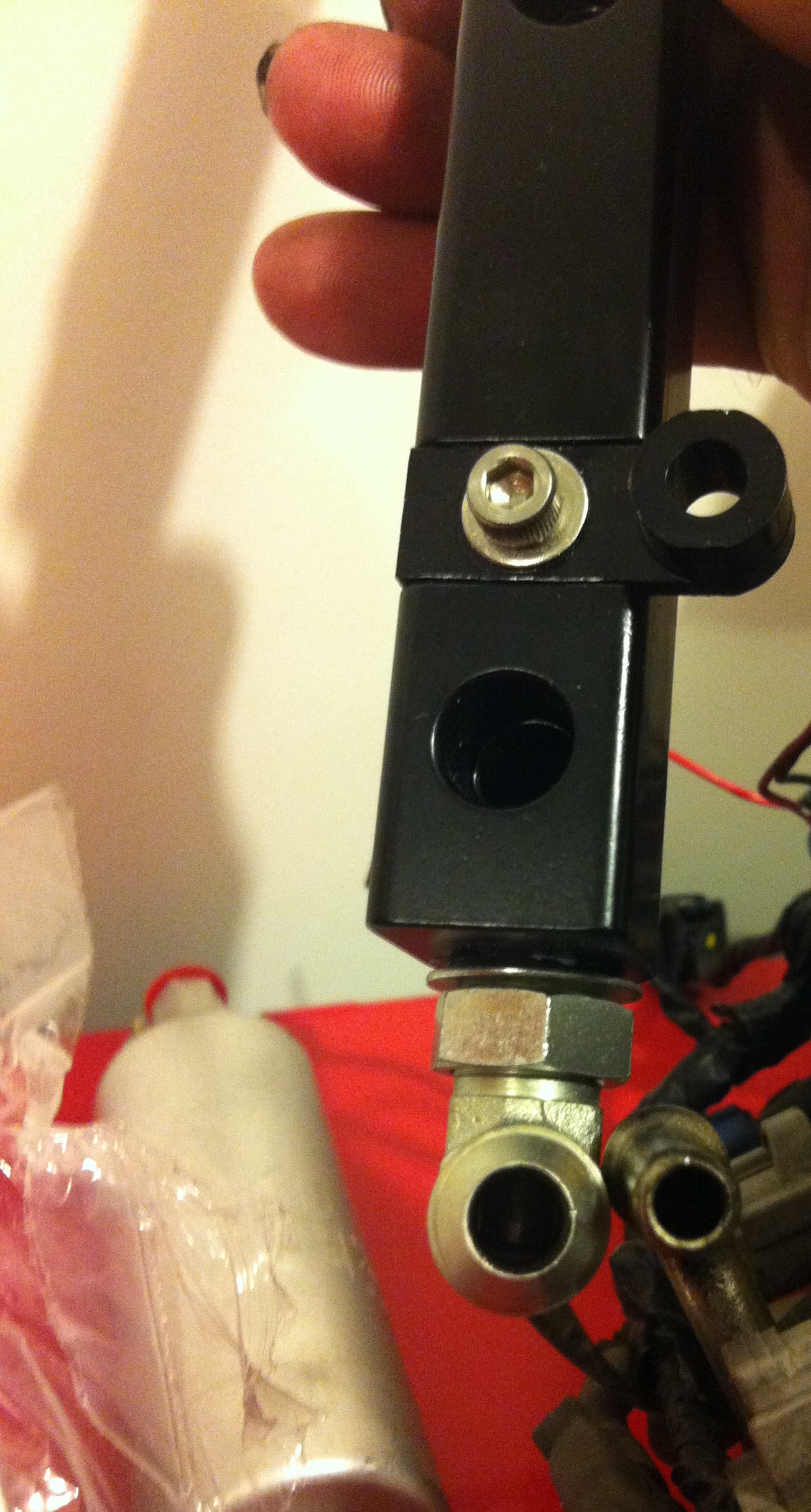

Anyway it has 9.5-1 JE pistons instead of Wossner because of price. Wossner is better though. The fuel rail is 3/8" and the photos show the new 620cc injectors and fuel pressure regulator. Also a 225lph fuel pump is being used.
