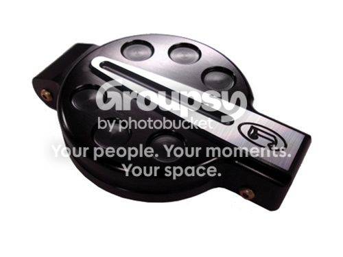

Finally got my new CNC machined cap and latch in the mail from Joker.
Should tie in nicely I think. I hope it looks good and goes together without issues..................I hope
It'll dress up the bike a bit I think

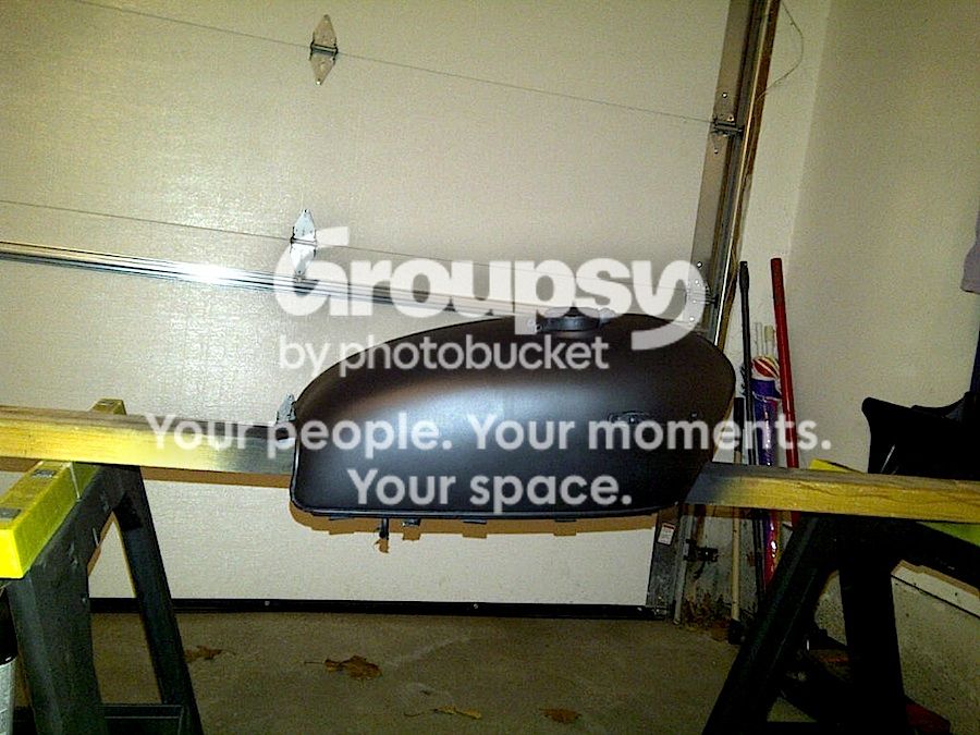

After that, I swung by the shop to see how the tank was making out. Well..........aside from the orange peel, I'd say it's doing AWESOME!
I'm leaving it at the shop where it's quite warm. I'll pick it up after dinner tomorrow and leave it a while longer before wet sanding the orange peel out (800, 1000, 1500, 2000, polish, wax)
Right now, you can't even see where I blended.
Faulking STOKED! Glad I persevered and kept at it.

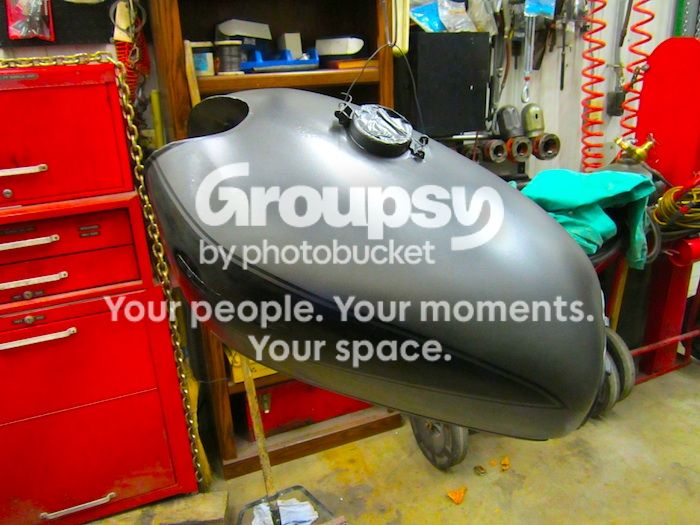

Finally got some time tonight to get at it again!
Wet sanded a few days ago and dulled it up real good. Buffed the snot out of it (by hand) tonight. 8)
Smooth as silk!!
I'm happy...............after that bit of chaos that went down. As you can see, you can see nothing but reflection in the paint ;)
Slapped the new cap and latch on tonight as well. Great stuff! ;)
There we go. Updated. ;D
Couldn't resist ;) Just "had" to set the tank on the bike to get an idea of what it will look like when I'm done. I'm really glad I took my time selecting colour and design. I'm quite happy.
Just dark enough.

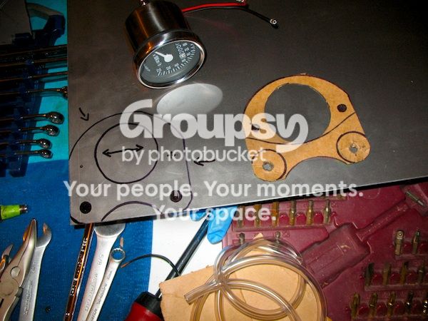

Started working the dash.........
Rough sketch.
After tweaking cutting and cleaning I got the full mock up done tonight.
Looks kinda crooked in the pic but it's just the angle. It's bang on the money 8) I'm pretty stoked on it. Nicely tucked away!
Will disassemble again and start painting I hope tomorrow night. Black...... ;)

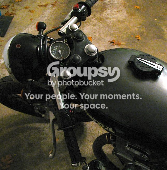

Dash now complete and tank back on.....
Very few things left to do. Hoping to kick it over tomorrow!!! Fingers crossed.
Here's a little preview. I'll try to get some better pics soon.
mikewerx said:
what did you use to cut the dash metal out?
Grinder to cut out the dash initially: basically to a manageable square at that point. After redrawing nicer lines, I just walked over to the bench grinder and shaped it old-school style. Dremel and hand-filing after that to clean and straiten it up.
I don't have a heap of machining type or precision type tools so I make due with what I've got. Took my time and got it looking good.
Hole for the speedo was bang on the same diameter as a standard 2 3/8 hole-saw. Nice tight fit once cut. Simple drill for the rest of the holes as well.
My bike isn't a show bike. I use it as much as possible.............even when it's freezing out. I take my time on my projects, try to get it looking as good as possible but again, it's not show quality.
If I were building something for sunny days only, I would probably not do it this way even though it turned out pretty good.
If you want precision (something really nice), I'd draw it up "perfectly" and take it to a machine shop to cut. They've got the tools.......

Slightly better light this morning. Was taking the kids to school and just took a couple of quick shots.
Tank turned out nice enough (not perfect but........). I'm VERY happy with how the darker colours tie in nicely though.
Now that the gauges aren't sticking way up in the air, the bike looks nicely balanced in the front end IMO. I know this bike isn't for everyone but I'm digging it.
