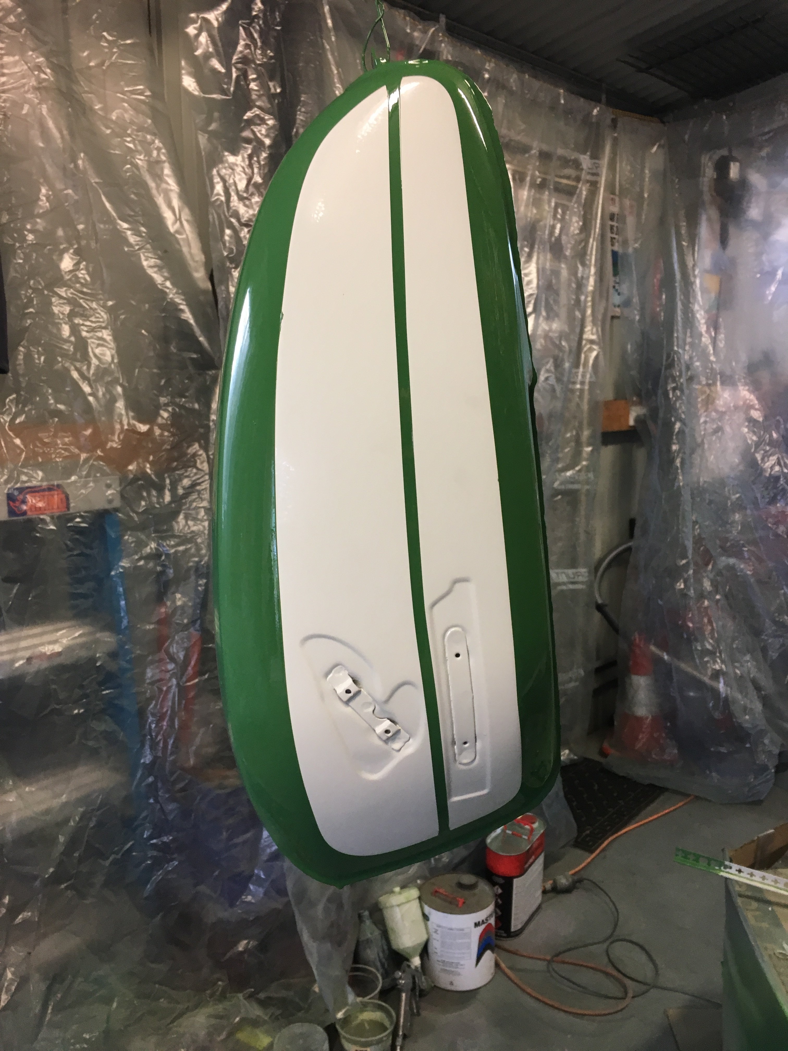

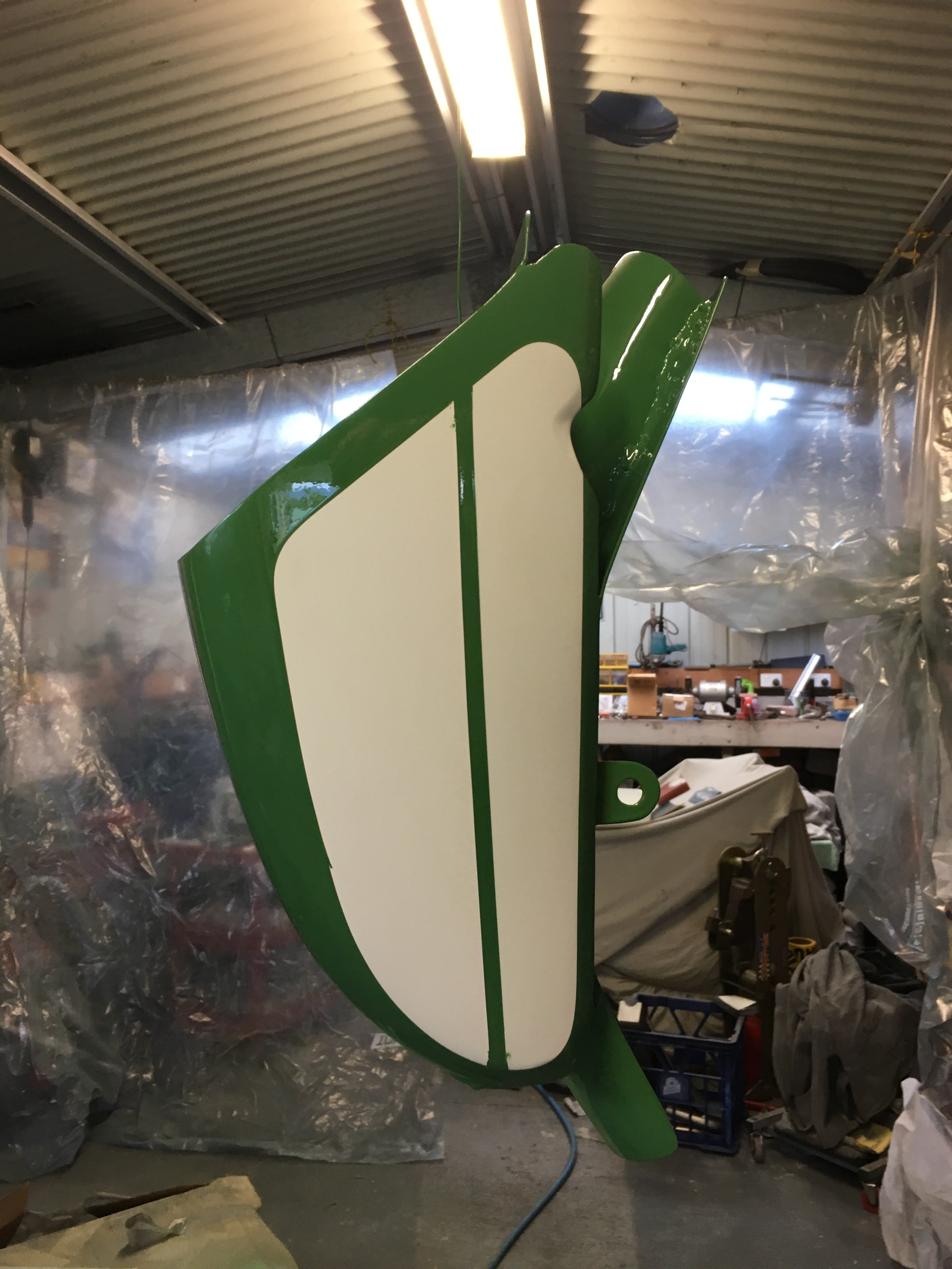

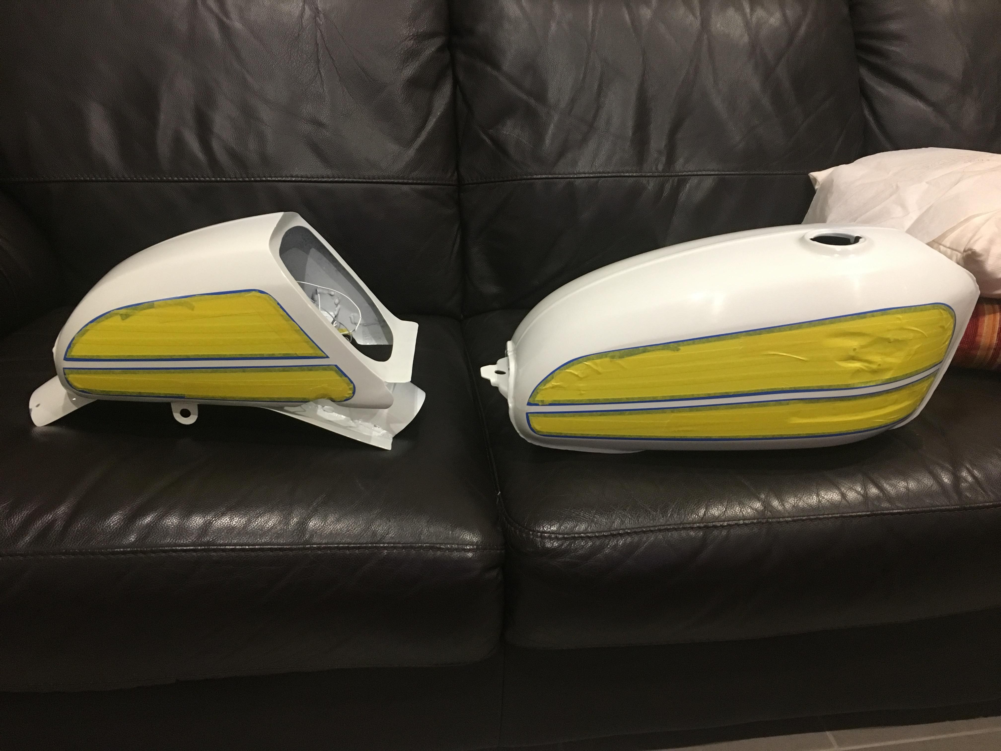

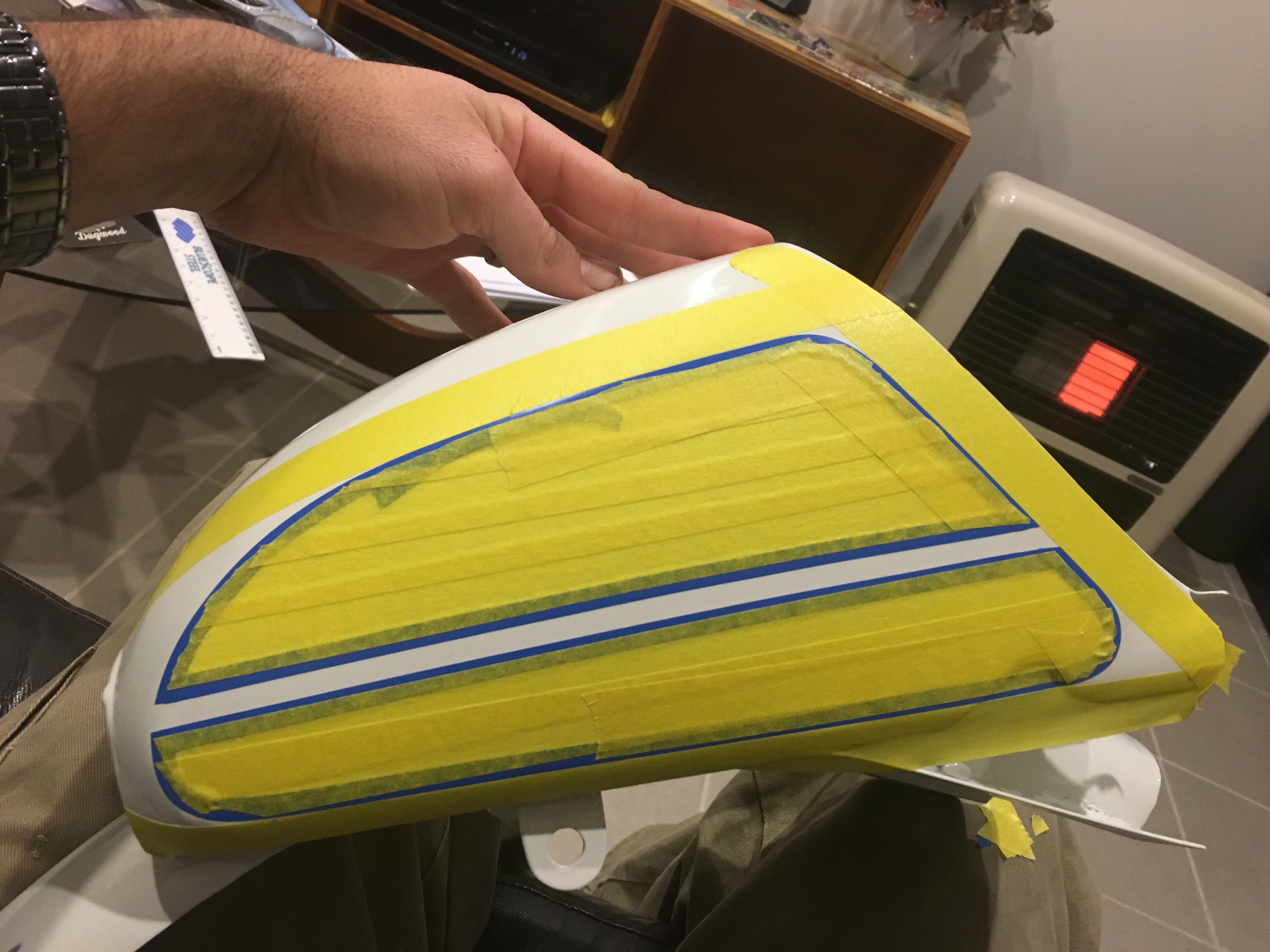

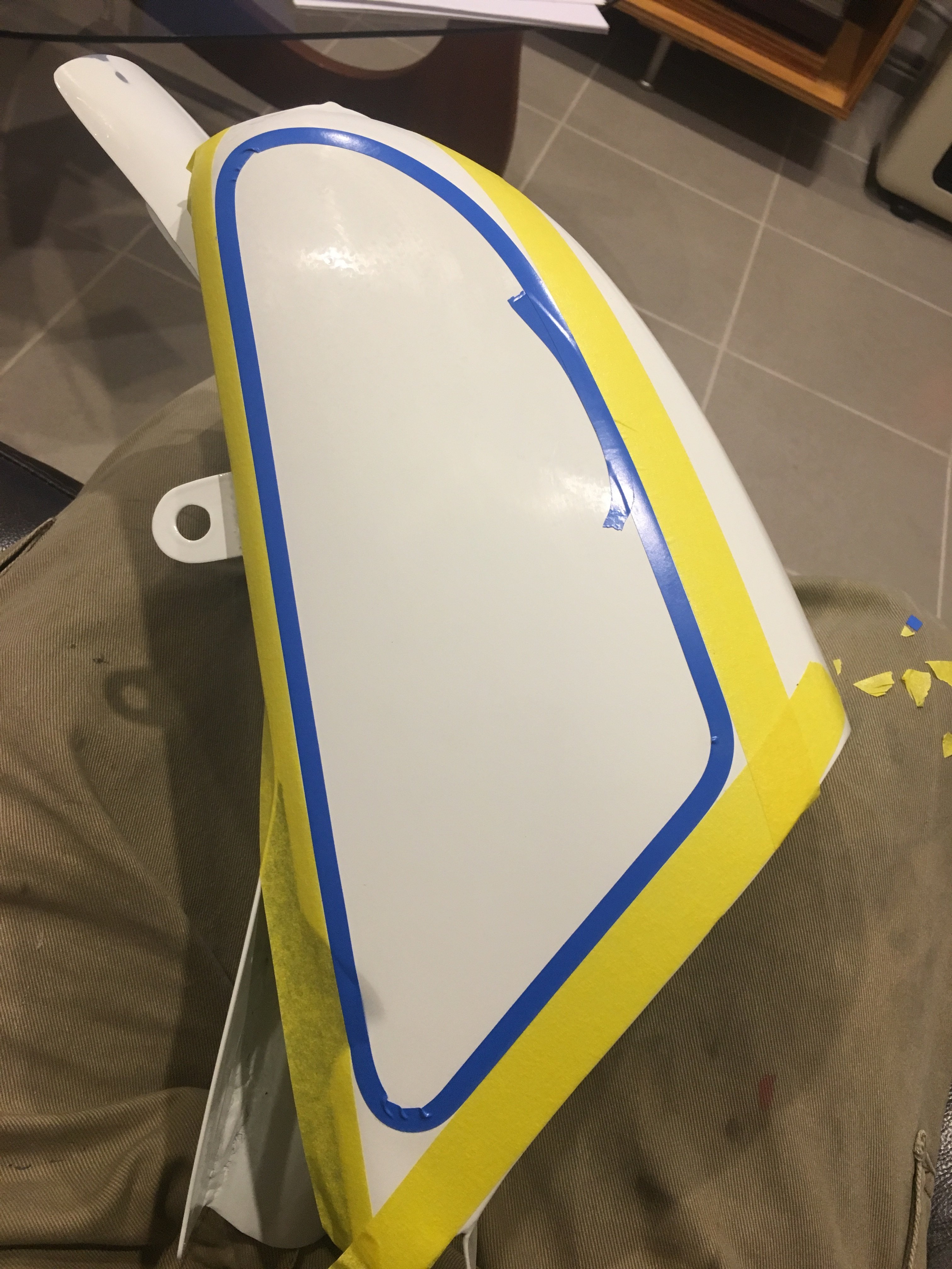

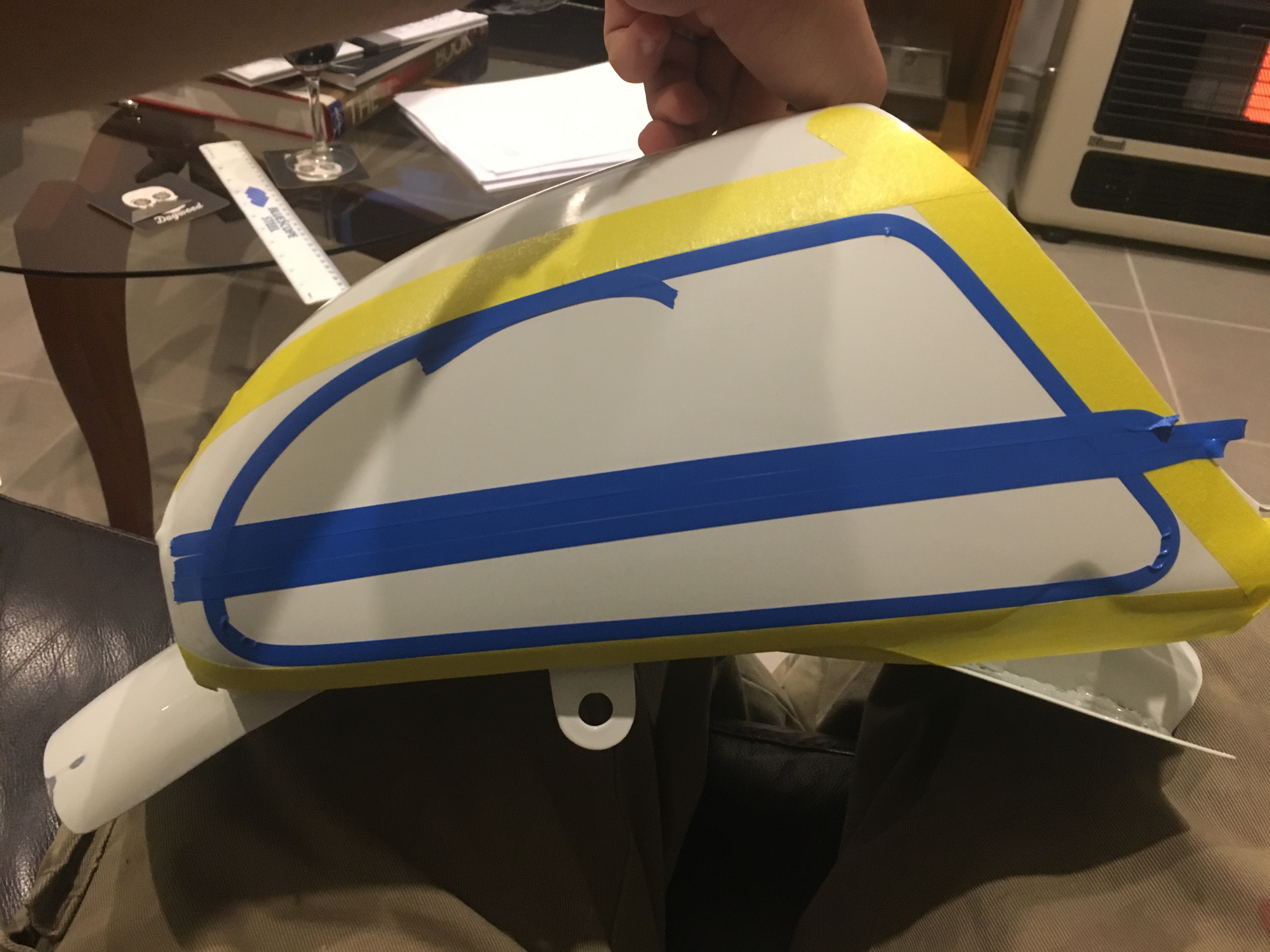

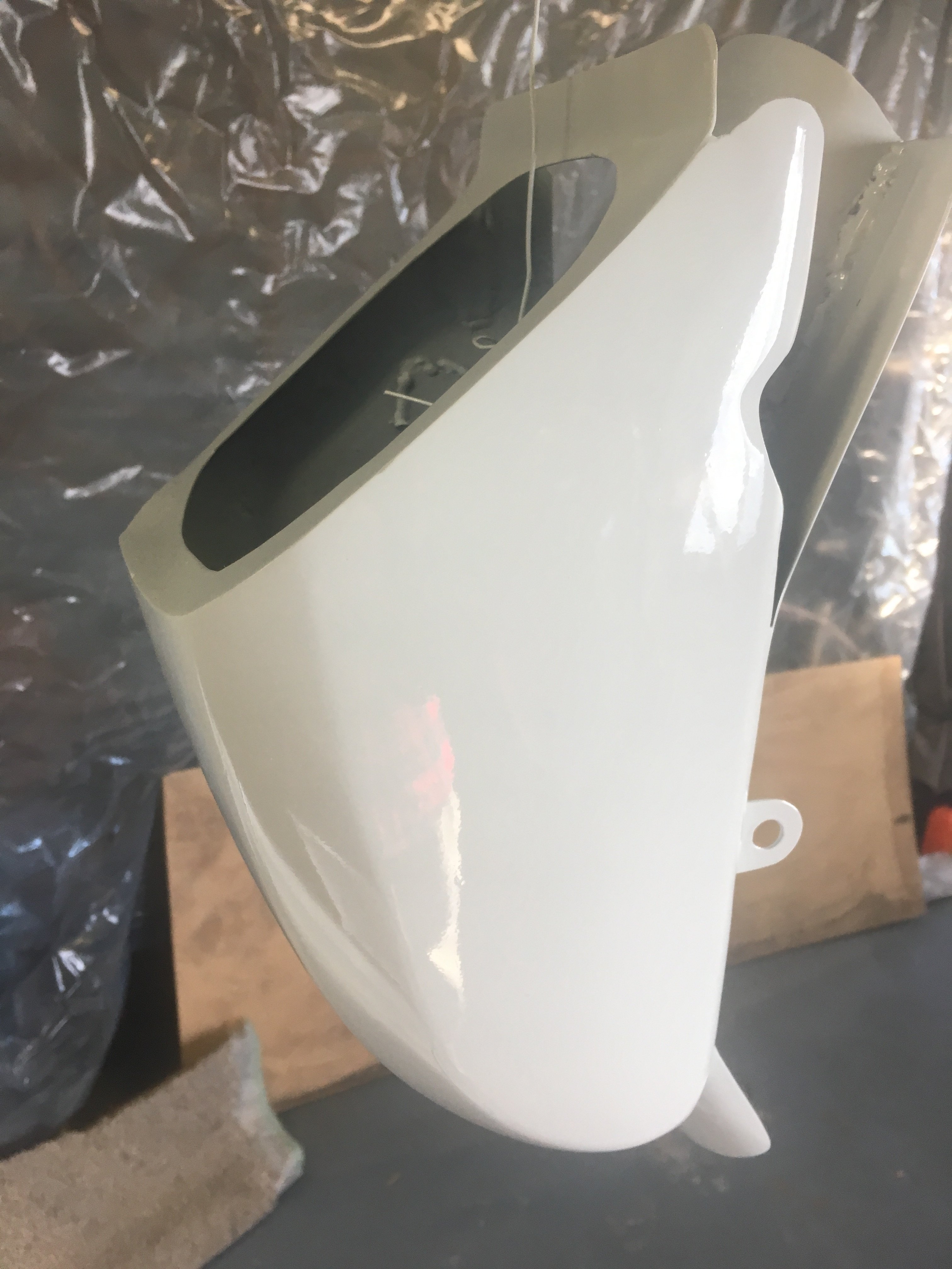

WOW. cant believe I said "just a little bit of paint prep".
I decided to spend copious amounts of time getting the absolute best results I can with my "first ever paint job" skill level.
there were a couple of small dents that I managed to mostly massage out then stripped back to bare metal and used some bog to get it real close. (tried to keep the bog layer to less than a few mm) the applied high build primer/surfacer and rubbed it back about 7 times to get it perfect.
this took FOR EVER. but im stoked with the results.
now I need to do a quick colour sand and buff, but first will be clean out shed, pack up paint booth and put the Val away which means the misses can get her car back in the carport.
also Iv collected all the materials needed to fab my SSteel exhaust and muffler buts another story.
