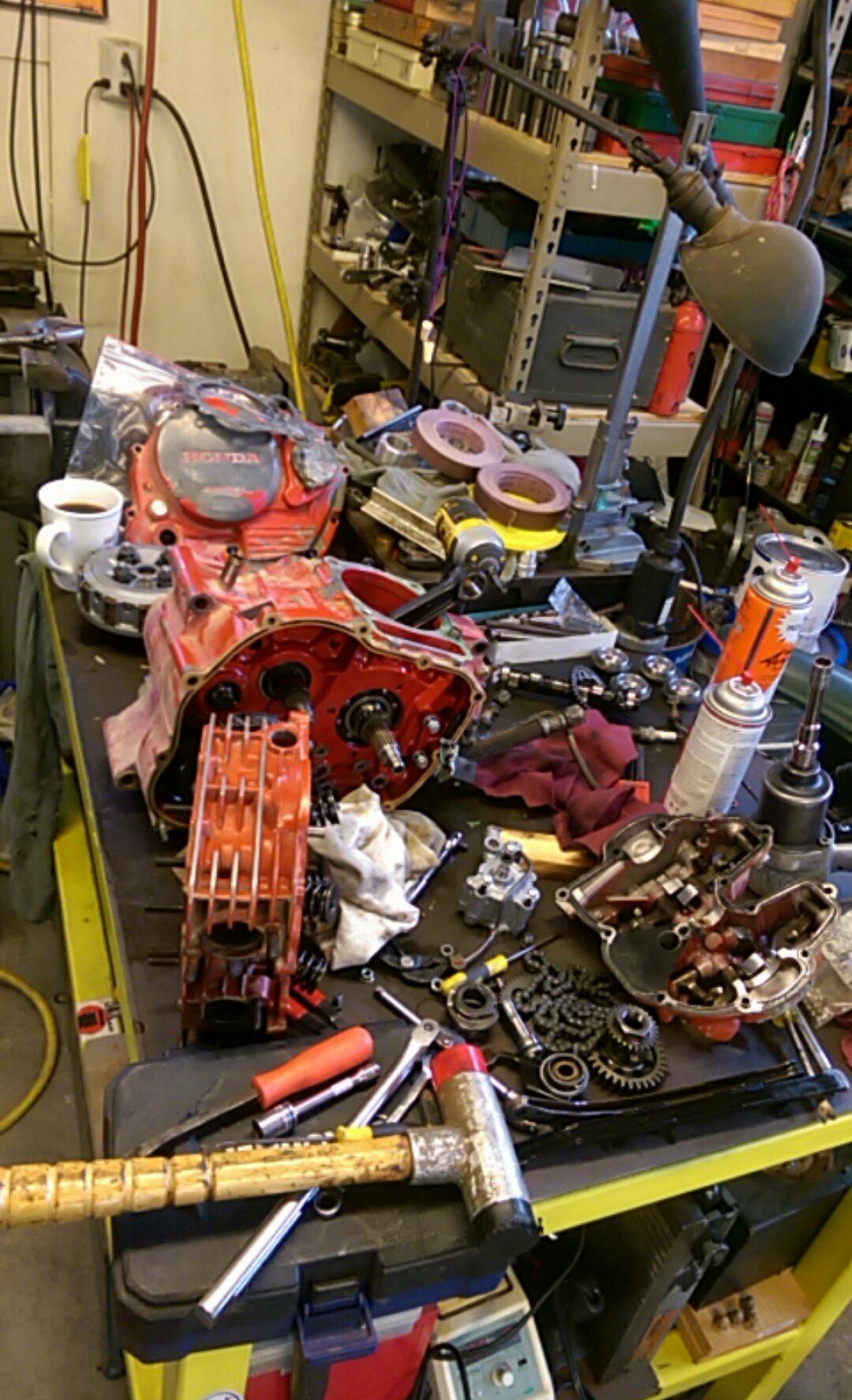

After that ride, it was time. Christmas was here, my awesome wife got me some awesome doodads to bolt on it and a torque wrench, I had no more excuses. So then this happened.
Mr.E said:
...So then this happened.
So then WHAT happened? You had an explosion in your shop? HCG (Mrs E) went nutz w/ that hammer? Santa's elves got into the e'nog and tried to "help" you? Ichiban Moto came and helped?
I decided to see what makes it tick. Literally. Remember that sound it made at mid O? It had been making it the whole time until now. But more on that later.

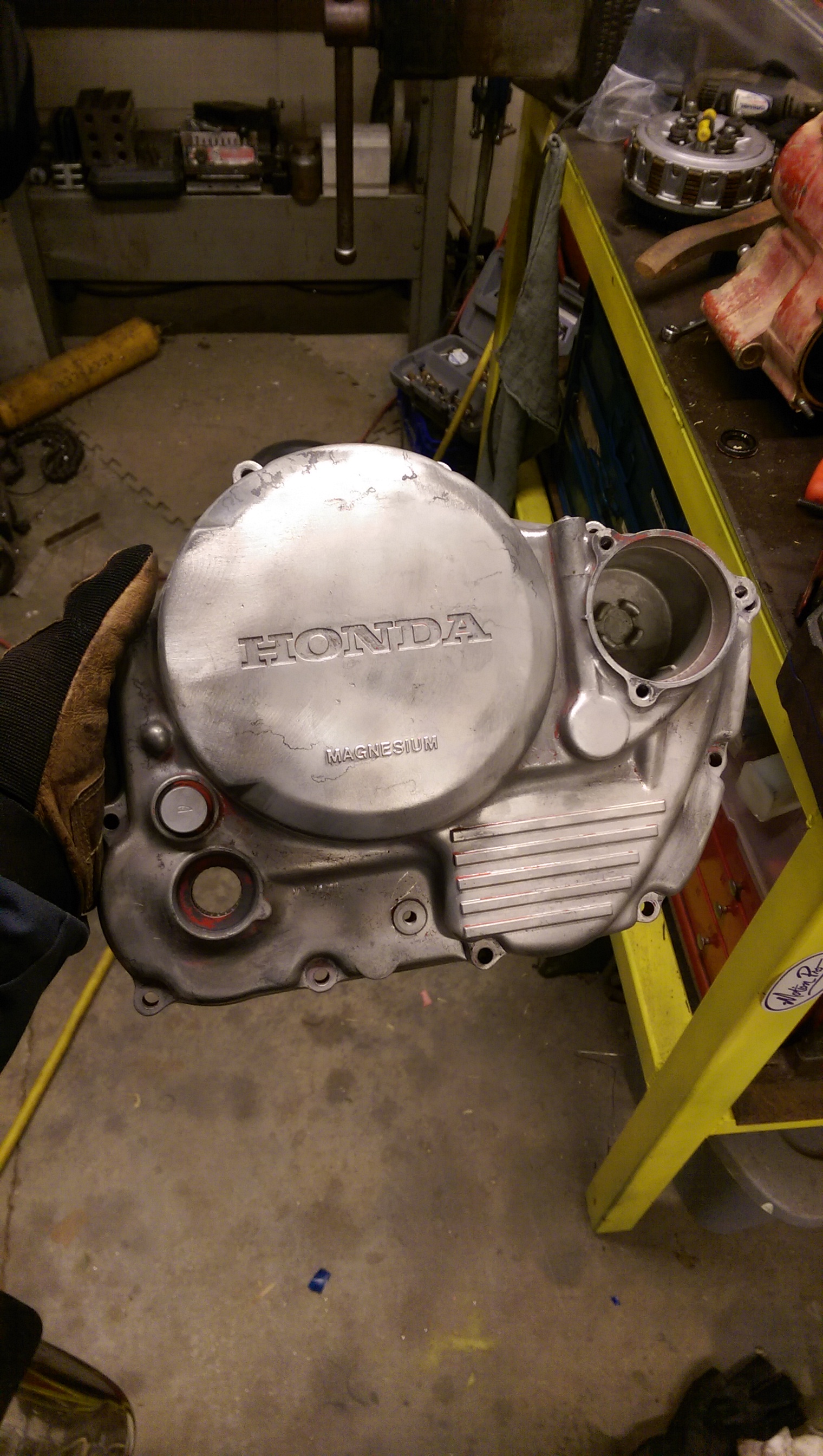

First, a bit on magnesium engine parts. If anyone read my Elsinore build, you may recall the issues with magnesium I ran into there. Basically, it "can" last forever so long as you don't expose the raw case to things like... air and water. Easy, right? Especially susceptible are areas where water can puddle, like the little corners on cases when it's on the side stand. Over years, alkaline in rain/swamp/water can eat away at the case just like rust. It just takes a scratch thru the coating. This bike wasn't bad. Just a few spots on the clutch cover to blast out deep and fill. Then a few good coats of ceramic engine paint to seal it back up. Someone back in the previous ownership did paint the covers, but looks to have just painted over the original paint. That's also bad. It creates pockets of sealed in trash that will continue to corrode. Look at the pic of the bare cover where the dark lines are. That's where the moisture has been trying to get under the paint. If left unchecked, it will rot like rust. Don't be that guy. Don't stop till its clean, and then seal the hell out of it.

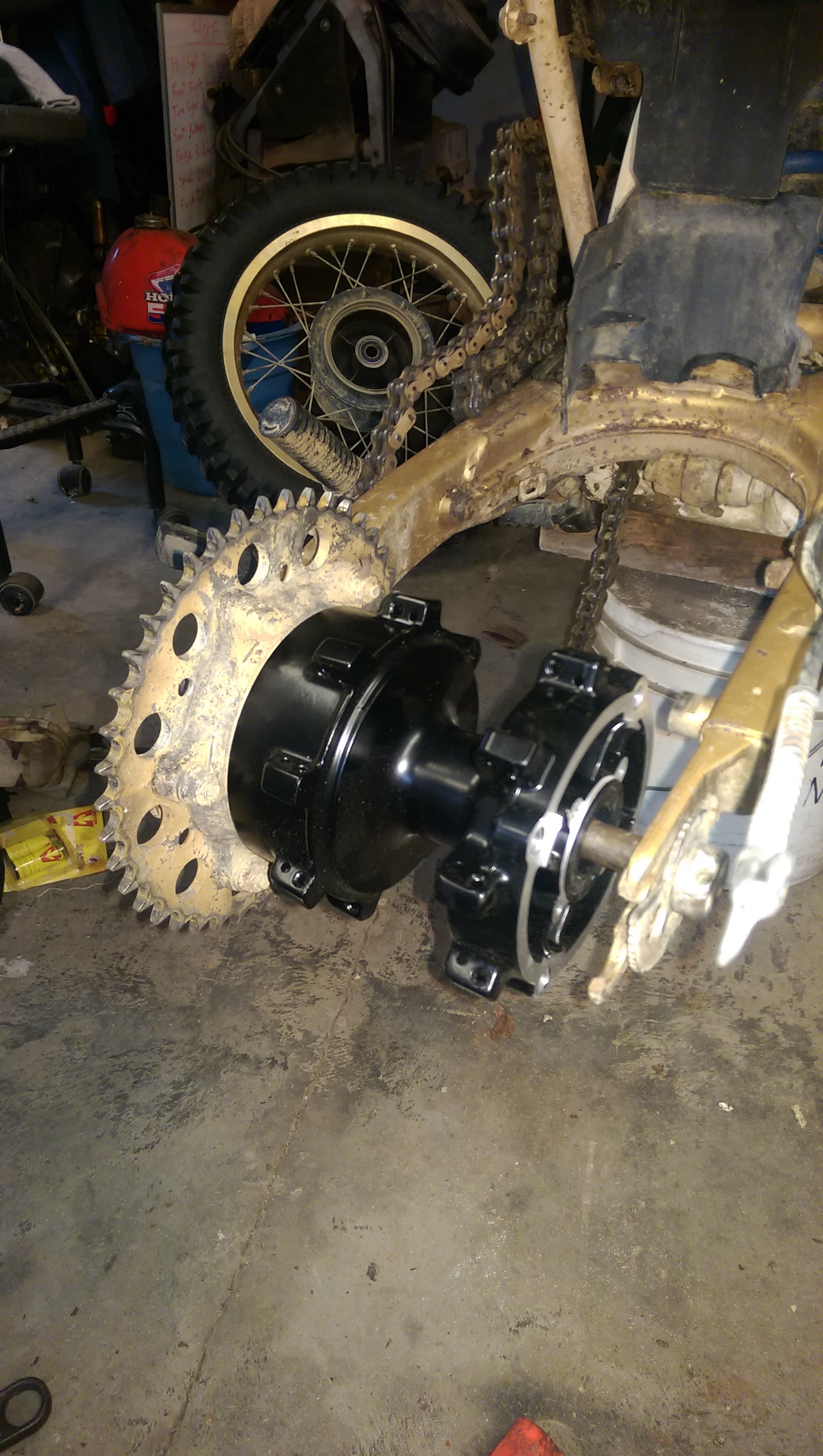

One of the things on my list was the transalp hub for a rear disc brake swap. From what I could tell, my sprocket carrier was a direct swap. So after a gamble on eBay, I got a nos transalp hub. It fit great with the carrier and axle. It even came with new bearings and seals. It is 32 spoke, so I've got to get a hoop and spokes, then I'll be in business.
