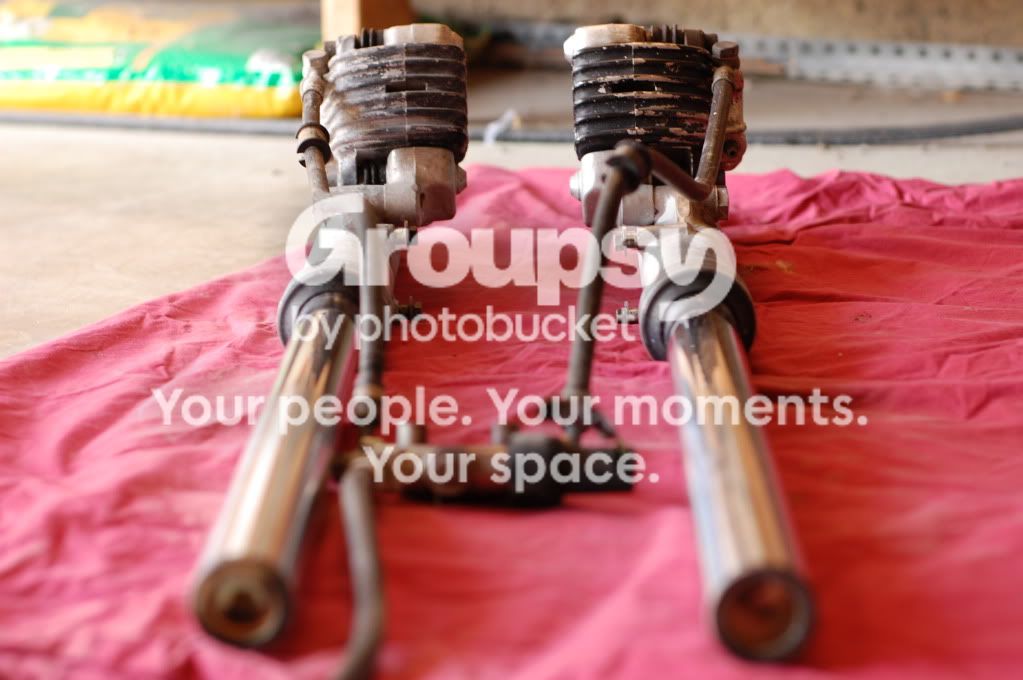

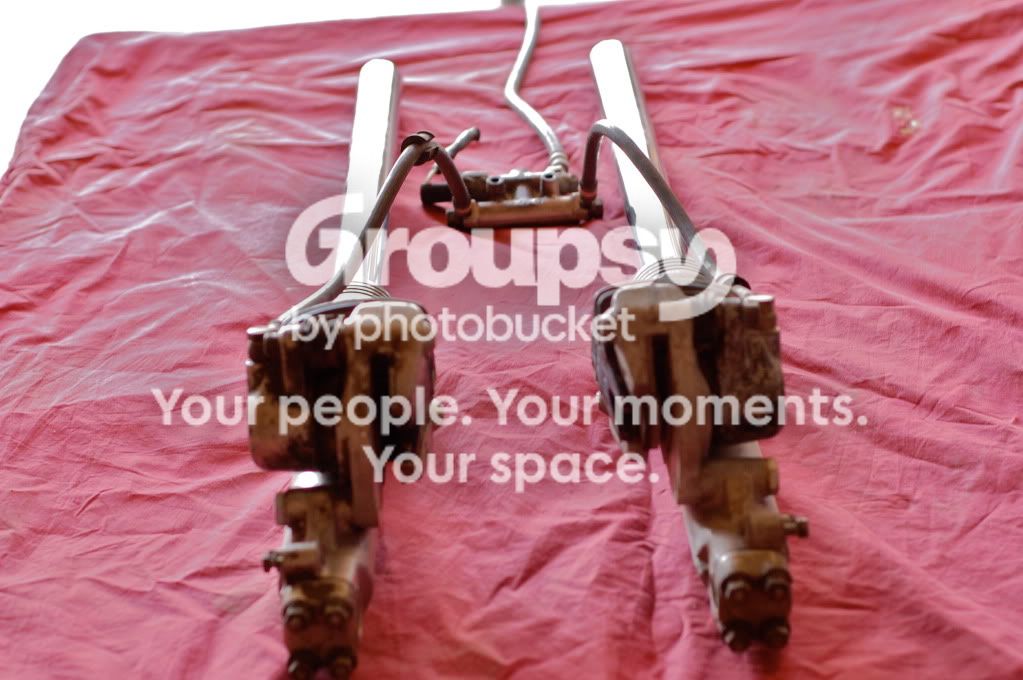

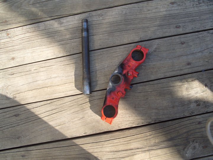

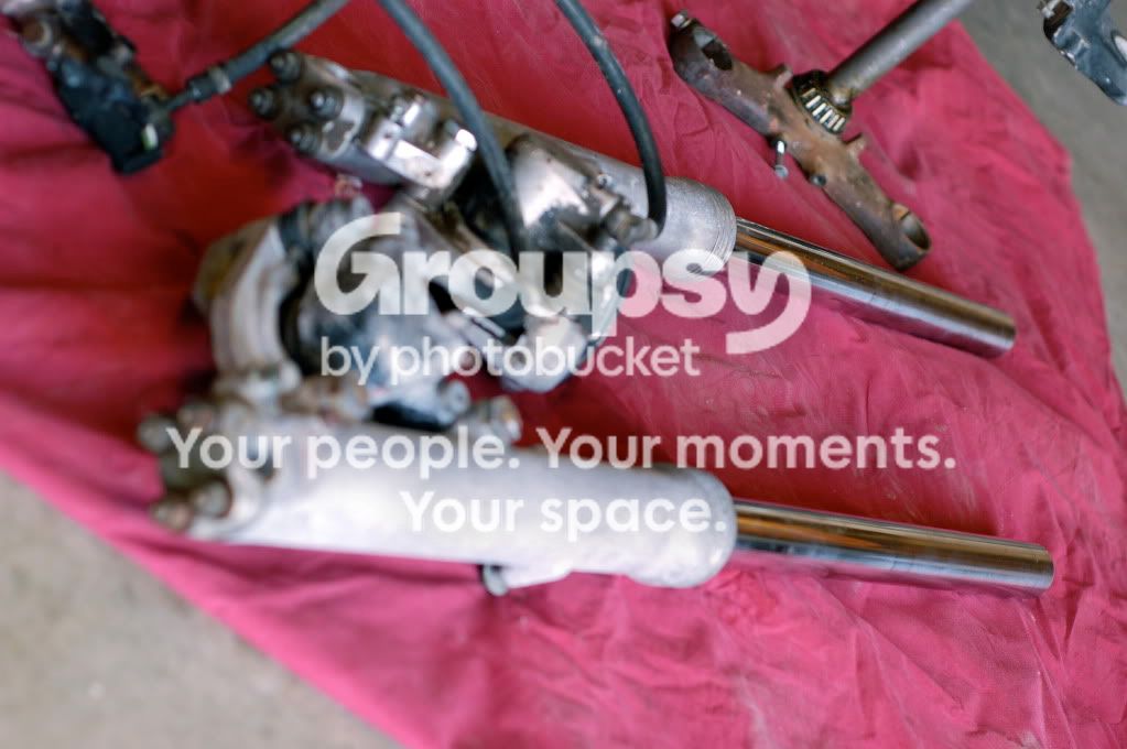

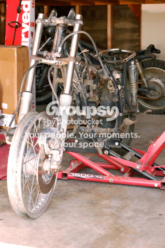

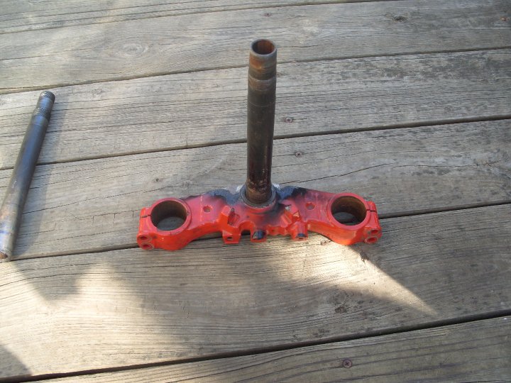

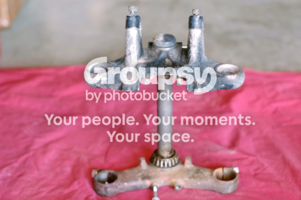

they should mount right on with some fresh bearings... im pretty sure the triple trees are the same....
just check the bearing height when you pop them all off of the frame and trees, and then stack the new bearings accordingly.
gl1100 front ends are a great upgrade for this bike. I say to go with dual disk, move the forks up in the trees about an inch (or however longer the gl forks are compared to stock, plus move em up another half inch or so) get some progressive springs, and if you really want some crazy performance, get some valve emulators.
this is all personal preference of course... play around with it until you get it where you like it. I like it when by bikes flick side to side in a second and the front end is nice and firm. ;D
sxecafe said:oh nice! do you know the answer to my swap question?
