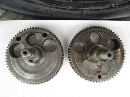

So I take apart a "256" crankshaft and find this ?! An '81 crankshaft is included for comparison . I've never seen this before . Anyone have an idea what Yamaha was up to here ? It could be something that was done after original assembly but I took the crank apart personally and it shows no evidence of having been apart before .

We know it's for balance but has anyone seen those balance weights in XS650 before?
I haven't and I've had quite a few apart.

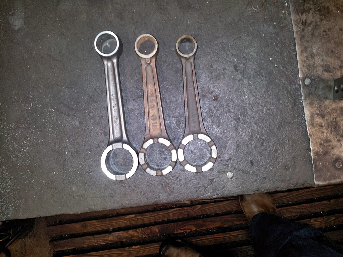

for anyone curious the 447 , 256 , and CR500 rods

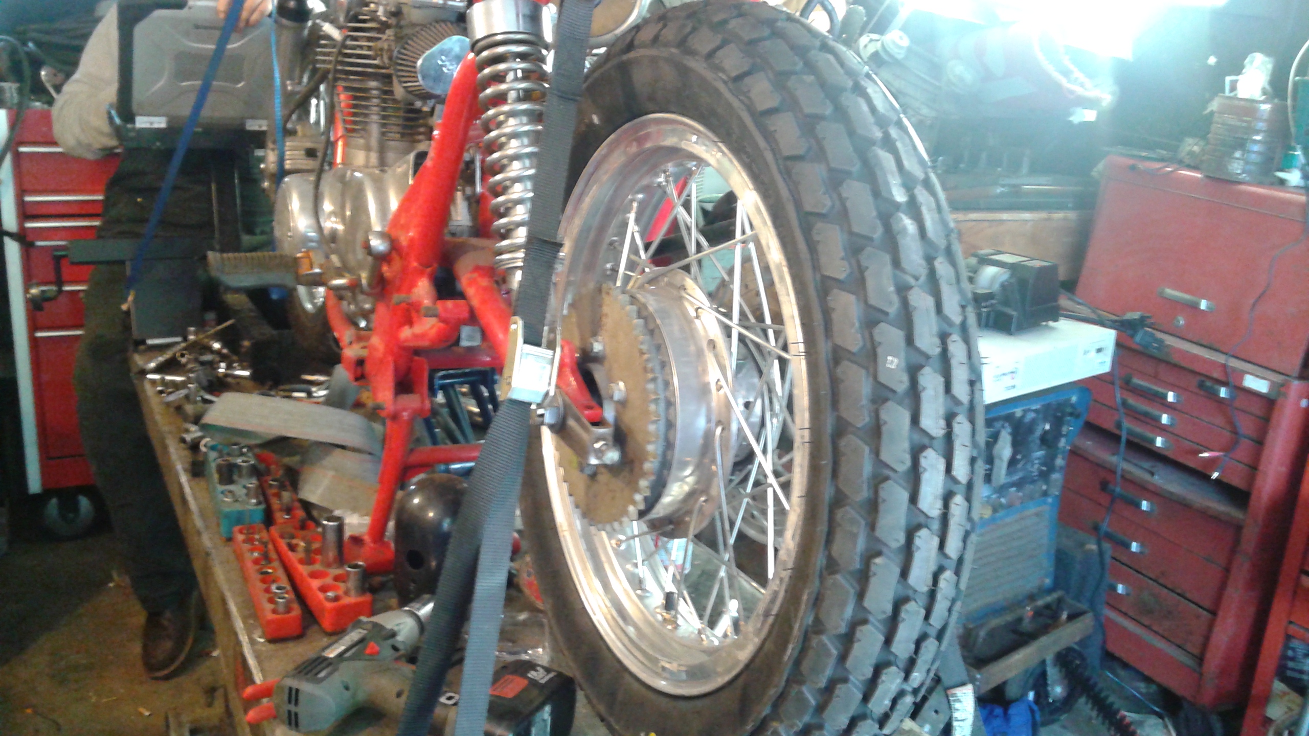

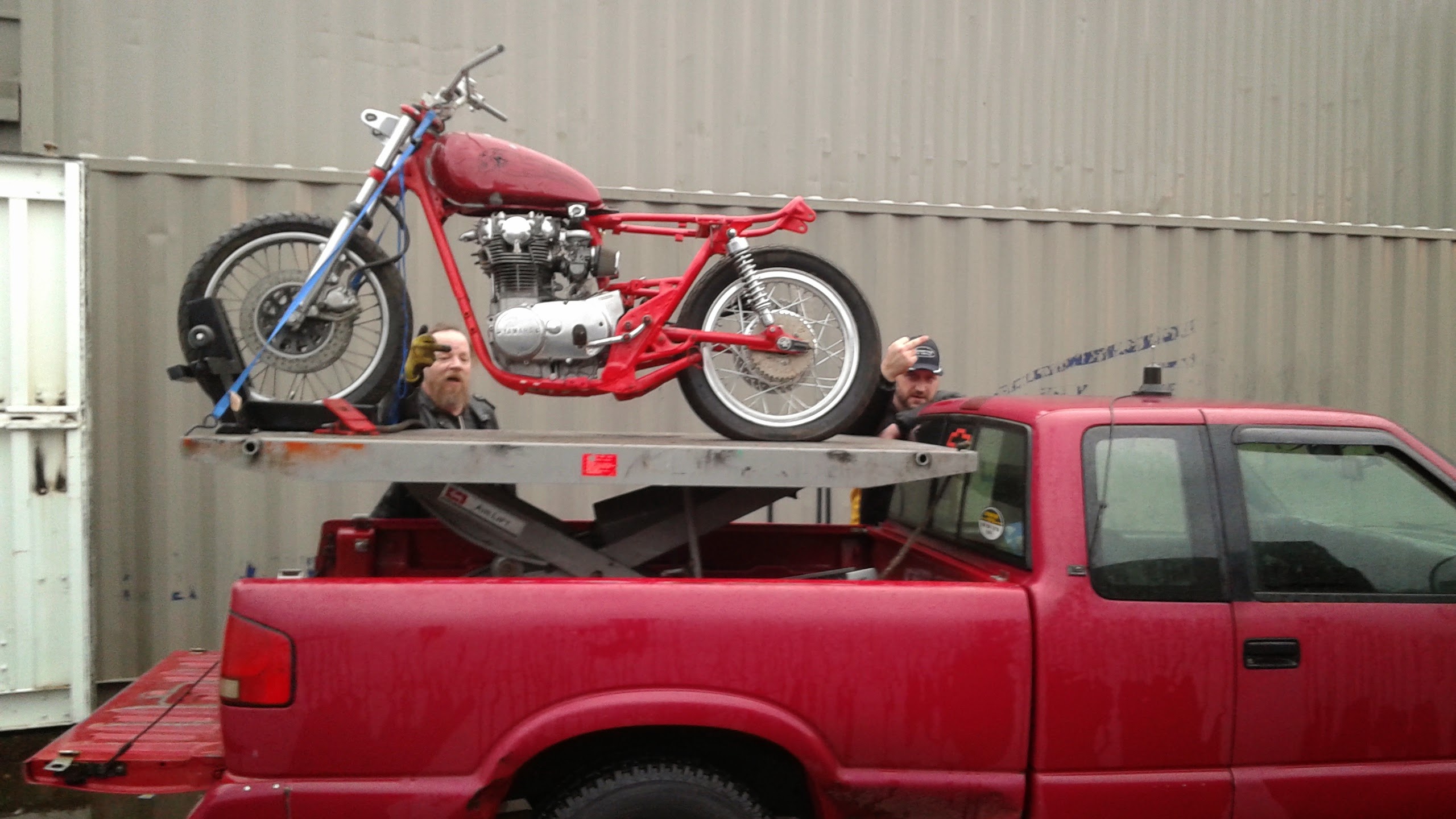

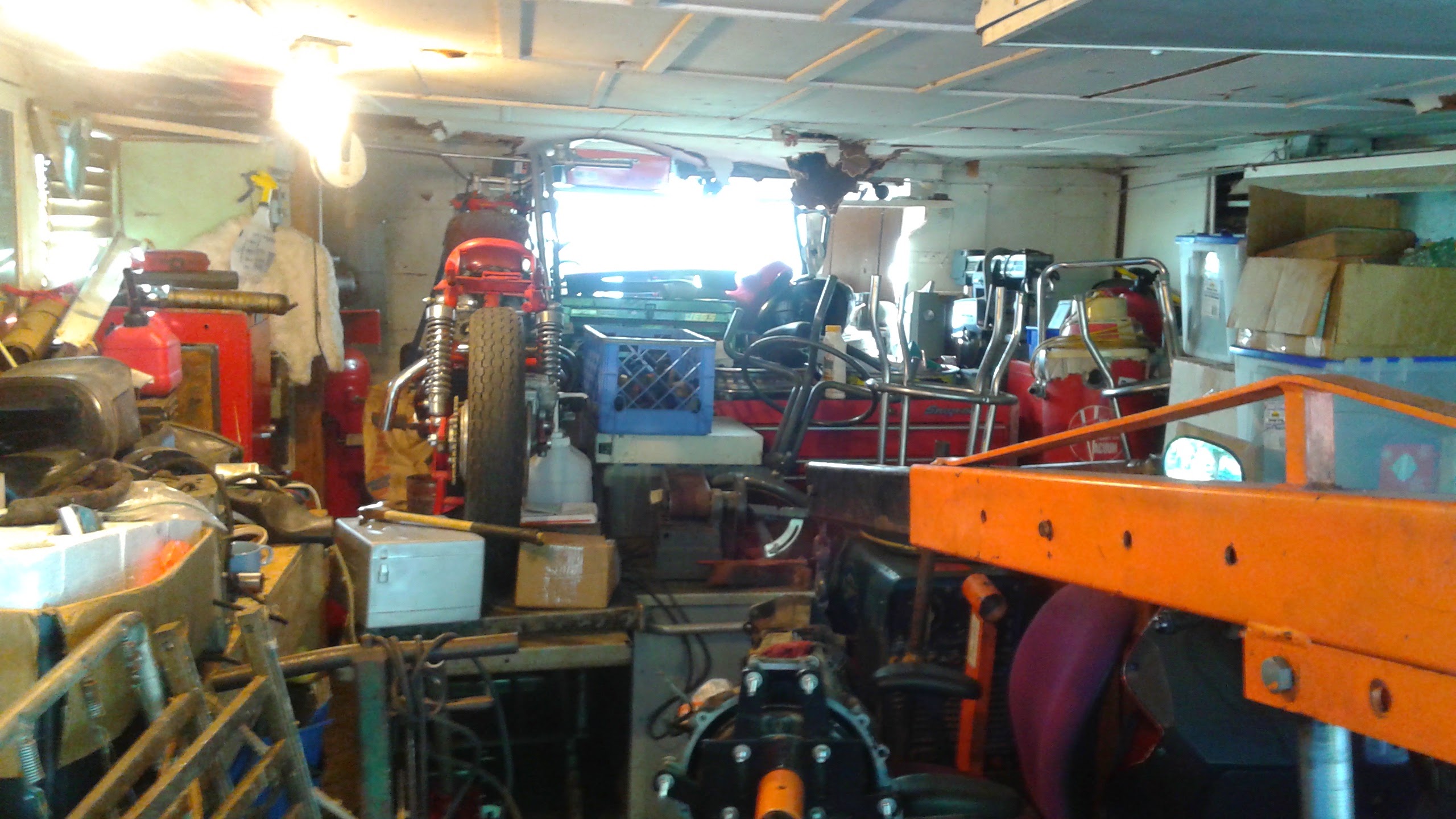

I finally got the red bike home . I had to down size severely . Red is finally wearing both of the "real" rims . All for now ...

I would be worried about the rear window and the CoG ;)
upside down bikes tied to lifts are no fun at all

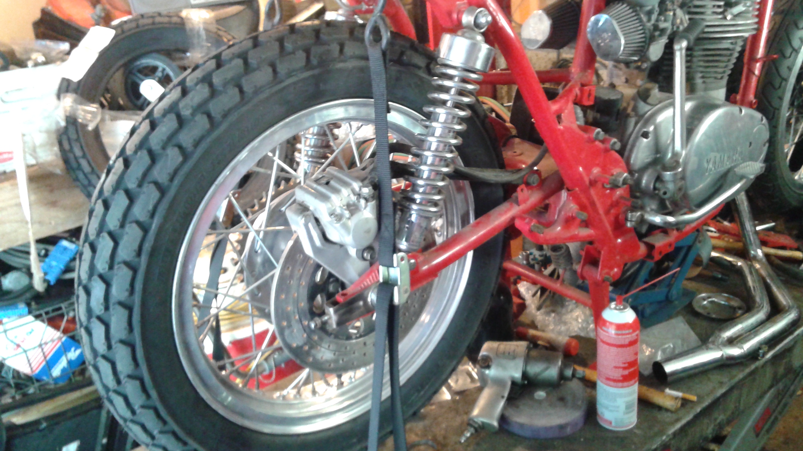

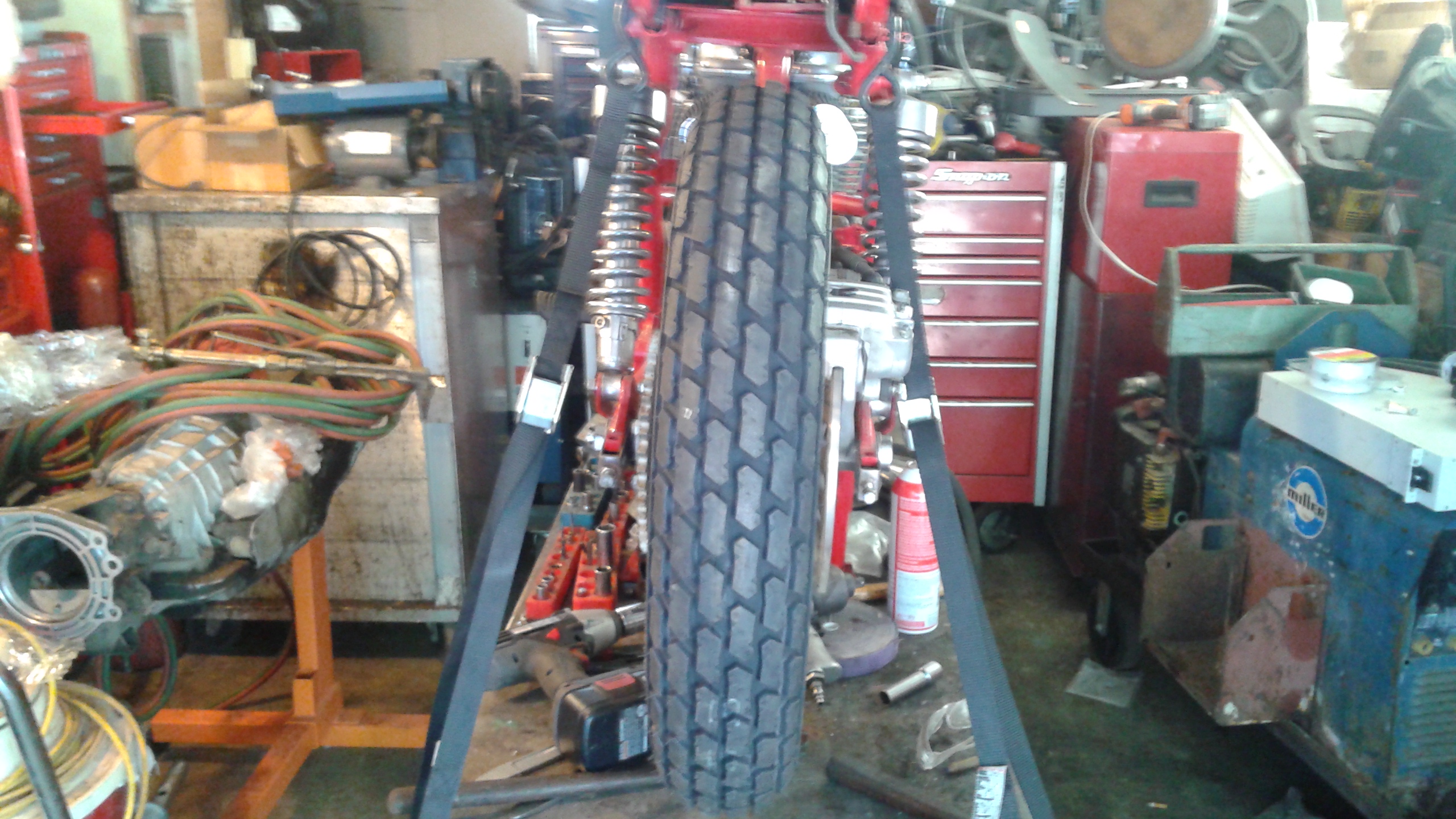

2.50-18 Borrani laced to KZ70B2 (twin) hub . 130/80-18 66P TT K180 . The 40 tooth sprocket is somewhat excessive :-) .
