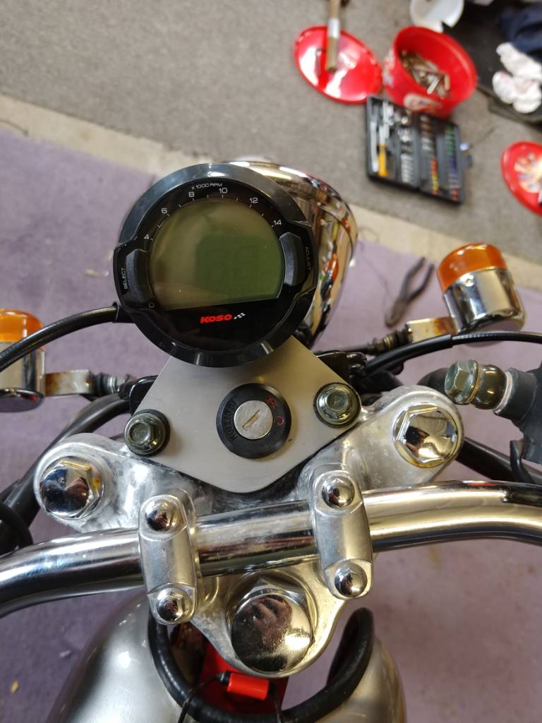

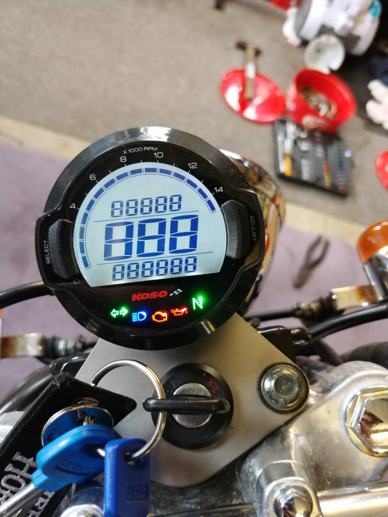

You better tell a bit more. Where from, how much, mods required please. You can't just tease us like that!
Haha Speedo is the Koso gp style from ooracing, I think it was £175 and no modding required to fit since it a simple plug and play kit, just a bit of a fiddle to get all the wires in place but a few cable ties fixes that issue but it's lovely once it's all set up, for me much better than the standard
