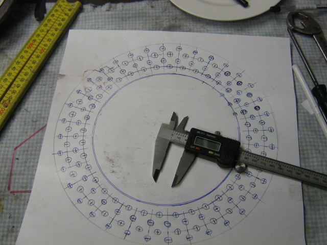

At this point I did a shite load of polishing, and drilled my front disc for less circulating mass and coz it looks da bomb (does anyone say that anymore? ???), onlu used one of each sized drill bit too, that easy glide works a treat

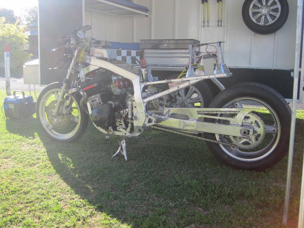

Work had to stop just about here as I built two of these
