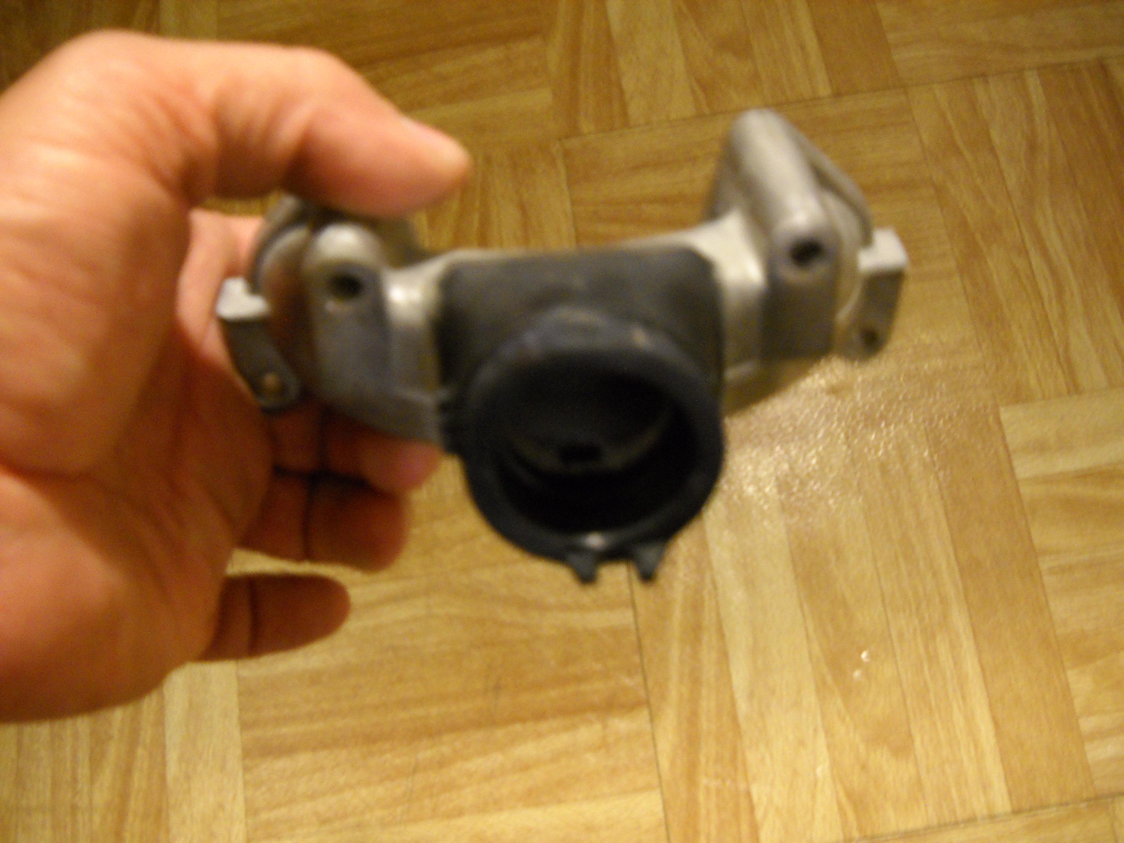

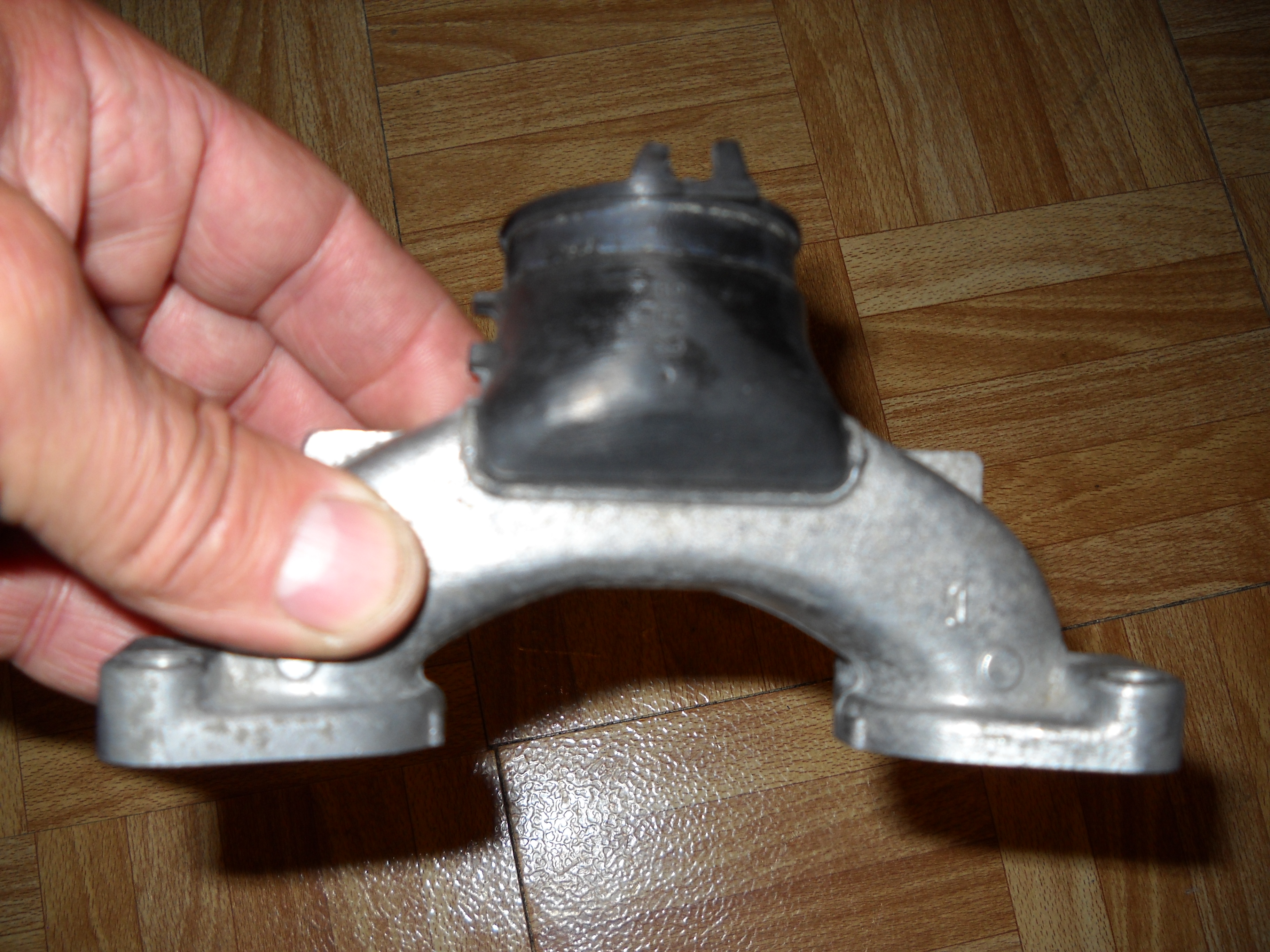

I have a fresh manifold for you from a low mileage bike w/ the # stamped KR3 on top and the rubber part is 100% pliable and solidly molded to the aluminum;I can do it for $5+ shipping in the smallest box from SW PA.
I tried uploading a few pics but it wouldn't work.

I think I'll take you up on that! The rubber on mine is pretty hard. And looks like there might be a couple cracks on the aluminum bonded part.
Think it'll fit in one of the small priority mail flat rate boxes?
CAL,
I tried to squeeze it into the Small priority flat rate box but it was just a bit to thick;I have a box that measures 6.5"x4x4" that will not be much more and it'll ship Priority.I'll try and post a pic again..
