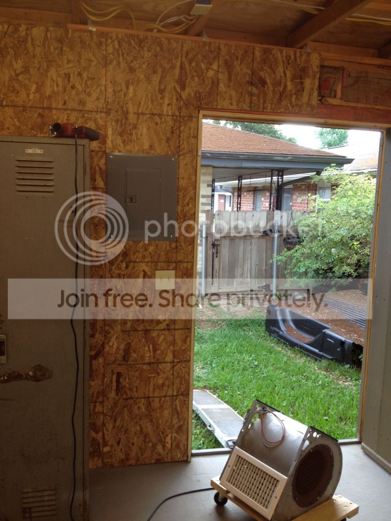

Got a lil more done...
Light fixtures wired up
Panel installed
BIL brought the wrong type main breaker, so wasn't able to light up the shop just yet. Got a couple of receptacles to install, and need to add in another switch.
Should be done by Sunday afternoon.
Nice shop! Hopefully you have a separate grounding electrode for that building. It really is essential for your safety.
Turtle, its grounded through the feeder panel on the house. Don't worry, a pro electrician did the wiring for me ;)

Will do. I'll see him this weekend at my nephews (his son) wrestling match. And if he can't explain it to me sufficiently, I'll bring it to the other two professional electrician brother-in-laws and/or my (retired) professional electrician father-in-law, and see what they have to say. I'll keep ya posted ;)
Phew, busy busy busy...
I got with BIL, all three actually, and they explained that it's a branch circuit subpanel that's 15ft from the grounded house breaker panel, something about it being Bonded, and that you don't drive a new grounding rod every time you install a subpanel, yada yada yada...
I kinda stopped them there when I had the epiphany that, we don't sleep together and I don't have to explain myself to you ;D
I'll hold trust that the three career electricians, that I'm related to, wouldn't put myself or their sister in harms way.
But should I or anyone else get electrocuted due to a negligent install, you can have first "I told ya so!". Mmmkay Pumpkin? ;)

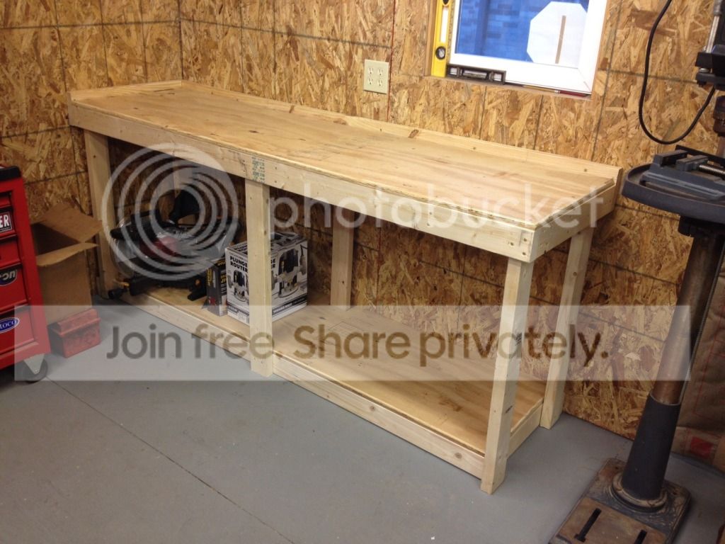

Got a lil more done over the last two weekends...
I'm gonna insulate and finish the interior a couple of weeks at a time. That way it's not one big project, or expense, all at once. I'm starting with the walls that will have benches since they will be attached to said walls.
Still had one more roll to install...
I actually got the cuts right on the first try. I know, I was shocked too!
Almost done. The extra meat on the corner is there to give added support for a vise...
And the finished product...
I also did a roundover with the router on the exposed edges of the plywood. This will eventually be a workstation bench for the bench grinder, belt sander, etc. But it'll do for now until I can insulate/finish the two walls where the main bench will go.
