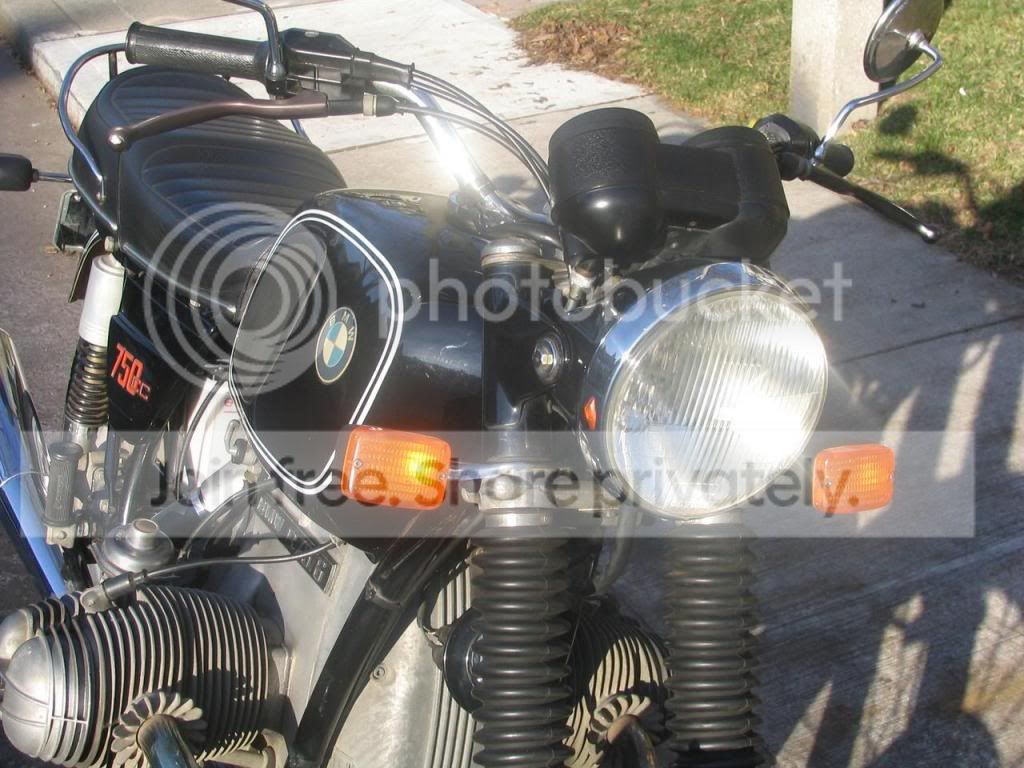

Well shit - that didn't work out well. Bars look and feel great, but my cables are throwing a tantrum. Clutch and throttle felt fine in the garage, but in reality the bike won't go below 3000 rpm now and the clutch is a lot heavier, which for a BMW clutch means you need to be a German weightlifter to pull it.
So for now it's back to the American bars, until I get shorter cables. Will be on the horn with BMW tomorrow to see if they happen to have a euro-spec clutch, brake and throttle cables laying around. Wish me luck. Would like to have these on for Wednesday's meet up so it's either all new cables or old bars Tuesday eve.

I was afraid of that... everything throttle should be adjustable but the clutch is odd... shouldn't really be an issue... I take it you checked for hard radius bends etc?

Here are the pics. Not only did the bike want to go a little extra fast, my right carb decided it was time to overflow too! I know it shouldn't be related to the cables, but nothing else changed and it's never even hinted at overflowing before.
Anyhow - need the right length cables no question in my mind. I checked out Bob's but the throttle cable selection could simply not be more confusing.

the cable look like they have some pretty hard bends in them. you clutch cable looks like it come sout of the cable tensioner and bends up at a good angle, the you throttle cables look they bend back on themselves, could be just the angle of the photos. i have stock U.S. cables on mine and i was able to reroute them so the bends would be smooth even with the extra length. my clutch cable is the only thing that i could shorten some if i dropped the clip ons lower.
Re: Tintin's 1975 BMW R75/6
I'll likely try re-routing. I checked Bob's BMW and couldn't sort out which cables to order. The brake cable seems to be one model for all bars anyhow. I haven't opened up the throttle or clutch handle housings yet - is this a big pain or relatively straightforward? I guess I'll find out :) I figure the biggest hassle will be the fancy throttle mechanism.
