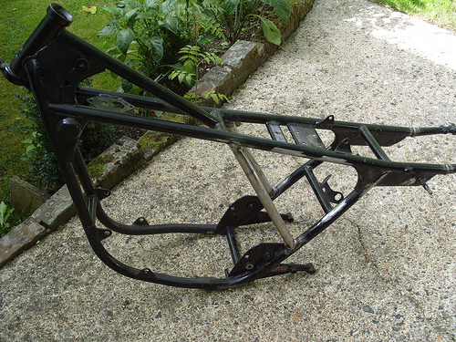

Then it's a total strip down, and prepare the frame for powder coating.....
We decided to go for the race look with this one, so we added a frame brace from just above the swing arm pivot to the frame below the fuel tank......as fitted to the TR spec race bikes of the 70's.
We also plan to do away with the side panels, which we think spoil the lines of the bike.....so the lugs and brackets that hold them on have been ground off along with any other unecessary bits. It gives a really tidy look !

And back from the painters.................note the rear frame members...they were cut off, tipped up, and re-attached. This way they still support the seat unit, but are tucked away out of sight.
