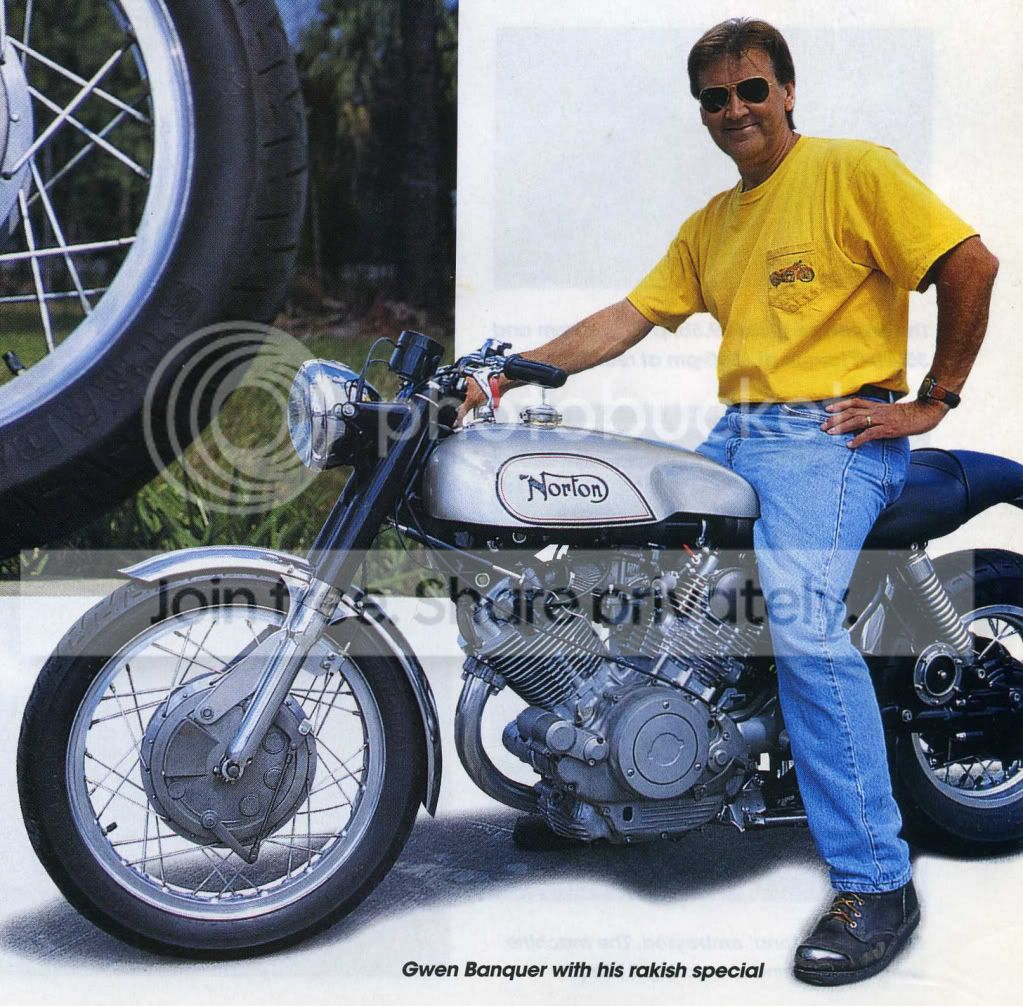

So - I'm serioiusly looking for a TR1 / XV donor to build a '60's style Cafe Racer in the Norvin style.
I can live with the shaft drive if I have to, but it must have wire spoked wheels. I can have them built up [ I want 18"'s back and front ].
I might also look at the Grimeca 4LS front drum/hub ass'y.
