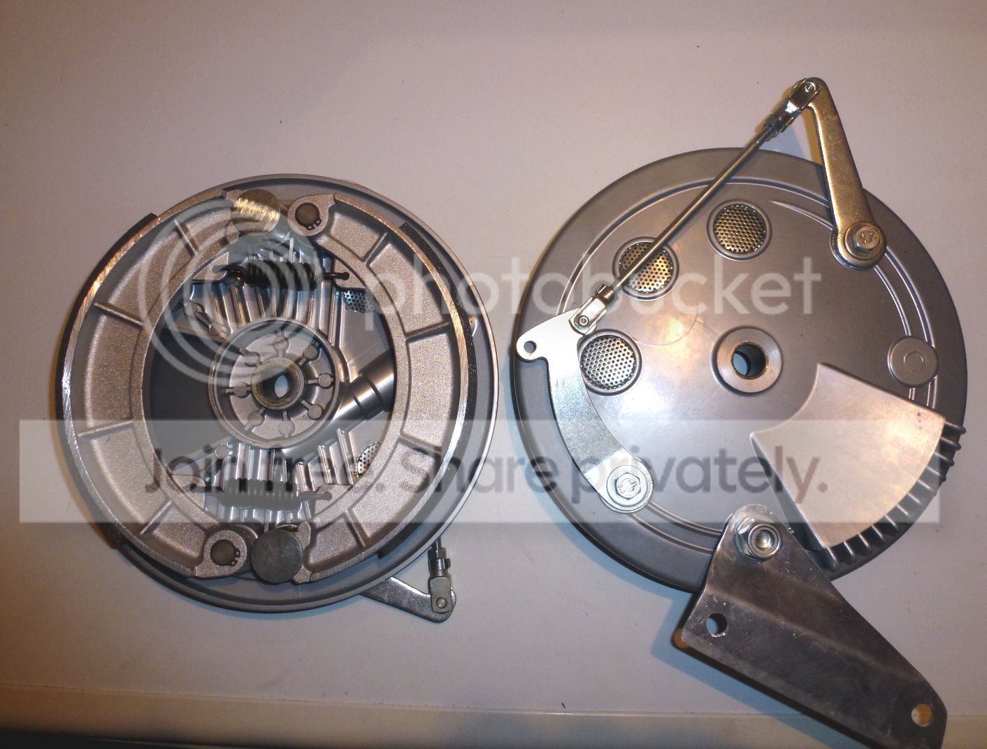

Yes, I need to punch out the other holes and add the levers to make it 4LS right now it is a technically called a double sided brake hub. After the mod it will be 4LS. The mod changes the stationary pin to a movable pin and then you add the lever to that on both sides. Its half the price of an actual 4LS but does the same job.
I have Jap bikes and have owned a lot of Jap bikes in the past but I know what you mean. How many CB350's can you really look at before you lose interest.
FYI - here's a pic of the reverse side of the 4LS.
Yeah, I've seen a 4LS brake before, have you seen the conversations that are common two make my hub just like that one? These guys offer it as a service but I'm going to be doing it myself because I already have the parts to do so.
