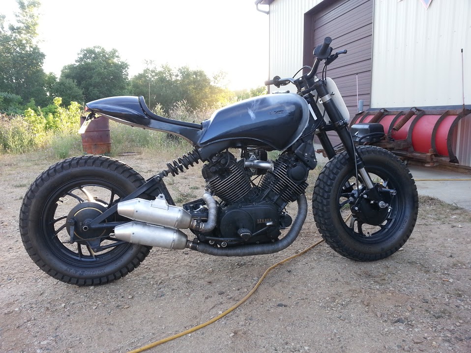

so my tank is off getting dents pulled and I need some advice. I tossed on my buddies xv920 tank and now I cant decide which one I like more.. my buddies tank sits lower in the back so there isn't much of a gap, whereas my tank has a gap from being raised.. any thoughts?

If you want I can grab a midnight tank that just got dropped on both sides, will need some work, but it'll be free. I wish you'd done this a week ago I had a nice one I just traded for a 750 tank ::)
yeah.. not completely sold on it, but going to put a different color at it and see how I feel. for some reason it just looks a little too big. idk.. anyways. rich im all good on that tank, wes and I are going to trade as he was searching for a 750 tank anyways. just waiting on some clutch plates and springs to come in the mail and ill have some updates.
I was going to vote for the second setup, until I put some thought into it.
I think that if you raise the tail a little at the front end, maybe also trim that corner that points downwards a little so that it flows better with the tank, the first option is better. It has smoother lines and it looks smaller, which I like (a personal preference of course...)
M.
