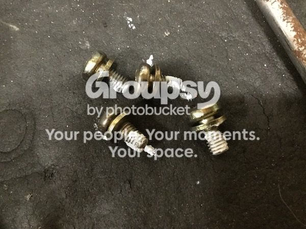

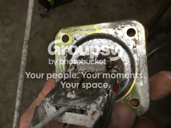

Got up early this morning so I got busy replacing that pesky weeping O-ring on the sending unit before leaving for work.
Dont drop the lock washers from the fuel pump connections into the tank. Ha
Nasty.
Fair amount of pitting. If it continues to weep I will have to re-visit w a light smear of metal mender.
cleaned bolts and a small dab of teflon sealant.

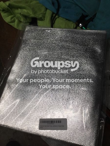

Fresh self adhesive heat shield I will cut and fit after paint.

Glad to see you're replacing the heat shield on the tank underside. It ain't there for looks . . . since K bikes recirculate fuel through the tank (good thing for keeping it cool in the rail), that tank becomes pretty warm on a hot day after a long ride, even with the heat shield in place.
