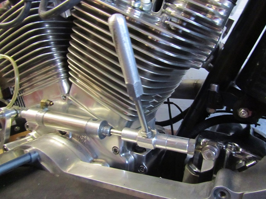

While I wait for the power connector to arrive, its called an Anderson connector btw, I've done a few small jobs on the bike. First made a simple bracket to hold the choke cable, still needs polishing but it'll do. Next the gear change handle needed changing, as it was too short and didn't give me enough leverage, while the little plastic knob on the end kept coming lose no matter what clue I used.
I found a length of alloy bar in the scrap bin which had a M8 tread drilled in one end, no idea what it came off. By cutting it in half and rounding one end, I had my new gear change handle. The next task was to cut a M8 thread in the stainless part of the handle (a bolt that had its head cut off) so the handle could be screwed securely into place. That's easy enough using a die, except when using stainless steel, as its so hard, its a real pita to work with. Took my time, only turning the die a little each time before backing off, till I had enough thread cut.

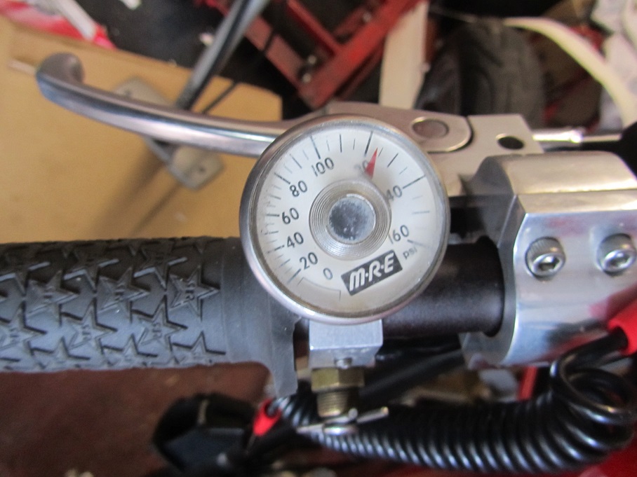

Next I replaced the old tired clear 6mm tubing for the air shifter with new black tubing, as it looked better and it allowed me to move its components compared to how it was fitted on my old drag bike. I pressure tested the lines by pumping in 130 psi, it lost 5psi in an hour which is ok, as it'll be re-pressurised before every run on the track.
