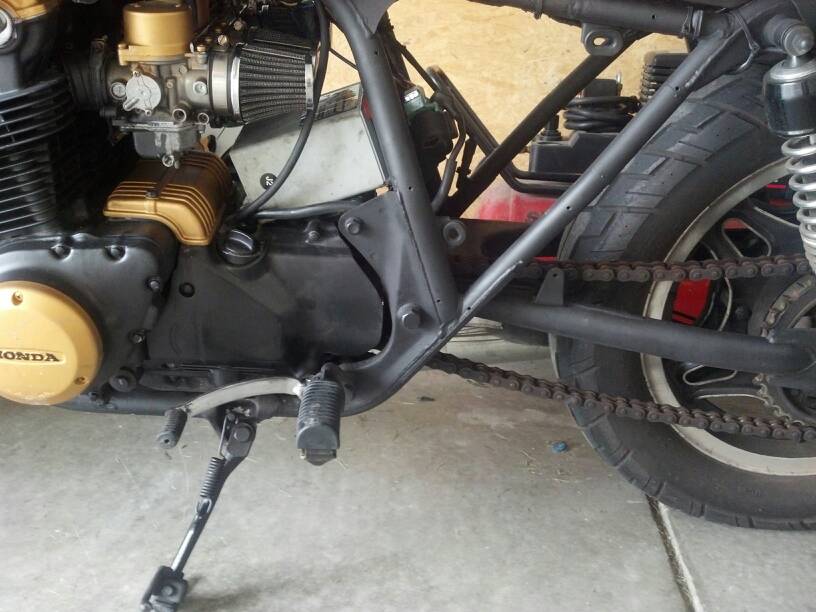

Hey veit earlier I asked you about a pair of rearsets for a 1979 cb750k. You said they Mount to the passenger peg location however my bracket it gone. Would you be able to mount them to the attached bike? If so where and how.
Sent from my tool box using a wrench
