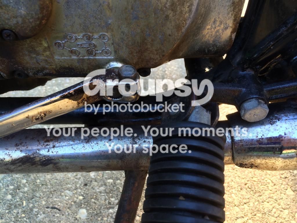

Any chance these can be made for Suzukis? Specifically a 1979 GS 425? It has a rear drum brake. I can send you some close up picks of all the linkage and stuff.
Here are the measurements on the GS 425:
From the gear shift shaft to the rear peg mounting hole is 4" center to center, then the second mounting hole is 2" from the first peg center to center.
From the brake pedal mount to foot rest mount is 5" center to center.
Here are pics:
