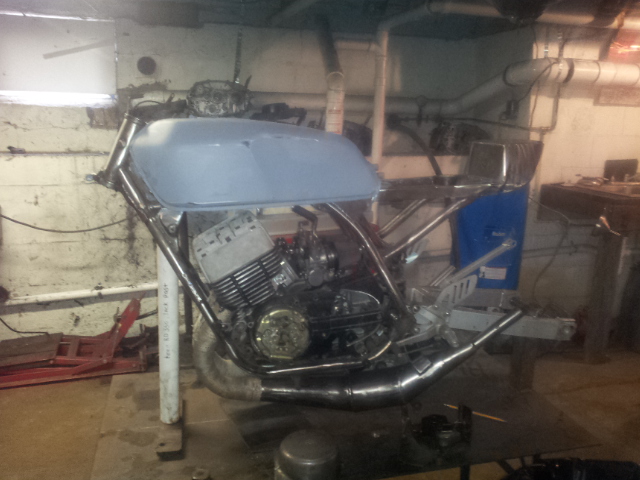

Found some time to get fimiliar with the rd today. I am waiting on new coils and decided to start my hoop and tail. I purchased the bike a couple weeks ago. It was missing the harness and had a goofy seat.
I figured out the harness and it ran for a short time till one of the coils went out.???
I am planning on building my own seat and tail, modifying the tank to match the tail better, getting chambers, powder coat, paint and, whatever else I can manage.

I got the chambers on and took her for a rip. Sumbetch is fun!!
I decided to look a little closer in the carbs, different pilots jets and different main jets. That explains the somewhat erratic behavior.
I believe the timing is spot on and starts super easy.
Here's a pic, ignore the seat.

I took a brake on the benellis and mounted the tail where I want it. The brake and signals will be hidden above the hoop in the tail.
I am debating to make the seat one with the tail or its own structure.

Not much progress today.
I finally decided how I wanted to do it, after a couple different mock ups. Quite the learning curve.:o
Got one side welded in, ran out of gas. Dammit! The other side is cut out and ready to weld up.
Far from perfect but, moving along.
Just need to build the filler to the tank, finish weld and, grind.
A bit of progress.
I plan on welding a tab on the rear of the tank to attach it to the front of the seat.
My tig welder is being a pain. I can't keep the gas flow consistent.
