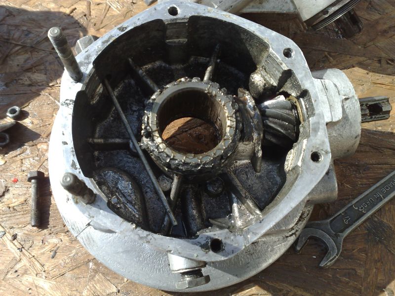

Stripped differential as well. Welded block, remilled, turned and refaced surfaces where was needed, new bearings, studs another bits and ready to fit! In the future will make one more gear to block the wheels when needed.

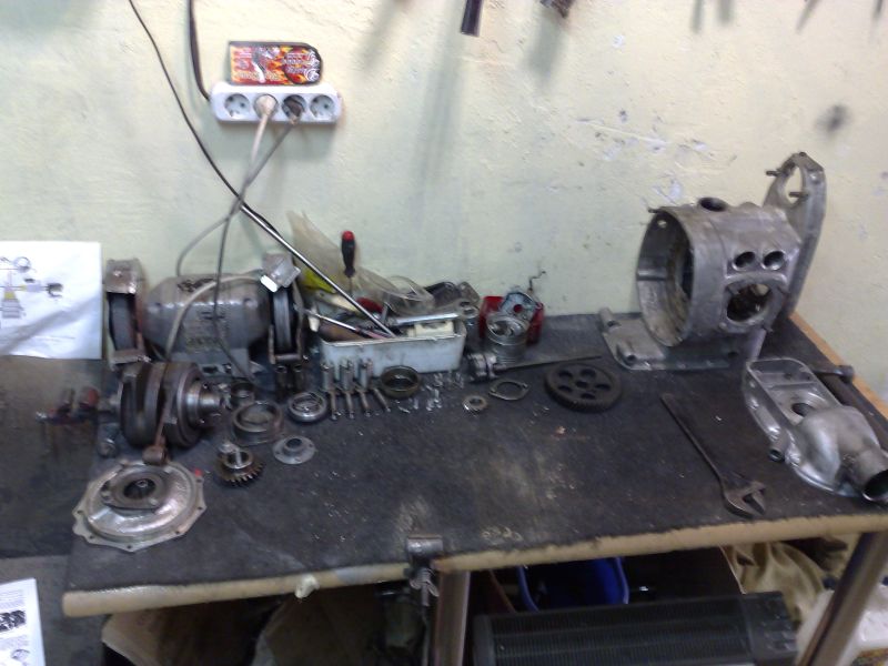

This will be the most interesting part: The glory engine! It took a bit time finding all useful information and specs about original engine, common problems and modifications. All i got just a block, crankshaft and couple other bits. Loads of part been fitted from different models and even cars.
First what i did was all bearing holes alignment. Also instead of original camshaft sliding bearing I put needle roller. This gave me less camshaft friction, less play and better lubrication.

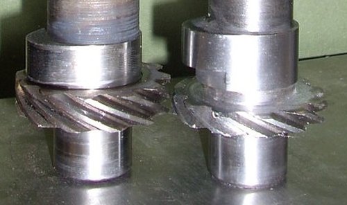

Also lightened couple gears. Less weight - more power! When you looking at similar URAL and BMW parts you can see that Russians had a rule: if in doubt - leave more metal. Everywhere. So Im trying to count every gram on this engine.
