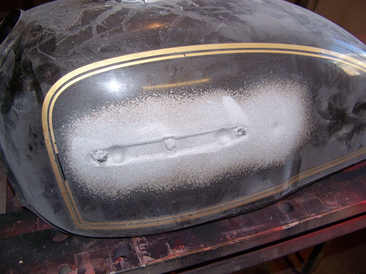

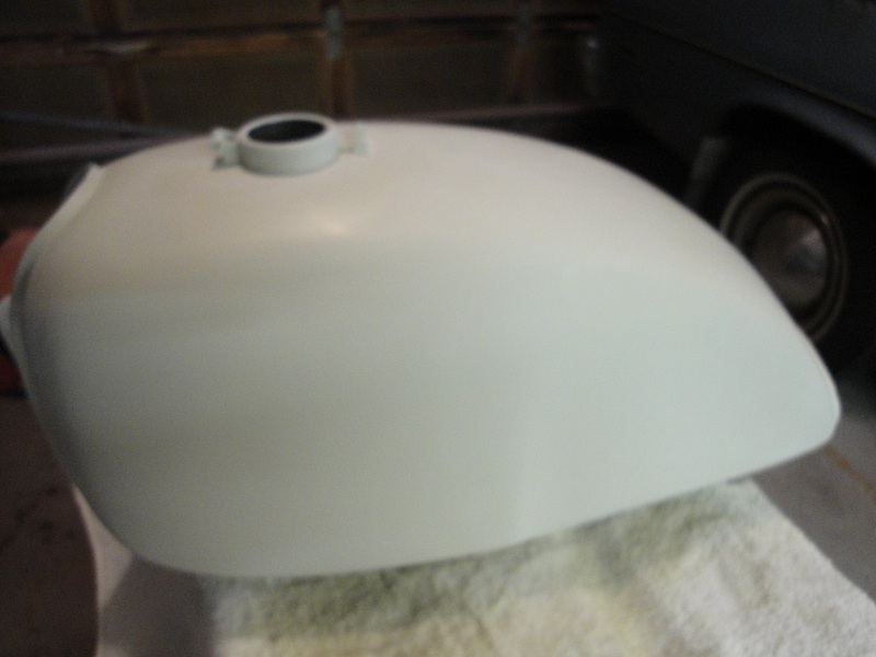

funny you should mention this.. i used the same tank, and here is what i did,, pull off the honda name plate, chisel off the rivets, weld the wholes that WILL be there, tin it , fill it with molten lead, grind it smooth, sand the shit out of it, prime and paint as normal, and you will NEVER have any gas seapage issues at all... nick... i will attempt to attach some pics of my tank... nick

RTCCP, nice job man, did you do the patch yourself or can you buy those somewhere? I need something nice on mine but couldnt paint something that looked that good.
This is the answer, superb job btw. Funny its also a CB500t tank I'm actually looking to do. Leading is the answer. :)
