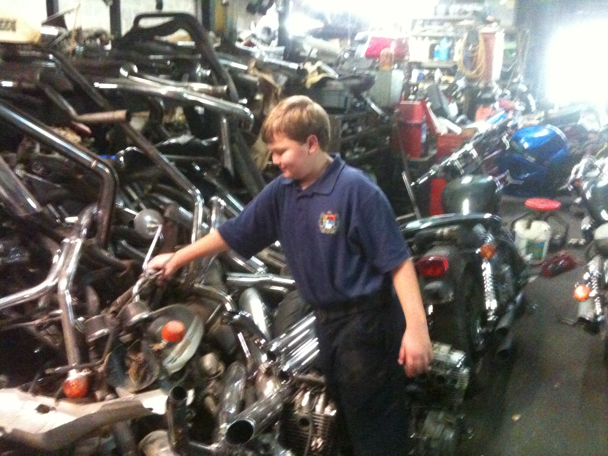

We are keeping her mom! Well Zeke has Tony, Teazer, and Kop to thank for his new build. She was covered in exhaust pipes and Zeke's first word as he uncovered her was Victoria! Tony was once again kind enough to sell us one of his project bikes. This will be Zeke's string so from this point on he will be posting. We loaded her up in the pouring rain and took her home.
