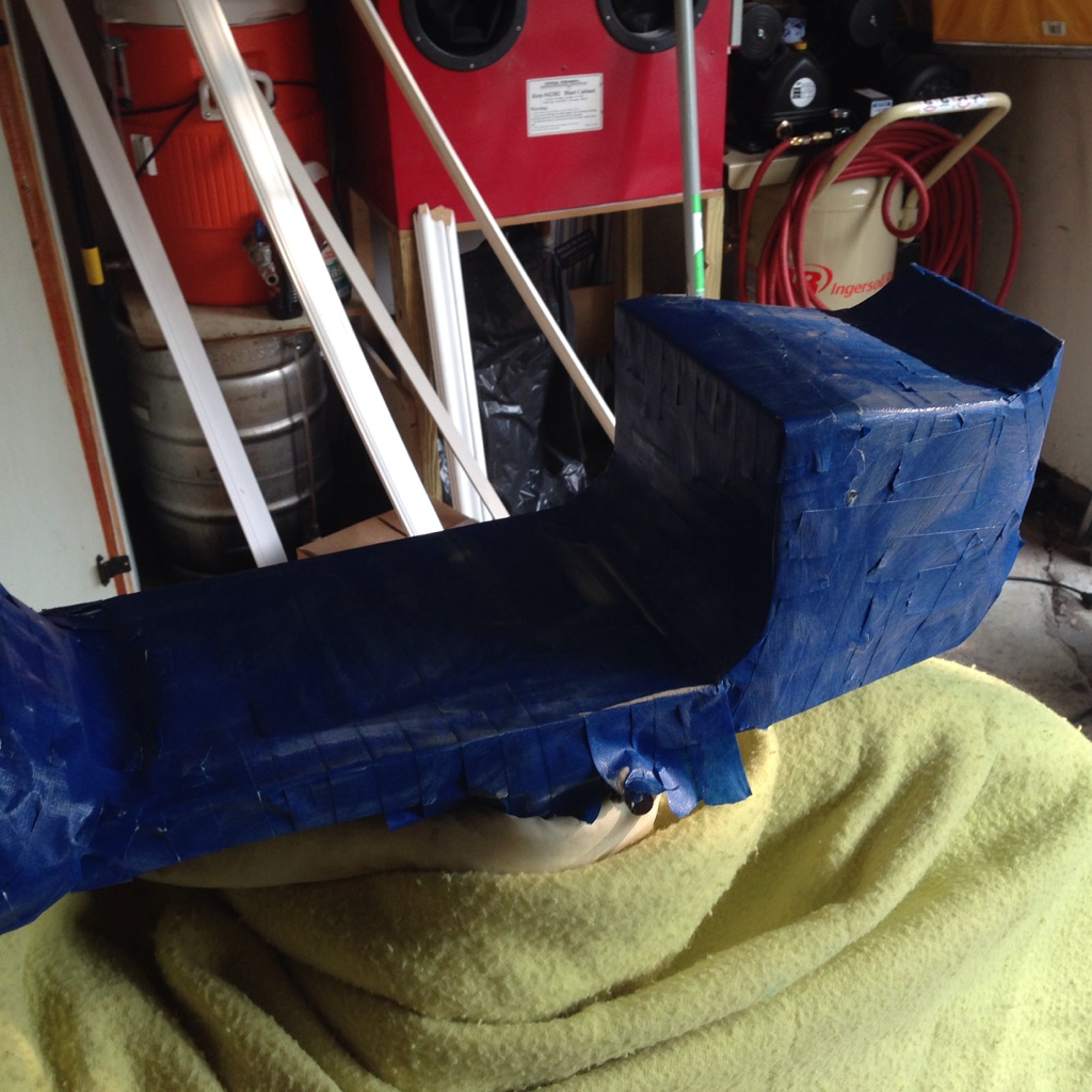

Re: First Vintage Race Inspired Smoker
Worked on it today!

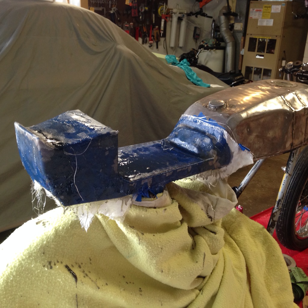

Got 1 layer of glass on. Going to let this dry, take it apart then throw a couple more layers on it.
nice fiberglass work!did you use epoxy resin or smthing different?
did you use any wax between form and fiberglass?
would you recommend that kind of fiber mat you used?
i m exactly at the same stage of my build!!
I covered the tape in a car wax. Seemed to work well. I just went to napa and picked up a kit. It's not actually glass but some sort of cloth. It's suppose to be stronger but it's a pain to work with. Makes a huge mess with strings and won't do corners worth a shit. If I was to do it again I would go real glass.
If I was to give advice, first would be to buy a seat, if you reaaaaly want to make one, measure your mold 100x to ensure it's even, I had to cut mine and reshape it a bit today because the two sides weren't even. Turned out ok but it's been challenging.

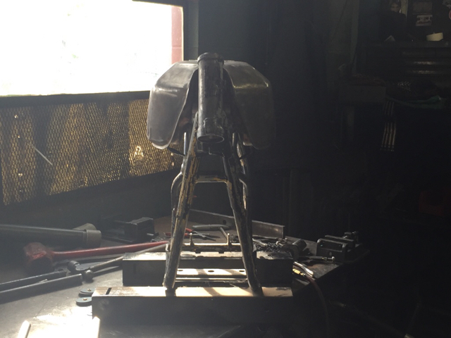

Been a super long time since I've posted much on this, there has been a little going on.

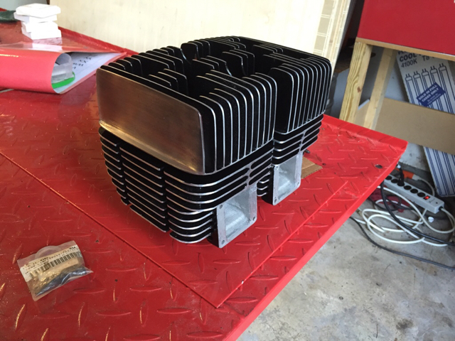

First, got the jugs and head fins cleaned off. I want to leave them with a more brushed look and mirror polish.

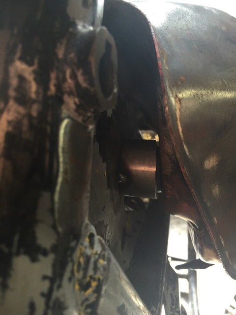

Also have been working on the frame some with mothgils. Cleaning up some of the old tabs, cleaned up the old shock mounts and will be making some new. This was because the PO cut them off.
Also tacked up some mounts for the RD400 tank that Brad made.
Pics of the fins

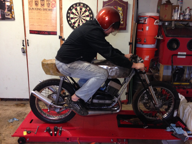

Been for ever since I've made headway with this, and with all the other bikes it hasn't been getting as much love recently. That being said, I threw the old seat into the trash and made a new one. The old one wasn't straight and I didn't feel like fixing it. The new one came out much better, spent a lot more time on the foam ensuring it was all even.

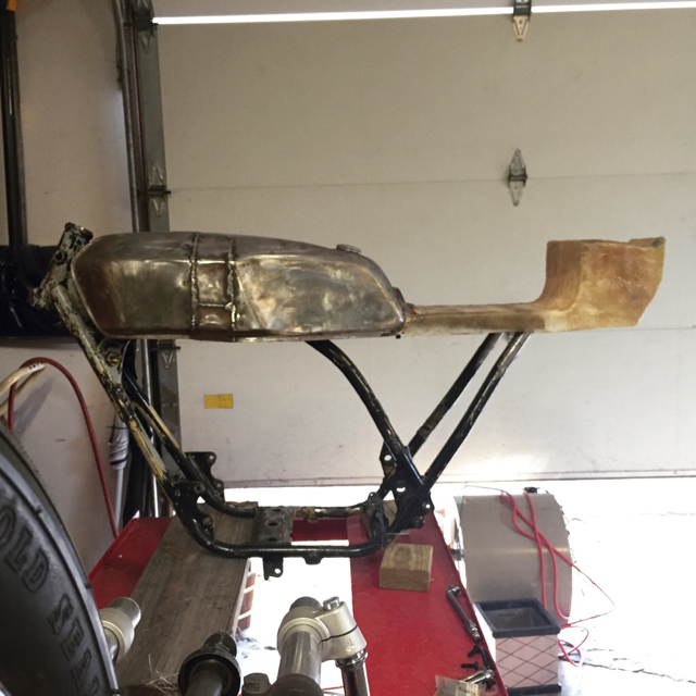

Last of the major frame work tacked up. Got the fame back on the table and the mockups have started.

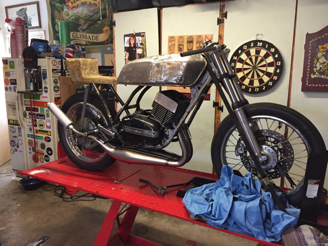

Been a long time, long time, shouldn't have left you, left you, without a dope beat to step to..
Well, been forever since this has been worked on. Cut ties with the GT freed up some room, and it's starting to get warmer again. So, let's get back at this and try to get it done. Started mounting up the fairing, came along nicely, but I think I'm going to end up a little more aggressive than originally hoped. Might trim up the fairing to allow the clipons to come up a little. Here's where we are for now.
