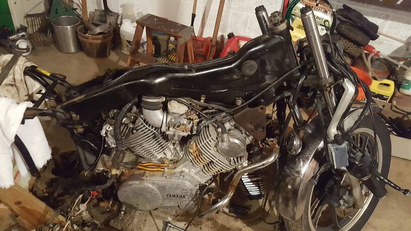

I just recently joined the forum. I just got a Virago XV920 from my neighbor. the bike was left outside for about 2 years so the tank is in terrible condition and the wiring needs to be done. My plan is to strip her down and rewire just to make sure the bike runs. This is my first build so all comments are welcome. There may be things I have not thought about while disassembling the bike please advise.
My advice? Don't strip anything down until you get it running. You'll end up chasing your tail.
Get a manual and go through a FULL tune up procedure, get it running, then start modifying.
This, 10 times over.. make sure its running and running well so that you have a good baseline when you start to change things..

Thanks for the advice. The wiring was bad so i thought to strip it first.
Do you have a mitigation plan for this
Sent from my SM-G920V using DO THE TON mobile app

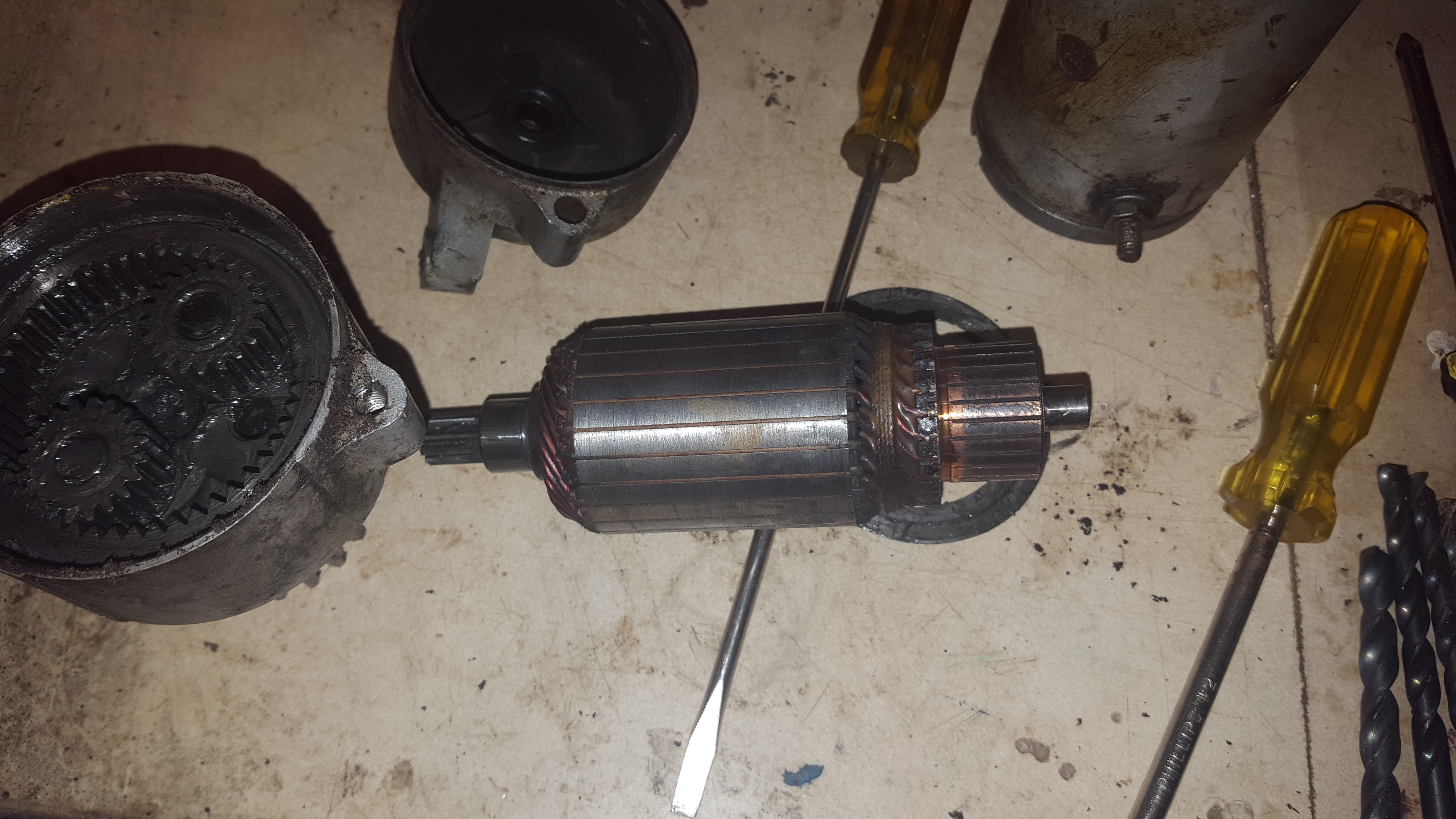

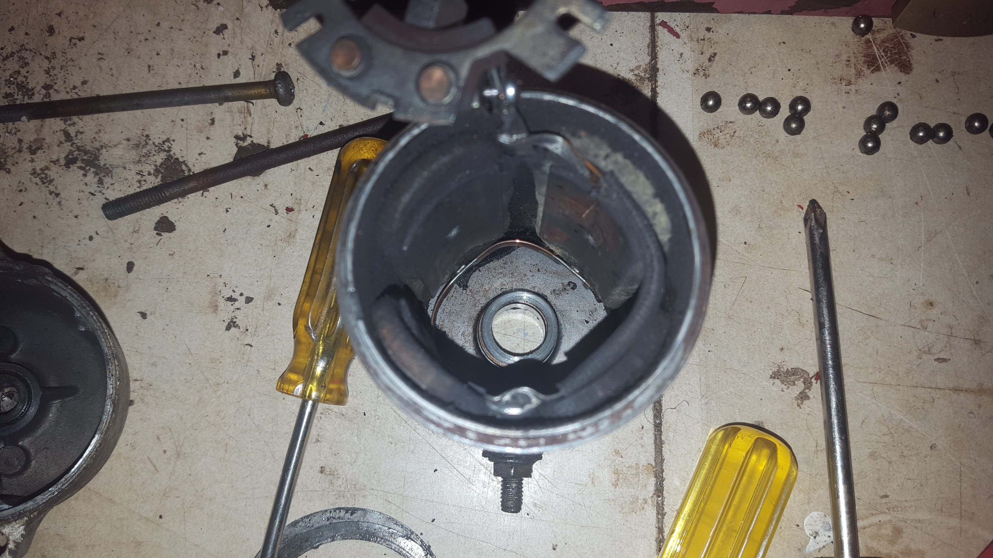

I finally got the bike stripped down to the engine. I was about to start to perform the compression test and the starter motor does not move. I disassembled the starter motor and it was filled with black crap. I do not want to put any money into this bike until i know it runs. Is there a way for me to clean the starter motor to make it work again? i have read the forum everyone is just talking about how bad the virago starter motors are and how to rewire them on a running bike. My problem is that it does not work when i connect straight to the battery.

Have you been over to VTF and had a look at some of the Info on the starters? I seem to recall the starter clutch being an issue.
As for the black crap, how worn are the brushes?

the black gunk in the starter is quite normal just blow it out with comp air,not in your garage lol
98% of the time when a starter quits is because the carbon brushes have worn down so much that they are hanging up on their wire tail and then just skimming the comutater
real easy to deduce if this is the sitch
if so replace brushes and check comutater for being out of round spin it in your lathe or on v blocks and put your dial indicator on it
or just take it to the local generator/starter rebuilding shop ask them please would they check and or clean it up
they will have brushes too in fact they can "rebuild" the unit its no dif than any car starter
they can test the whole thing as well
