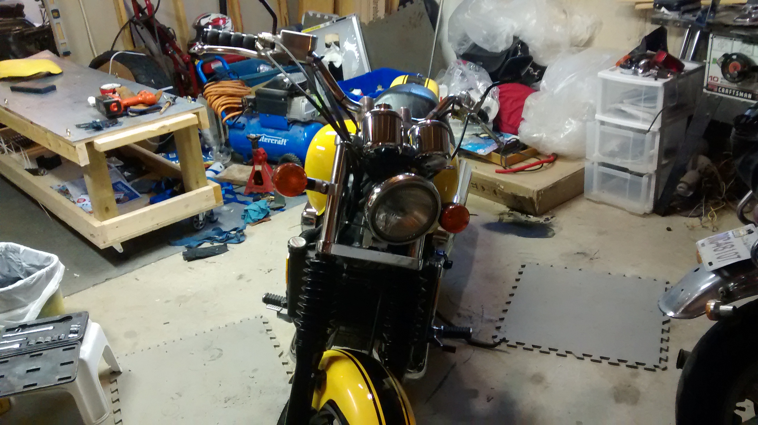

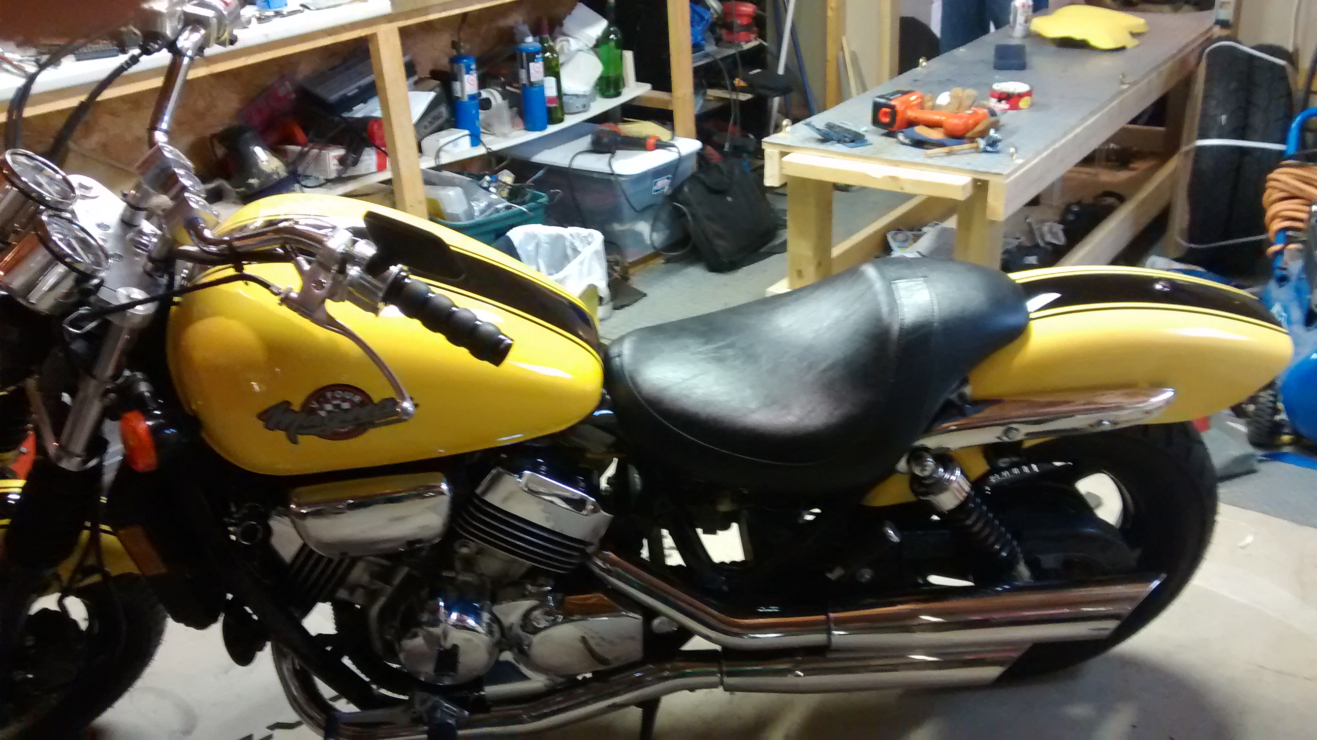

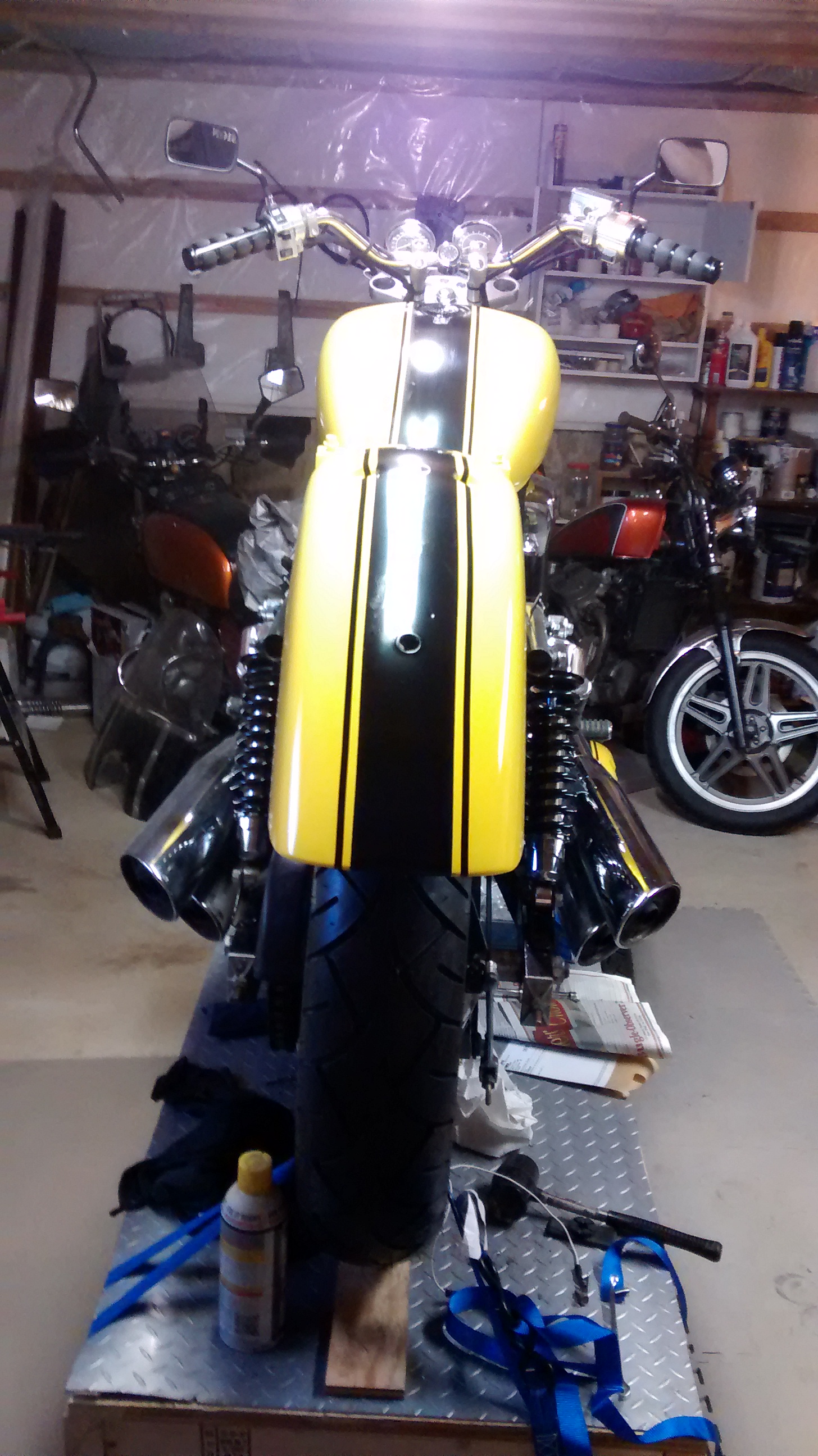

Well we decided on a Stripe to break up the sea of yellow on the tank. I think I like it. Once I get the OK from the owner I'll do the same on tail and front fender. Sonreir came through with replacement decals. So will be able to clear the whole thing in a week I hope.

So as soon as the replacement tank decals arrive from Sonrier, hopefully today or tomorrow. This will all get hit with 2K clear and some minor assembly and polish work and it will be done.

And then there was clear. 1 whole can of 2K for the tank. Had a minor mishap with the side covers so I will have to do those again but the rest is good to go back on when it is fully cured.

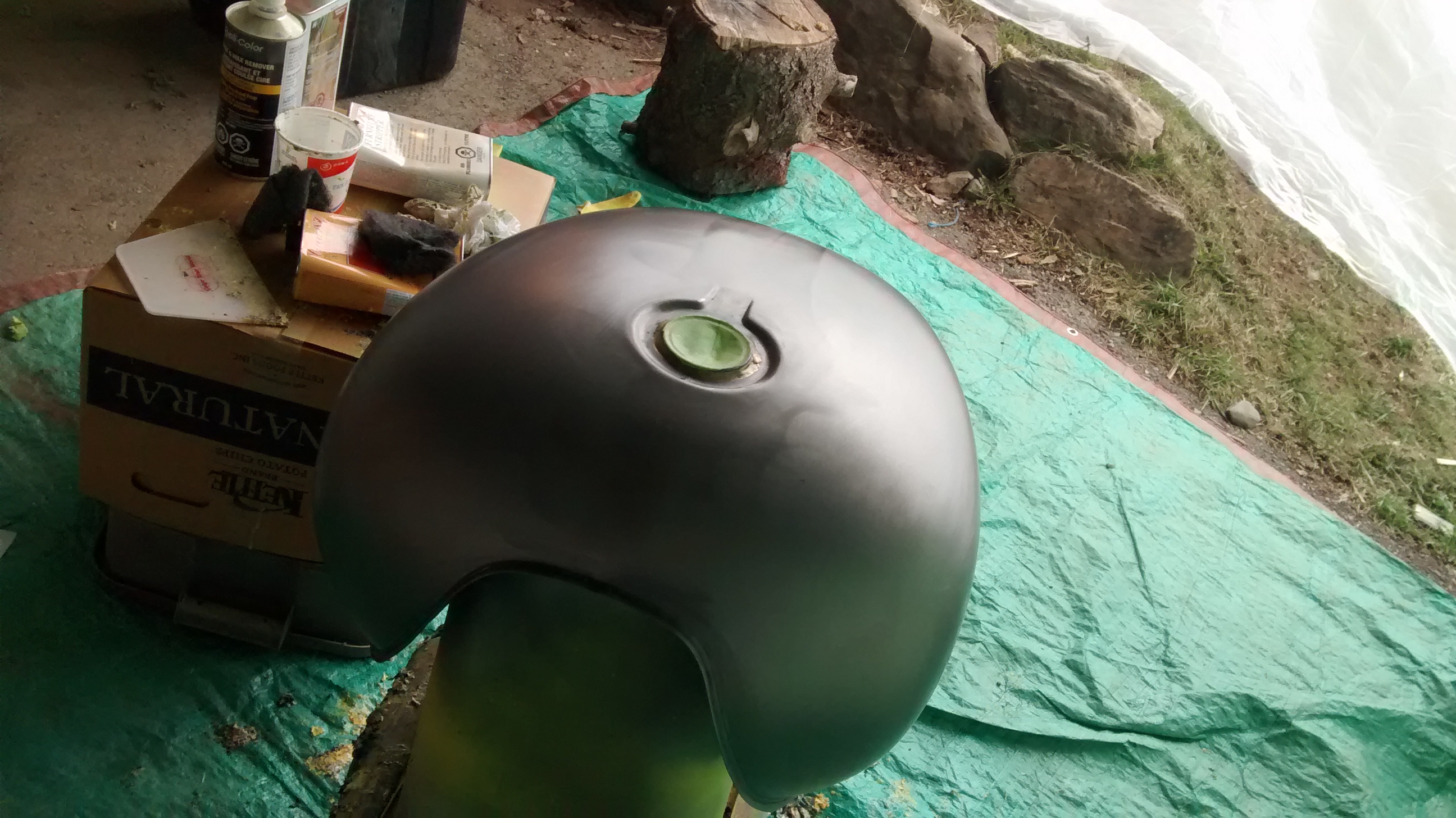

Well the chip repair failed so we are here now. Starting from bare metal again.
